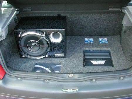

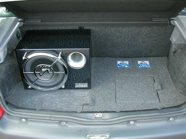

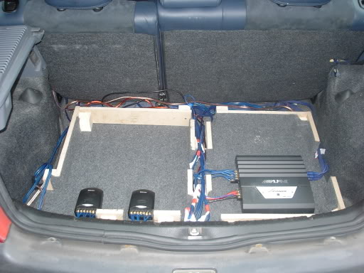

Built 2 false floors, mouted the amp on the bottom one, cut a hole for it, and put the second floor on top. Knocked up a couple of beams the same height as the amp.
All the wires are hidden under the top floor and the amp is inset into the floor.
Job done :D

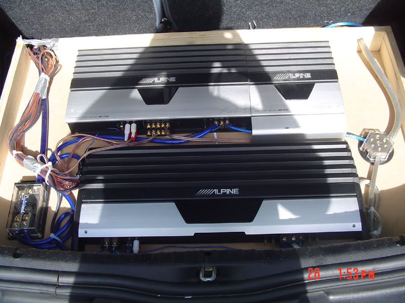

cut round them then. Its well easy, heres my old install:
build a box under make sure teh supports are higehr than your amps:

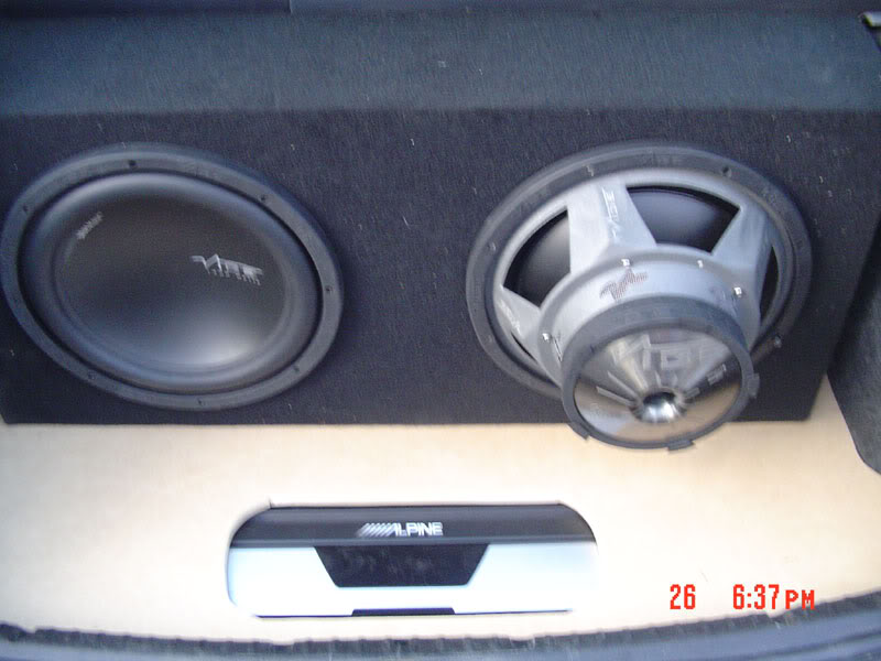

Then make a template using boot carpet, and card board, then cut out with a jigsaw. Take your time with your template.
then carpet, job done:

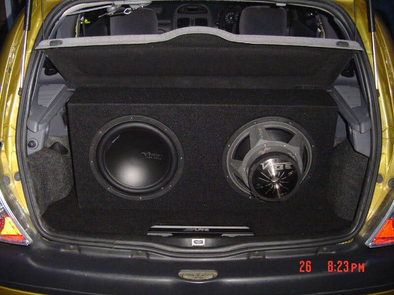

and my new one built in the same way, but the floor has bein raised to allow for 3 amps, stacked:
