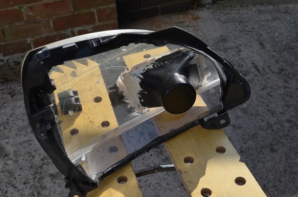

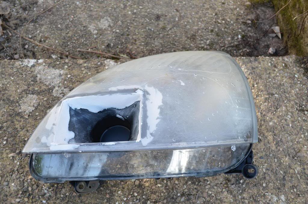

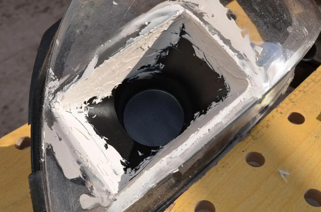

Small update, with the weather being nice this weekend I thought I might as well crack on with the headlight project I wanted to do. With induction filter right behind the headlight I thought it would be ideal to have a cup racer style headlight as used on the MKII 172's.

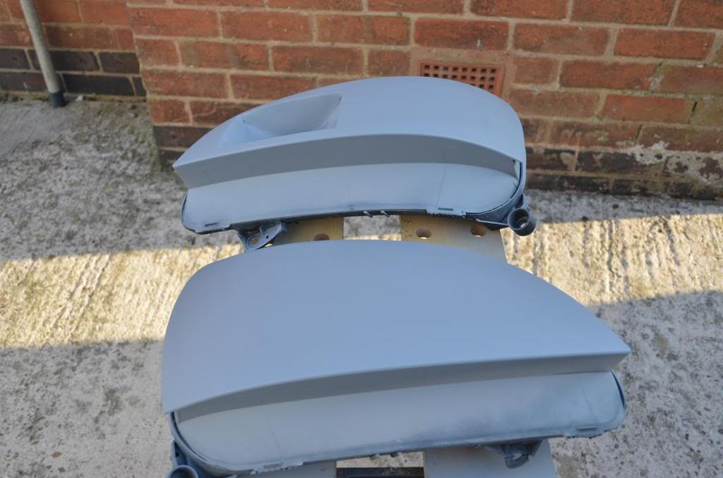

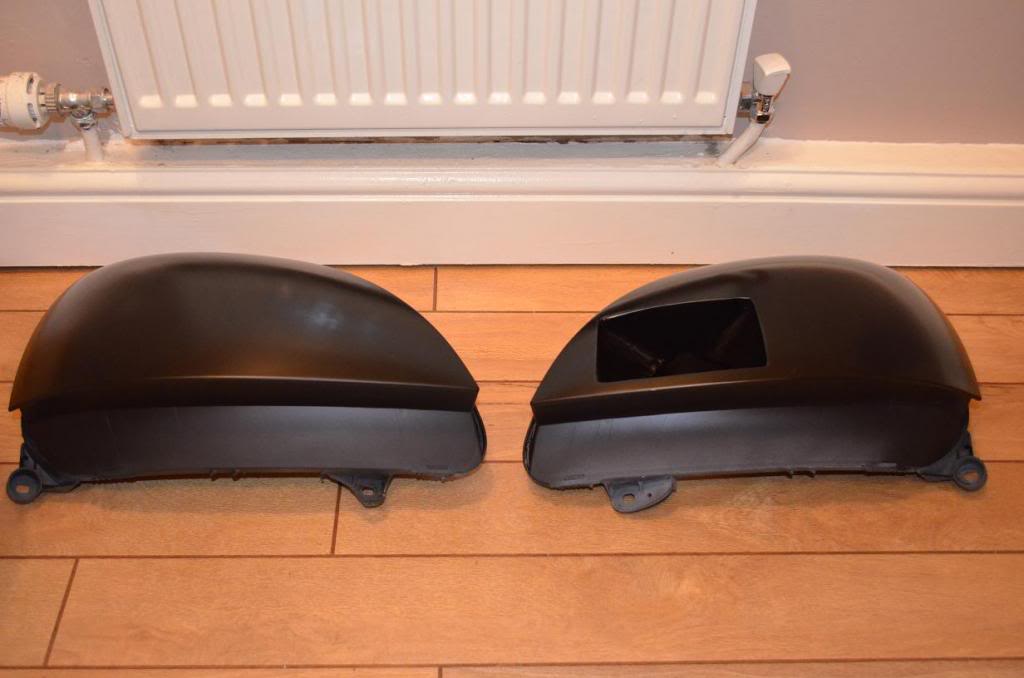

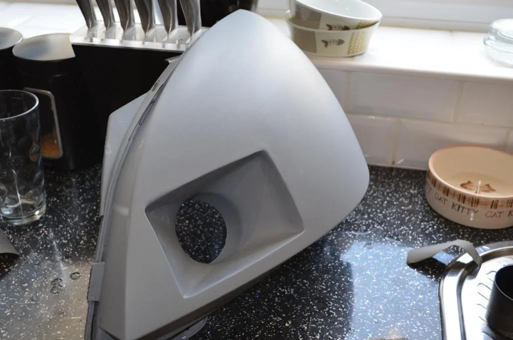

I've previously purchased some headlights for £25 and Demon Tweeks brake duct for £7. After trimming the duct to the approximate shape I used Araldite to bond them together, then body panel filler for the gaps and to square off the inner face. This is the first time I have used filler so happy with the outcome, but could have done better. After a few coats of primer I used 2500 grit paper with soapy water, rinsed and left to air dry before the final coats... Matt Black :evil:
I will leave the lights properly cure over the week and then fit next Friday. Any ideas what sticker I should put on them? I was thinking an orange Alpine Star logo?
