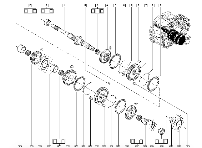

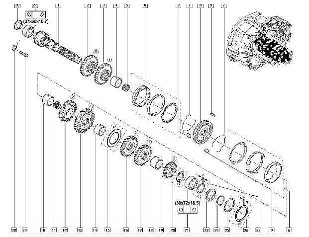

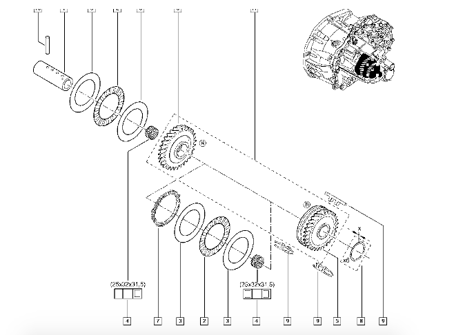

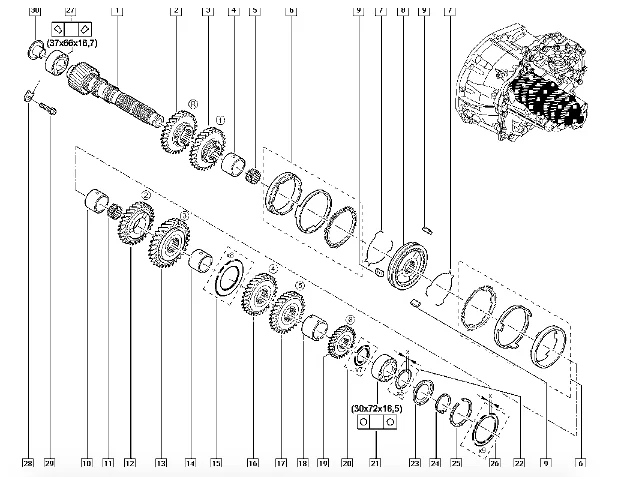

The part number are 8200608035 and 8200611295 and you need both parts
Renault have been know to put the wrong gears in the wrong boxes though, just make sure to count the teeth when they arrive!
