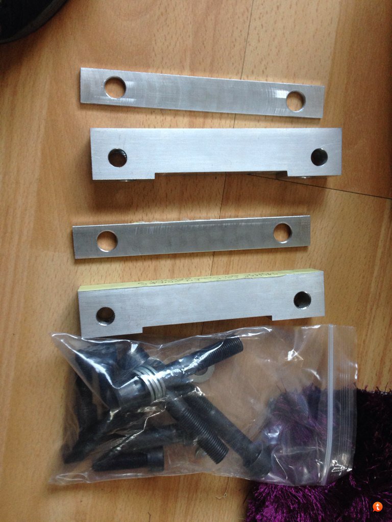

They were delivered today look spot on shall be fitted next week hopefully
I'm using goodridge braided lines

Do you have the brakes already, once fitted I'd really appreciate a few pictures. As you are going to be running the 300mm disc i take it that is what the smaller plate is for?
they ive had the calipers for couple of years but never thought about them much until the last few months plus i need the stopping power now.....yeah they must machine the main bracket for 280mm and by the time you add the plate plus the calipers dont need the 5mm removed from it for 300mm it makes up the difference
I thing I will stick with the 280mm disc, I did think they would have been one sold bracket as the website page seemed to read as if they where all made to order.
