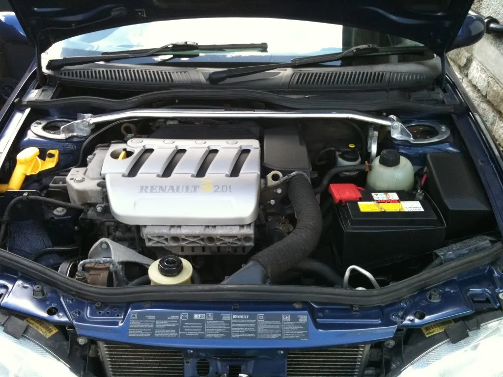

well hey all..i not so recently found out that the engine in my car is pretty much a heavily detuned 172/182 lump naturally detuned by renault. so after having a long chat with one of my very good mates i decided that the aim would be....swap a load of 182 parts onto my coupe. so the biggest differences between my engine and the RS clio is the exhaust manifold, ECU, inlet manifold, cams. as standard my car is pushing 140bhp so plans are to literally swap over a set of 182 cams, 182 exhaust manifold and try (long shot) fit a flowed 182 inlet manifold then finally custom map the car to see it to around the 170 - 180 bhp mark (fingers crossed).
So whats been done to the car so far?.....nothing much just cosmetic changes such as lowered 45mm, Ktec polished strut brace, 16" TD pro race 1.2's in gloss black.
to improve the car generally i have had fitted a clio 172 gearbox mount (eliminate play in the gearstick and cabin vibrations), Ktec drilled discs and EBC redstuff pads at the front with OEM reno discs at the rear with mintex pads.

The cylinder head is different too isnt it? If you've already got a 172 'box in there would it not be easier to just fit an engine from a 1*2 you can pick them up cheap off here from people breaking cars on here. Just an idea.

daveski mate i remember u. i used to be a CC member but after a hiccup and myself being slated over a £1 bung i was no longer a member. dont really fancy joining it since there are a few people on there i dont get on with at all lol. cheers tho. Yeh i know there will be problems. The easiest bit will be the exhaust manifold then its simply a matter of gettin powerflow to mate the manifold to my current system or just get a full custom jobby done. Cams should be a simple swap aswell but then the problem will be gettin the standard ECU to accept everything otherwise its an OMEX jobby lol. I am most likely not going to have a 182 inlet mani fitted as everything will have to be reshuffled which i dont fancy so it will be the 'easier' mods first.

Brett not sure about the cylinder head...i know for a fact the compression ratio's differ between my car and the RS clio's as the clios is quite high no? i always thought the actual block was the same tho. i know they differ in pistons and rods aswell.
Gobsheene yer they actually have 2 different 2.0's for the ph2 coupes. Daveski has the IDE version and mines is the VVT version. both have the same bhp but IDE has better pickup IIRC.
engine swap is not on the cards as i really cba with it lol. too much effort. if i was to even bother with something that serious i would just keep my lump as its only on 40k then get a 172 low boost kit from ktec and have parts fabricated. but im hoping for atleast 170 ponies NA. if not....then forced induction it is.

Will never make 170bhp i'm afriad, compression on a normal tune F4R is 9.1:1 and a 1*2 lump is 11.1:1. Plus everything else differing.
  2002 megane coupe
Really? hmm Ok question...if ktec can turbo the rs clio lump on standard internals with the compression as it is...then surely with a 9:1 ratio my lump is already ripe for being turbo'd? Or are there other factors i am not considering?
