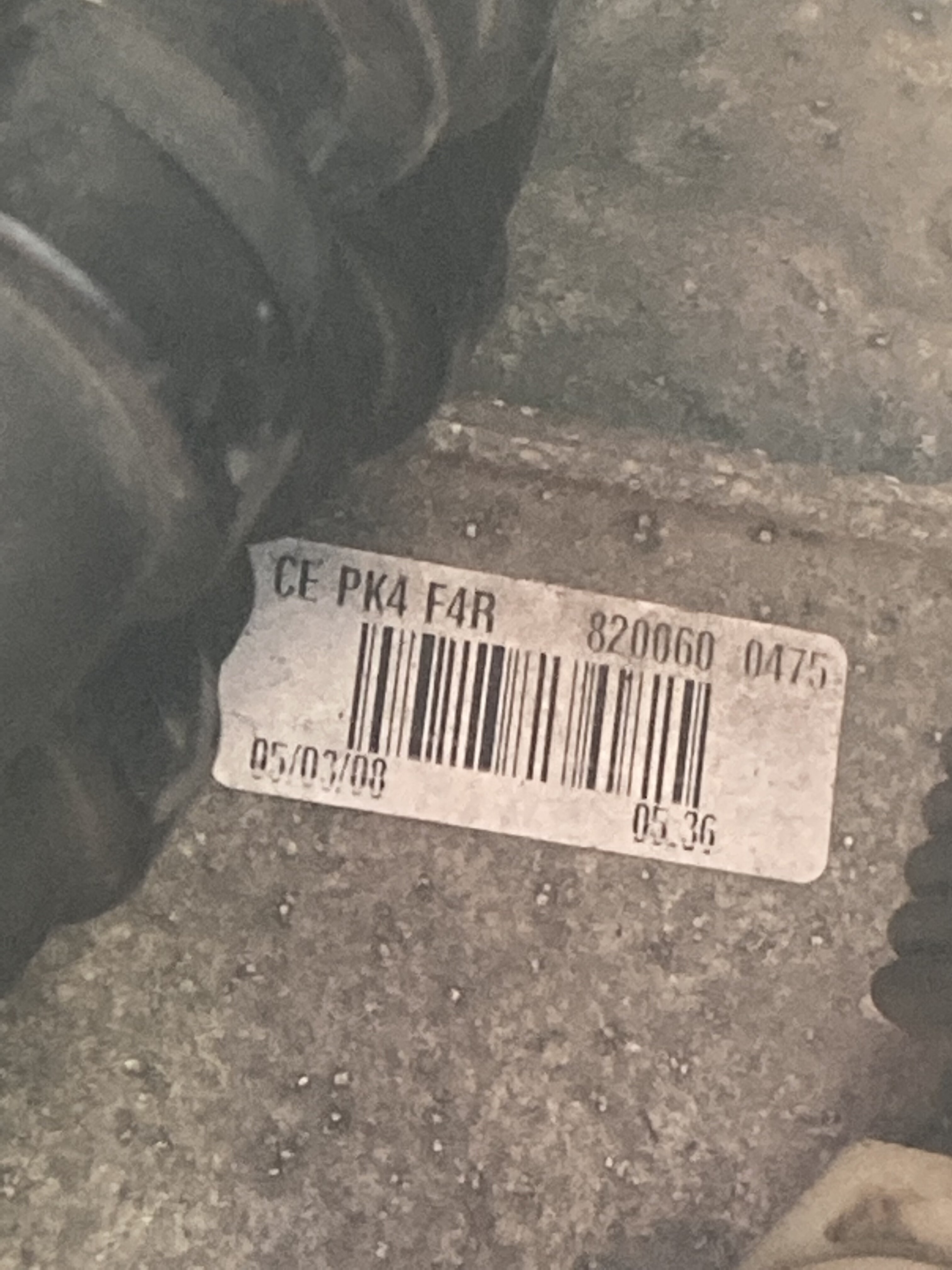

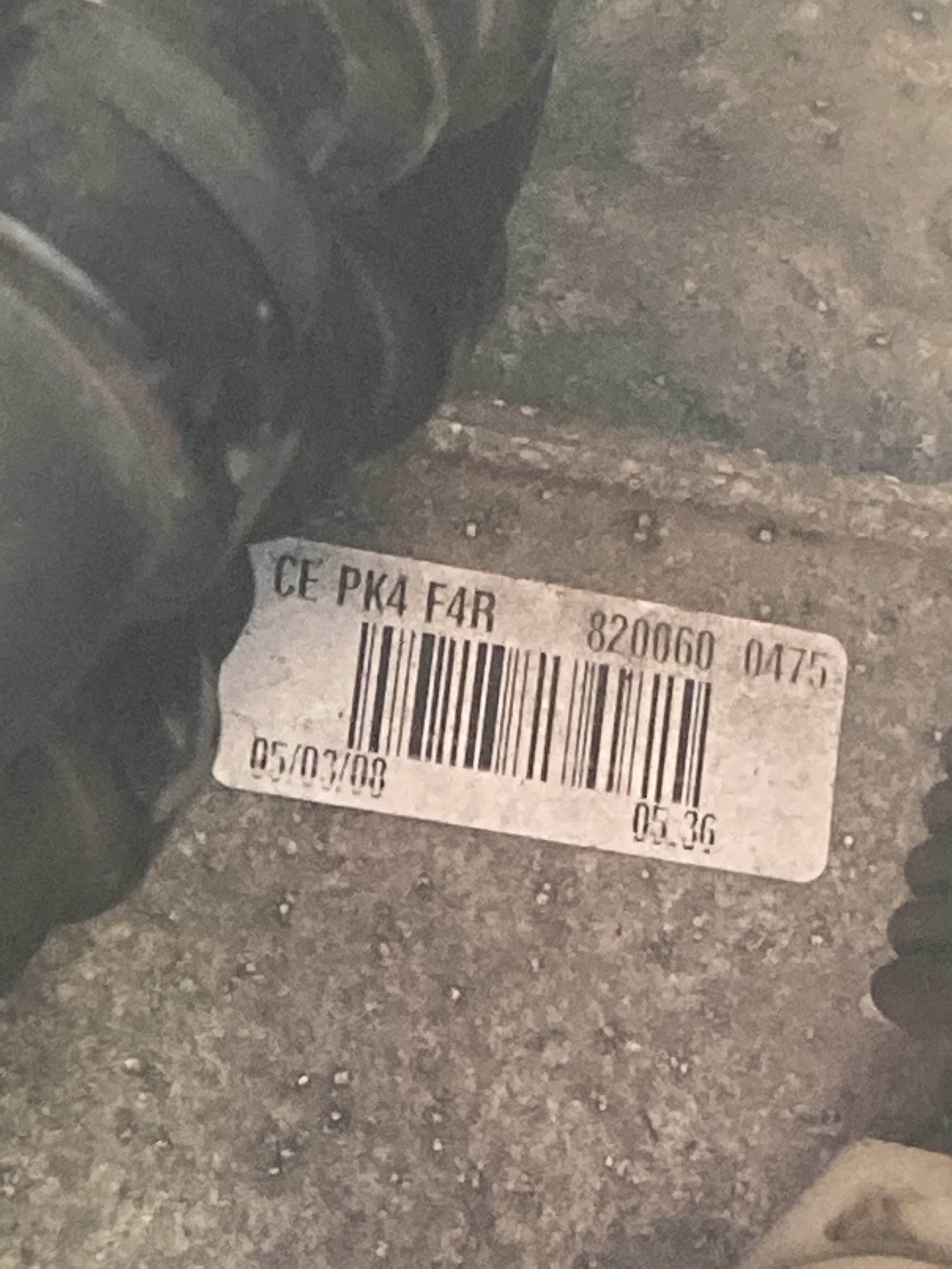

Reckon it's compatible with this? Mk3 Laguna gt, f4rt
250 box should go straight in, in theory. Not sure what the clutch is like for pk4 but cant imagine its much different
