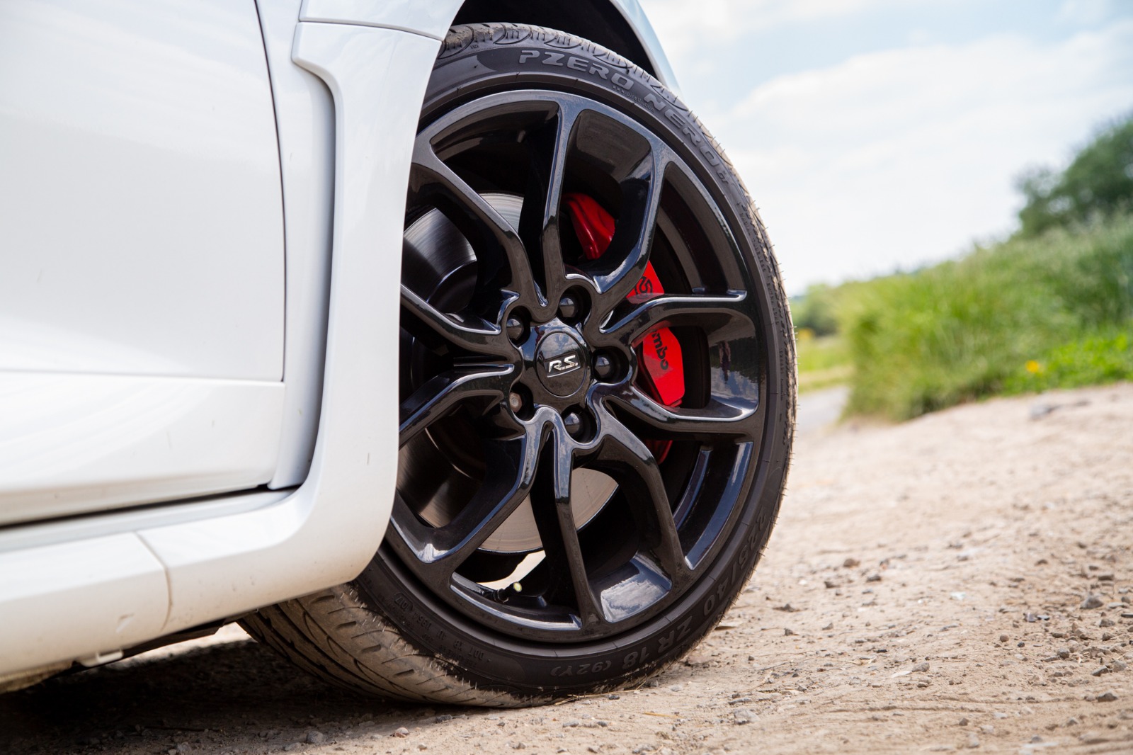

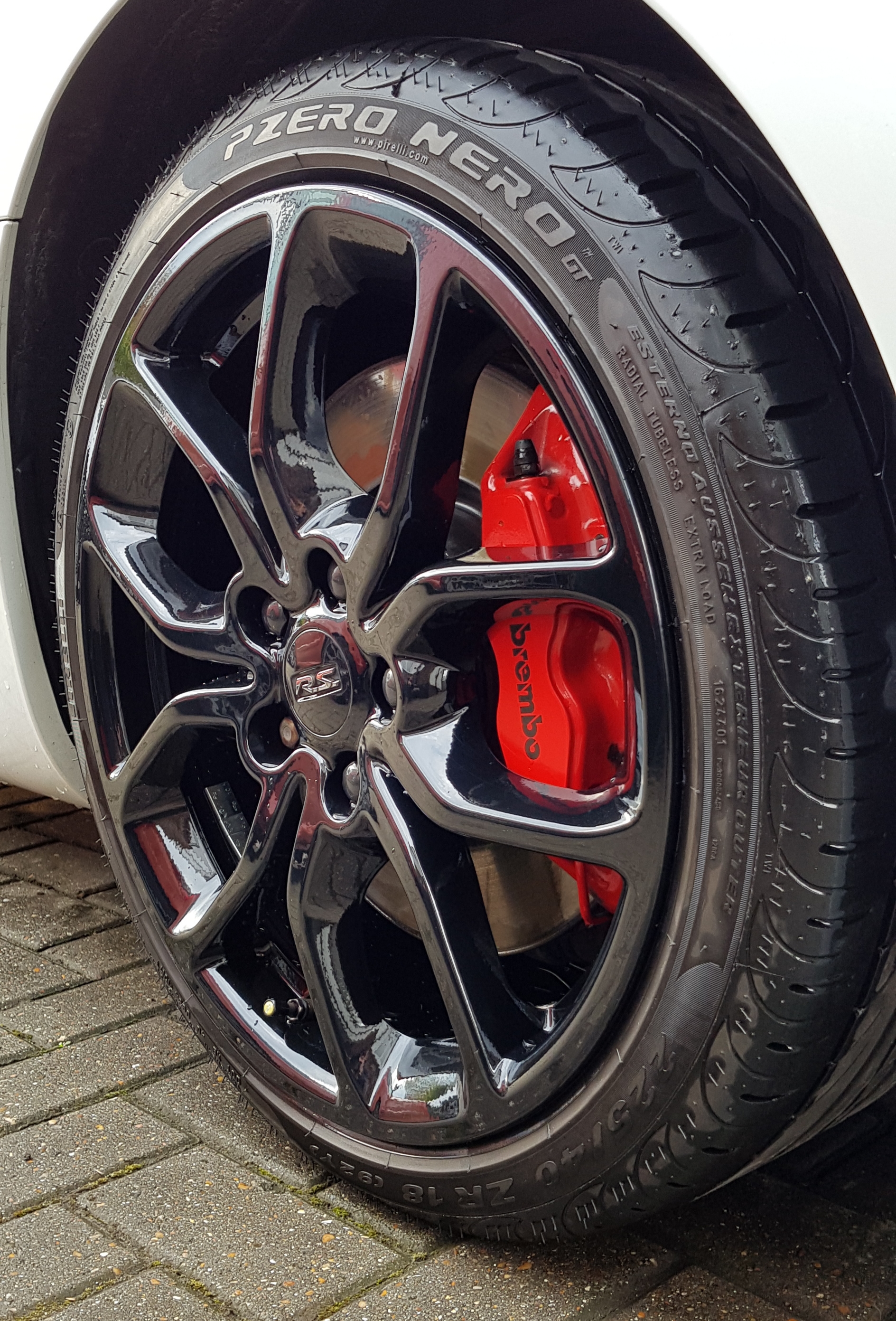

While the Tibors were off the car I decided to get them refurbished. Well chuffed is an understatement!!

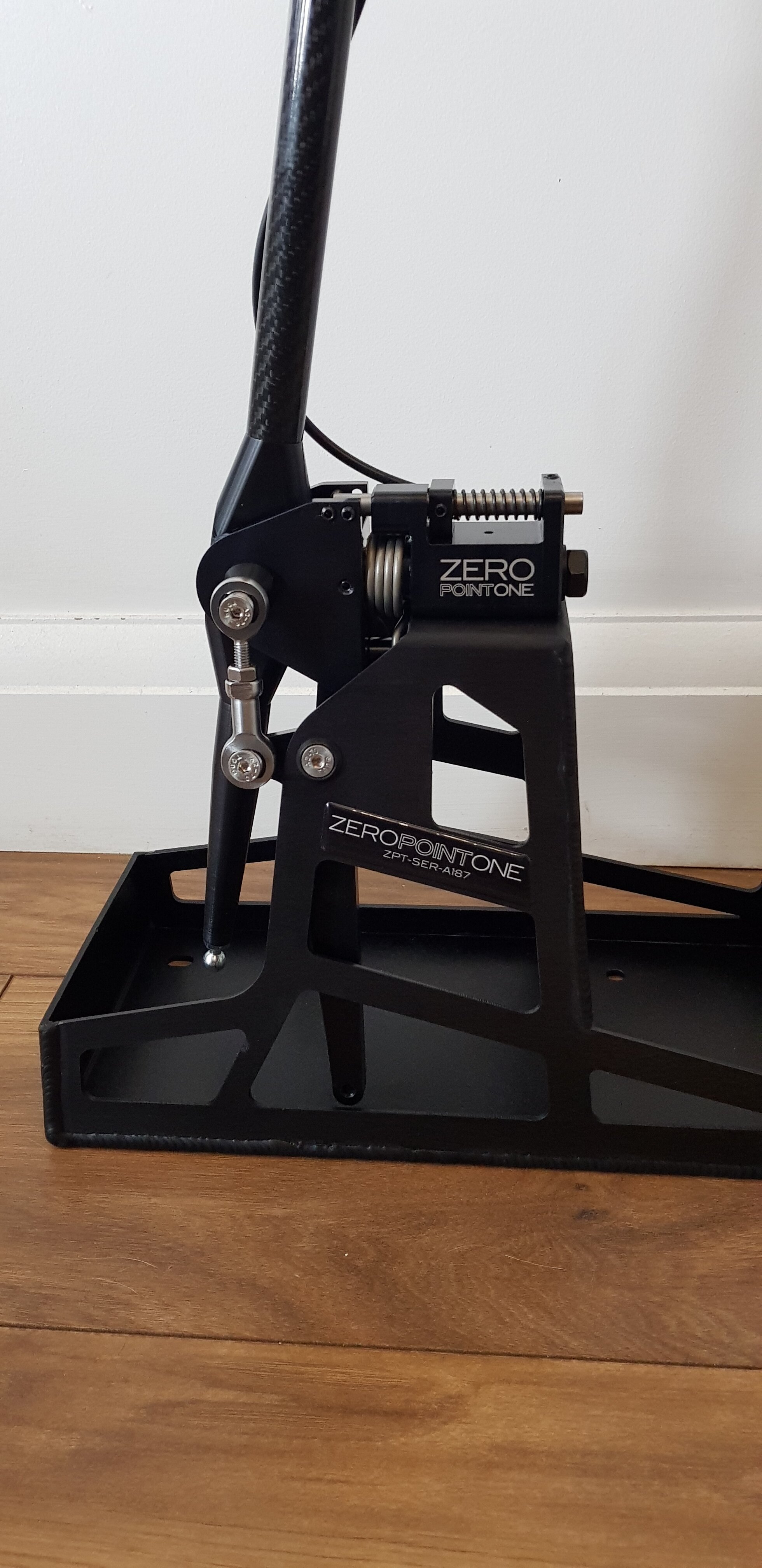

I have also pulled the trigger on a Zero point one shifter after I did some work on another Megane 265 last weekend. It pushed me over the edge. Absolute work of art. The contact from zero point one has been excellent. Soon as it arrives will get some pictures.
Anyway wheels are on 😍 Pretty much decided the track ones will be black too.

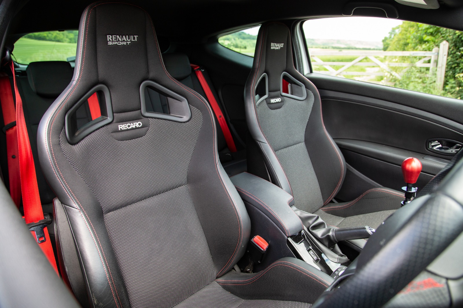

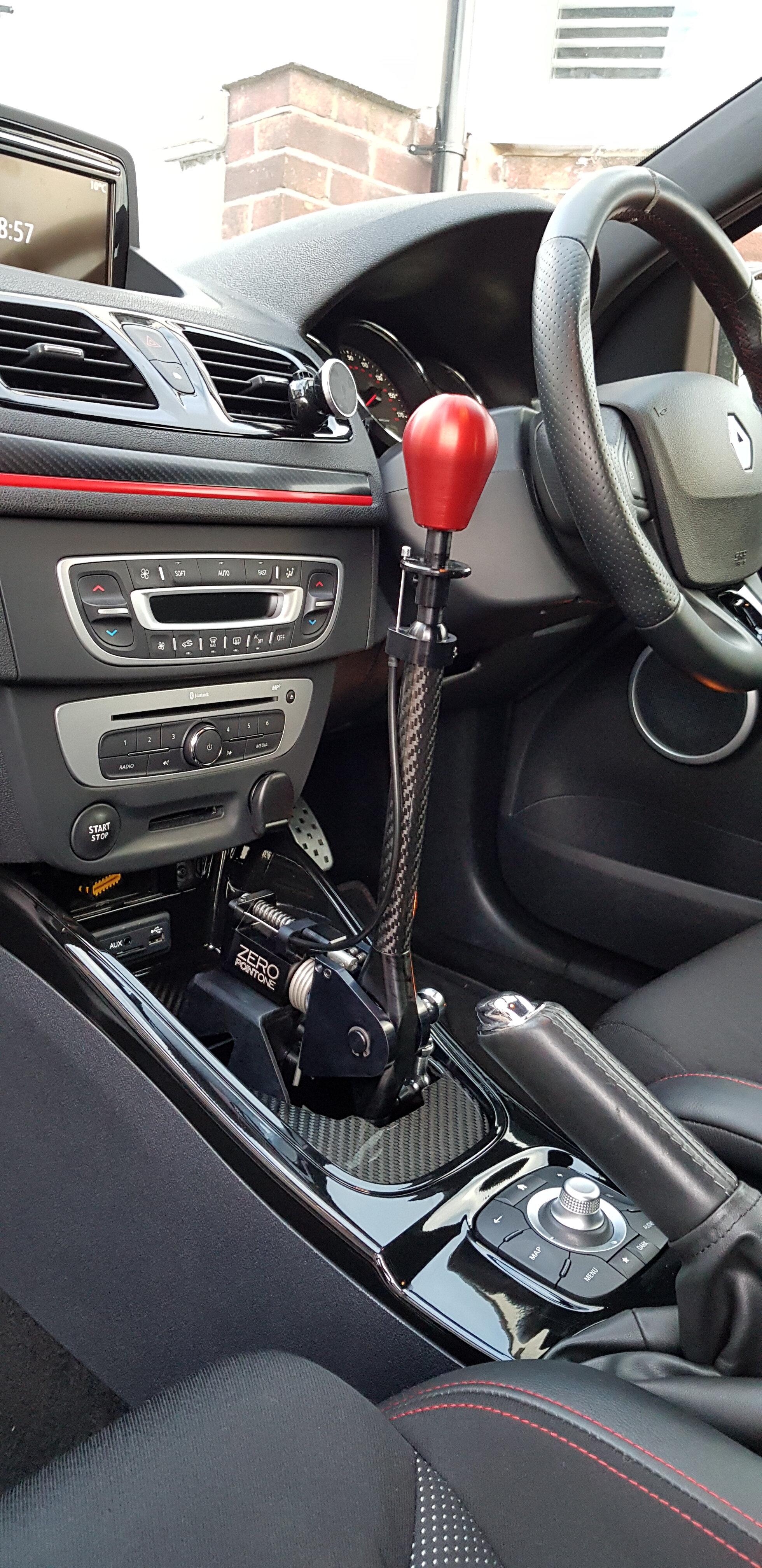

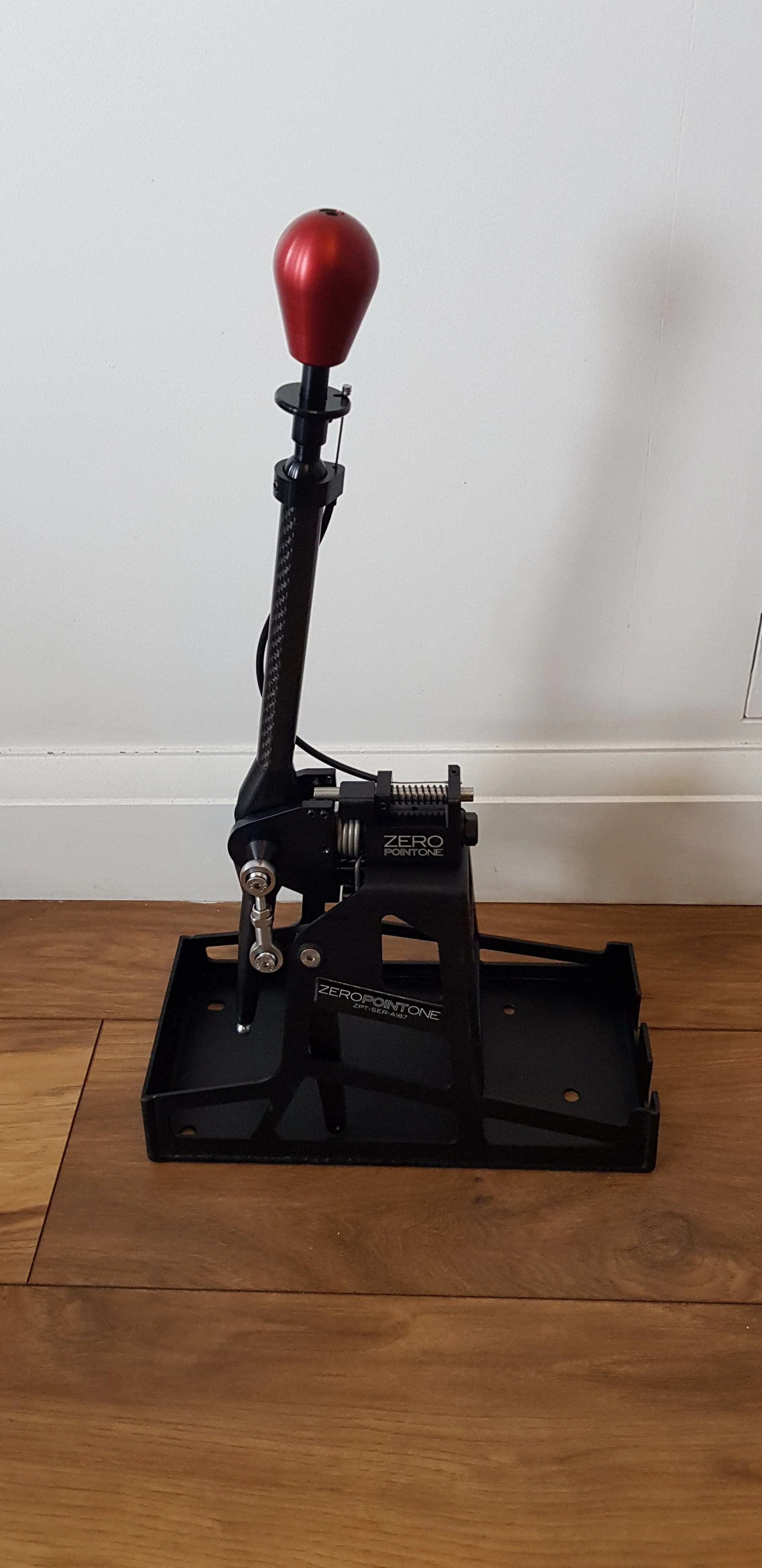

It arrived yesterday 😍 I thought about putting it in a display cabinet it looks so cool! Have found Terry at Zero Point One an absolute pleasure to deal with.
Spent a bit of time yesterday evening fitting it. The most awkward bit is removing and refitting the center console. A lot of people with track cars don't bother with this and must make it much easier! It's all fitted, just need to make some final adjustments before I take for a drive. Will update with fitted pics and first impressions.

I am about to find out 😂 All reviews are really positive. Did a fair bit of research. Been told it transforms the shift and worth every penny so 🤞 Looked at the other options too and always came back to the Zero Point One.

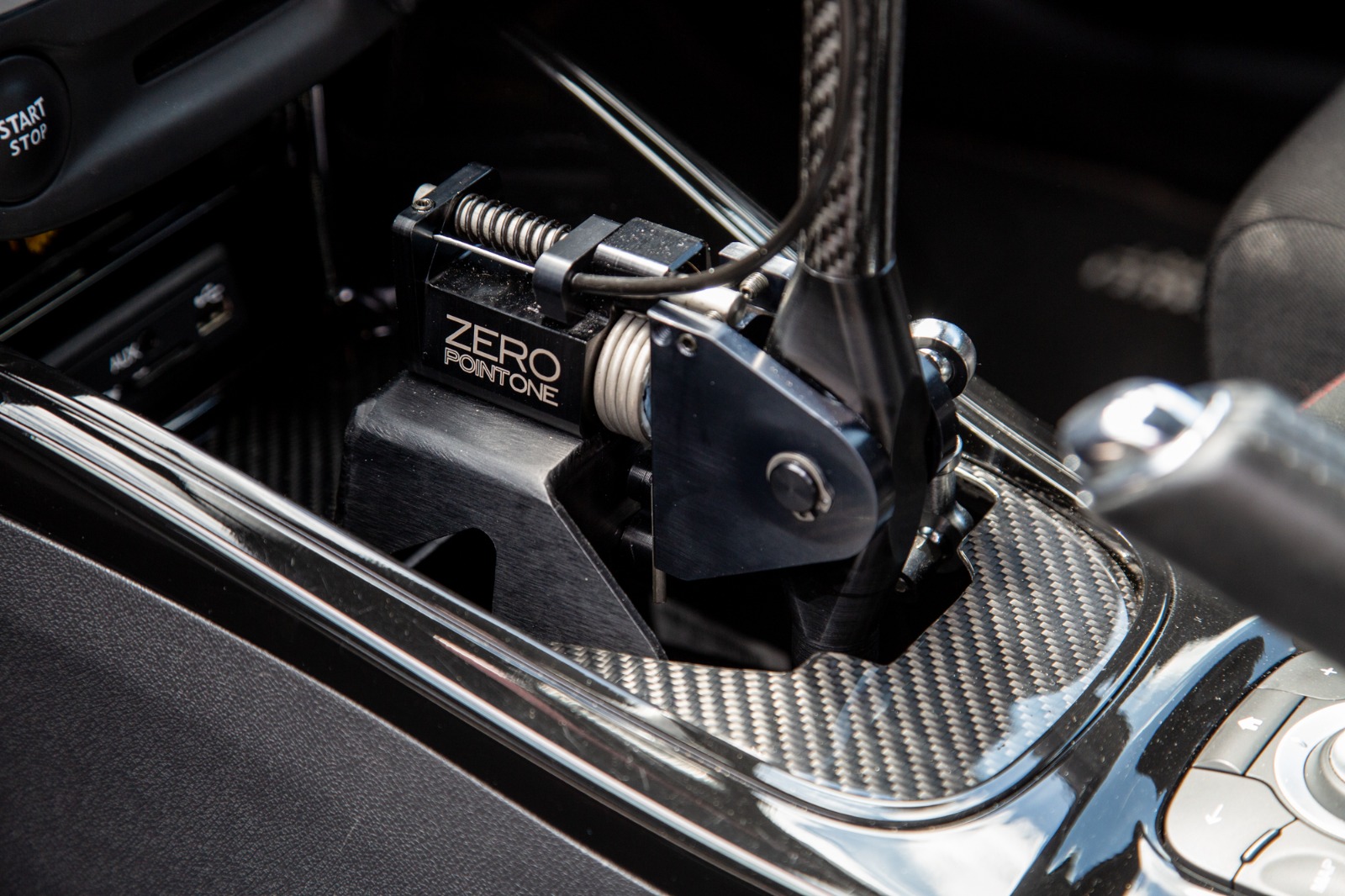

Fitted and adjusted. Been for a drive and the shift is amazing! 3rd to 4th and vice versa is so slick. Will be fine for daily use and looks so good. Was not cheap, but chuffed to bits with it. Can't wait to drive to work in the morning.
How to they work mate?.
The Megane shifter is cable operated, so different to the Clio. I believe the longer gearstick and construction of the shifter creates the feel and shorter shift. I also have a short shift mod on my gearbox too. It looks and feels amazing. Really adds to the involvement of the drive. I can't wait to drive to work in the morning 😂
Zero Point One currently have a Clio 172 track car and they are developing a shifter for it, which should then be a available to buy. I can't fault them, have been excellent.
Drove the car to work this morning. I love the shifter and how it has transformed the gear change. Makes the drive even more of an event! Will see how I get on as I use the car more, but can't see my opinion changing!

The ZPO definitely changes that! Mine has the short shift conversion gearbox side too.

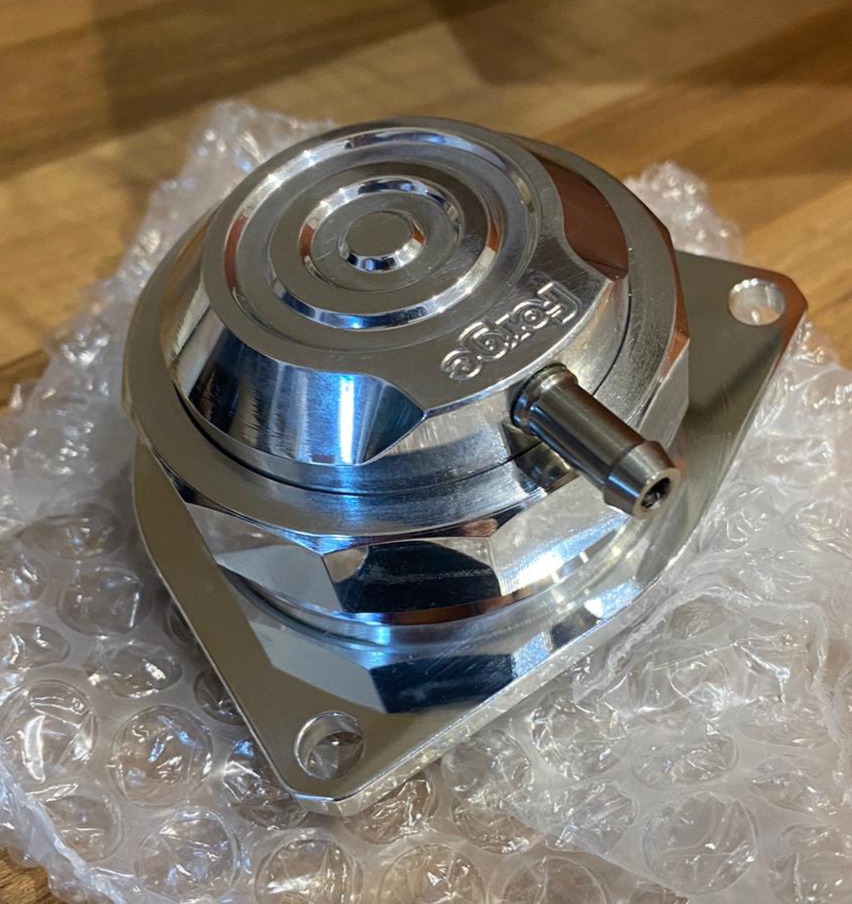

Fitted the Forge recirc valve this afternoon. Delivered to me by @Somnambulist in his lovely Megane RS 275 Cup S. Was a right pain to fit due to there being not much access to the three bolts that hold it on. Anyway got it fitted with the yellow spring. I now get the turbo chatter sound low down which I love! All the mods I wanted to do on the car are now complete so just need to book in for mapping at RS Tuning and book some track days 😁

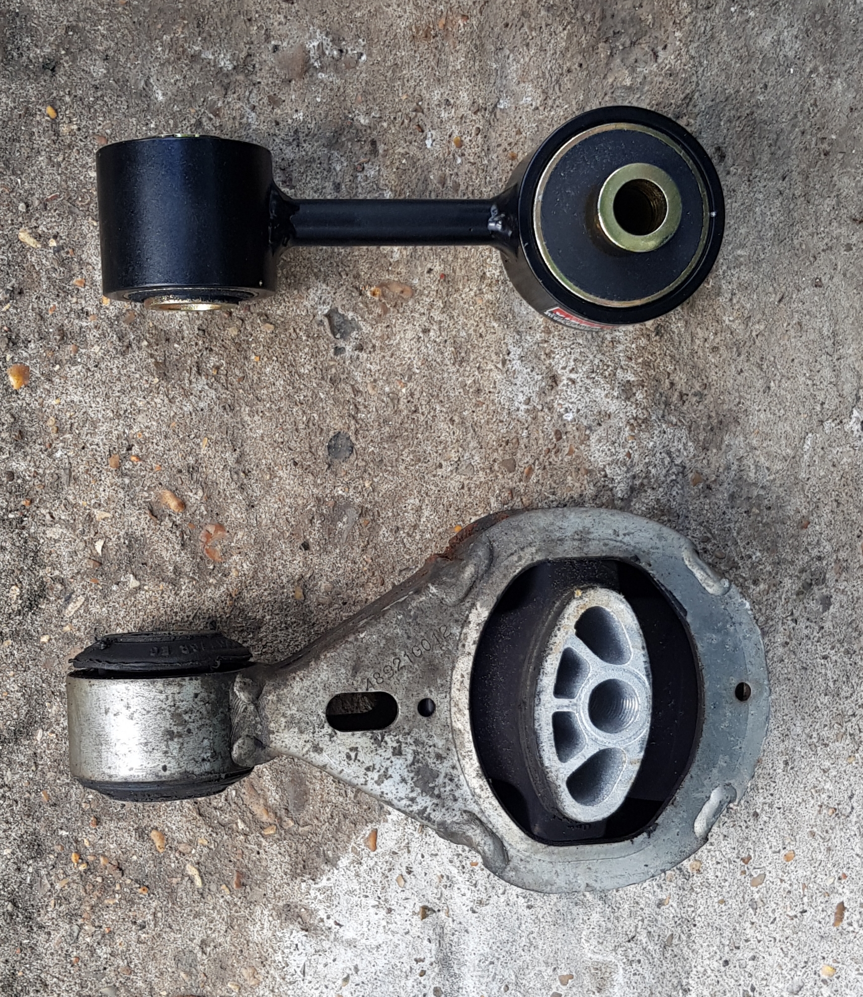

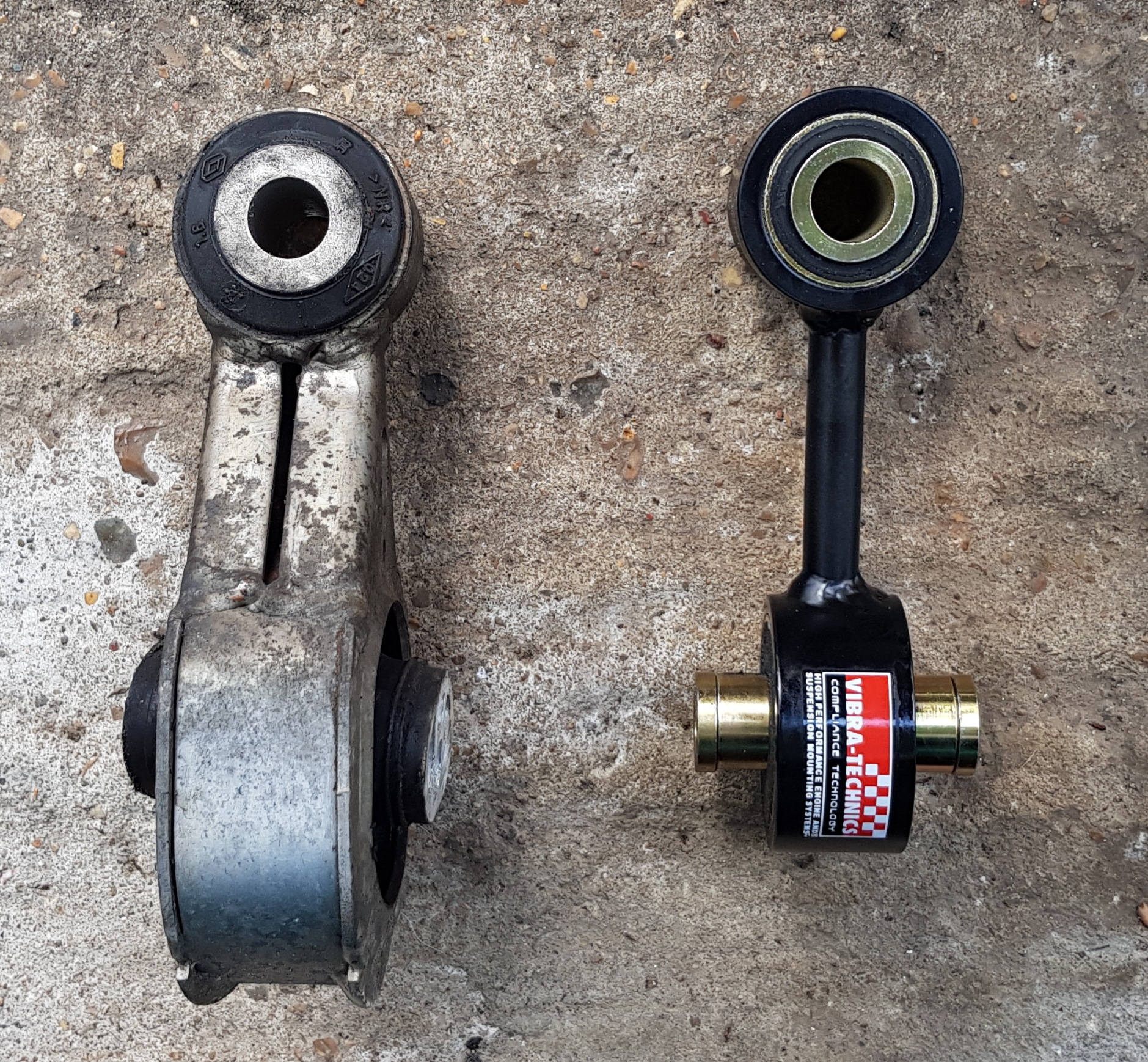

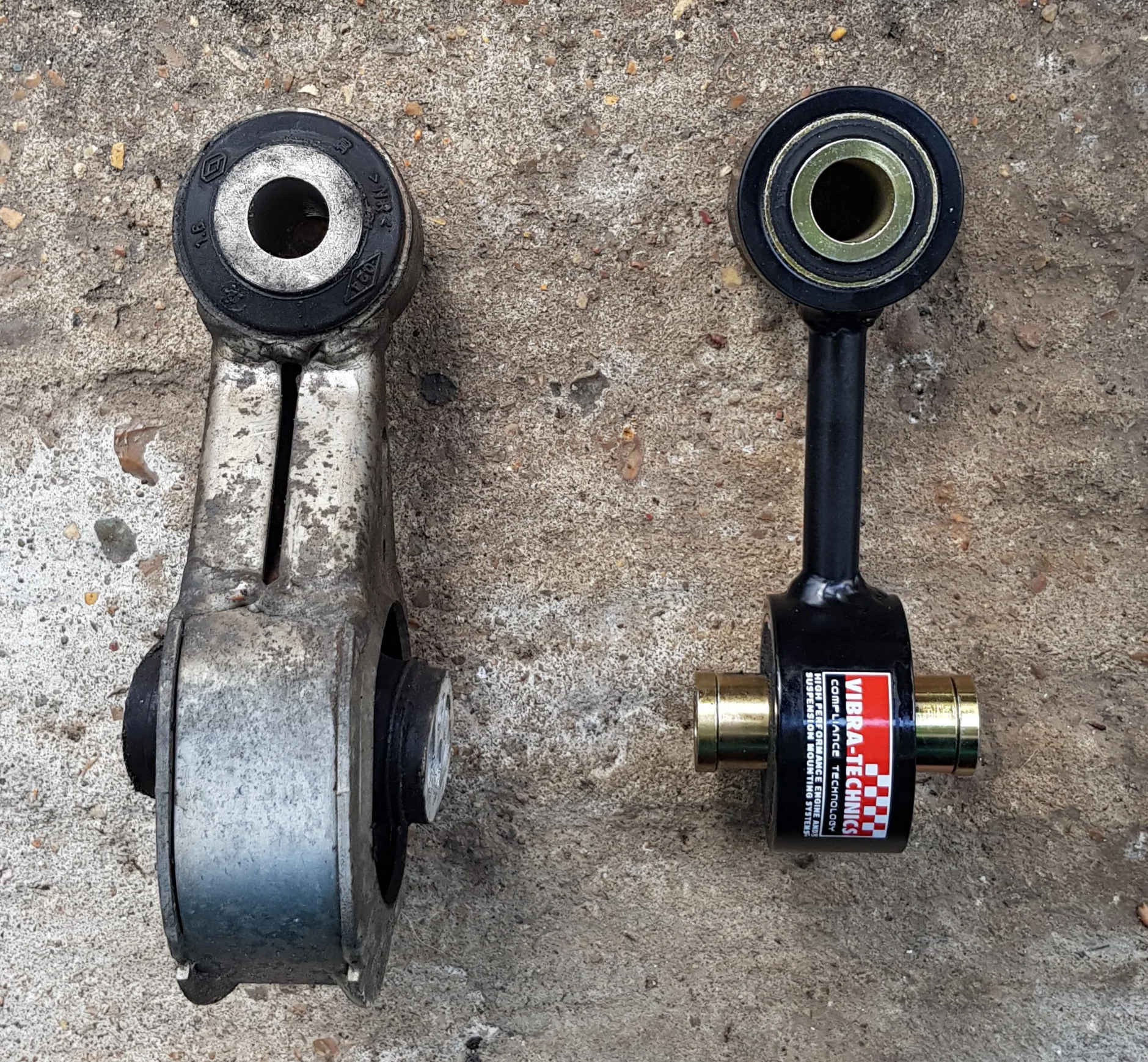

Been meaning to get a uprated lower gearbox mount for a while. Had a look on ebay last week and with a voucher I had 20% off so ordered a vibratechnics one. Got round to fitting it today and did not realise how much movement there is in the standard one! Got it fitted and will see how it is on school run in morning!

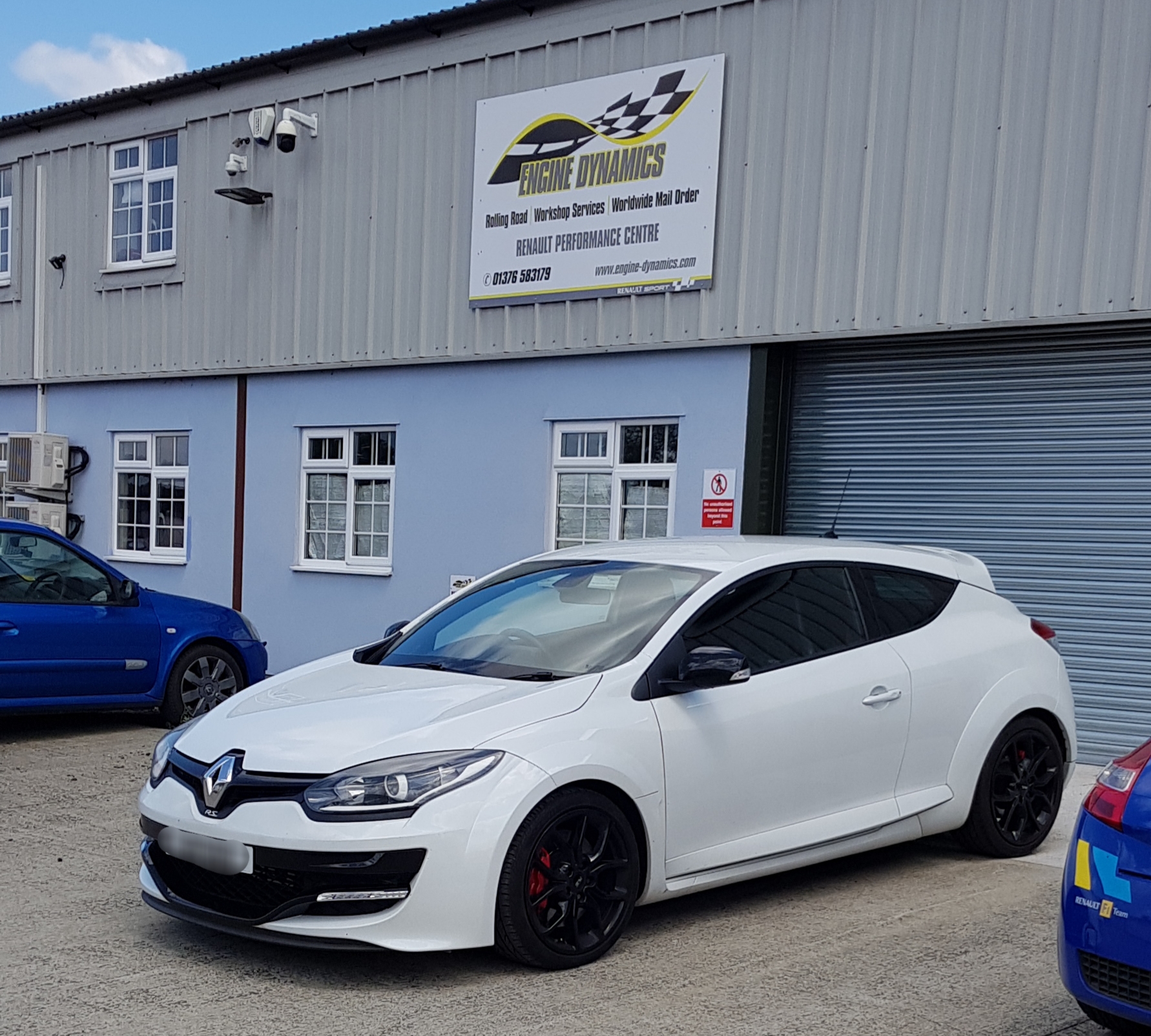

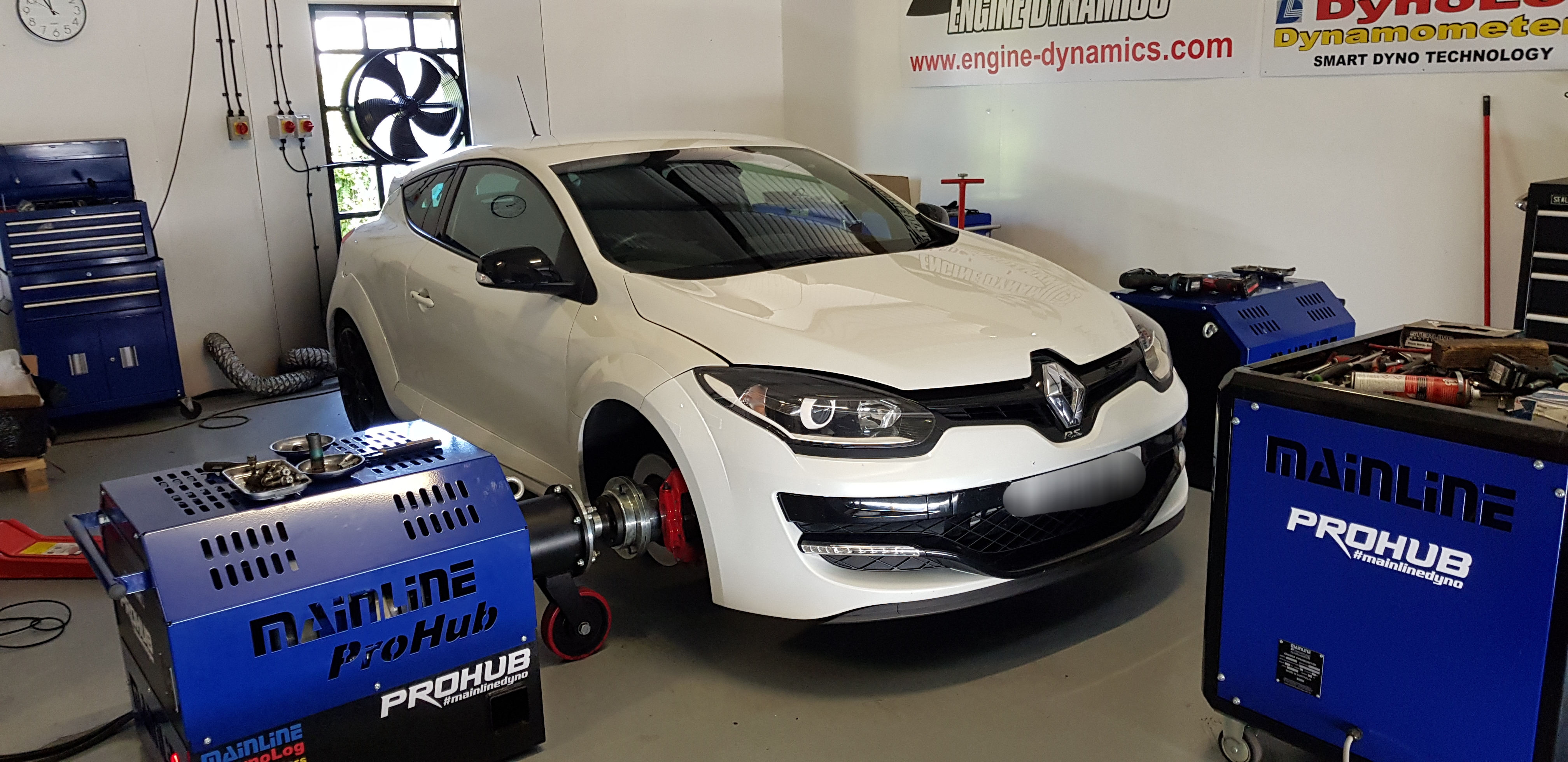

So today was mapping day. First time I have ever taken one of my cars to be mapped on a rolling road and I can't lie, I was quite excited! Before setting off I had checked the car over and filled with a full tank of Shell V-power, as that is what I normally run. A couple of the rocker cover bolts were weeping oil, which is fairly common on the Megane. Easy fix though as you remove the bolt, clean and degrease then reseal. Engine Dynamics are really busy so had to wait a couple of months for this slot and didn't want anything putting a halt to it! I was up nice and early for the drive to Colchester, Essex as was a little worried about the morning traffic.
Got to Engine Dynamics an hour early. Quite an impressive looking unit with various Renaultsport cars parked outside. Spoke to Andy on arrival who was friendly and welcoming. He was all ready to go so no waiting around. Had a chat about mods and my expectations.
In terms of modifications this car is almost identical to my grey RS 250, apart from decat which is a route I don't want to go down with this car. My old car was 321bhp/360lbft. In my head I thought a realistic figure for this car was 310 - 320bhp/330lbft. The main thing I wanted was safe fueling and reliability. One of the reasons for having the car mapped was to make sure everything is working as it should.

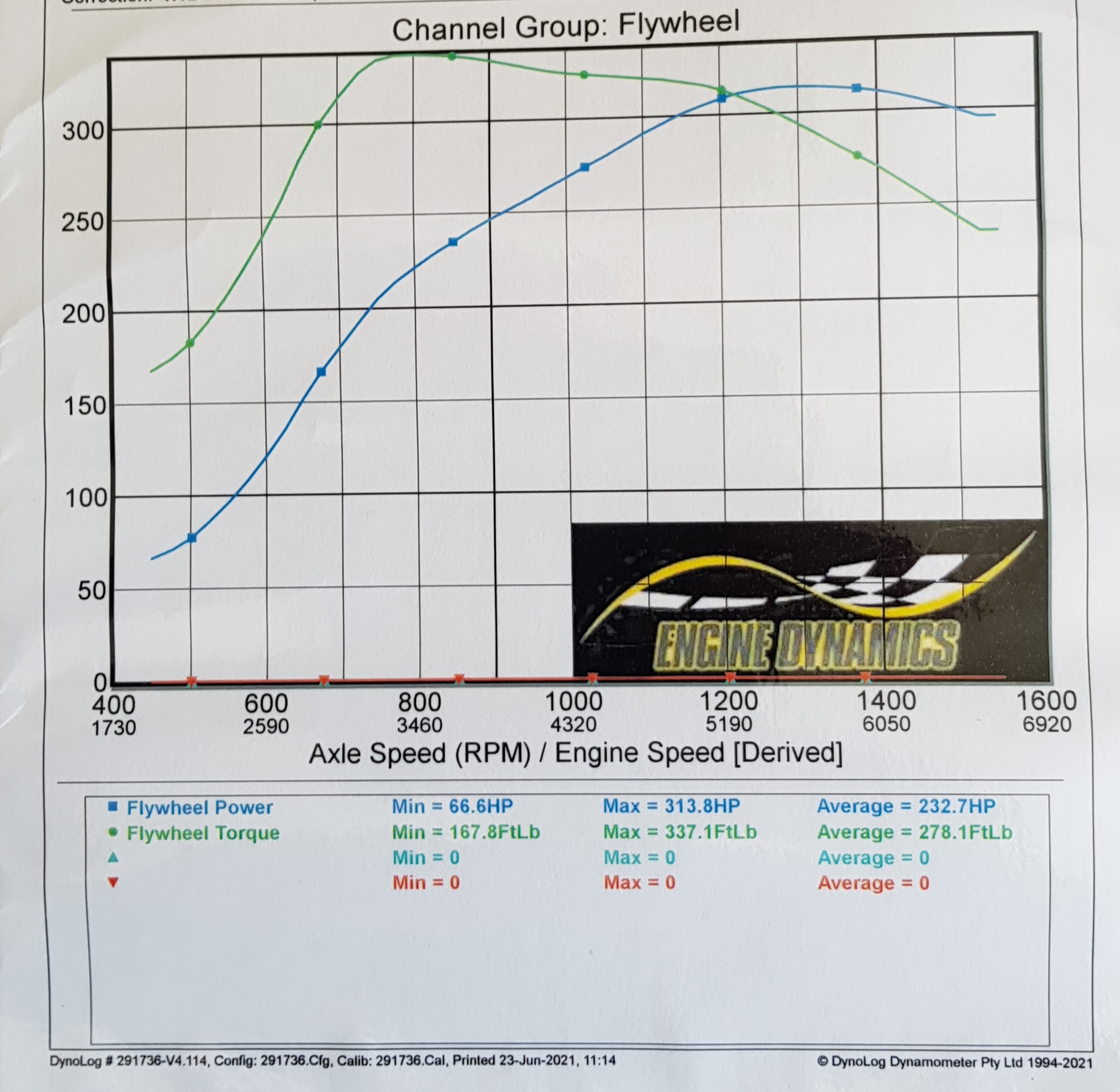

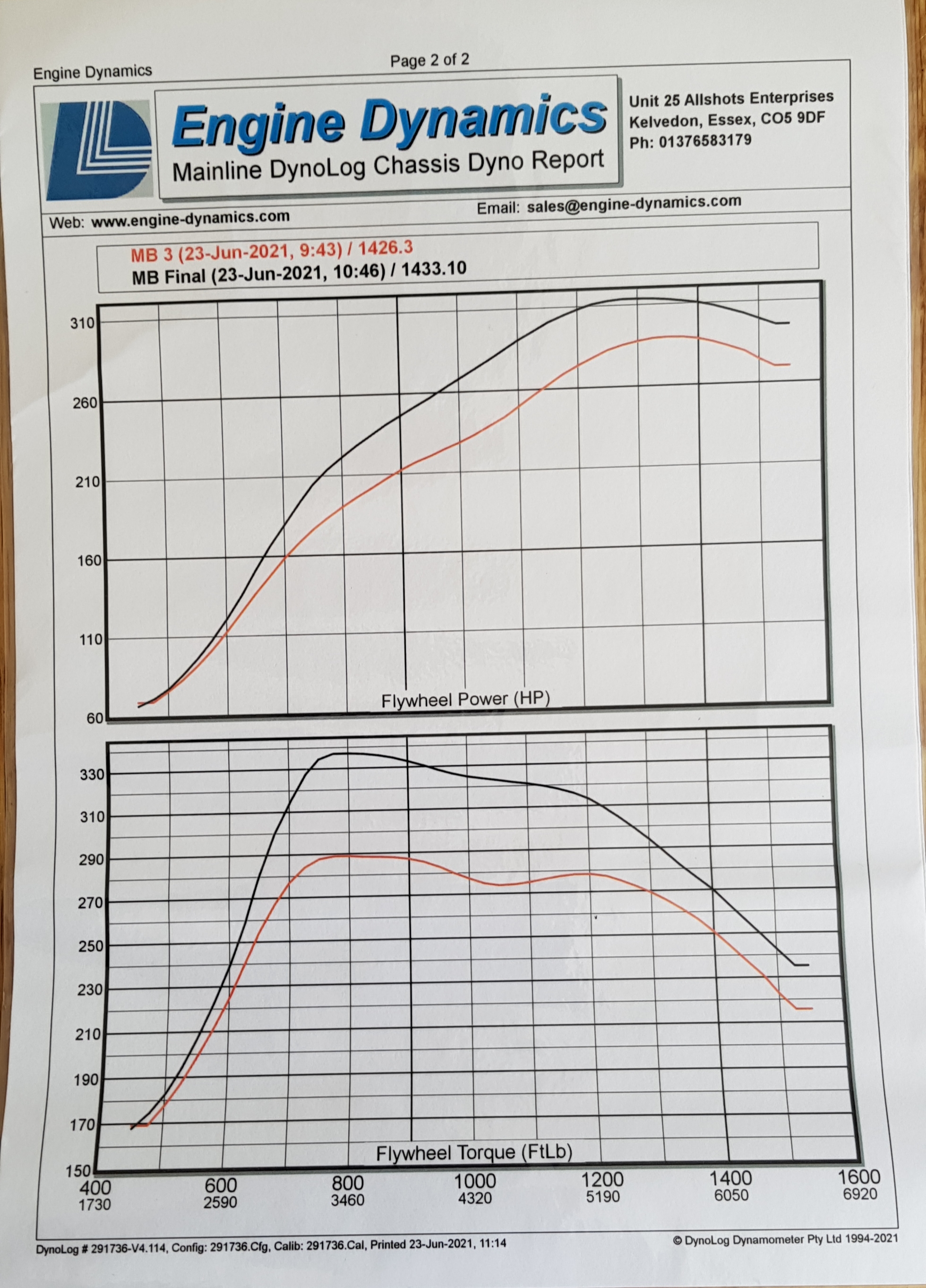

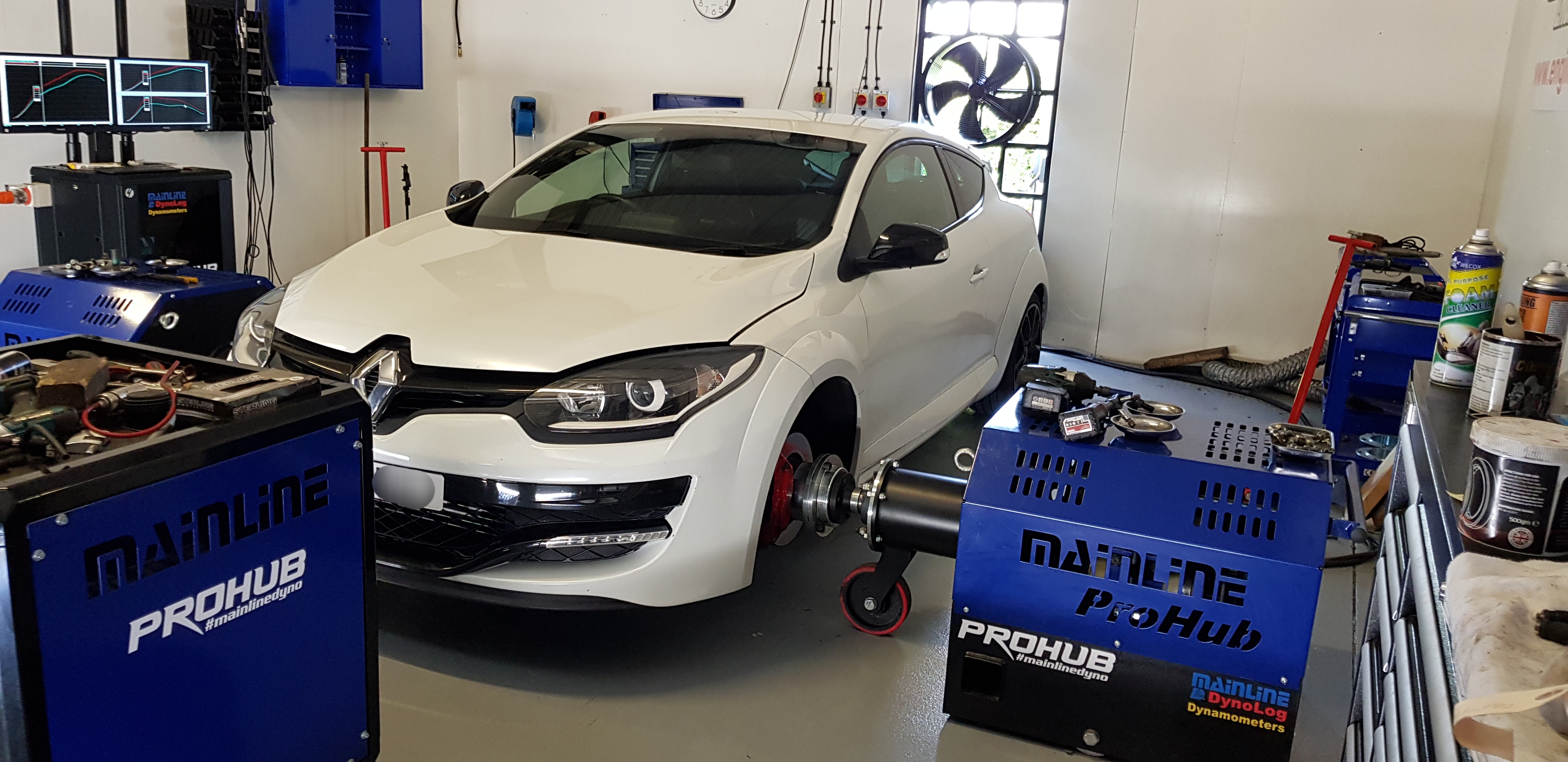

The dyno they have is a Pro Hub one that bolts directly to the car, so slightly different to a conventional dyno. First run done to check all was running correctly and see where the car was at. The previous owner said there was a generic 300bhp map on the car, which there was! I had said previously I thought it went well. Car was 288bhp and 280ftlb. Not bad really and all appeared well. More to be had though. Further discussion was had around figures and expectations, then Andy set to work his magic.
Further runs and tweaking to the map car made 313.8bhp and 337ftlb. Pretty chuffed with those figures, but main thing would be how that translated to the road. I knew the difference would not be as big as if the car had been standard to start with, but the torque figure was pretty impressive. Car was all finished by midday and then time for the drive home 😁
It did not disappoint!! Car feels so quick and pulls hard all the way to rev limiter. It's almost too quick for the road if that makes sense. I understand it will only go as quick as your right foot allows. It makes you want to push on and this will be perfect on track and early morning blasts, which is what the car is for. It is such a capable car. I do enjoy using it as a daily too though and today it has managed all mixture of driving. It does behave low down and easy to drive in traffic. So chuffed I have had it done. Need to get a track day booked at Brands Hatch just to give it a first run out and then further afield.
A really good day and very impressed with Andy at Engine Dynamics and the overall setup he has. Found him very knowledgeable and open to suggestions. I would certainly have no hesitation in recommending him after my experience today.
