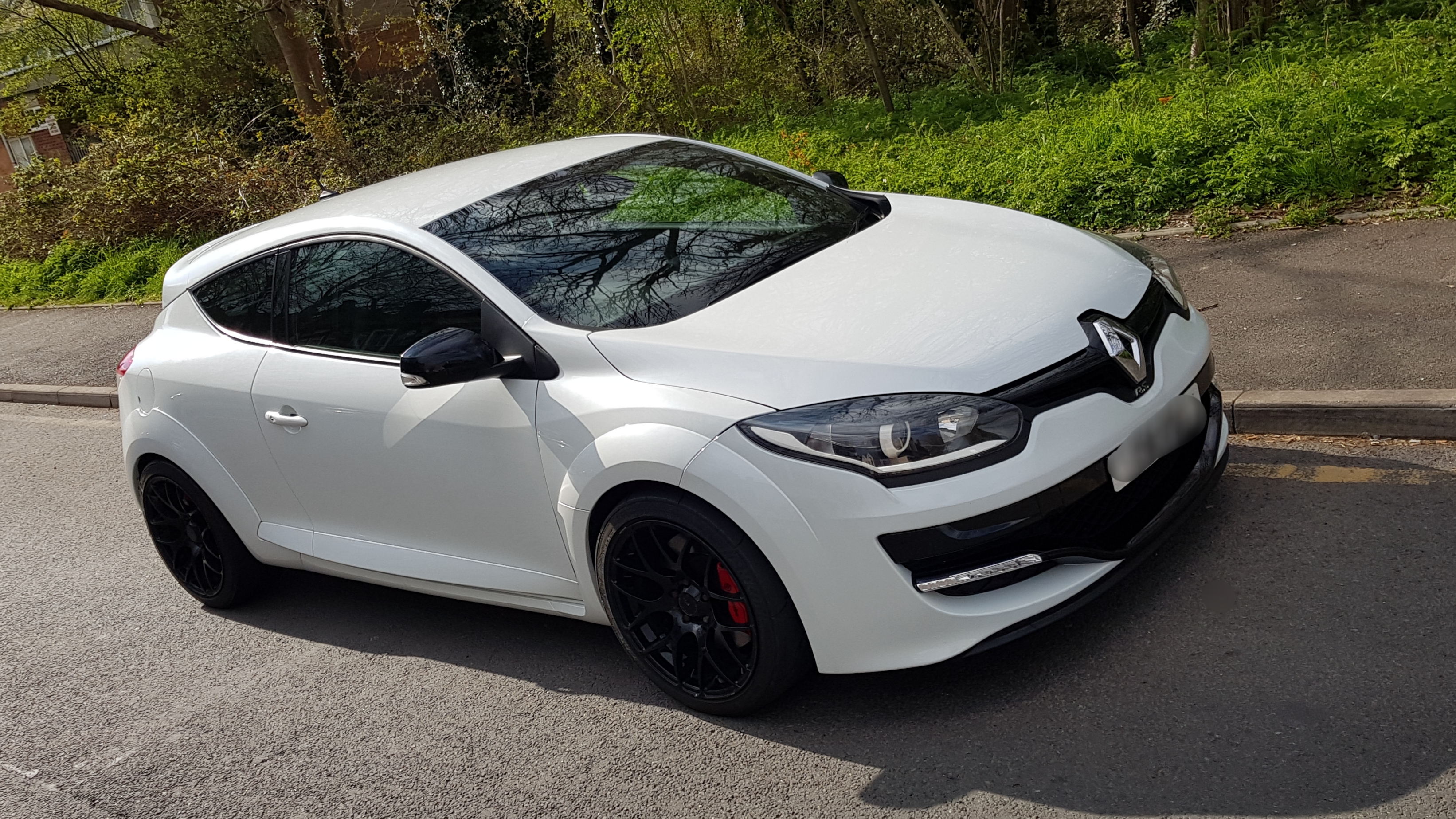

Well started cleaning the car today and got a bit carried away! There were loads of small iron and tar spots on the car. So started with a jet wash and clean. Then auto finesse iron out and jet wash. Followed by auto smart tardis and jet wash. Followed by a further clean. I had a bilt hamber clay bar so did the whole car and once finished I had managed to remove about 95% of surface imperfections.
Further clean and jet wash. Time was getting on a bit at this point and it was quite cold today. I wanted to get some protection on the paint so put a coat SRP on. I will at some point machine polish, but once it warms up again. Will give a coat of wax tomorrow and hoover out the interior. Really pleased with the results though. Paint is so smooth and slick once clay bared. Artic is a lovely colour too. Quick pic before it got too dark.

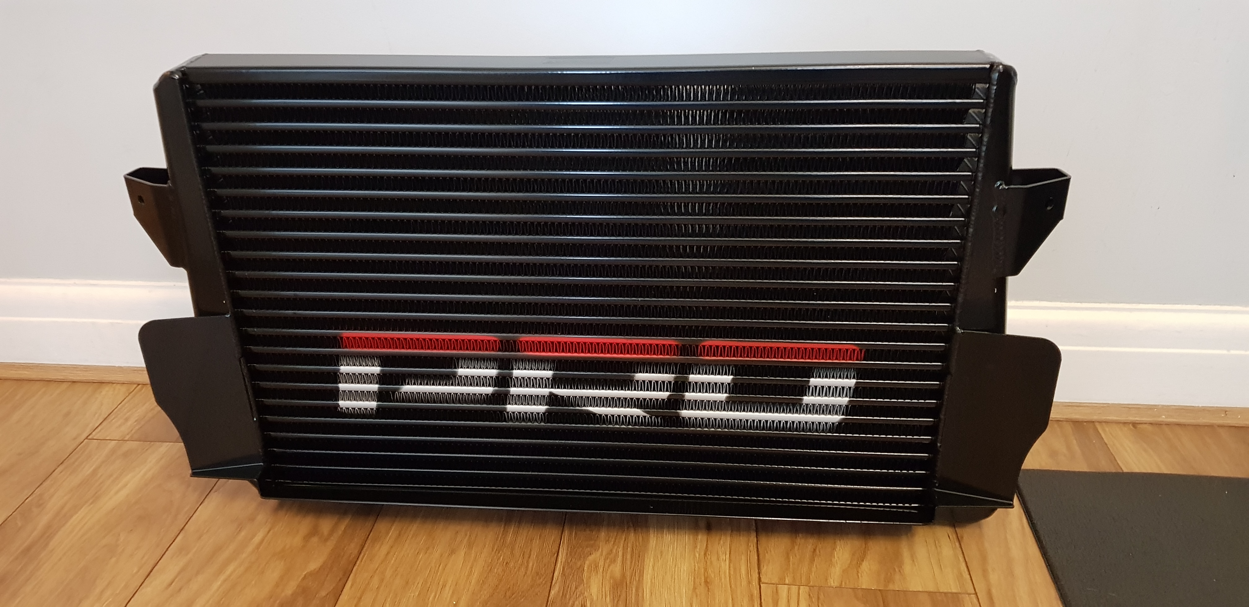

Thought I should open my parcel and check all was good! On initial inspection looks really well made and I wanted one with the Pro logo on the front as looked subtle, but smart on my last Megane. Hope to fit along with the turbo cooler this week. Will update with pics during fitting.

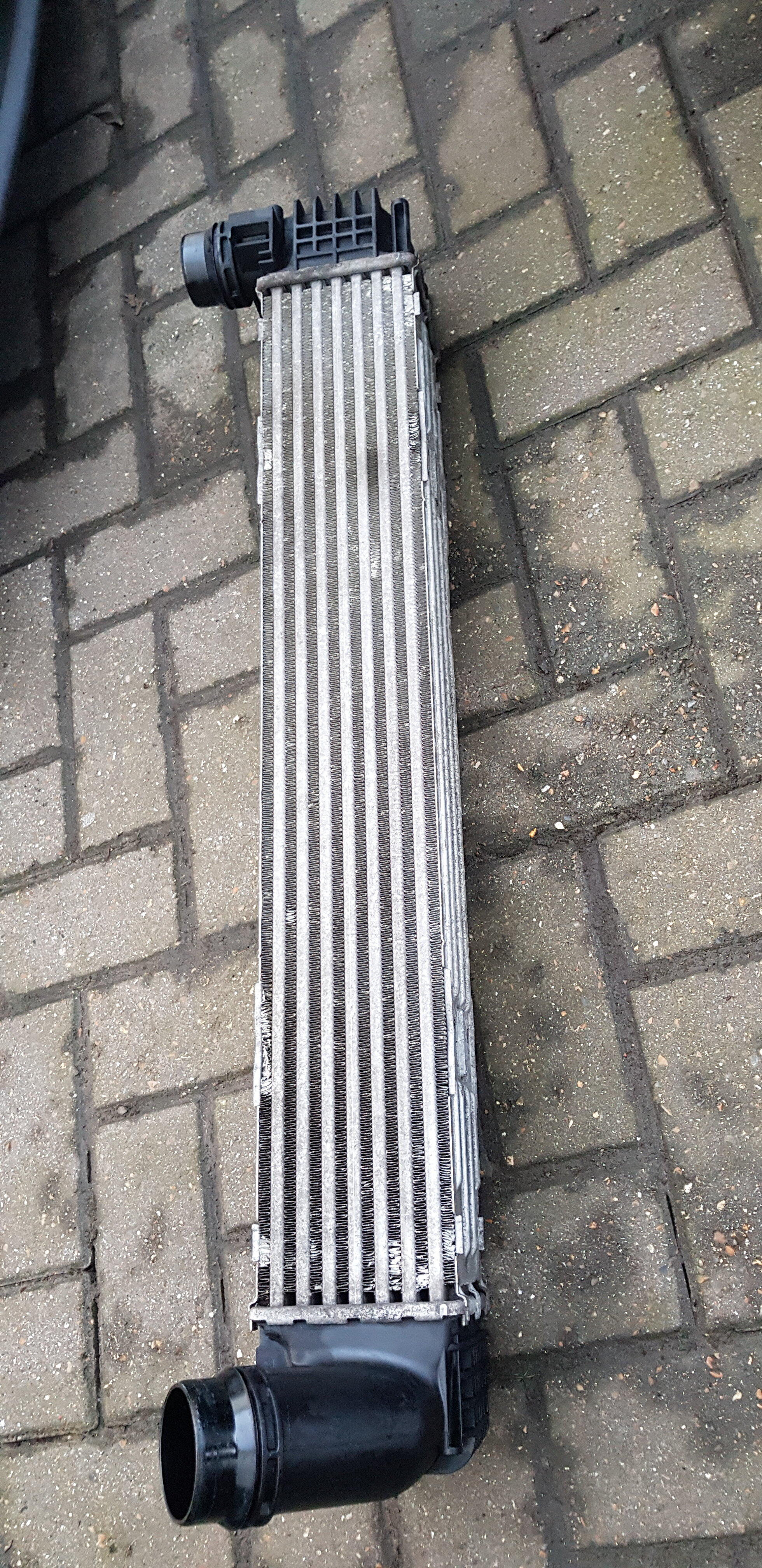

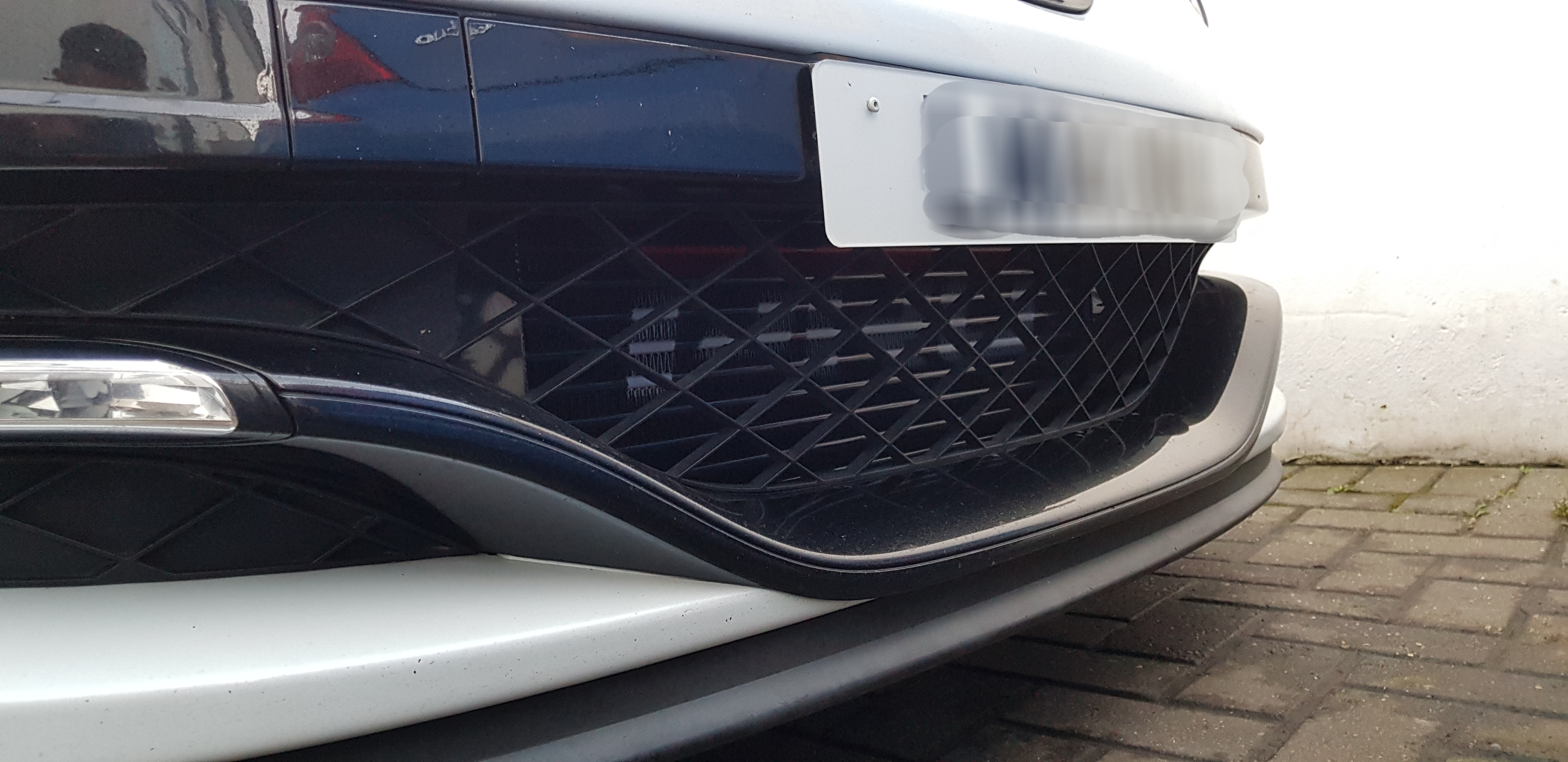

Finally got round to fitting the intercooler and turbo cooler yesterday. I didn't realise how small the standard one is! I was rubbish at taking pictures during the fitting and was dark when I finished last night.
Took my time to make sure the coolant pipes down to the cooler were routed the best way. To get best access to the turbo pipes I removed the scuttle panel. To fit the intercooler the bumper crash bar had to be removed to give sufficient room.
I was so impressed with the quality and fit of both the intercooler and turbo cooler. It has been really well thought out and made. They do give instructions to cut down the original plastic ducting to the radiator, but looking at the facelift bumper design, this imo would be pointless so didn't bother. The kit comes with a modified horn bracket as the new intercooler leaves very little room!
Took for a quick drive last night and checked everything. Let the water level settle and topped up this morning before driving it to work. Well pleased.
I am going to see about booking a mapping session with RS Tuning soon as possible. I will discuss with them if it is work getting an uprated recirc valve or if the standard one will suffice. Just my braided hoses left to fit now.
Old cooler...

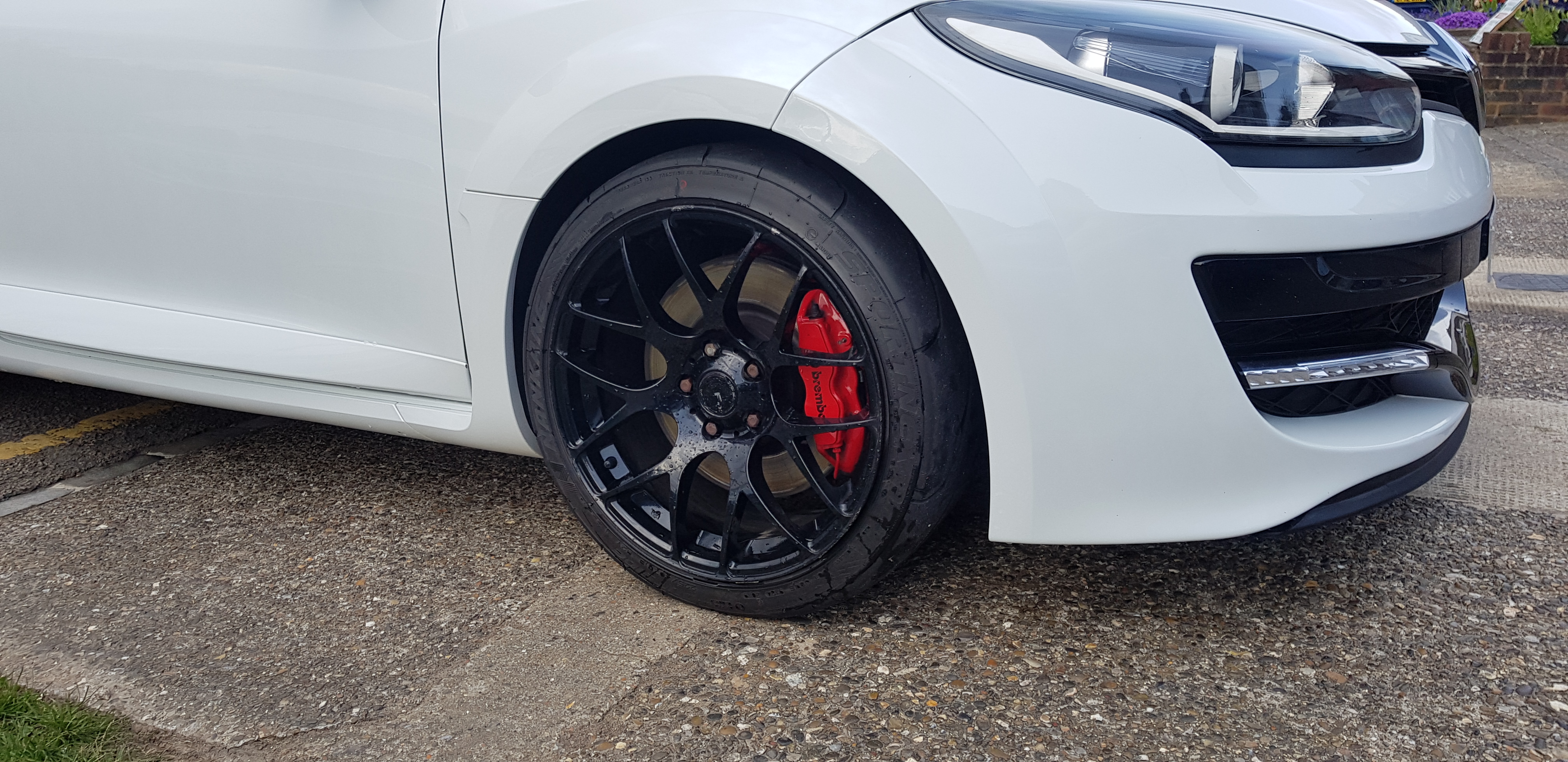

Not updated this for a while. Still love it! Only use occasionally as got another car to stick miles on for daily duties. Purchased some track day wheels this week. They are BK Racing alloy wheels, offset of ET40 and fitted with almost new Nankang AR1's. They are in fair condition and perfect for track days. I test fitted them today and all good!

They are 18 x 8.5, ET40 fitted with 225/40/18 Nankang AR1's
Thanks, how do they sit against the arches? Any side on pics? Just would be good to know for when I order my wheels to make sure the right width and ET.

They sit pretty much perfect in the arch. Any more and they would be outside the arch. Will get you some better pictures 👍

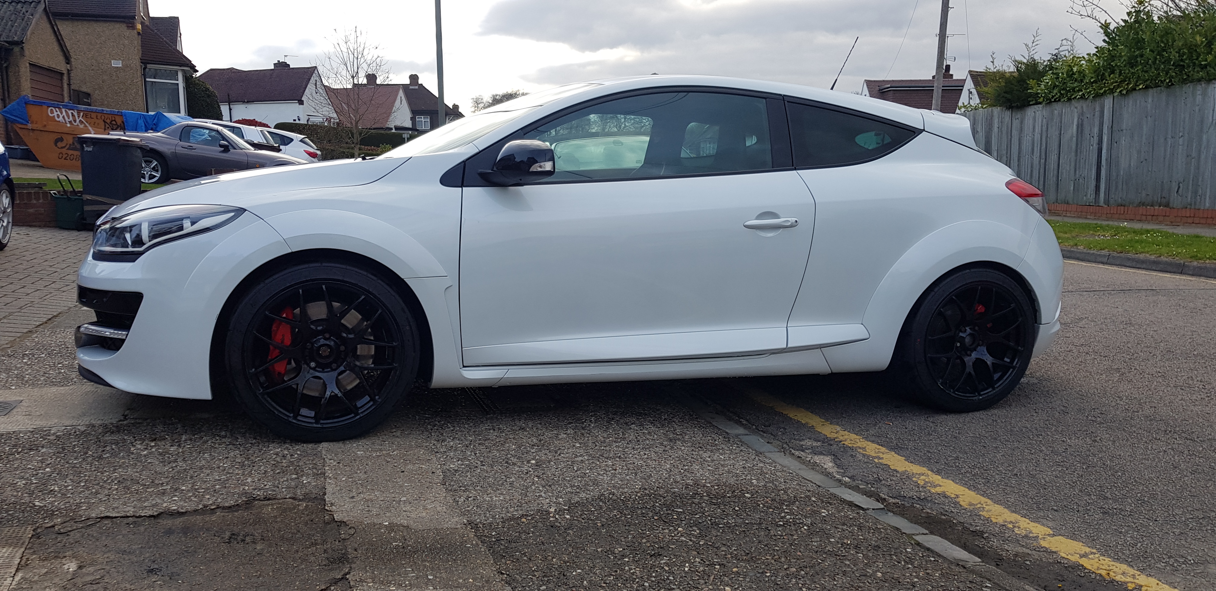

Took the car for a drive earlier with the track wheels on. Felt great. I would not want to use them on the road all the time as a bit noisey and I don't reckon they would be too clever if it decided to rain. The suspension settled a bit too so got a quick picture when I stopped at the shop for some beer! Hard to show how well the wheels sit, but they are pretty much perfect. My mate has suggested getting them refurbished in anthracite, but I am not too sure!
