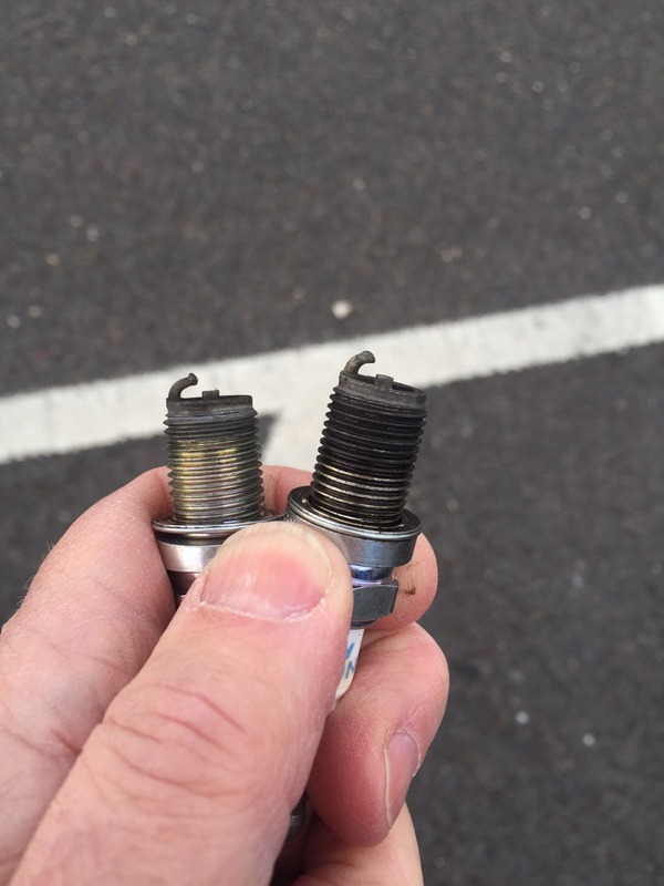

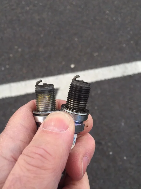

So trackday at Donington yesterday, did about 30 mins epic running, then misfire, P302 (should be cyl2) on Scanguage.
Pulled everything apart, fitted new leads/coilpack off a friends Cooper S, same problem, pulled pugs out to be greeted by the following:
Cylinders 1>2>3>4 left to right.

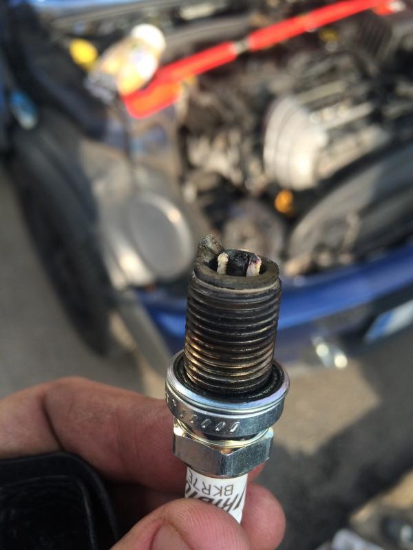

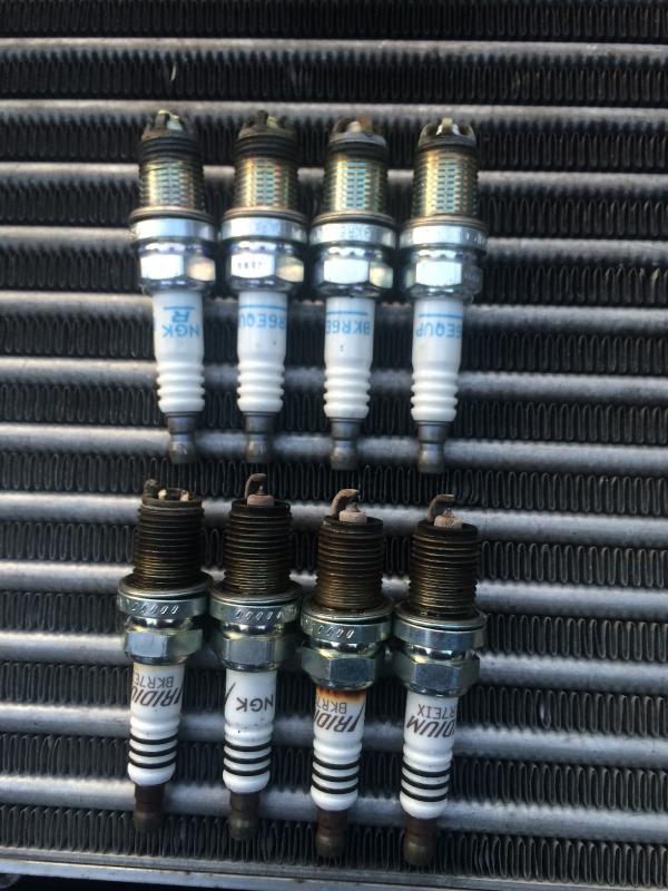

Bottom set had been in 12 months or so and are the first set we took out. Plug in cyl1 had melted (weird how scanguage gave the wrong code?), assuming due to overheating through lack of fuel? Car was running fine up until the misfire, but IATs were rising up to 50°C just before the issue occurred, which seemed pretty hot?
On the 2nd set from Halfords (all they had), the car was epic for 15 mins, then same issue again, plug in cyl1 had melted causing misfire.
Car is running newman cam/450 injectors and Mynes tune from 1320.
Initial thought is the injector on cyl1 might be goosed, but im no mechanic so open to other suggestions?
Car ran fine to get me home, so assuming the issue has only reared its head due to extensive high temp/high load running on track

I'd be looking at the injector too as you suggest. It would seem cylinder 1 is running lean due to lack of fuel and getting very hot. Hopefully no damage has been done to the piston.
Darren S
Exactly. There's a spark plug tip knocking about somewhere - or by some bloody good luck, it cleared the exhaust valves and got spat out?

Injectors were 2nd hand, fitted by previous owner (Sarah's brother) a couple of years back.
Im hoping that as its running fine now, i.e. no misfires etc, it would indicate that there is no further mechanical damage?
As Greg says, we reckon it might have spat it out, otherwise it would be running like a pig permanently.

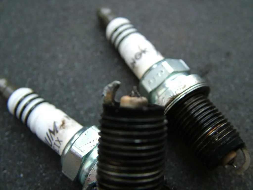

I had the same with my 200sx many moons ago -
Caused by det. Just got far far too hot. Never did any engine damage so i'm guessing it was spat out on mine.

Strange thing is, the colouring doesn't look too bad if its been running really lean, I would expect them to be a lot lighter looking? like really grey?

Dave silly question, are they the right temp plugs for the application ? eg when highly modded then a different plug is often specified(a cooler running plug) to stop that ?
Yeah, was mapped by 1320 on the 7's a couple of years ago, but yes, perhaps i should have gone to the 8's for trackday due to extra heat/loading?

Det usually. Have you had the map checked to make sure it's not running lean?
Not yet, but when 1320 did it originally it was a very "safe" map, so well within fueling/rev limits etc. Only thing i can think re: that is that the s/c belt that was on it when it was mapped was apparently slightly too long, & i now have the correct one, possibly giving more boost at higher revs, meaning that its a bit too lean - although wouldnt that affect all cylinders?

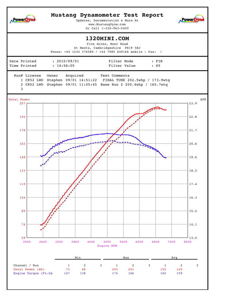

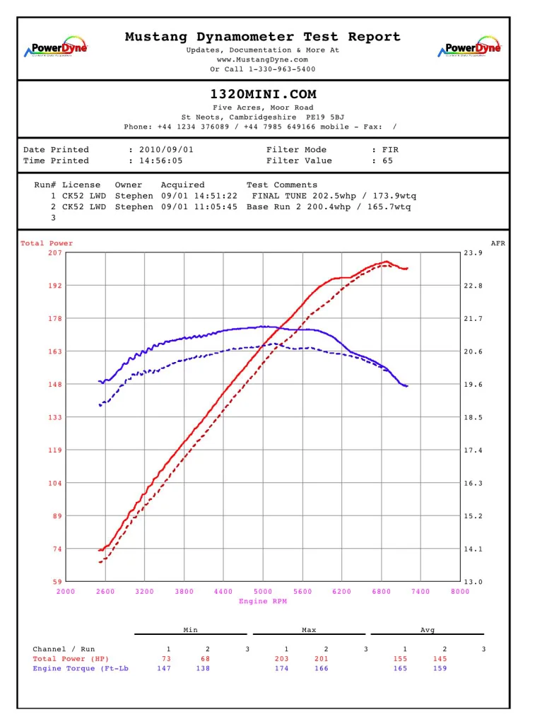

Think the graph below shows the limits at the top end?

I always use the appropriate temperature Denso plugs. Yours is tuned so I'd go one step colder.
IK20 is for the normal Cooper s and IK22 is for the works (197-214bhp), so would get some IK22 Denso plugs.
Then when you've got decent plugs of the correct temperature fitted get the map checked.
Have to say i swear by Denso's too , always had em in all my race engines both 2 and 4 stroke
and i am more convinced that a plug failure issue to running too hot than it being a det issue ......

Happened on my astra gsi. It was held flat out at 3 figures for too long and then bang. Cylinder 3 ate the spark plug. Sadly mine needed a new engine lol.

But det can be caused by the spart plug.
I think you are confusing this with pre ignition,which can be caused by a red hot plug tip,and the burn starts at BDC,usually resulting in a hole in the piston.
Japanese sports bikes run either NGK or DENSO plugs at twice the rev`s of a mini,with close to 190 bhp per litre,so plug failure twice in one day is unlikely on a mini,especially as it`s the same cylinder.I`ve never seen a plug failure on modern bikes either.
Ignition issues are unlikely,as I believe mini`s run 2 double ended coils,so anything going wrong on No 1 should be echoed in No 4.
Inlet air leaks are ruled out because its supercharged?Would probably run rich.
My money would be a faulty injector on No 1 cylinder making it run weak.
A visual inspection of the piston crown if it`s possible,along with a dry and wet compression check would be good for your peace of mind.
My money is on a faulty injector on No 1 cylinder.
Good luck with it,and have a poke round the mini forums.I had a quick look,but couldn`t find a similar problem.
I still think Det is high on the list. Especially with it just having a new "correct" belt. More boost needs more fuel. Can you see what boost you are now running?

Yes,detonation it is,on ONE cylinder ONLY,caused by a weak mixture by that cylinders faulty injector.
The other cylinders get the same boost,and share the same fuel rail!
If you look above I have posted a picture of the exact thing happening in ONE cylinder ONLY on a 200sx I had.
