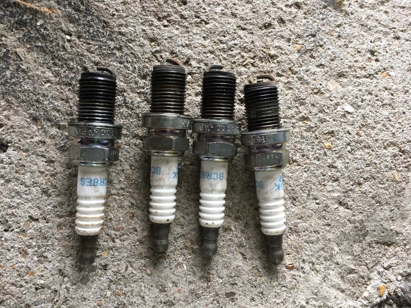

In effect, i got another PO301 Cylinder 1 misfire 30 mins or so before the end of the day, so went back to the pits, assuming it had probably done its usual trick of melting a spark plug. Unfortunately, having whipped them out, realised there was nothing wrong with them, then replaced all 4 anyway, the misfire stayed, so i had to drive the 45 miles home to Weybridge on 3.5 cylinders.
The 4 spark plus are below, Cyl 1-4 left to right:

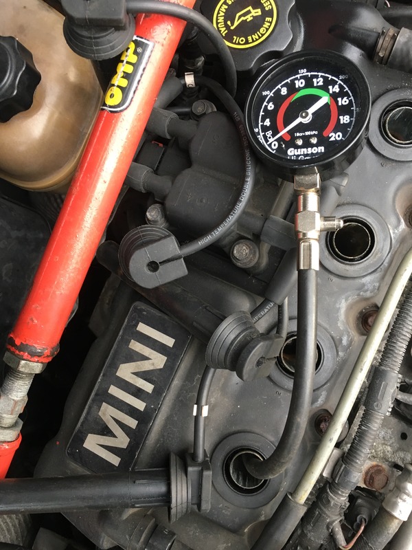

A comp test at the weekend showed the following:
As im not exactly an engine builder, I've bought a refurbed standard head for £220, with the hope that its something simple in the head like a valve spring, but what are peoples thoughts on the likelihood of further damage, i.e. pistons etc and the rebuild starting to get beyond my capability levels? The car has used oil on cold start for a while (valve stem seals), but never when warmed up (usually rings).

Do the compression test wet with a bit of oil down each cylinder and see if it changes.
Probably is the valve stems though, like you say it's been like that for ages.
  Evo 5 RS
I would get it bore scoped, you're going to have some scoring at the very least now. At the very least compression test.
They're pretty resilient in truth, though. Mine ate chunks of chicken mesh and barely lost any compression lol

The head is coming off anyway so you'll get a good look at the pistons, if you're melting plugs there will be some damage, how much is the question.
Probably worth doing this before the head comes off too \/
