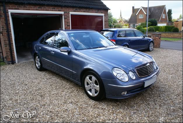

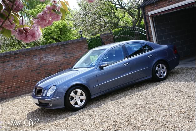

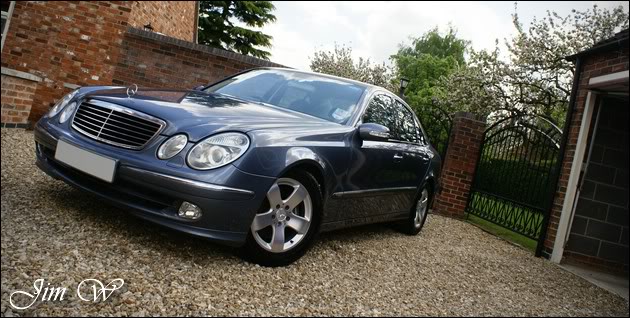

I last visited this car August last year. Since, it’s had nothing other than the weekly wash, so, more than ready for the complete strip-back and cleanse session!
Before:
After:
…that should see it through the Summer months!
Inspection:
Bodywork flat and covered in contaminants. Britework dull and tarnished. Wheels ready for a good scrub inside and out.. Still, at least the interiors nice and fresh.

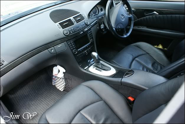

Possessions gathered and bagged. Mats removed. Hoovered. Plastics and dash wiped down with G101. Leather cleaned and protected with the LTT combo.

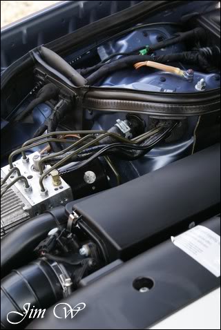

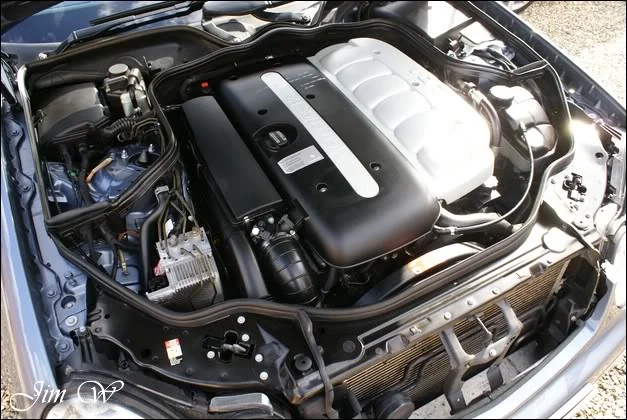

Once the interior was sorted, and, leather had been protected, I moved on to the engine bay.
Using AutoSmart G101 to clean and various brushes to agitate. Rinsed on a medium pressure by the Kranzle. (to be dressed later on)

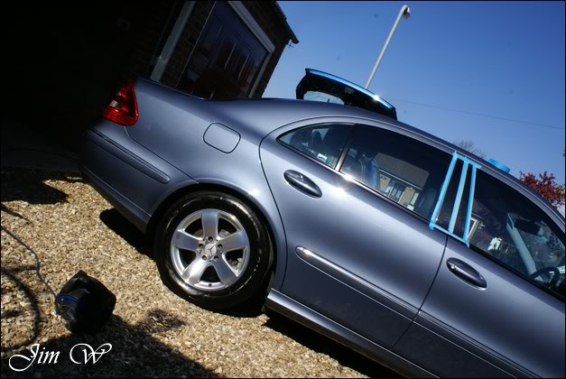

Dodo Juice Lime Prime on a 3M Yellow Polishing Pad.

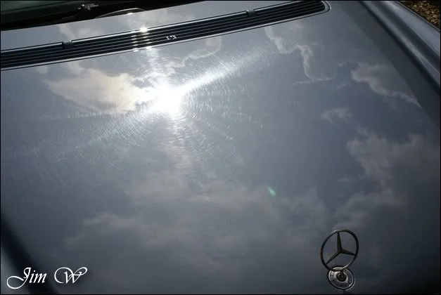

Bonnet before:
Bonnet after:
50/50:

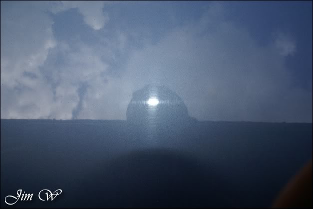

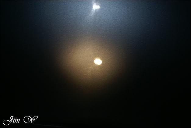

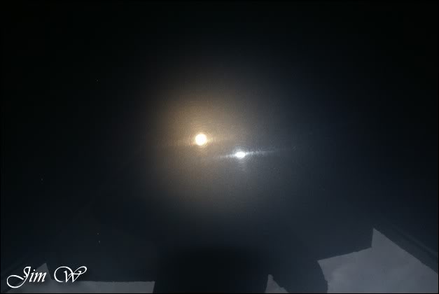

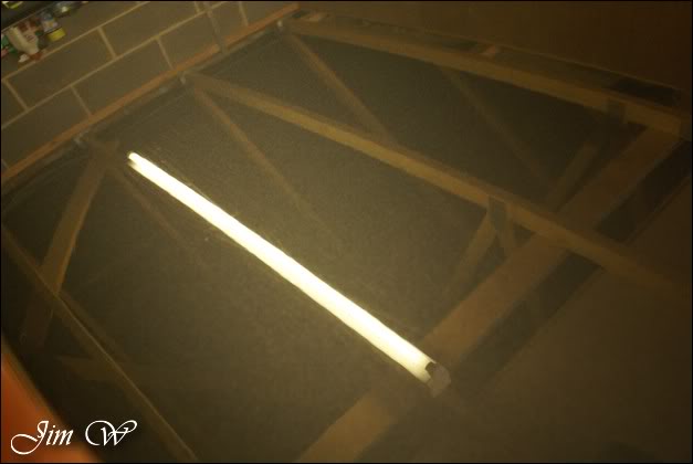

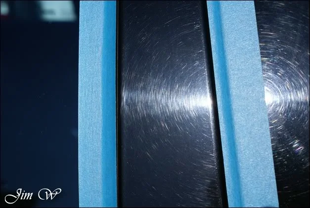

Roof before under strip-lights..
And cleaned up nicely.
Although the correction achieved looks well, don’t be fooled. There were lots of deeper marks still in the paint. I’d guestimate a mere 60% correction throughout; on the tough German paint Lime Prime was going to struggle anyway.. A more aggressive approach would be the answer to tackle the remaining swirls.

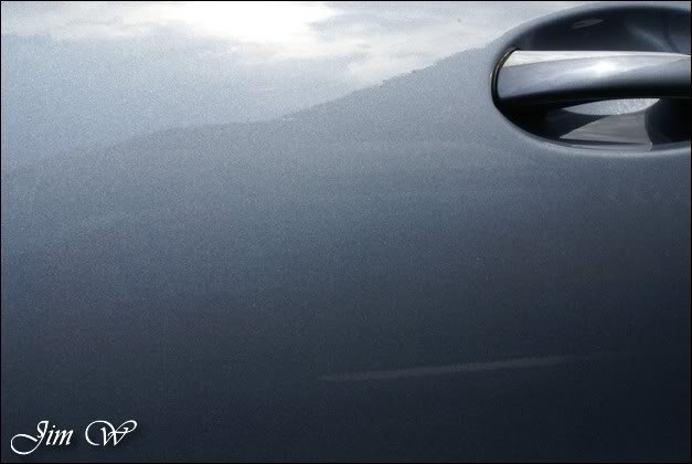

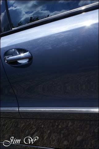

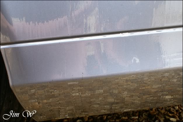

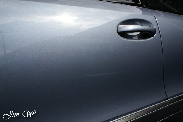

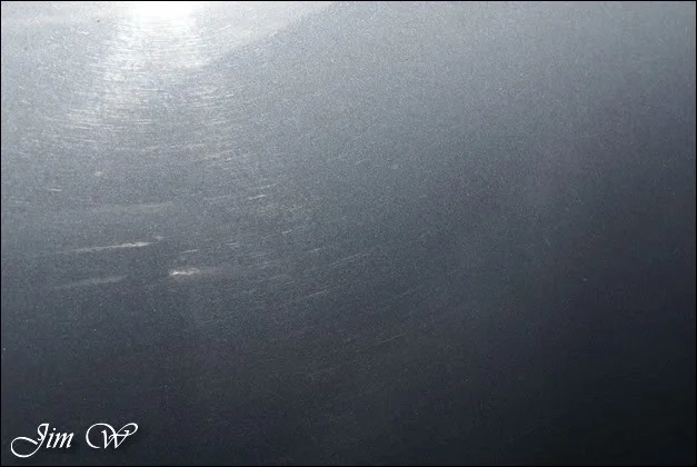

With the aid of some strong direct sunlight, I managed to snap these defect shots down the N/S:
After a pass with the enhancement set up, we were left with:
Much better.

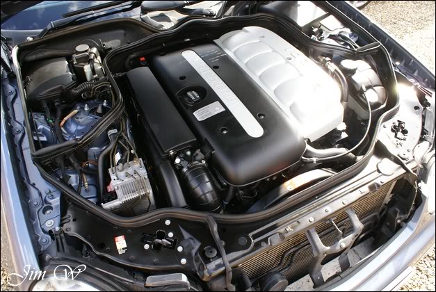

Finishing off on the first day I: dressed the engine bay. Dressed the tyres. Sealed the alloys.

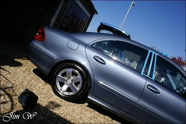

Returning on the morning of the second day, I finished off the large pad work (lower door sills) and then moved onto the small pad areas; bumpers, B-pillars etc.. A nice day for it, too!

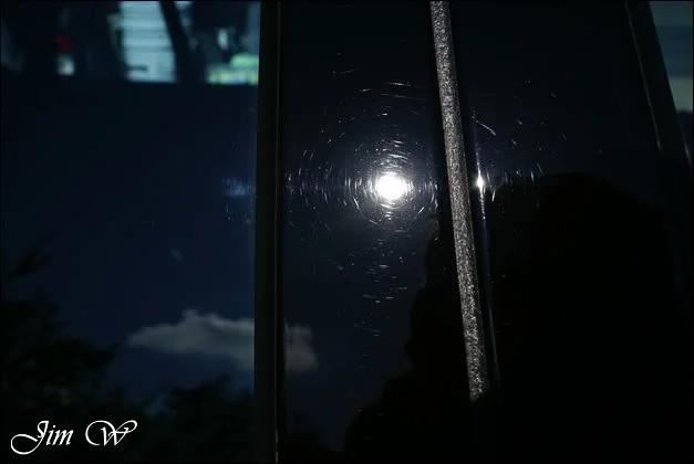

B-Pillars in a bad way:
Initial 106FA tests made very little difference – Strange.. Usually, this is all that is needed and does the trick! Stepped up to 203s and cranked up the speeds to achieve this:
Again, a heavier more ‘aggressive’ approach would be needed here to improve things further.

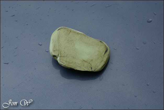

Random clay-bar shot mid way round the car,

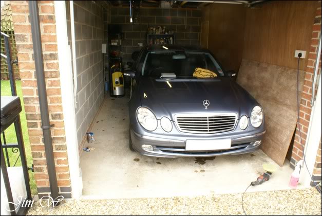

Although garaged, conditions weren’t great. For now (until the clouds blow over) I’ll work down the one side and move out and adjust as/when necessary.

Bonnet before:
Bonnet after:
50/50:

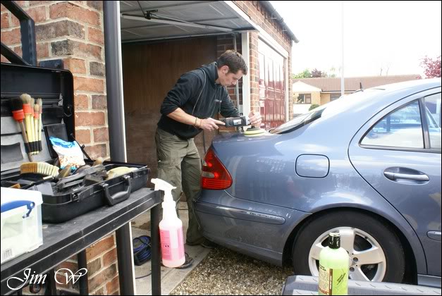

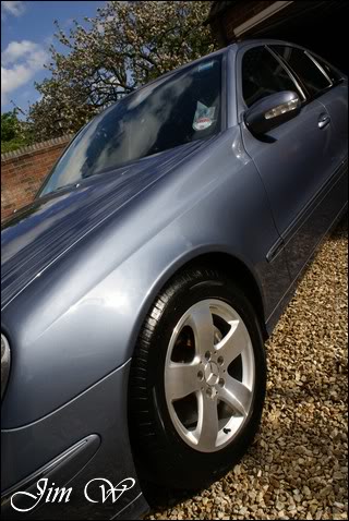

With blues skies above, I managed to move out the garage for the remaining time on day 1.
Before:
After:

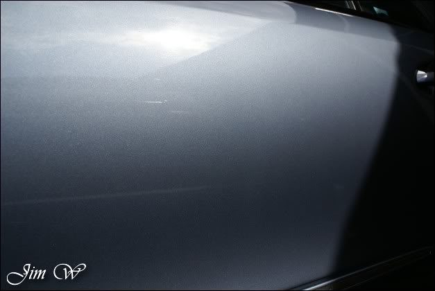

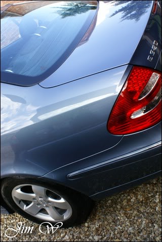

Much better.

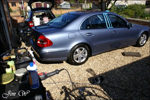

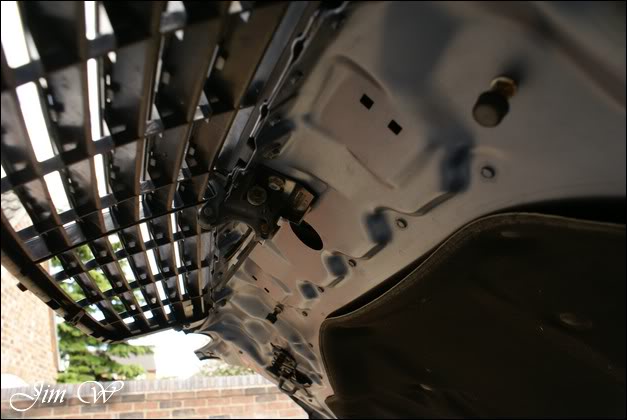

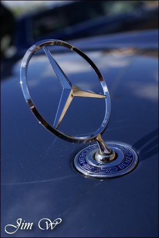

With that and the wax out of the way (Collinite 476s used here for max durability), I looked at the britework.
I remember last time the front end had accumulated a fair amount of ‘grub’ and looked very dull and tarnished.
Similar story this time round.
Before/after:
Stubborn spot in the middle just would not shift..
Grille completed, too:

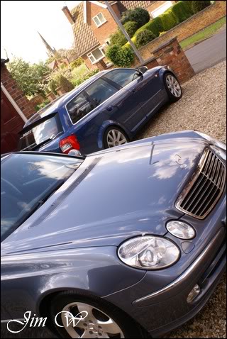

The Dodo threesome:
A final wipeover with Red Mist and we’re there.. ~10 hours in total.
