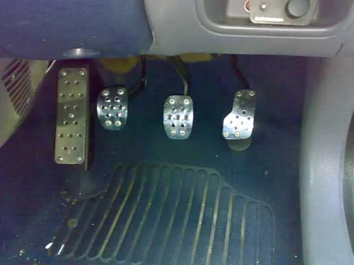

Stu_c Car GOLF GT TDI Nov 21, 2006 #10 i got the megan 255 footrest got it from renault when i bought the 172 pedals pic attached Attachments 13102006033.webp 17.5 KB · Views: 116
RacerStu Car Civic Type-R Nov 21, 2006 #11 Ye same here its about £35 from Renault. You get some rivets with it and bolt it to the standard plastic footrest.

Batman Car 80MPG BEEZA Nov 21, 2006 #12 how much where the 172 pedals? good to have the code numbers for the 172 pedals and 225 footrest
Stu_c Car GOLF GT TDI Nov 21, 2006 #14 Here You Are: Metal 172 Accelarator Pedal = R82 00 067 574 Metal 172 Pedal (2 Needed) = R60 00 073 658 Metal Megan 225 Footrest Pedal = R82 00 308 061 Rivets Fixings (14 Needed) = R77 03 072 051 Is about £140ish to do this if you dont have clio sport pedals or the megan pedal is about £35 on its own
