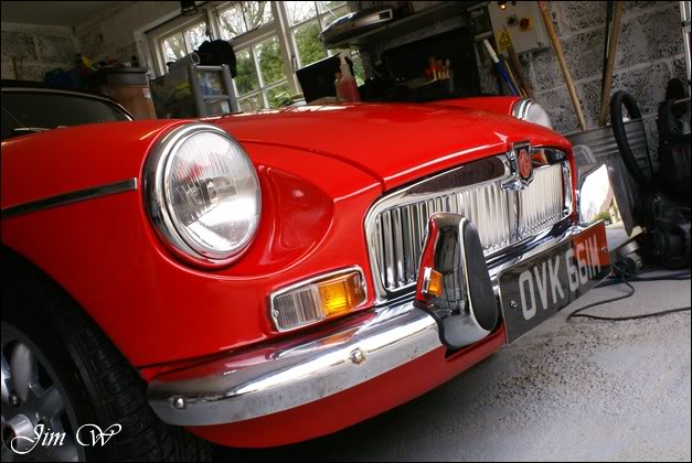

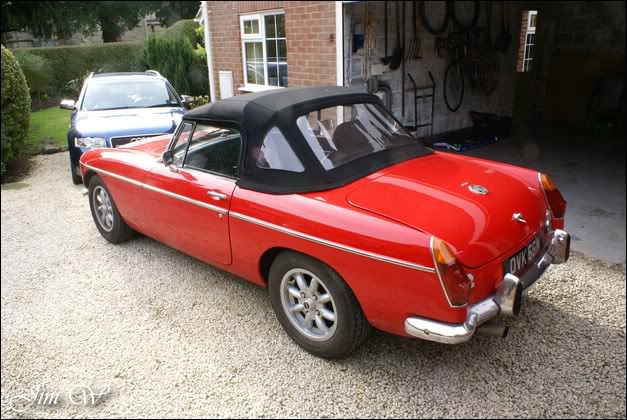

After having a fair amount of money spent on maintenance and engine work, it was time the MG had its bodywork looked at. Spec'd up for a Gloss Enhancing detail.

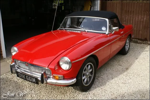

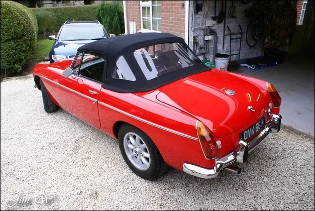

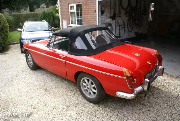

Before:
After:

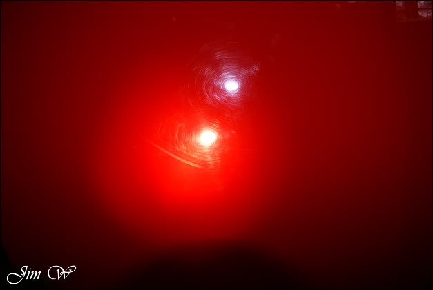

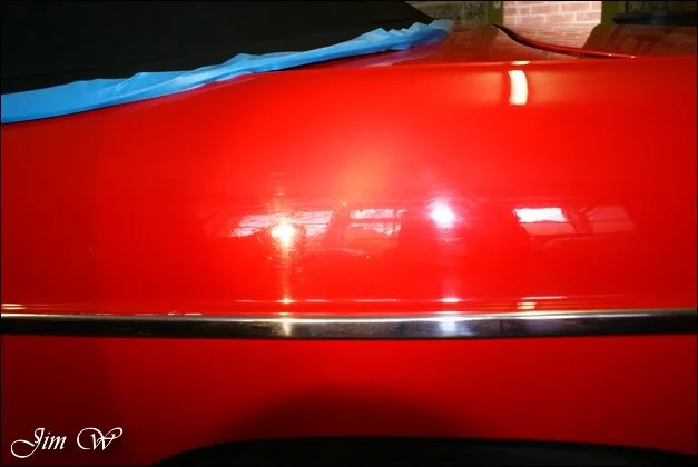

Inspection:

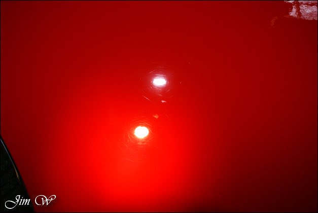

Lack of reflections:

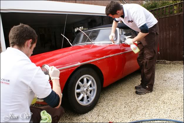

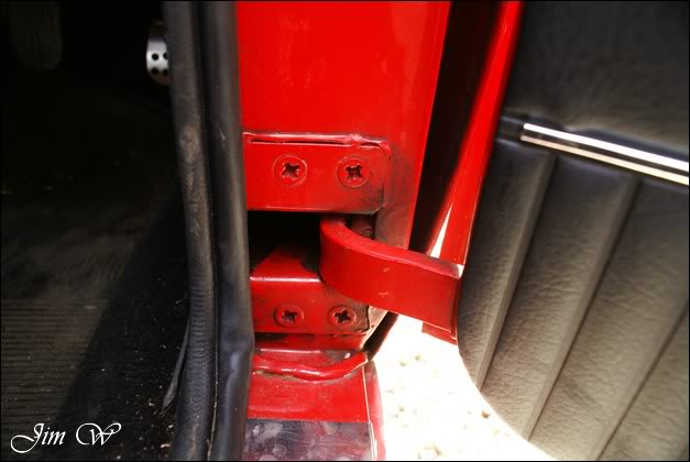

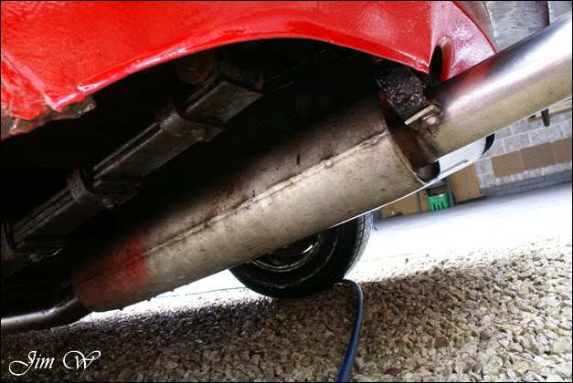

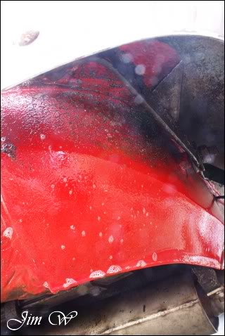

A good two hours were spent initially ‘cleaning’ the vehicle. Door shuts, under-sills, arch-lips, chrome bumpers and their undersides; they were all pretty lathered and had a fine coating of grease to shift.

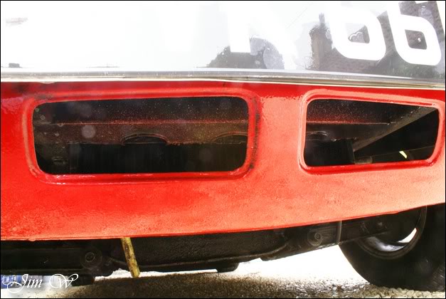

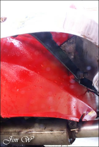

Under the front bumper (right side already done..)

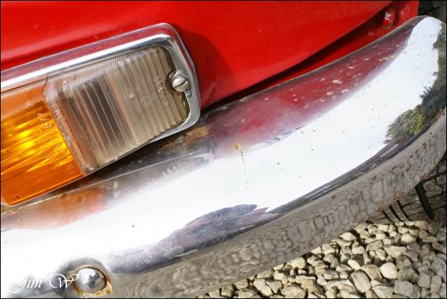

And under the rear bumpers:
Didn’t capture an after of the exhaust, but, for a quick Tardis wipedown and a bit of metal polish, it came up real well.

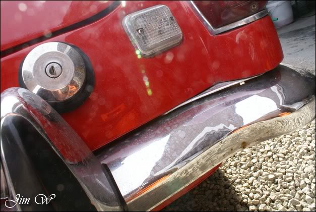

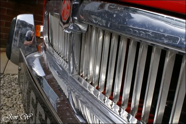

More time spent on panel gaps, badges, britework etc:

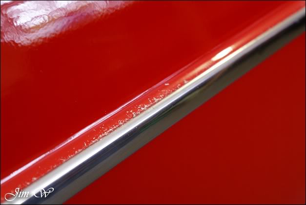

LOTS of polish residues left from previous sessions. I’ll come onto this a little later with the toothpick!

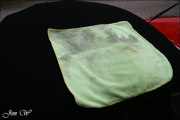

Because the vehicle isn’t water-tight (you could actually see through into the interior in some places), a pressure washer was out of the equation. Fortunately, the roof wasn’t too dirty. Only required a wipe over with a damped cloth with G101. Picked up a bit of dirt:

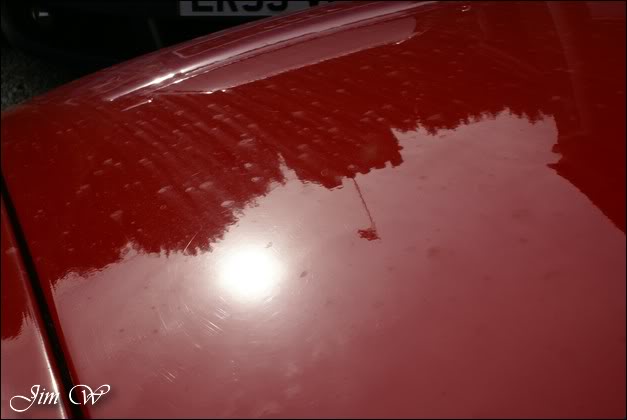

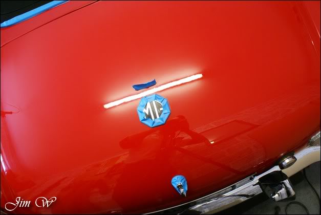

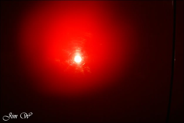

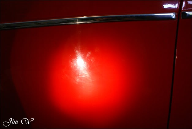

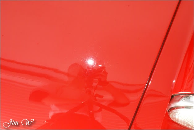

To lift the surface swirling and to add oils and depth, Megs #80 Speed Glaze was used on a polishing pad.
A noticeable improvement:

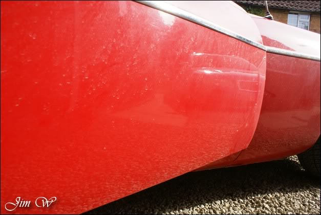

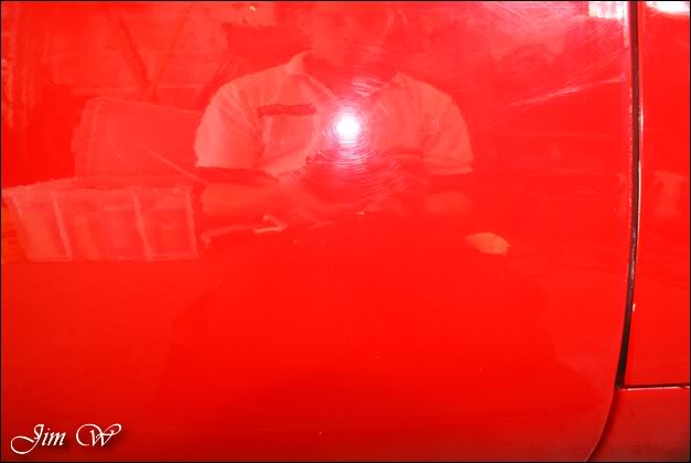

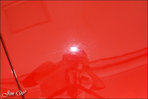

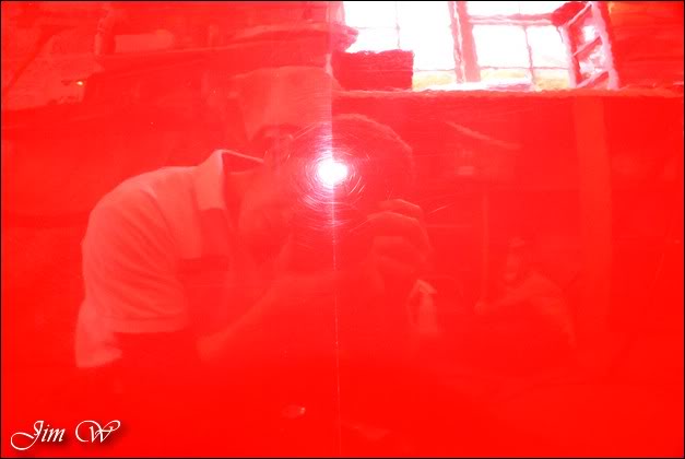

N/S front wing before:
After:

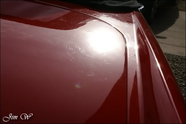

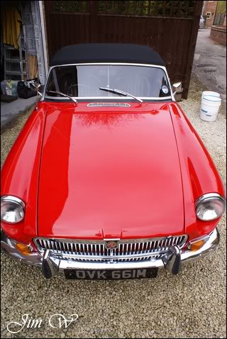

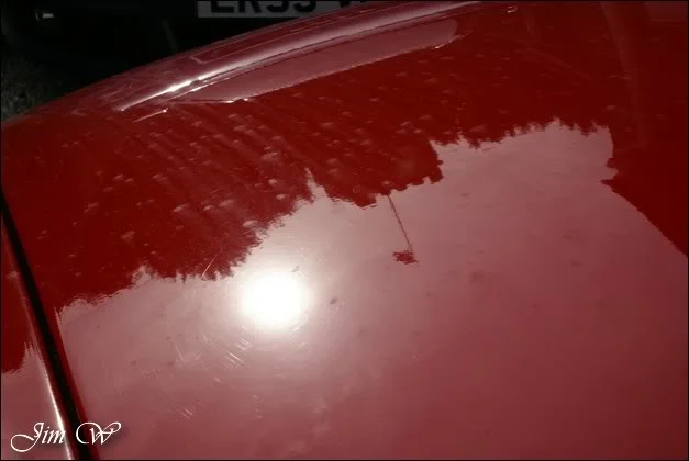

Paint actually proving pretty hard for a respray. A more extensive cut/polish/refine approach would be needed for further correction.

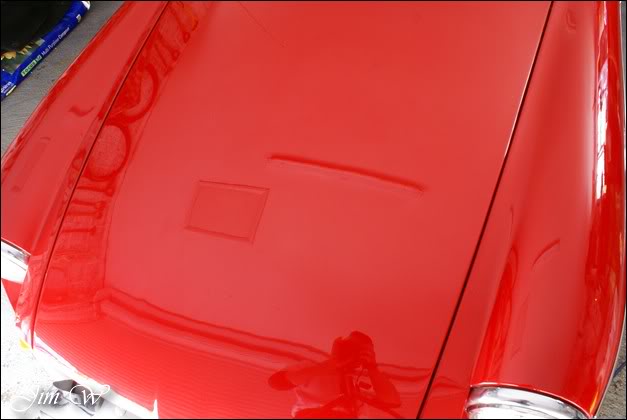

Swirling ‘haze’ knocked back as seen here. Before/after on bonnet:

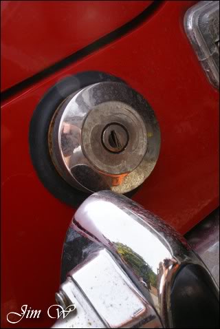

With the single-step machine polish out of the way and before finishing the paint, I decided to prep the britework and clean up the old polish residues as this would only smear/smudge the paintwork anyway. At least with the glazing to follow, any excess smears from contact with the paintwork would be sorted then regardless.

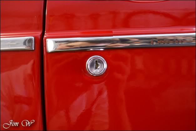

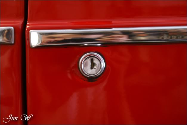

Polish build-up broken down with cocktail sticks..

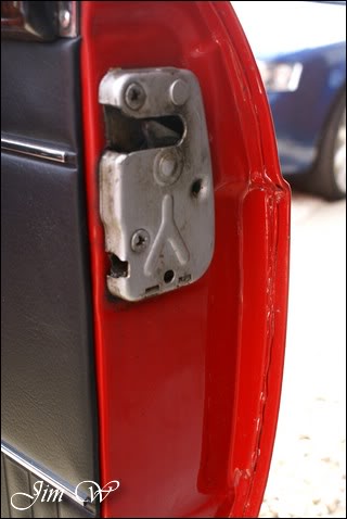

As was the dirt and crud spotted around the door locks:

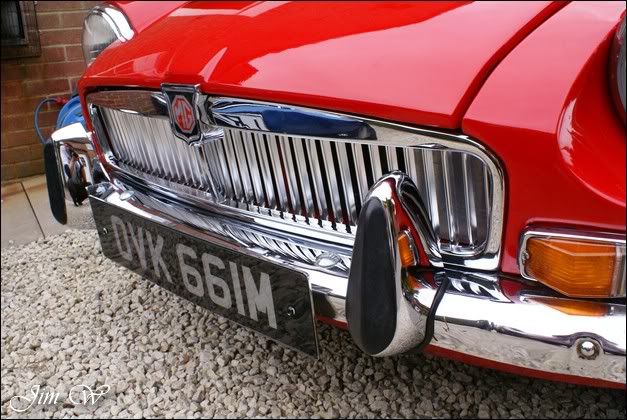

Chromed areas polished with Belgom ALU.
Finally (again, before the glaze just incase any overspray lands on the paintwork), the roof was protected with 303’s Fabric Guard.

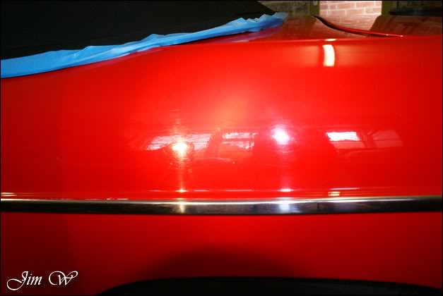

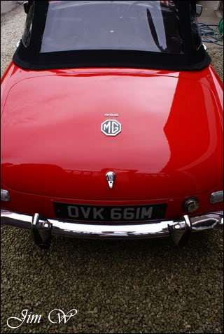

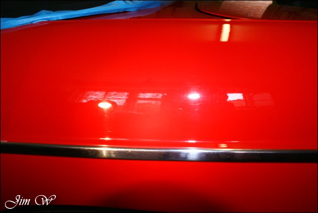

Glazed via DA, a flexipads finishing pad and Clearkote Red Moose Glaze.

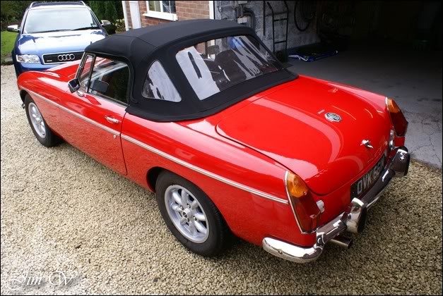

Waxed with Collinite 476s for max durability.

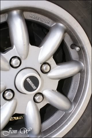

Tyres dressed. Windows polished and interior tickled..
Total time taken ~7 hours.
A lovely little car – I could happily listen to the engine noise all day! Very beefy (….for such a little car!)
