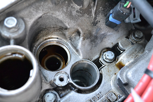

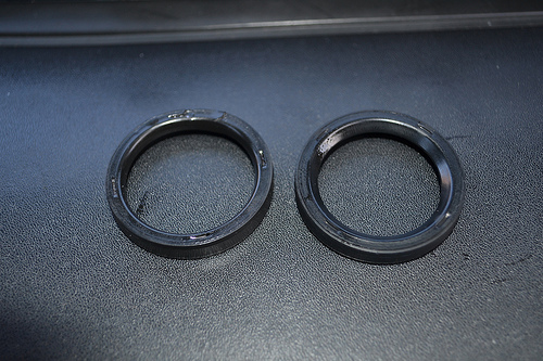

Fixed an oil leak this morning though.
Had a couple of pools of oil on top of the cam cover, close to cylinder 4. Tried re sealing the bolts around the area but to no avail.
The only other thing it could of been is the VVT trigger seal. I found the part number - 77 00 106 385 - £12.31
Fitted it just and hey presto, no more leaks!
Old on left, New on right
Old seal out, new about to go in. Showing pools of oil too
