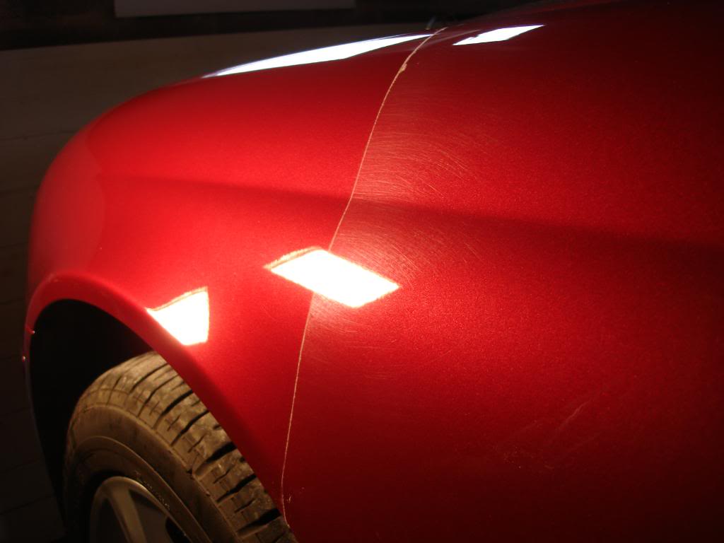

try scratch x, it does require rubbing in very hard with a foam applicator pad. I did 2 hours on this small area and managed to achieve this. you need to rub in the polish untill the abrasives have diminished.
Really you should get a machine polisher and do it that way itl be a lot easier. But 8 quid or so scratch x vs £200 machine.....

Looks good but if it took 2 hours to do half a wing you'll be there for weeks doing the whole car!
