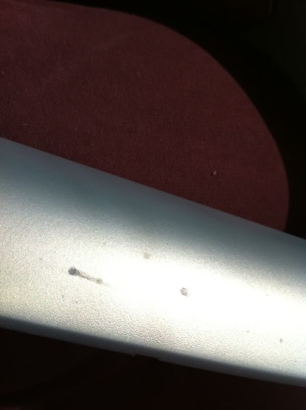

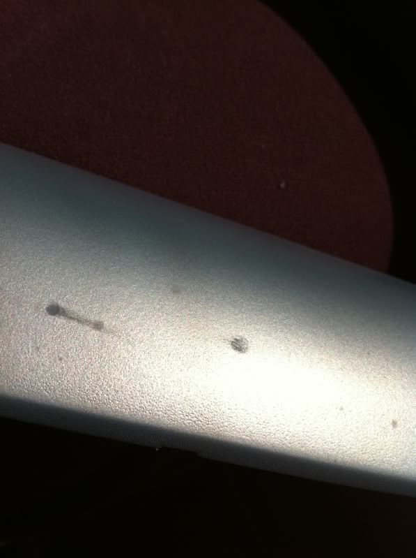

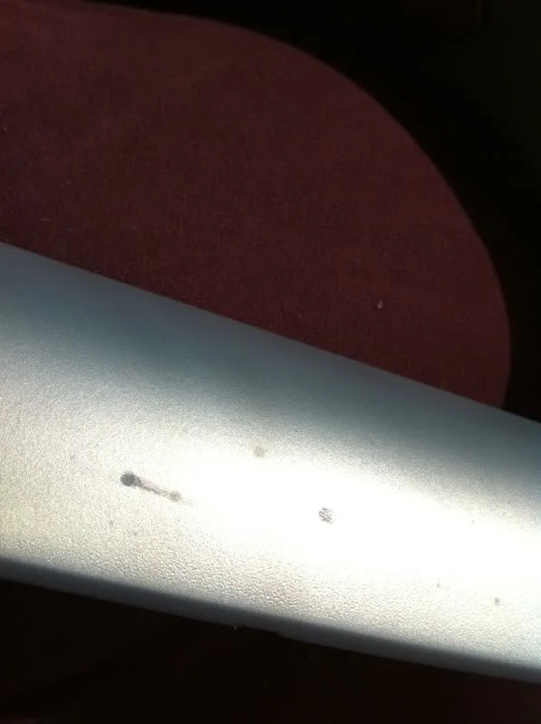

As per title, I have had a small mishap while colour coding my bump strips, was spraying on my colour coat nice and even when the can spat all over and now it looks crap!
It looks like its bubbled and gone down to the primer forming a small crater in the paint work.
Any way I can sort this without sanding it all back down and priming again? or is that my best option?
Cheers, Chris
Some pics to help
And yeah I know its not completely smooth either, would it be worth trying to get it fully smooth?

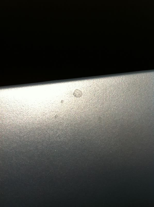

Another pic of the marks
Really bugging me now cos I wanna get it finished.
Should I just sand it back down?
Cheers, Chris
yeah man sand it down.. you could only sand that little bit though... however if i was you i would be sanding it all down to get a smooth finish!
jamie!
i went from like 400 to 2500 iirc :)
i also found that using filler primer works a treat :D
i think i went from 400 to 1200 and used some filler primer but only after using normal primer.
