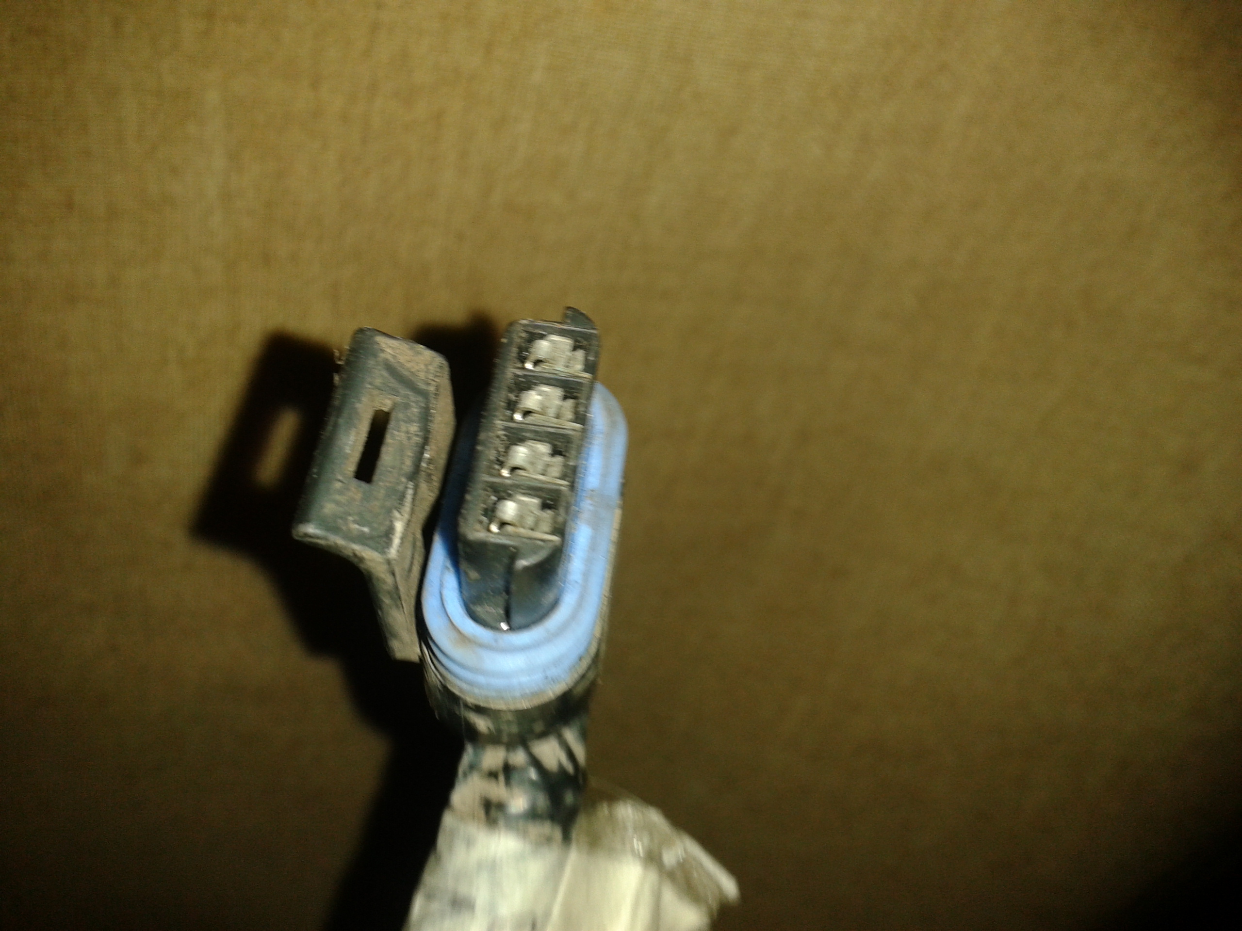

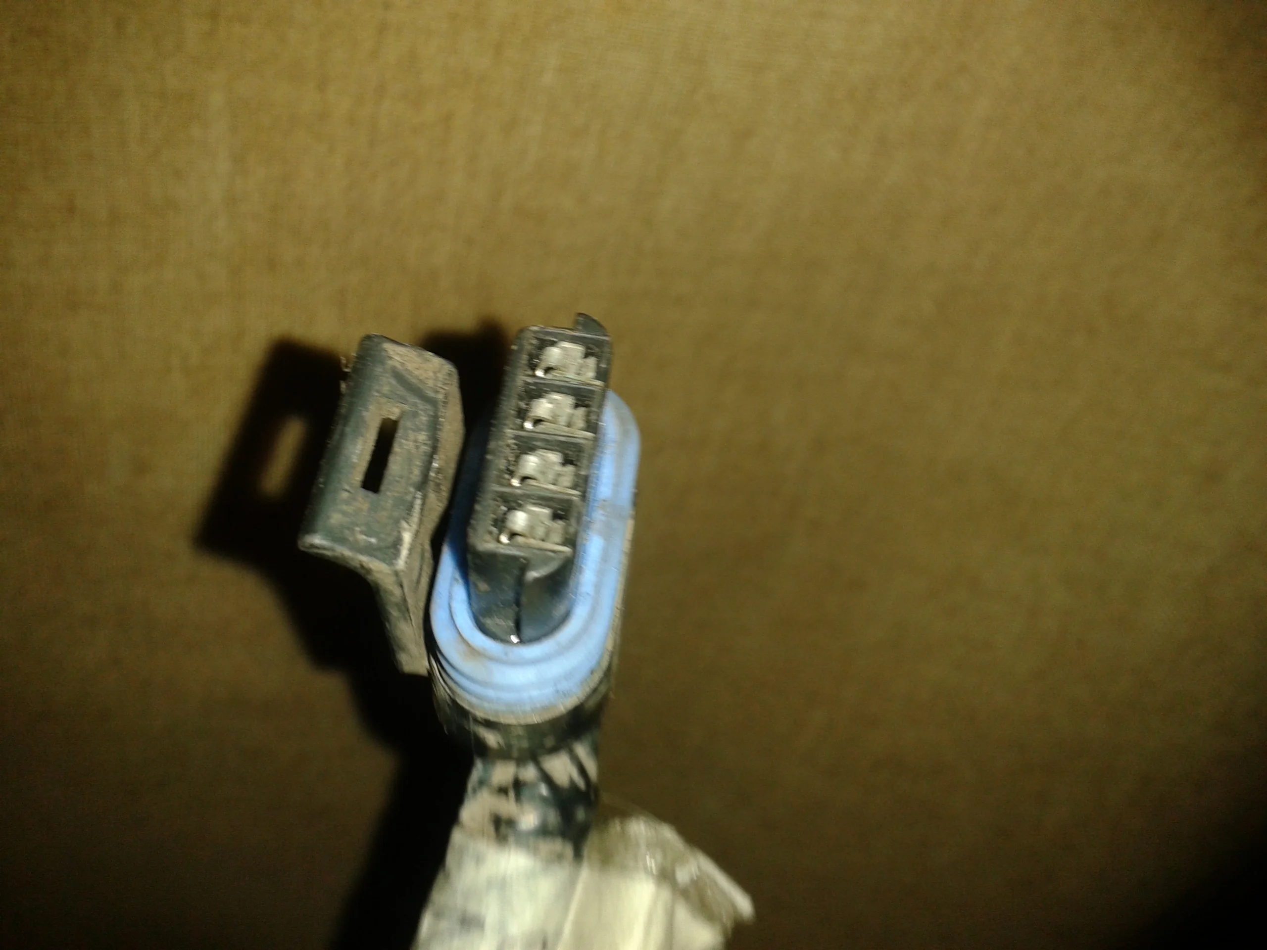

That makes life difficult, as the usual answer is to swap the sensors front to back.
The correct Bosch number is 0258006046.
Perhaps CS can provide a connector plug?
