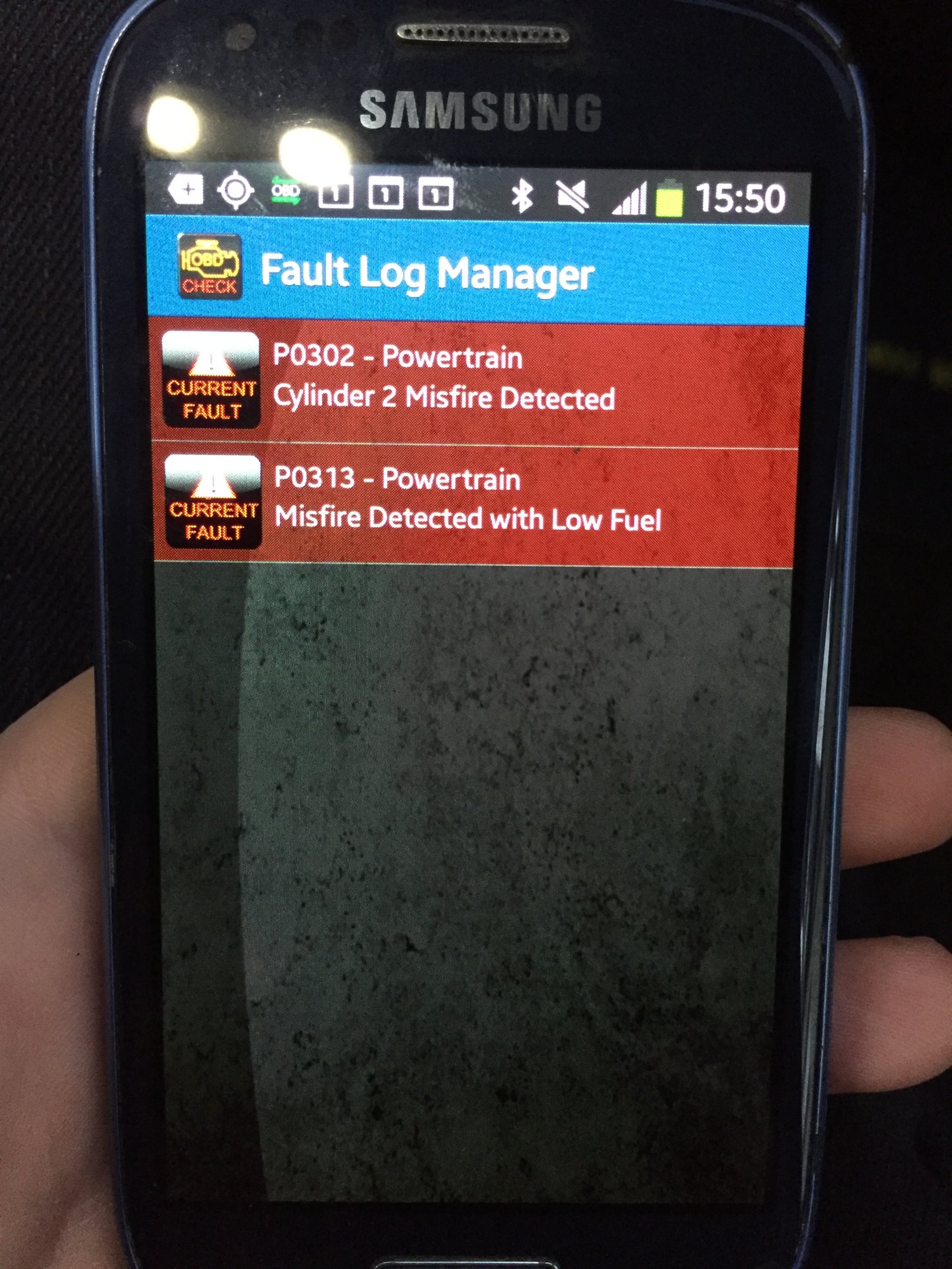

I've managed to get a code reader on it and have the following... cylinder two injector?
I am no expert... lol
Have you checked the intake system for air leaks? If a pipe has a leak and it's sucking air in through it at a location past the point that sensors measure what is coming in (especially when the load increases on the engine and therefore on the intake system), the mix in the cylinder will have less fuel than required for the air volume, meaning it will be running lean and be read as such by the lambda sensor in the exhaust (if I understand it correctly).
