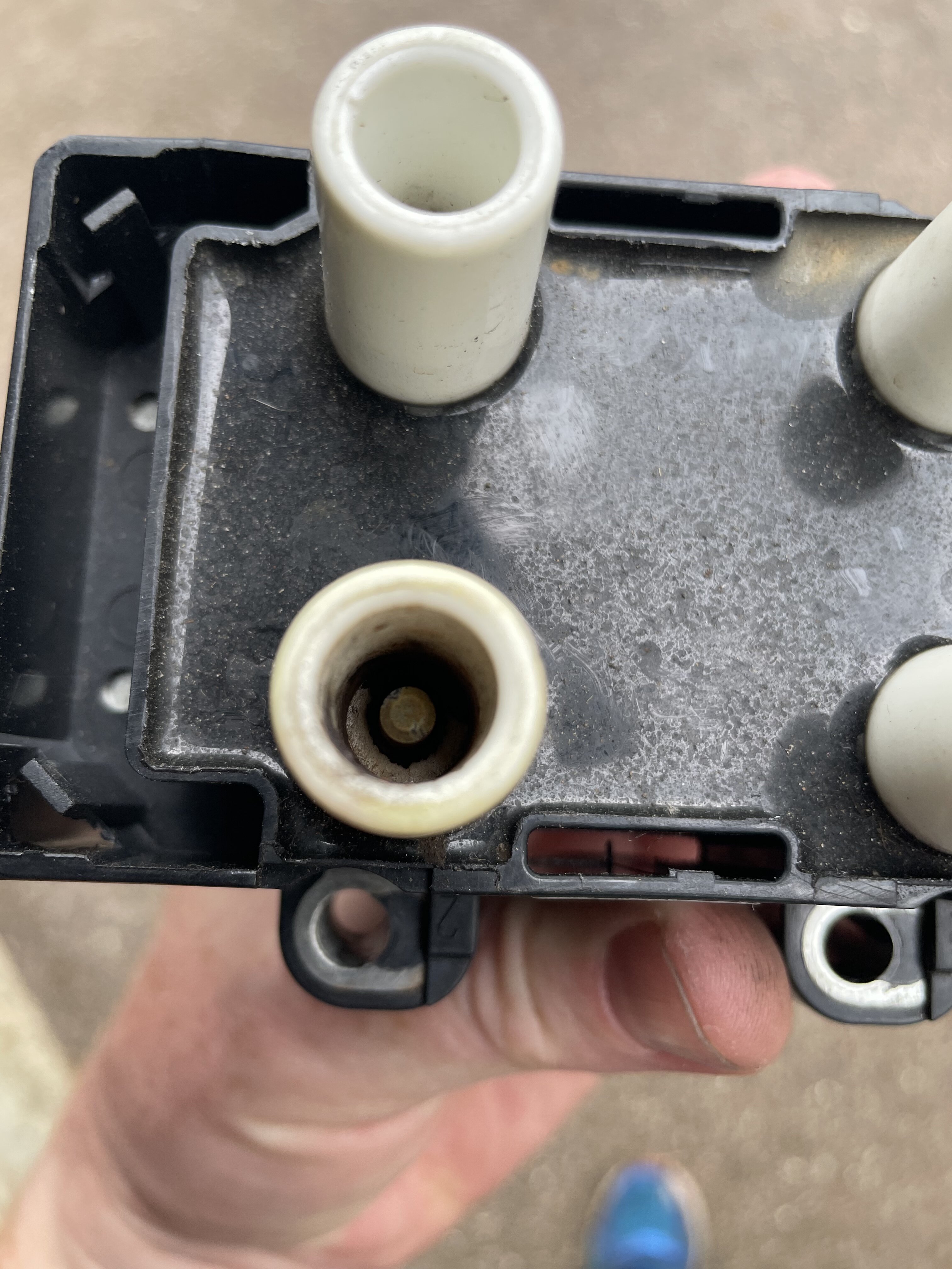

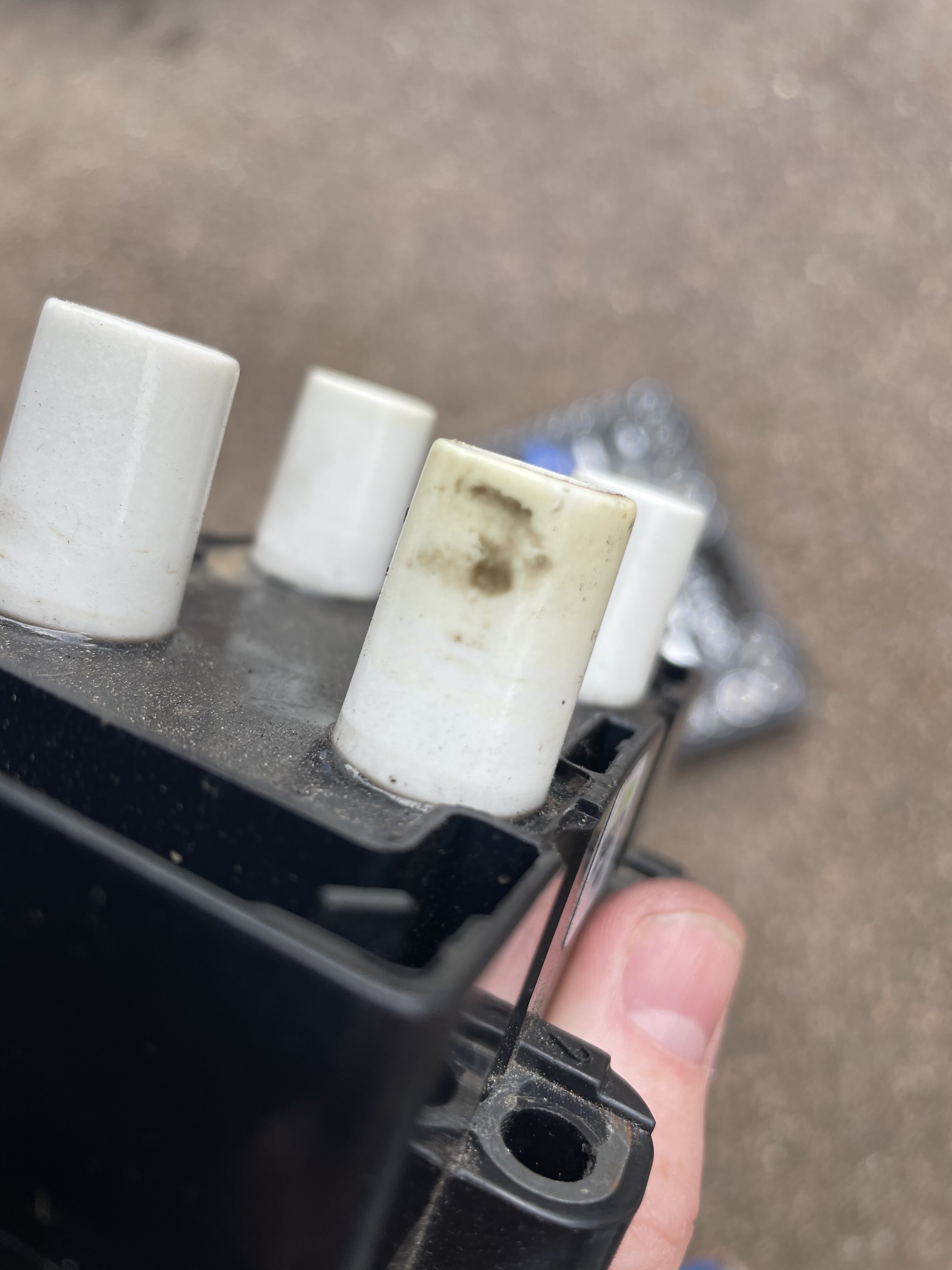

looking at the coil pack it was showing signs or burning so I have replaced that, fault still there.

pics of the old coil pack
