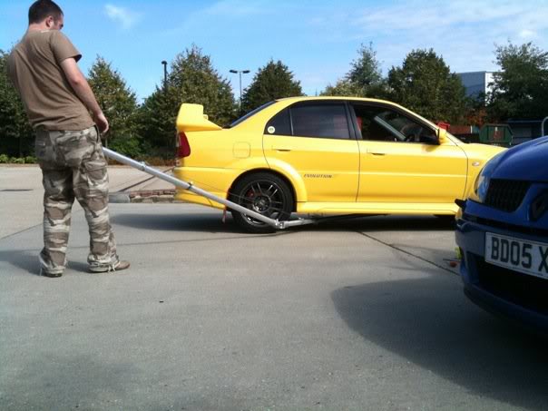

Here's an out-take of the rig on the evo:
EDIT: Christ my ass looks HUGE in that photo! I did have a load of tools in my back pockets though so I blame that! ;)

just a quick question with the pivot point of your rig, can you actually lock tight in place there or is it just the steel cable that holds it in place

Total n00b question, but how does it attach?
Clamped on the exhaust or something? What about the front?
Have a look at this post on my blog, you can see a photo where it is clamping onto one of the rails under the car. It's the same the other side.
It can be tricky to find places to attach it, and the M3 I did a shoot on had nothing to attach to, so I was buggered lol!
http://danfreemanphotography.blogspot.com/2009/08/rig-baby.html
cheers
James
It can be locked yes, but that is nowhere near strong enough to hold the rig up, it might help with vibrations a bit though.
That cable is essential, there is a hell of a lot of strain on that cable! That's why I got 3mm steel cable which I think Im right in saying is rated up to 750kg! I think that should be enough lol!
This is where I got the cable from, they also do all the other bits too:
http://www.tecni-cable.co.uk/Stainl...ess-Steel-Cable-1x19-Non-Flexible-Low-Stretch
