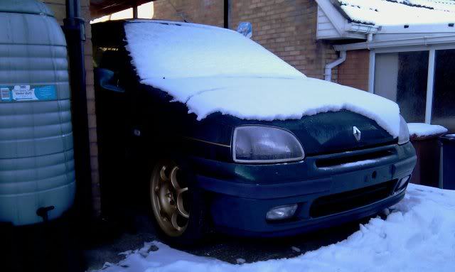

Frustratingly there hasn't been much progress lately, mostly due to the car looking like this :dead:

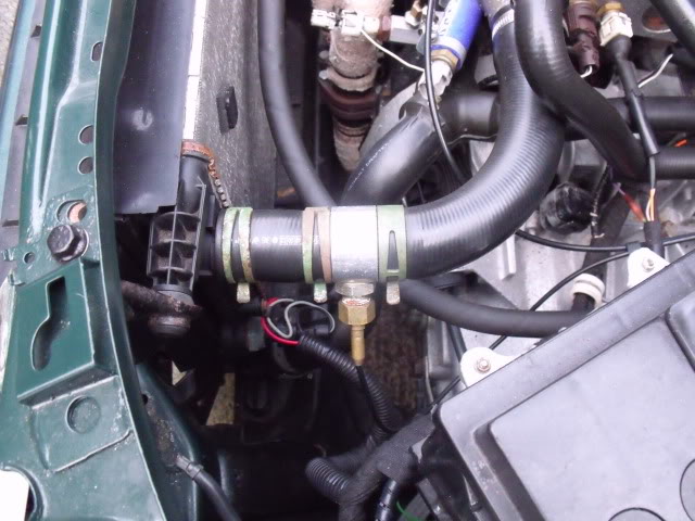

Water temp sender for a gauge fitted, not overly happy with the location as it's after the thermostat and so will only read once the engine is up to temp and the stat opens but it will at least show if things are getting too hot
the gauge is a TIM split water temp/oil pressure one so oil take off added

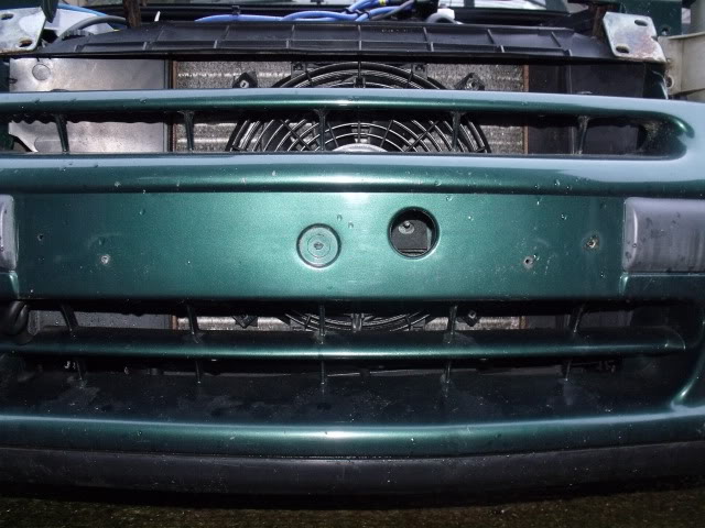

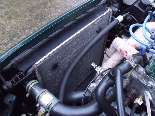

Squeezing the new manifold in didn't leave much room for the fan so we've gone for a front mount one. Verdict is still out on this too, it cools the rad down fine once the engine is up to temperature but it's not been trialled on the road yet to see if it obstructs flow too much.
Back view
Front View

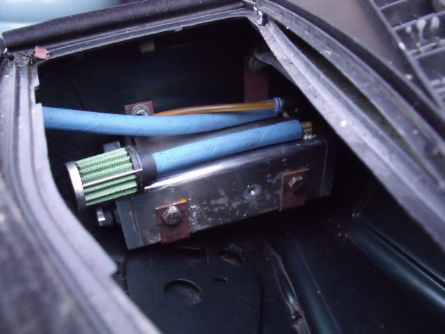

In the scuttle area that used to hold the ECU an oil catch tank has been added. It's a cheapo ebay one for now, planning on getting something better made up with better size breathers once it's up and running.

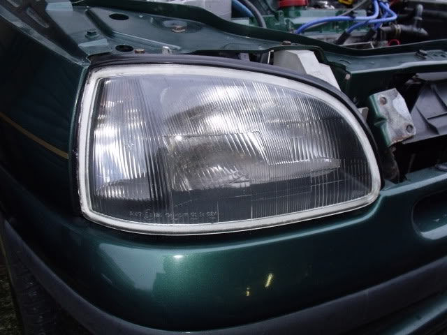

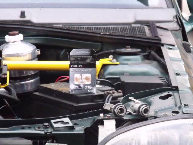

Another mod I've tried is painting the insides of the headlights. Not seen this done before on a clio so not sure if I'm trailblazing or not. When removing one of the headlights the glass fell off, common problem I've since found out. With the glass off the idea came up of painting the insides black, we've also removed the lenses over the indicators and fitted some silvervision bulbs to avoid orangeyness
Again, I'll wait and see what I think of these once it's up and running.
