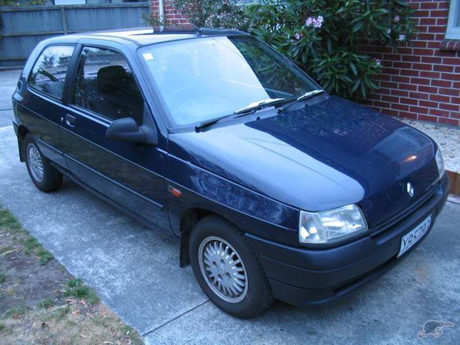

This is it anyway, if it goes ahead im gonna leave it on steelies :D How much am i looking at for a Williams widetrack?? im assuming its just the axle?
For widetrack u need:
Williams or renault 19 16v wishbones
Williams shocks (can use williams or 16v springs)
Williams driveshafts (can use a renault 19 16v driveshaft but only the passenger side one, drivers side must be williams)
Williams or renault 19 16v ARB+mountings
