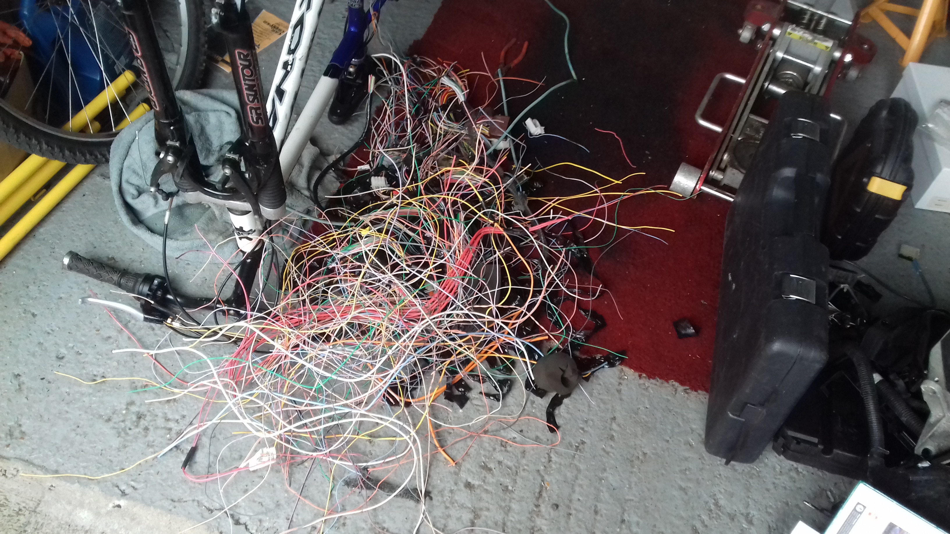

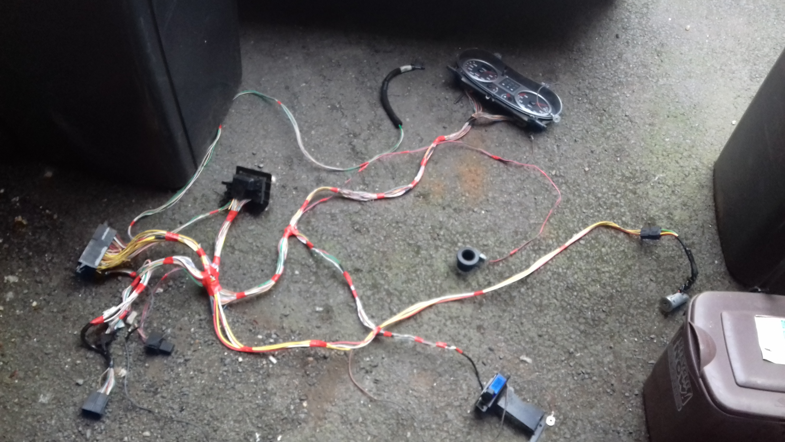

Thats alot of wires out of my looms.
Unfortunatly 1 to many though. No need to worry ive identified the offender. The immobiliser 12v feed. Even though i was being methodical i still cut the wrong one. I was being ruthless though. If it wasnt plugged in whilst ive had it running it was cut off.
A much prettier 172 loom. Just need to reconnect that immob feed.

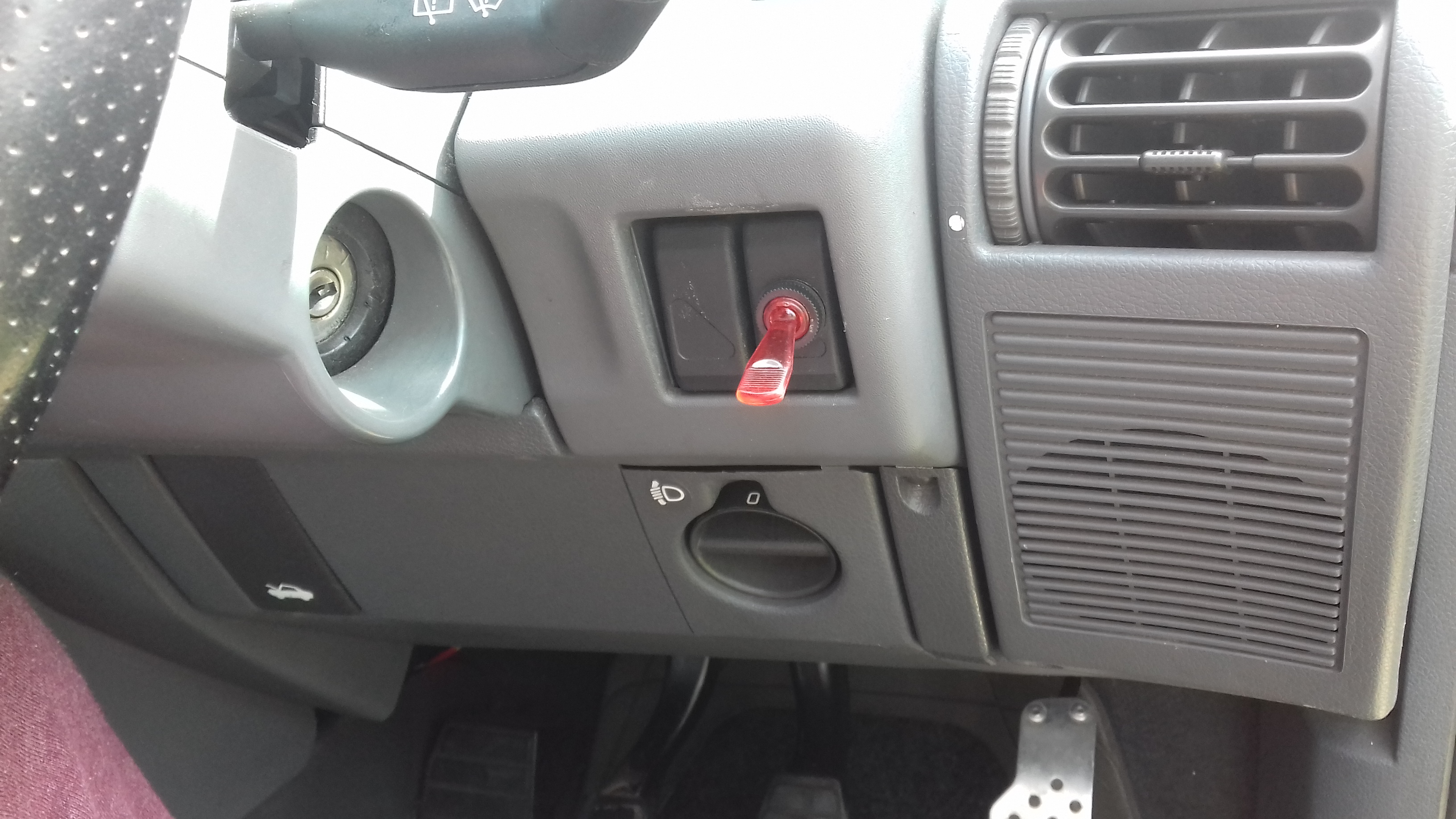

Then id like to arrange so that the immob is hidden out the way and it all runs off the original key.

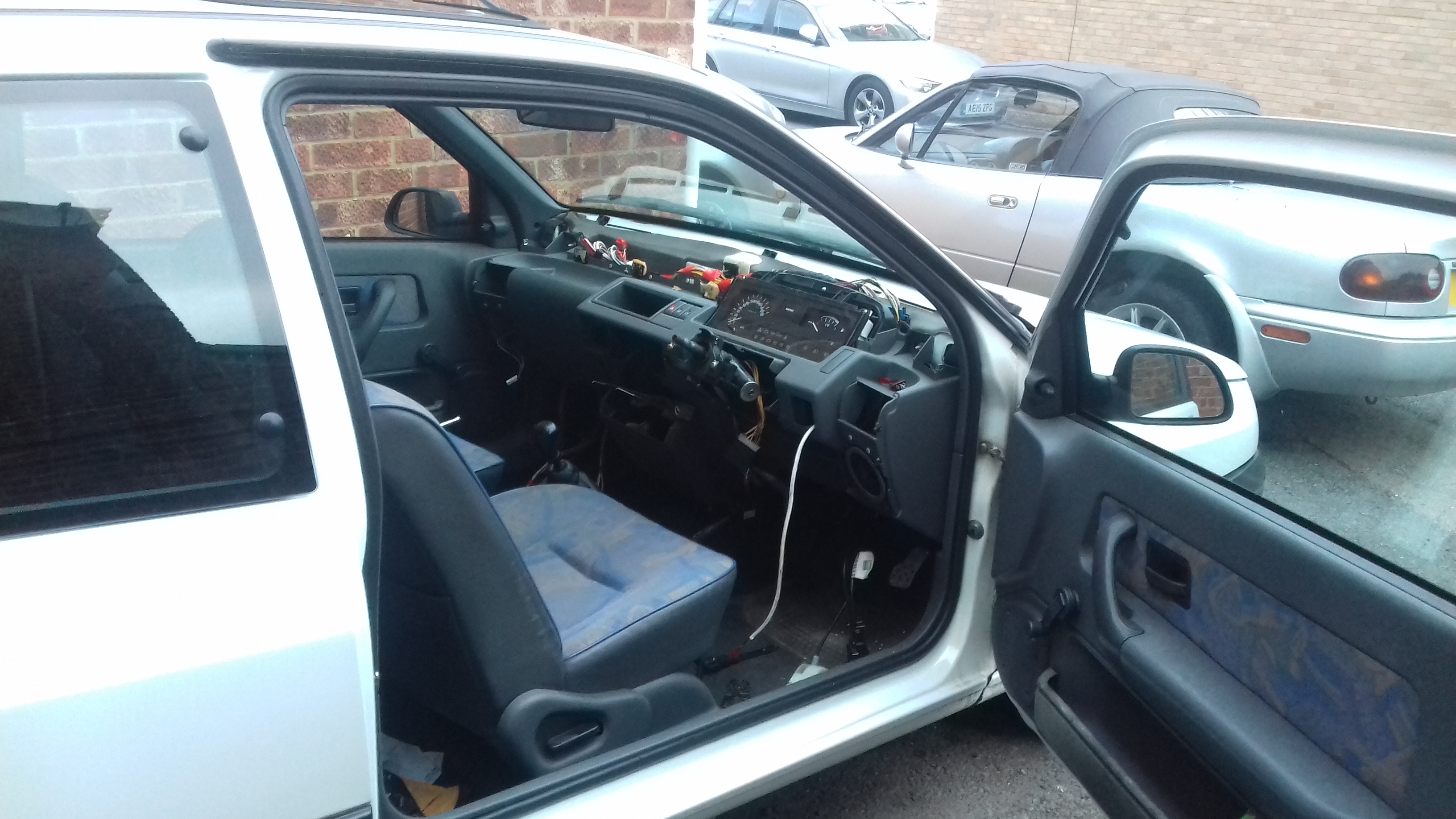

and started to put the dash back in.

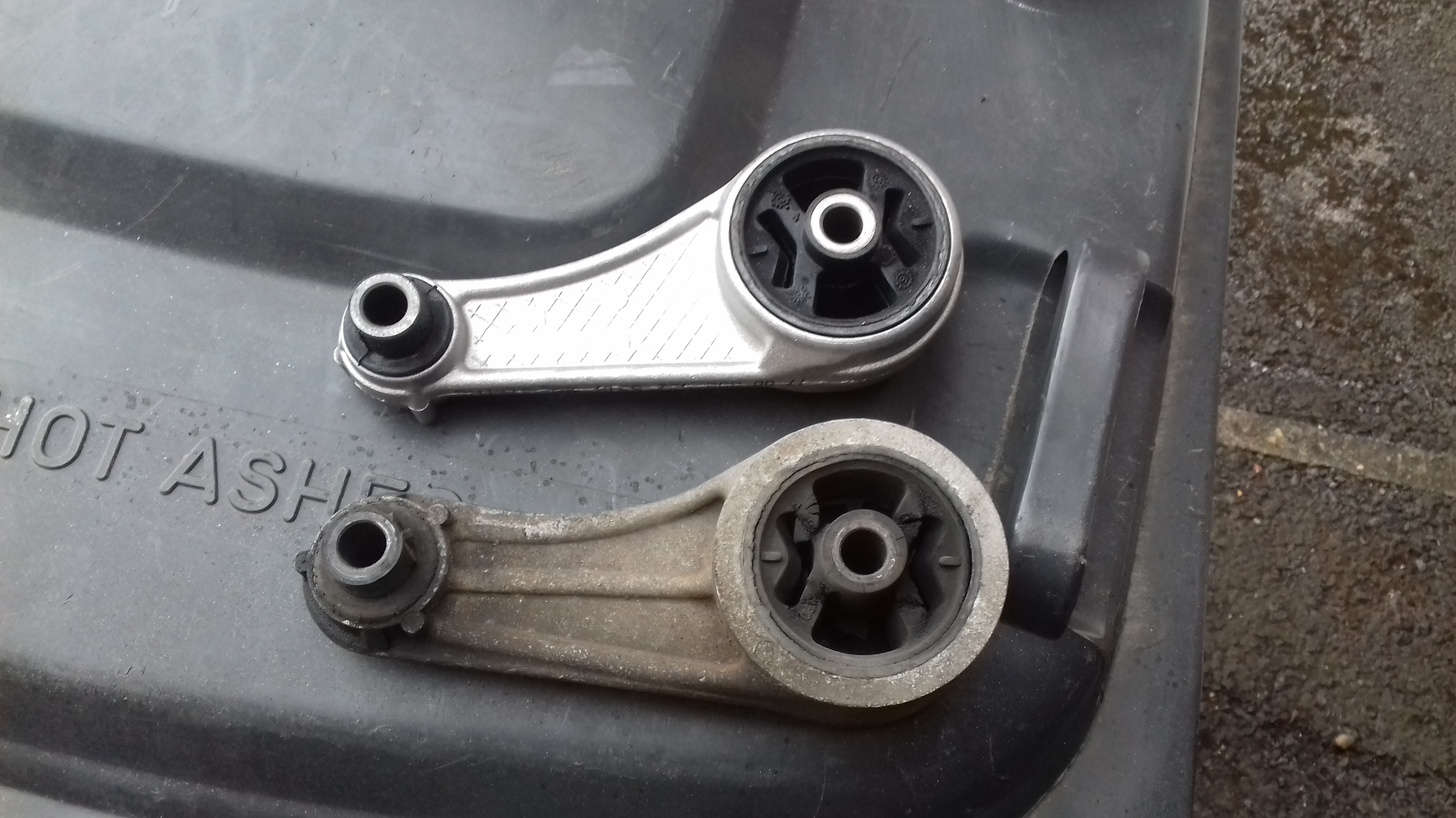

And replaced my rear mount

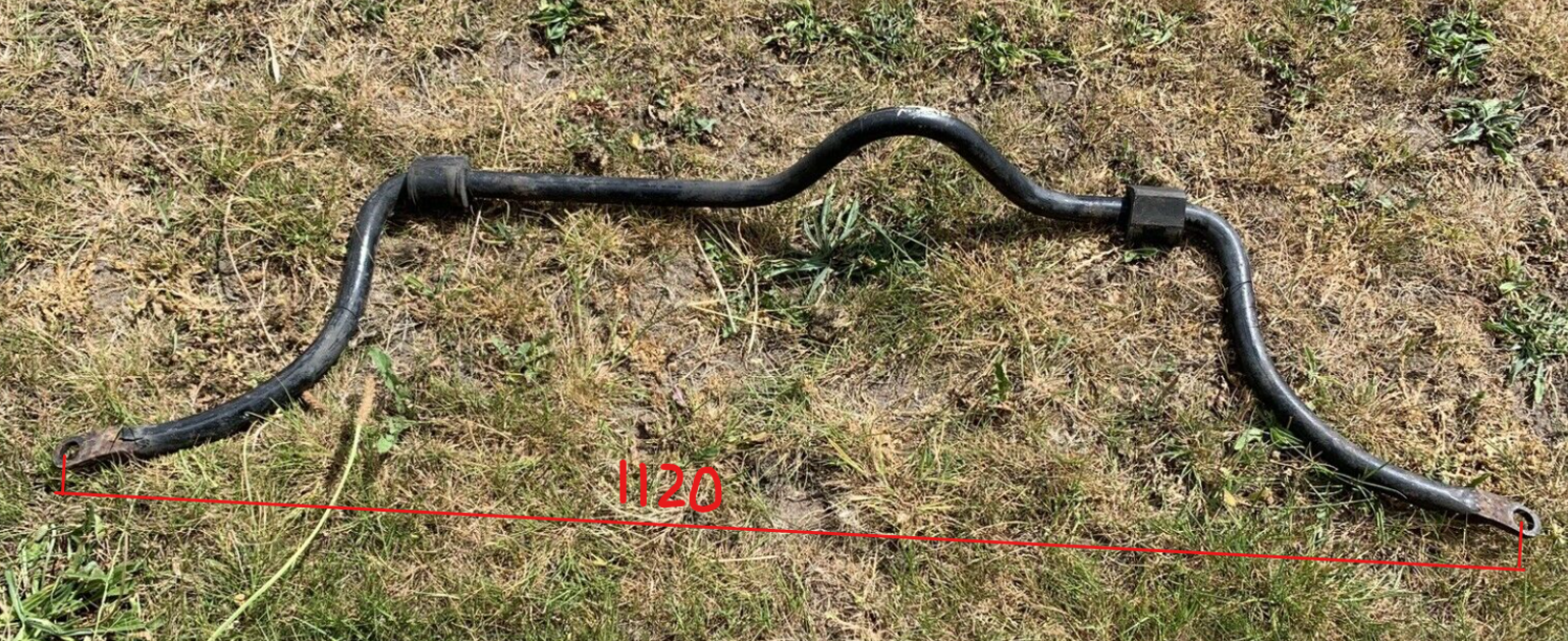

I think the car needs a roll bar. I got hold of a twingo GT bar as I thought this would fit. It doesn't.
Does anyone have a dimensions below of a lower spec clio? I need one that's a bit shorter on the ends, probably by 100mm.
Thanks
