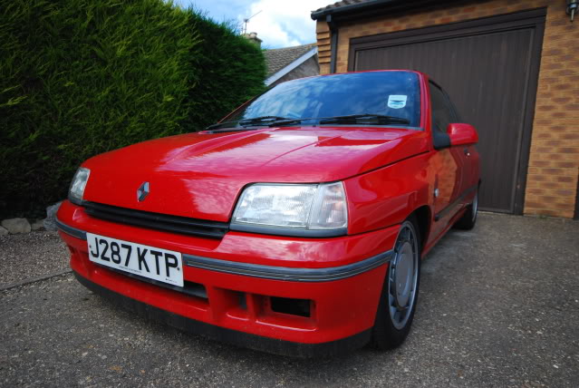

As a few people may know I’ve been wanted to buy a track car for a while, wasn’t too sure what to buy for a project car though. First of all I wanted a mk2 ph1 but they were too expensive to insure, thought about a Mazda mx5 but quite a bit more to buy and a bit too much to insure as a second car. Finally thought about a mk1 because I know a few people have recently bought them. Started looking round for one and signed up to clio16valver. One came up in Peterborough so seeing as I was stopping down that way for FCS I went to see it. I loved it as soon as I pulled up.
Saturday 20th June

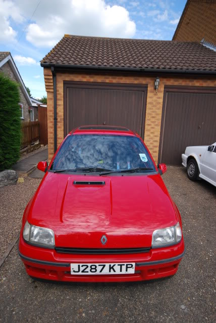

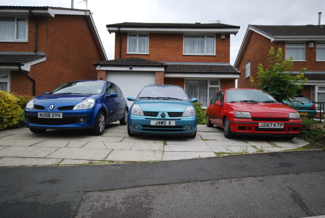

Me and my brother (Gaz) took the trip down to Peterborough to buy the valver today. Gaz drove it home because I can’t get temporary insurance because of my age. Got it home alright and took some pictures with mine and my mum’s car (all three Mk’s of Clio).

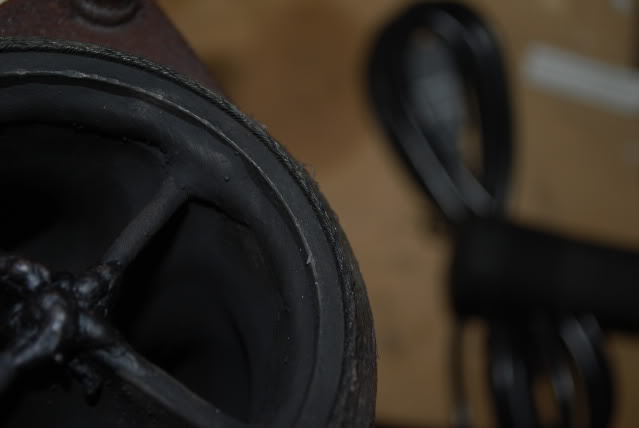

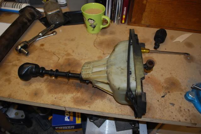

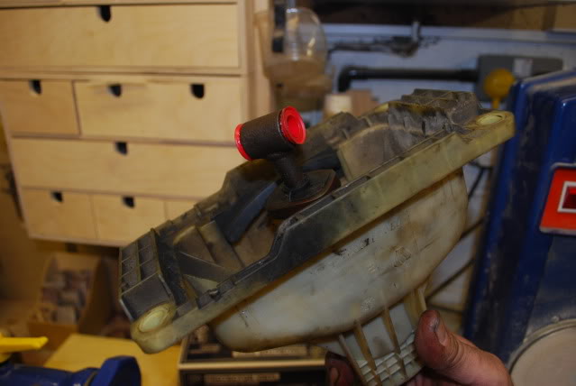

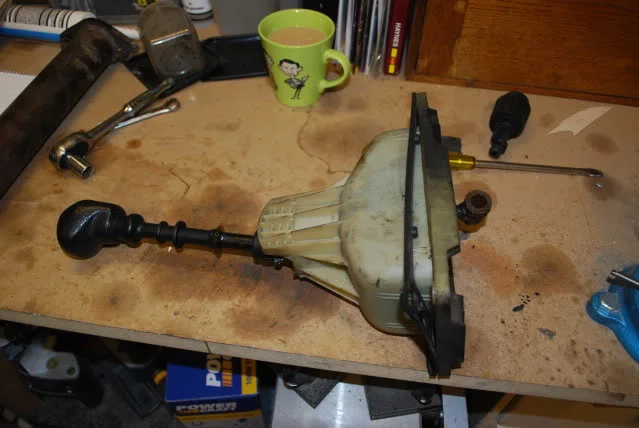

When I bought the car the gear lever was really sloppy and it was very hard to feel the gears. When it was in first gear the gear lever still moved a lot, as if it was in neutral. This was because the bushes needed replacing in the linkage. So out came the gear lever unit. This meant taking the decat off simply undoing either end of the linkage.
As you can see from the picture, the bushes at the bottom of the lever had elongated. These were replaced along with some more bushes at the box end on the linkage.
Put it all back together and there is a lot more feel now and can put it in every gear easily.

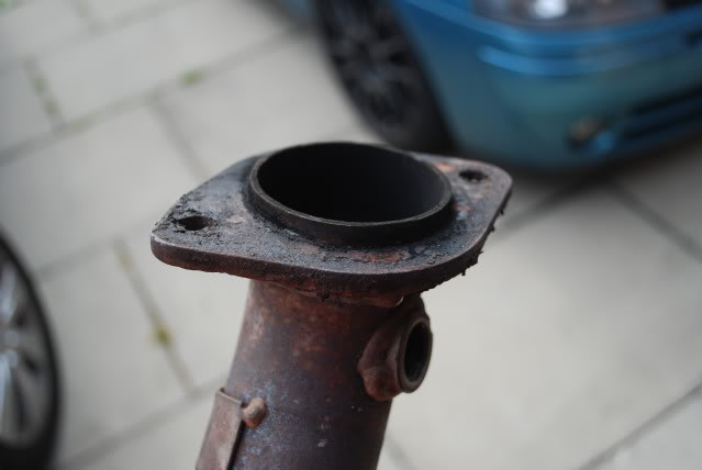

The flange on the manifold downpipe is different between valver and williams, its rotated 90* degrees...so you would need a williams decat
  Track valver + Ibiza FR
I don't really know how to describe it but on the valver one, the centre section end flange on the decat, the gholes are horizontal and on the manifold end they are vertical. On a williams decat are they both horizontal?

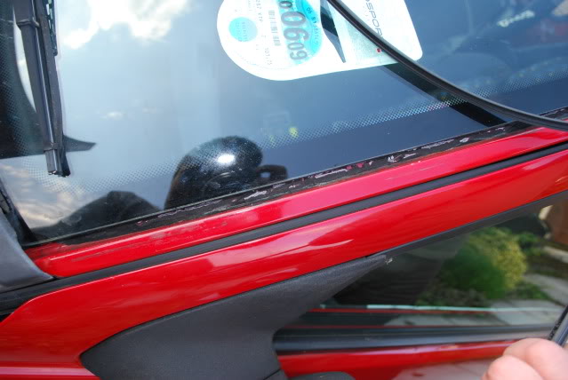

Over the past week I’ve been doing a few things. When I bought the car it didn’t have a windscreen seal.
The windscreen was still siliconed in so didn’t leak but to fill in the gap I thought it would be best to get a window seal. Picked one up from a locally scrappy’s off a 1.2 for £3. Tried fitting it to the valver and discovered the windscreen isn’t in the centre of the frame, it’s slightly too far to the drivers side. This means when the seal is put in, on the passenger side there is still a gap of about 5mm so the seal simply falls out again. To solve this problem I just put some clear silicone under the seal and pushed the seal in.

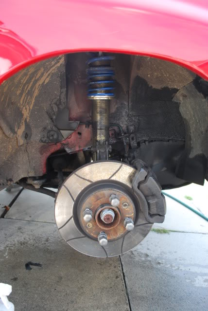

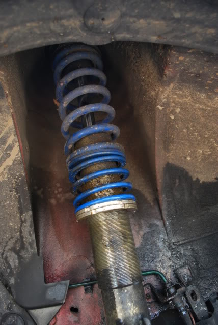

The car was a bit low when I bought it so I though I’d lift it up a bit seeing as it’s on coilovers. So started by taking the wheel off and cleaning them up by spraying AG engine and machine cleaner and cleaning the threads with a toothbrush. Before adjusting them I measured the distance from the top of the hub mounting on the coilover to the bottom of the spring. Then I’d adjust the coilover on the opposite side to the same measurement so they would both be the same height on both sides.

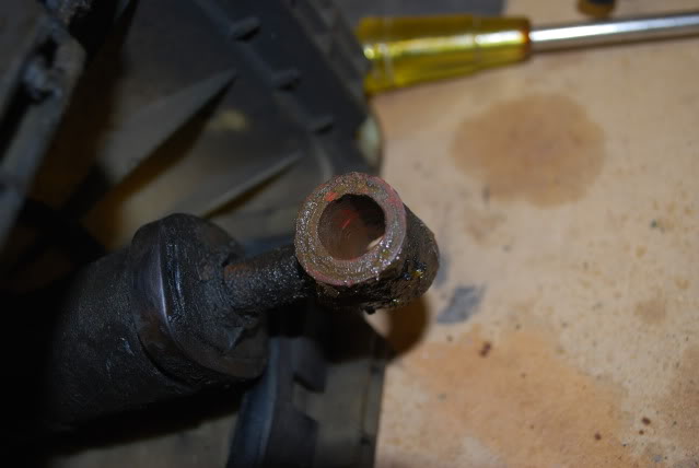

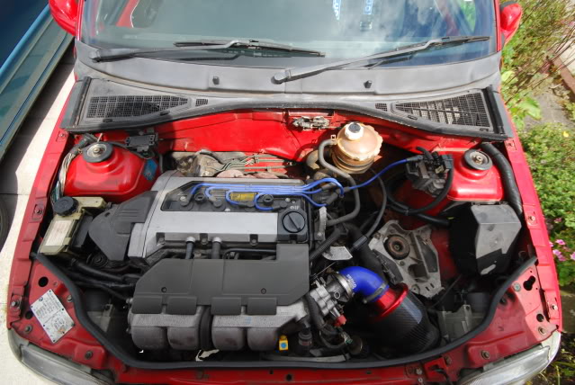

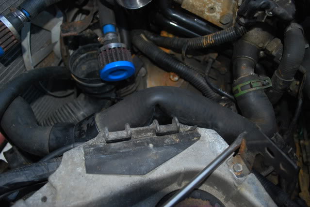

Having a look in the engine bay I noticed a few pipes with kinks in. I found out what the pipe was and it’s the main coolant pipe that comes out of the block and into the radiator.
On the drive home the car didn’t overheat at all which I’m surprised about. I just need to drain the coolant and adjust the pipes and jobs a good un I hope.

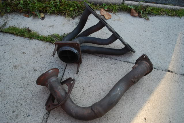

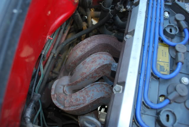

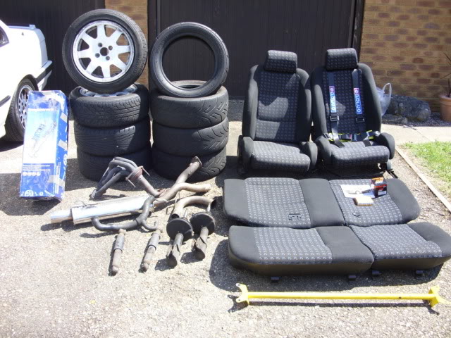

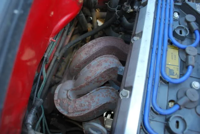

The car came with a few spares as well and this included a Williams exhaust manifold and downpipe. I’d been told that this gave some more power and the Williams manifold is tubular where as the valver manifold is cast and quite a lot heavier than the Williams manifold.
Valver manifold
Williams manifold and downpipe to go on
I dropped the downpipe off the bottom of the manifold and found you can’t get the downpipe out of the engine bay until the manifold has been taken out. You can get it out by taking the offside drive shaft out but seeing as I was going to take the manifold off anyway I though I’d just leaving hanging for the mean time.
Whilst I was undoing the eight nuts that hold the manifold to the block, I realised the shaft that the nut was on was also spinning. I was using a 10mm ratchet spanner and continued the whined the nut out. Suddenly the spanner stopped and I realised what had happened. I’d wound the nut out and hit the manifold and I could turn it any more because part of the manifold was in the way but I couldn’t wind it back in because it was a ratchet spanner. So I was stuck for a while.
Then realised it was only a small part of the manifold which was stopping it so got a screwdriver (acting as a chisel) and a hammer and ‘gently’ removed the part and all was well :). After all eight nuts were off I tried to remove the manifold and it was still solid. Then I realised there is a strut that holds the downpipe end of the manifold against the block to stop the manifold from moving with engine movement, but as I found out the bolt was bloody tight!!! Managed to get it off eventually and then sure enough the manifold came off easy enough.

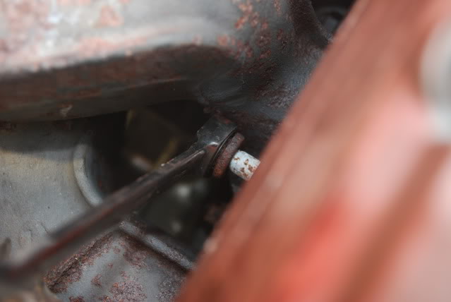

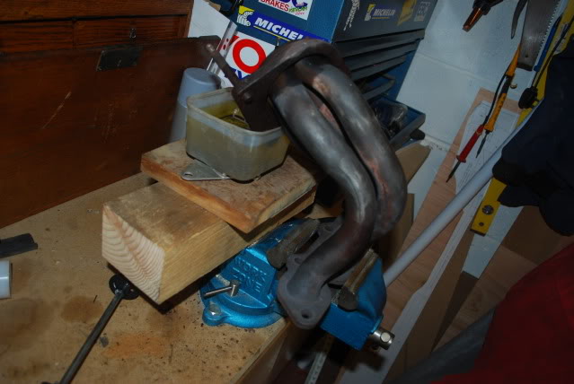

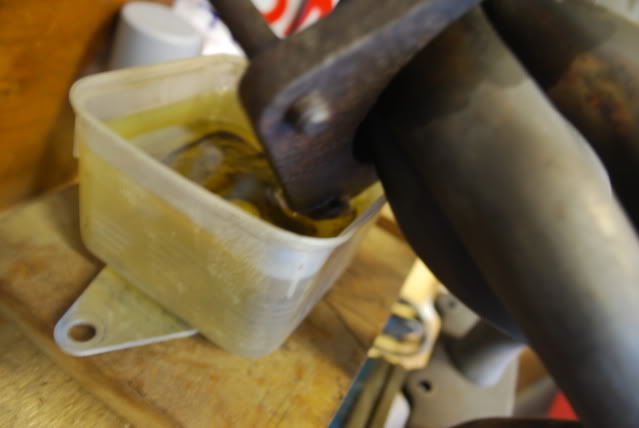

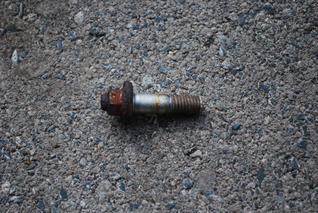

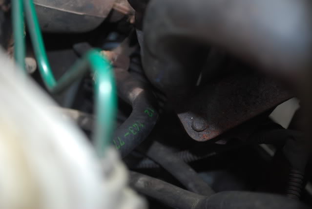

On the end of the manifold where the downpipe attaches there is a mount to hold the manifold solid against the engine block so when the engine moves, the manifolds moves with it to prevent the manifold from cracking. Anyway, the last person to take the manifold off had sheared the bolt wasn’t sure how to get it out so tried soaking it in paraffin for about three days to see if it did any good. I didn’t want to soak the whole manifold in paraffin so rigged it up using a vice and a few blocks to wood to hold a tub of paraffin up to the bolt.
That didn’t loosen the bolt so back to square one. Couldn’t be bothered trying to get it out so in the end just drilled it out using a 9mm drill in a hand drill. It perhaps wasn’t the best way to drill it out, me and my dad had some hairy moments but all came out well in the end.

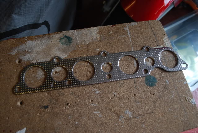

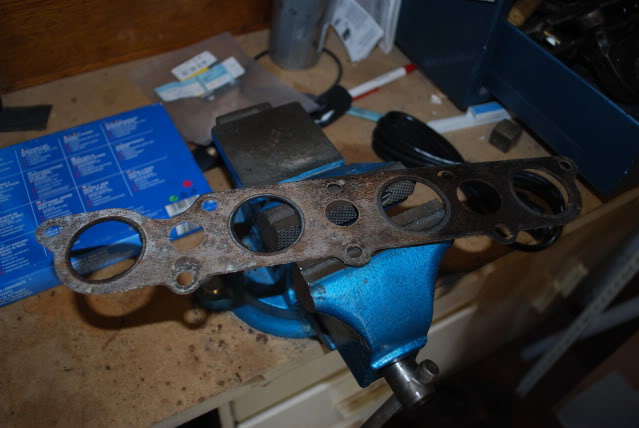

Got a new gasket for the joint between manifold and block
Old
New

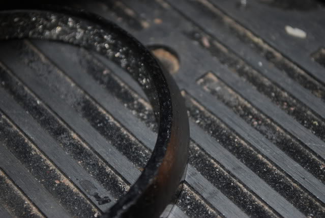

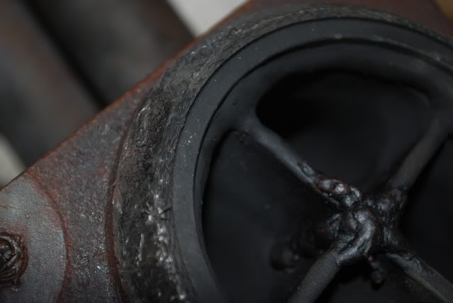

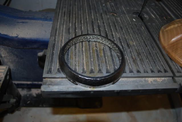

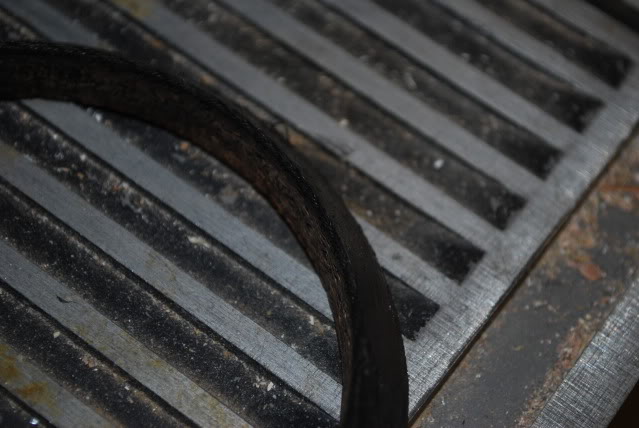

And a new fire ring which goes between the manifold and downpipe. Here you can see the thicknesses of the old one compared to new.
Old
New

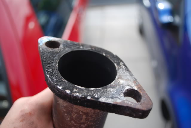

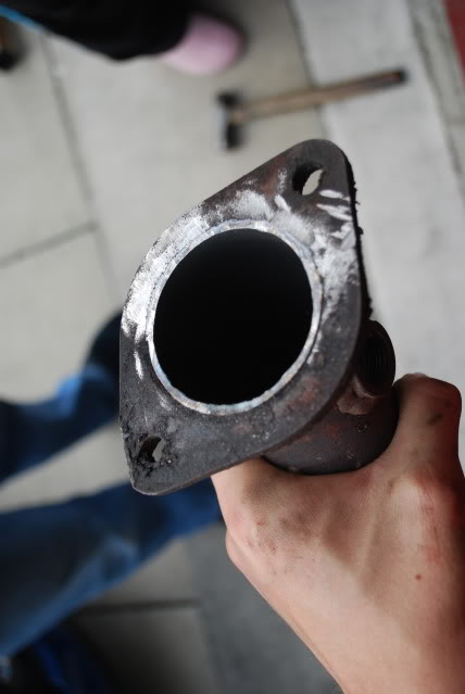

Also went to connect the downpipe to decat and found the downpipe has a slight flange on it and the decat is flat.
Downpipe
Decat
So out came the grinder and:
All good and connected the rest of the system up wth no problems using exhaust assembly paste so hopefully they should all seal. Had a look over at everything in the bay just to check before I started it and found one of the power steering hoses is quite close to the manifold.

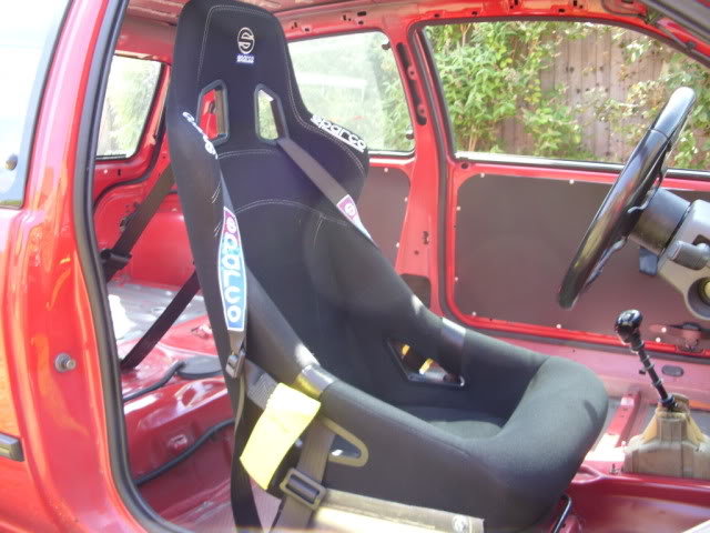

I’ve also started putting the passenger seat in as well but not finished yet.
