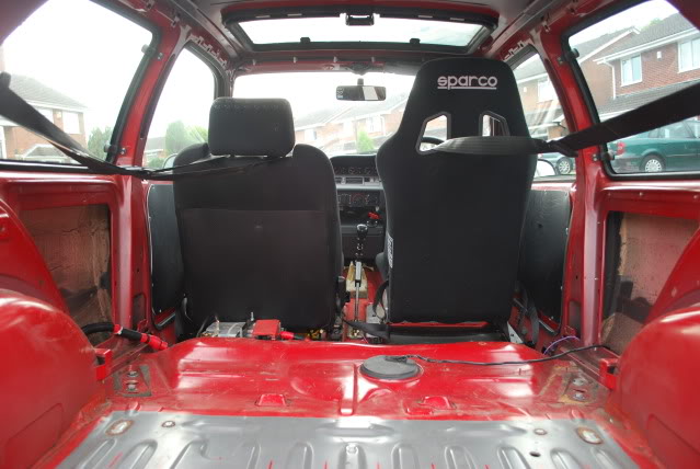

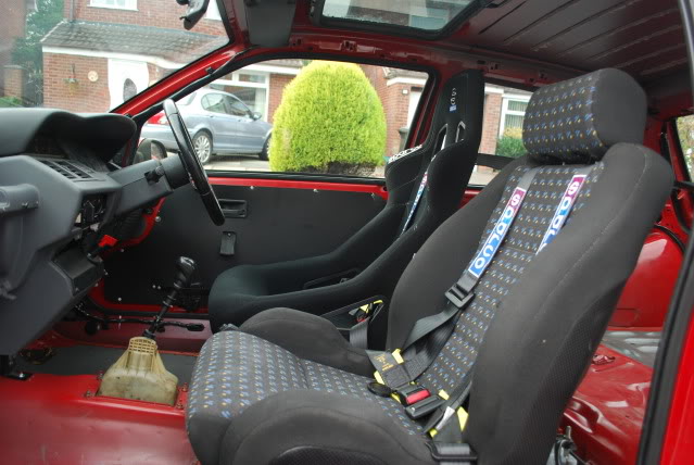

As I said in the last update, I’ve finished putting the passenger seat in. It’s the standard seat but running with Sparco 4 point 2 inch harnesses, it’s by no means ideal but I won’t be sitting in the passenger seat so I’m not that bothered.

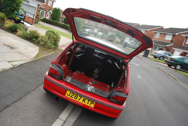

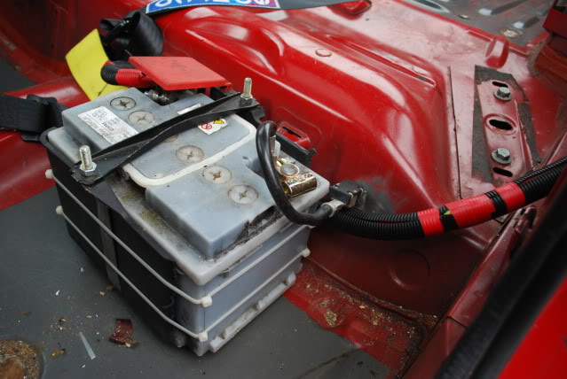

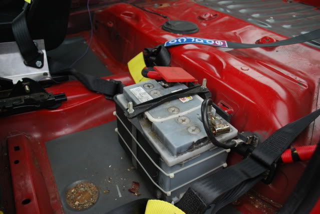

When I bought the car the battery was installed underneath the car at the rear where the spare wheel used to be. Apparently it was put there to help the centre of gravity but surely the battery wouldn’t make that much difference if it was in the rear left of the boot. The battery wasn’t fused either so it could have been quite a fire hazard so thought it was best to move it to the inside of the car. Ideally I want to keep the boot floor clear, to make it easier when transporting the track wheel, so the only other places to put it were the front passenger footwell or one of the rear passenger footwells. I decided to put it behind the passenger seat and put it on a fused earth lead which I bought or jord (f0xy) thanks again for that mate.

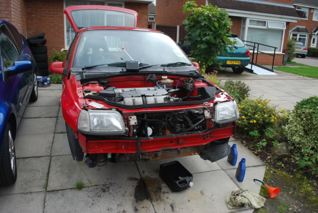

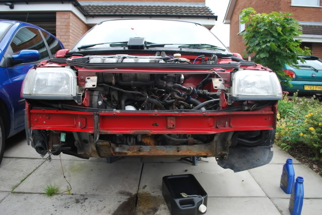

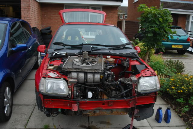

I needed to do a few jobs in the engine bay so to make it easier I removed the bonnet and front bumper.
Contacted the fella I bought the car off about if he knew when the cambelt was last changed, he didn’t so thought it be a good idea so change both of the belts. Took the auxiliary belt off by loosening the pretensioner but we couldn’t get the locking mechanism of the tensioner undone so we just tried to force the tensioner loose and sure enough it worked. Took all the cambelt covers off with a bit of help from jord and then changed the belt for a new one and timed it up. I didn’t have a new auxiliary belt at the time so got one about a week later and put it on and tensioned it up.
As I said in an earlier update, one of the main coolant hoses had a kink in it but I didn’t know exactly why. It looked to be the right shape and go in the right direction but it which ever way I turned I, there was still a kink in it. I came to the conclusion that it was the wrong pipe. Anyway I was just looking through some of the spares I got with the car and found a virtually identical pipe so one of the previous owners must have known it was the wrong pipe, got a the right one but just never fitted it. So I drained the coolant by taking the bottom hose off the radiator. Then fitted the new hose and sure enough it fitted perfectly.
I was going to change the engine oil and filter and the oil filter is on the front of the engine block so whilst the coolant was drained I decided to take the radiator out to make changing the oil filter a lot easier.

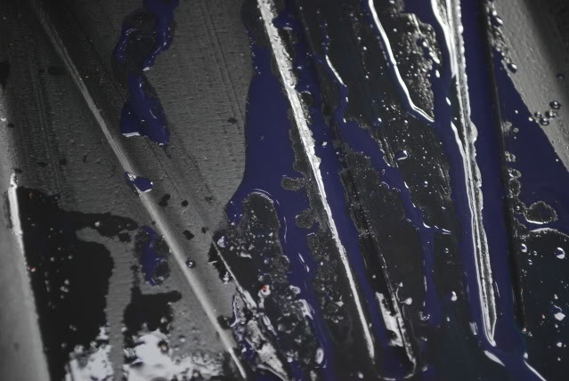

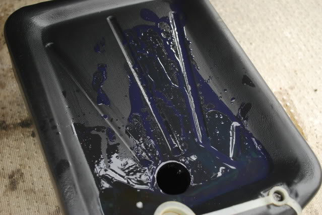

I didn’t know when the engine oil or the gearbox oil was last changed so thought it be a good idea to change them both. When I dropped the gearbox oil I found it was purple, thought it was a bit strange but anyway.

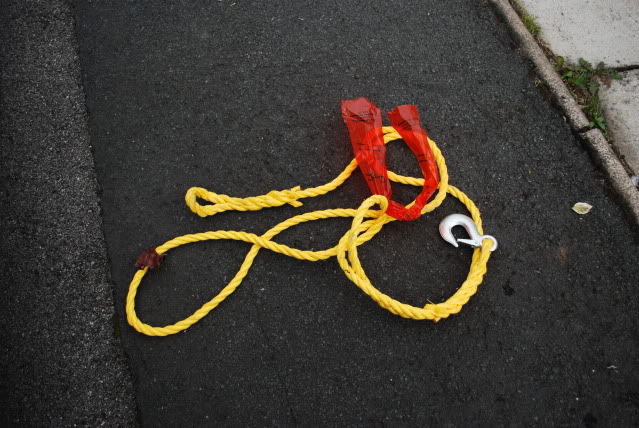

My new tool to get me out of some holes which will be staying in the car from now on
