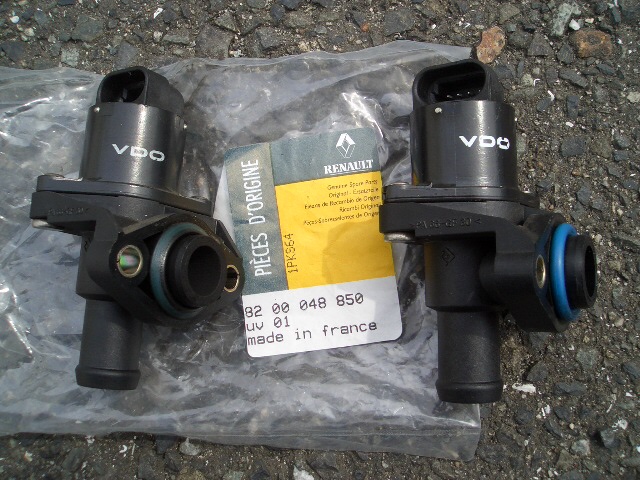

Rang Renault parts for a price on a new valve- £131.65 inc vat would you believe!!!!!
I fell off my chair, or slipped anyways, for something you could hide in your fist closed. If it had been cheap enough, would have tried it. He was helpful (Steve at Lifestyle Brighton parts) and suggested it could be air getting in at the pipe around the ICV. Or somewhere else

new icv is £30 from euro. it's your throttle body though, return spring pulls it to one side and wears the butterfly and starts sticking. need to strip it fully and get rid of any ridges on the body where the butterfly sits.

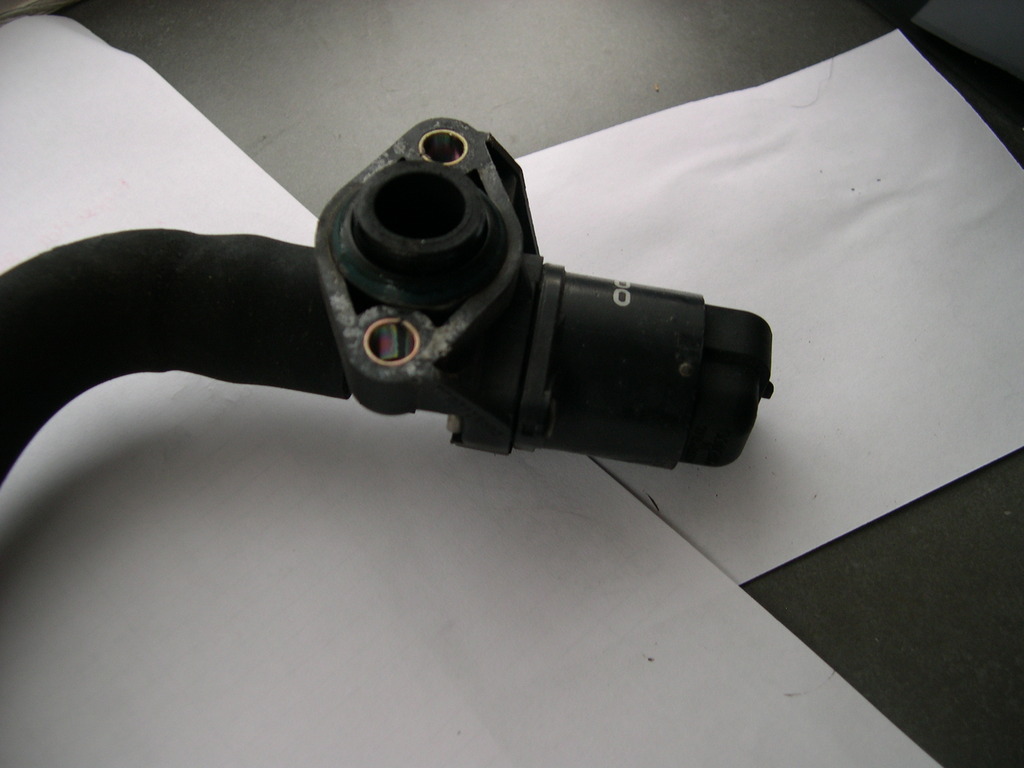

As you can just about see here on the photo i took before i cleaned, the seal is there.
Looks pretty grim tho, any idea how easy to get a new one? where from?

For the sake of £30 I would be tempted to put a new one in.

Took the ICV and pipe off again, (Checked pipe was airtight) checked that the greeny blue sealing washer is there, it was. Added a little extra padding and replaced, make sure the bolts were tight enough. Disconnected battery for 5 mins, then turned ignition on and off 10 times to reset the ICV.
Took for a spin, and its better than yo-yo, that seems to have gone. Then as the 5 minute drive contd, whilst at traffic lights and junctions the revs returned to around 1000, it took an extra tiny bit longer to do that as the engine warmed up. At the end of the drive as i reversed into my parking bay, it revved to 2000 and didnt return, and i dabbed the accelerator pedal and it went down to 1000 rpm again
So have noticed the issue of revving at idle after changing/slowing down and stopping gets worse the warmer the engine. For all i know (might try tomorrow) the yo-yo revs may come back after a half hour drive
My options left now are:
  1. Purchase a new ICV for around £30 and grind off the old one, and nut and bolt the new one on
  2. get a brand spanking whole new ICV with new green seal and angled entry at £131 from Renault :-(
