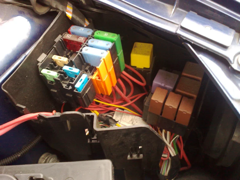

Does anyone have a key / diagram for relays on a non-sport ph2?
Here's a pic (similar but not identical to my Clio)...
I think one the thin brown relays is causing starting problems.
I know I can swap them around & try to narrow it down by process of elimination but it would be very helpful to know which relays are for starter motor / injectors etc. ???

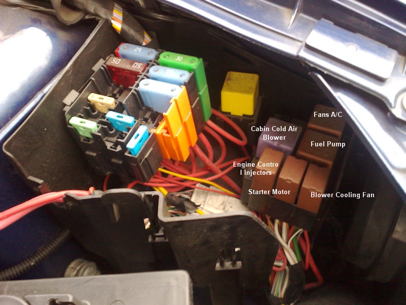

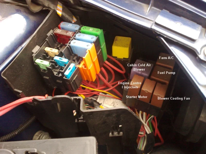

No problem! I've used the pic above to label the relays according to the info that I've sourced.
I can't be a 100% about the two big brown relays, it could be the other way around, i.e. Fuel pump nearest to wing & A/C fan control nearest to the 3 mini-relays?
There are some more pics & breakdown of what I've done on my project thread here...
Mk2 Ph2 1.4 Expression
This might help too...
The main engine control relay on your 1.4 Clio feeds the power to the injectors via fuse 1 (30 amp) which feeds relay base terminals 1 & 3. This relay is earthed via terminal 2 on 'relay to ecu' pin no 39. If you remove this, try bridging out relay terminals 3 & 5 with a piece of wire now try to start car.

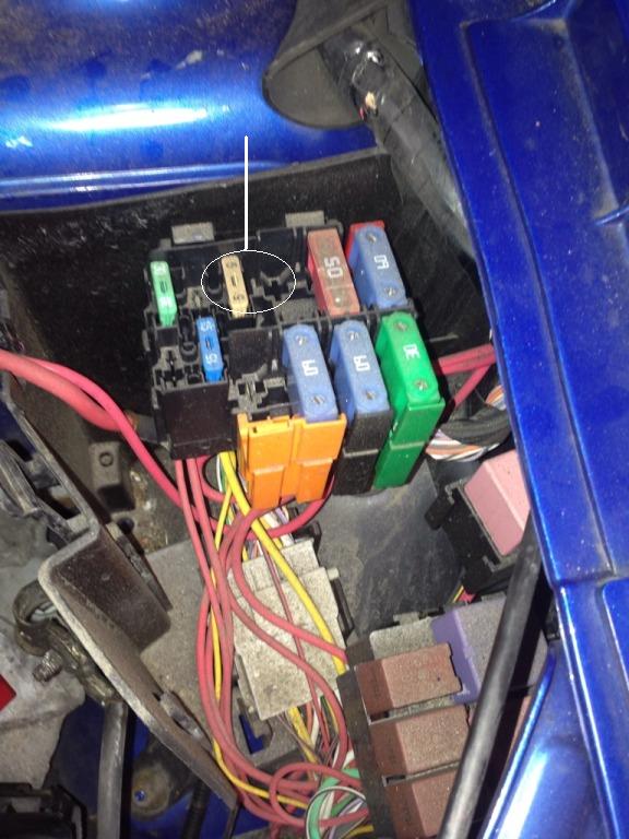

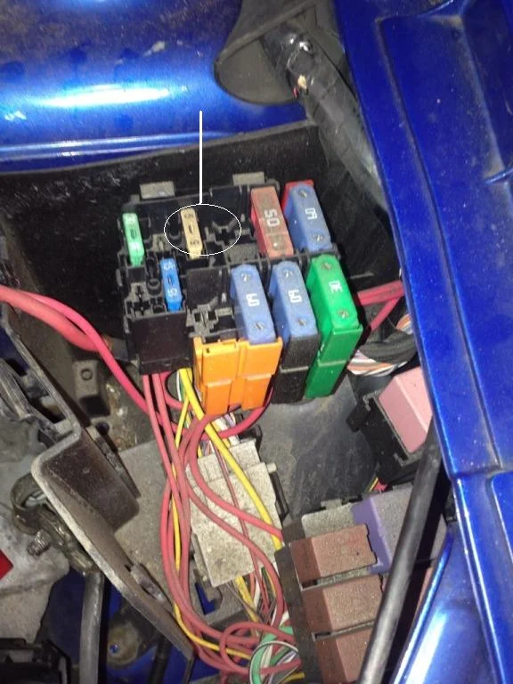

Most welcome! Hope you get it sorted... Here's a pic of the 5amp fuse for the immobilizer circuit (circled in white). If it's blown you may get a solid red light that doesn't extinguish when you turn the ignition on. If you remove the fuse box cover on the passenger side of the dash, just behind the door with the airbag sticker on it, there should be a spare one!
Also might be worth removing the mini relays (as above) giving the terminals a good clean (also a tad of WD40 or contact cleaner in the female relay sockets) and putting them back in a different order. Mark them up first with a permanent marker so you remember which one is which.
