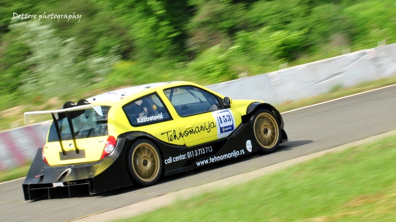

1) An Eastern European chap on here has built a Super Touring spec Clio (used a Laguna BTCC t-car as a donor) which has a mental amount of GFRP/CFRP aero bolted to it. Bear in mind this is full race spec and therefore comes with the price tag of one-off composites...

Found the super touring thread: http://www.cliosport.net/forum/showthread.php?586255-Clio-SuperTouring&highlight=super+touring+clio "Because race car" is rarely so appropriate:

Thats a diffuser and a half on that race car lol. I love the look of the 'painted on diffuser' on the white clio, but mines an arctic blue, so don't think it would look right?

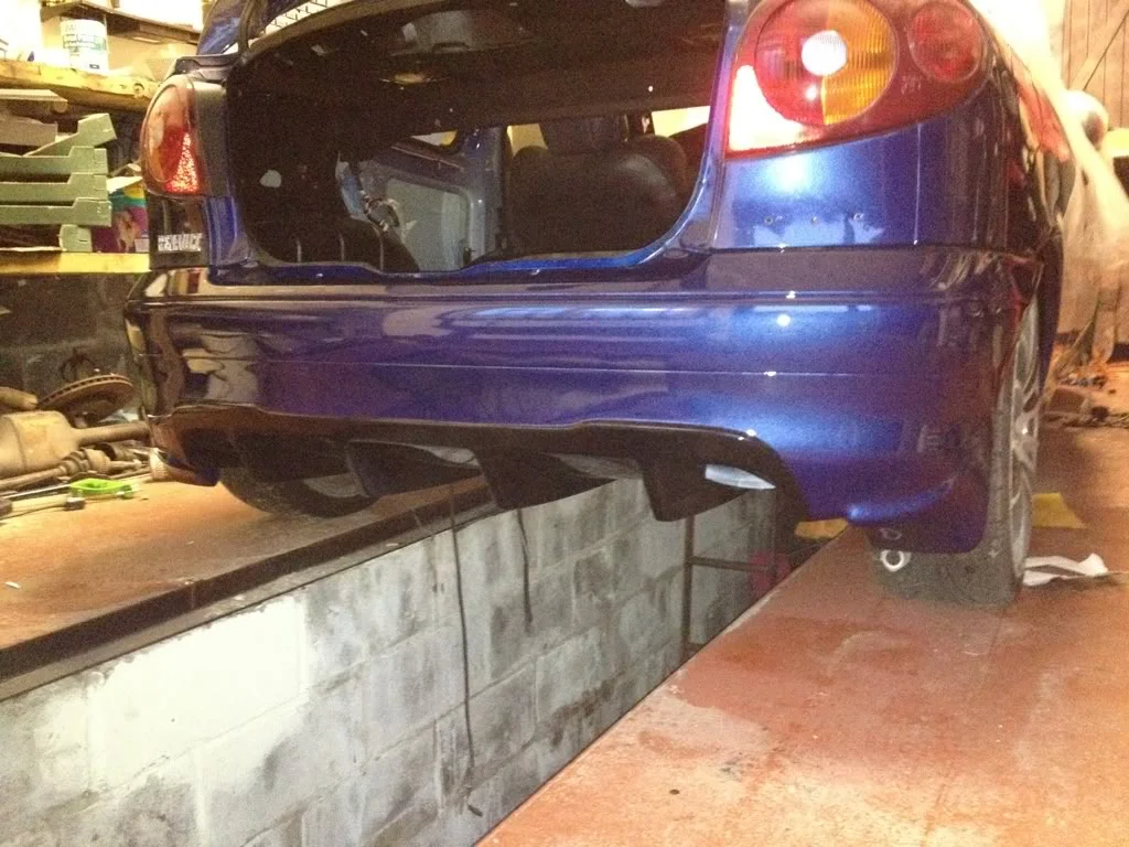

Just like to add I did ths on my megane as above and it very nearly broke me!
Trying to mesh the 2 together is a nightmare and although I'm unfamiliar with the Clio I had to cut my wheel well out on my megane so I wouldn't be surprised if you had to do he same
Cut wheel well out, got some sheet metal and welded it in place of the big hole.
Cut bumper roughly, used lots of tape to stick the diffuser to it, put it on and off the car 10000 times to check for fitments before using brackets and fibreglass to bond them together, I then took it to a body shop to get it painted.
Costs:
Diffuser - bargain at £100
sandpaper and fibreglass- about £80 worth
brackets - £10
paint £250 + £150 after long life broke it when fitting the exhaust that I had custom made to fit the cutouts

Could you not bolt it around the wheel well? Plus ive got the 182 replica exhaust so im assuming that'll cause more problems. Yeh same as in that picture is what im going for! quite like it actually. Only i'd want the exhaust tips to stick out so not sure how that would fit either.
