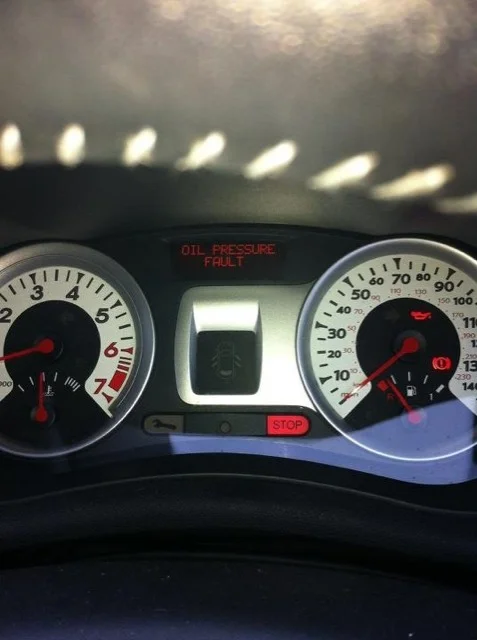

Hello was hoping for some help.
My mates GFs car has broke we think. This morning the dash went mad and threw up an oil pressure fault:

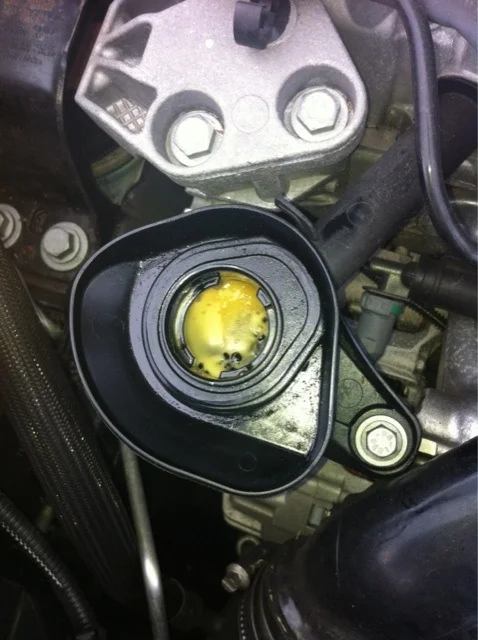

So she stopped and turned the car off. My mates had a look inside the oil filler cap and found this:
Now my 1.2 always had a bit of white stuff around the oil cap but nothing like this.
Luckily it's still in warranty from the dealer so will see what happens but has anyone got any initial thoughts as to what it could be?

I can't really make out from the picture, is that lining the pipe or is it actually full up with that s**t?

Would have had a problem sooner then. BS I reckon.
Did you or anyone else check the other symptoms of head gasket failure?
A lot of condensation maybe getting in from a leaky seal?
EDIT: Actually it can be a symptom of too much oil, but I still think it would have happened earlier.
And the oil pressure warning is probably because it is clogging the breather system somewhere?

I had a similar substance when air was getting into the powersteering system, but that was in in PAS resevoir. Too much oil would never do that. Big LULz.
possibly risk sounding dumb here, but would over filling the engine with oil chuck aload of blue smoke out the back?
It can cause that. If it reaches the level of the crankshaft it can whip the oil up into a foam, which could be what that is. That is a lot too much oil though.
Point well made, i should clarify: it would have to be a massive amount of overfilling on the oil, but that would kick up a fault right away, shirly?
Yeah that's right, it would have to be seriously overfilled to reach the crankshaft, which is why what the dealer said is bullshit as it would have happened when she was driving it home after the service, not after 2 months.
I've got it in writing that oil pressure is fine. They put the correct amount of oil in and said to bring it back if anymore problems
The oil pressure fault could have been high pressure then?
No, it's an oil pressure switch not an oil pressure sensor... It can only see when oil pressure drops below a preset value.
Luke, that mayo build up is normal in a tCe which is why you have to remove te remote filler tube and clean it when servicing. The wife's is exactly the same mate.

The wrote a full explanation of what the fault was and what they did to rectify it. Draining the oil has kept the problem away for now though
