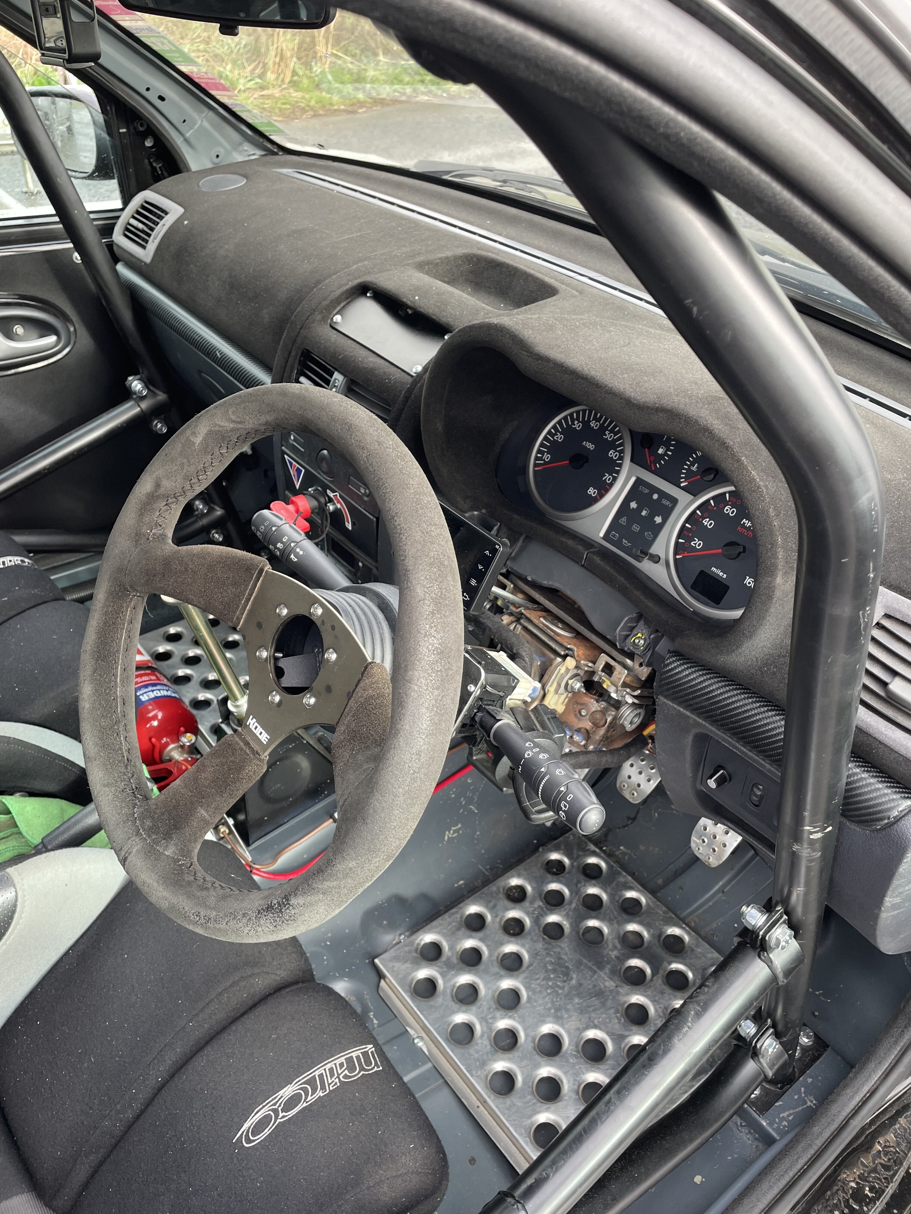

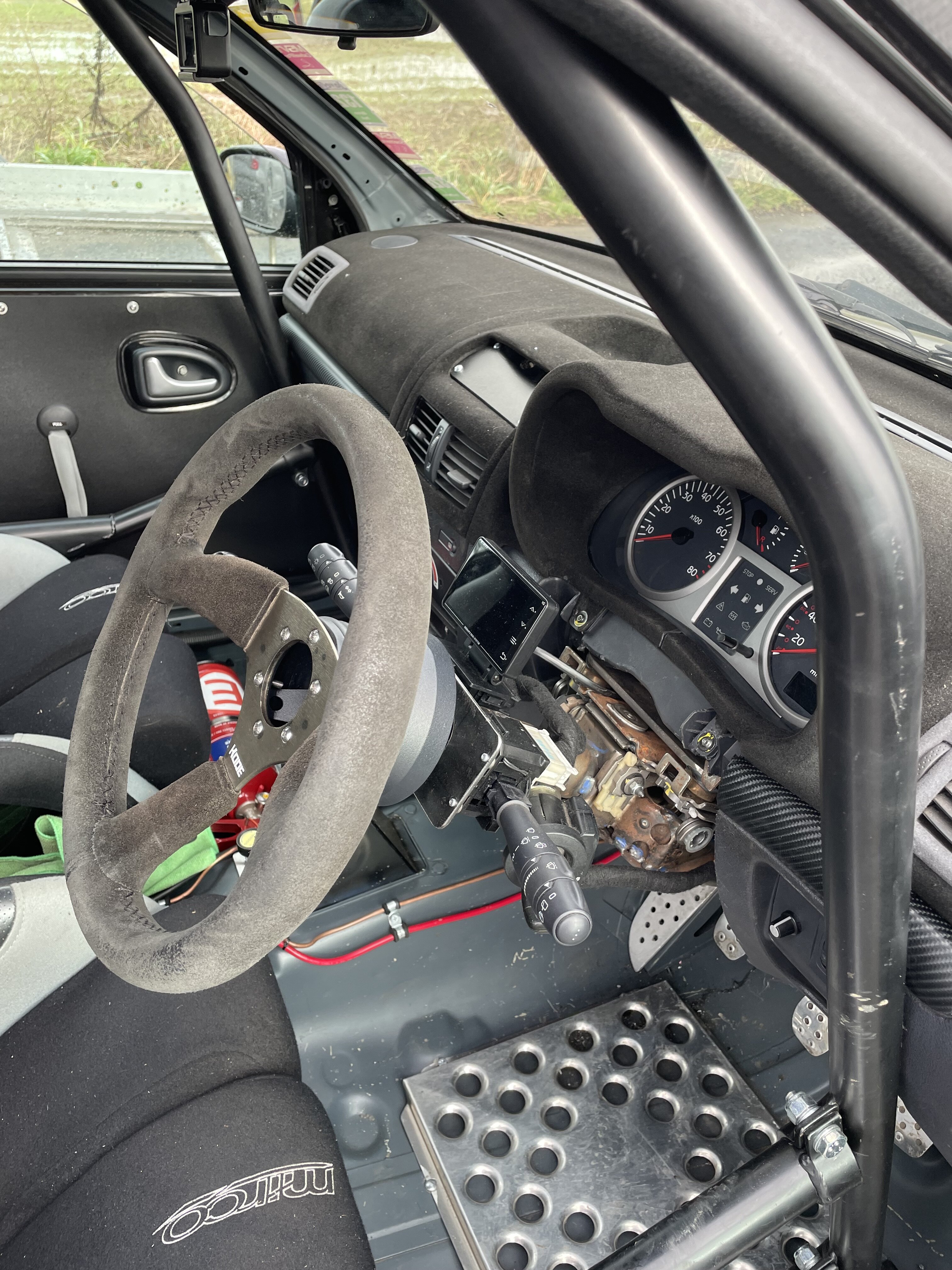

Conversion done & tested, what a game changer, no comparison to any of the other set ups I’ve tried.

You need be to handy at welding & fabrication or know someone who is, I’ve used a complete column from a MK3 cup as the cup still has ignition barrel & key & not the card.
So I cut the part that holds the ignition barrel off as it was square & cut the round ignition barrel holder off a MK2 column & welded it on.
Then fabricated a metal plate to mount the original MK2 indicator & wiper stalks on.
Next step was to extend the lower part of the column (the splined part) by about 3/4 cm, the MK3 end that connects on to the the rack will fit the MK2 rack no problem.
I then removed the MK2 column, top part of dash & clocks.
When I offered up the column I found the motor & controller on the Mk3 are mounted on the top so I had to completely cut the mounting bracket off the shell to allow enough space to get the new column into place.
I then fabricated a bracket for the two mounts closet to the steering wheel that was welded to the metal bar that runs behind the dash, then jacked the lower part of column up into position & fabricated 2x brackets that welded onto the shell & bolted to the lower column mounting points.
I finished it off by installing a Bruno steering MK3 steering electrical kit from Portugal & a MK3 steering wheel boss.

Any chance you could take some more pictures from inside?
Just to have a better point of view for the mounting, and how the motor sits, as it’s upright than the usual 172 epas.
basically any more info, so maybe we could have make some documents for others :)
