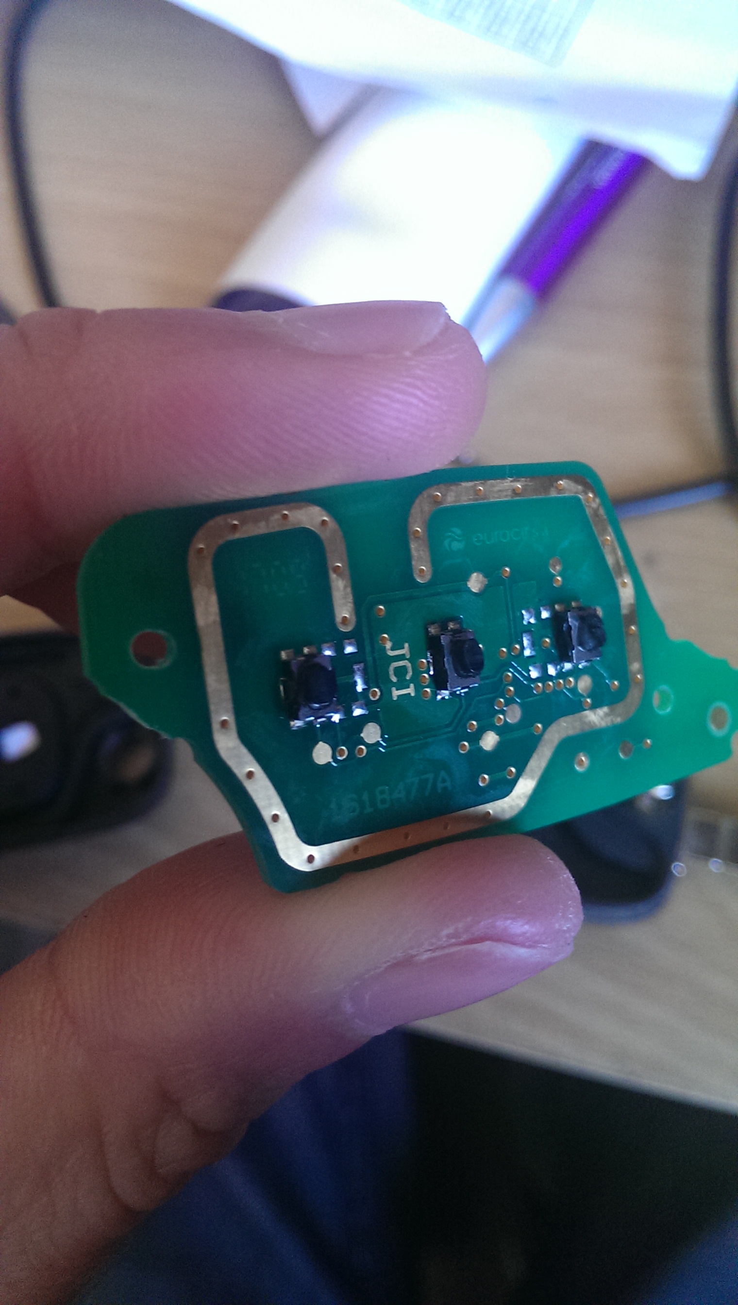

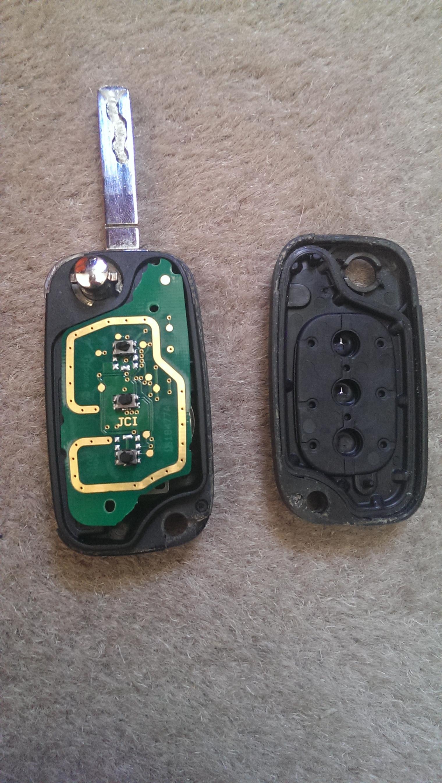

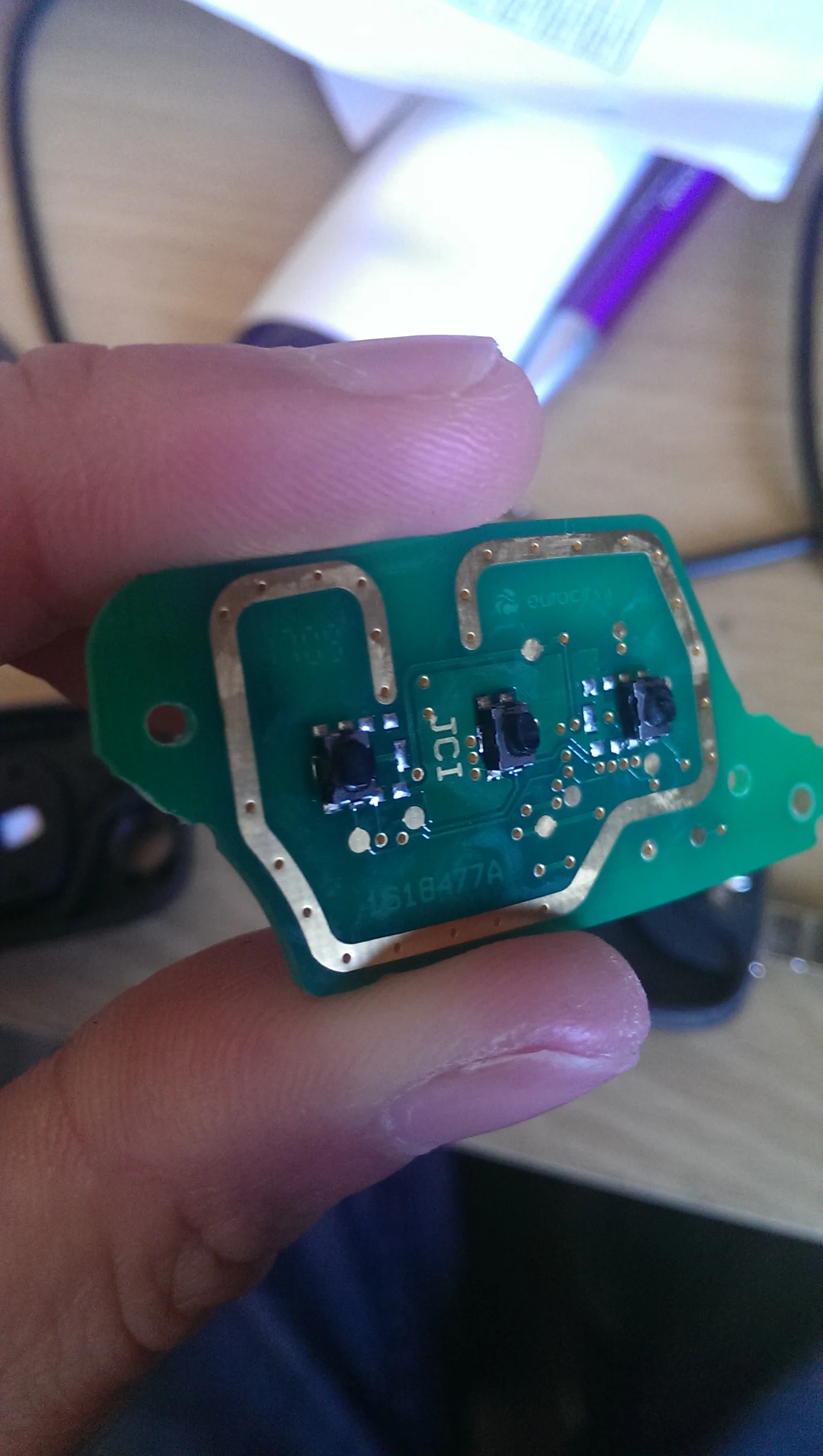

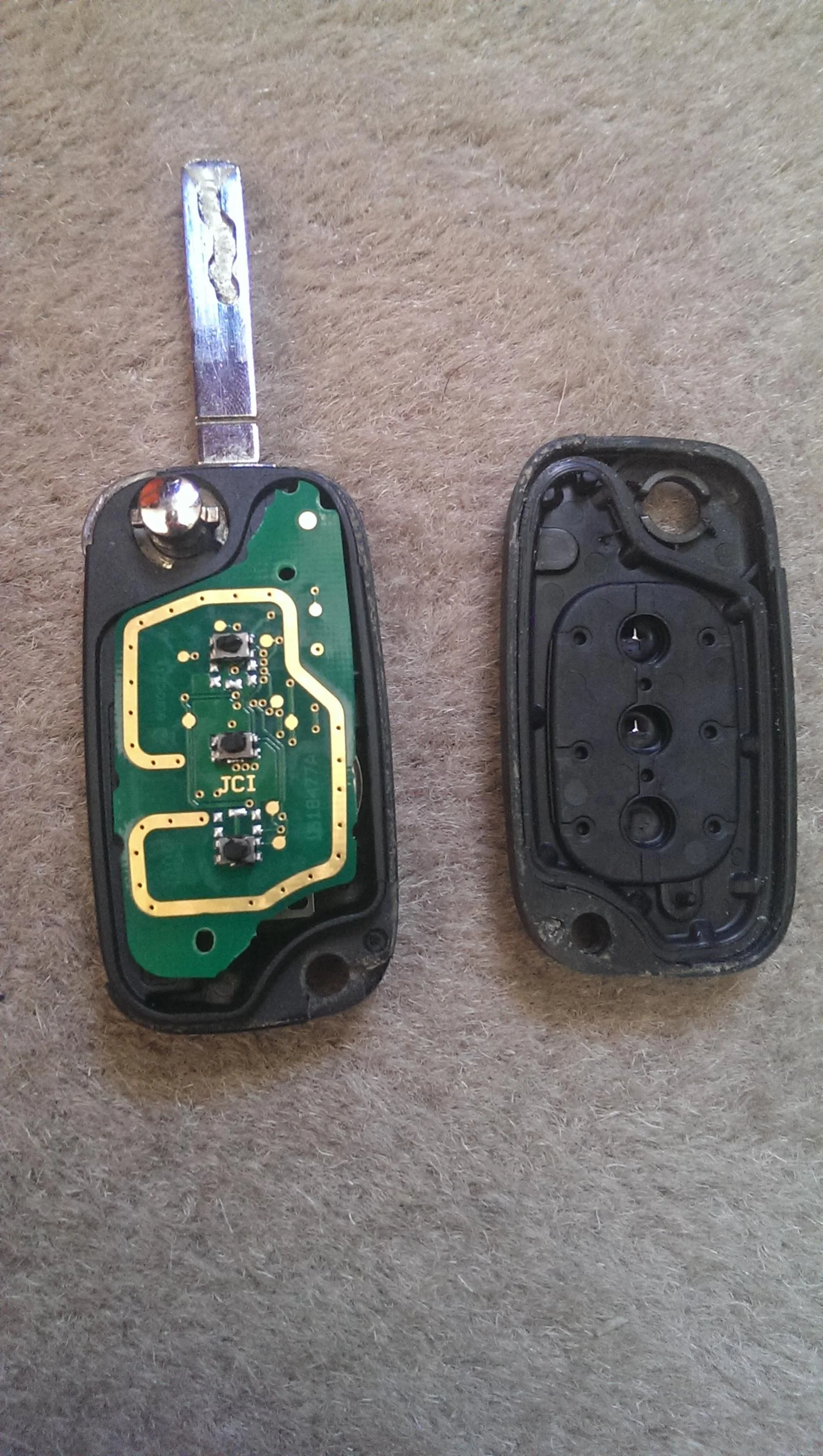

I accpeted that I might have to buy a new key so I thought I may as well just open it, even if it breaks... And yeah problem solved. Popped the fob open with a pen knife where the keyring goes. The rubber that makes the connection to the switch has cracked so I folded a tiny piece of paper and placed it inside the rubber, so it was rubber -> paper inbetween -> switch. All buttons work and I don't need to go two finger hulk mode on it anymore. Saved £150, just depends if it will last... Thanks for your reply!
