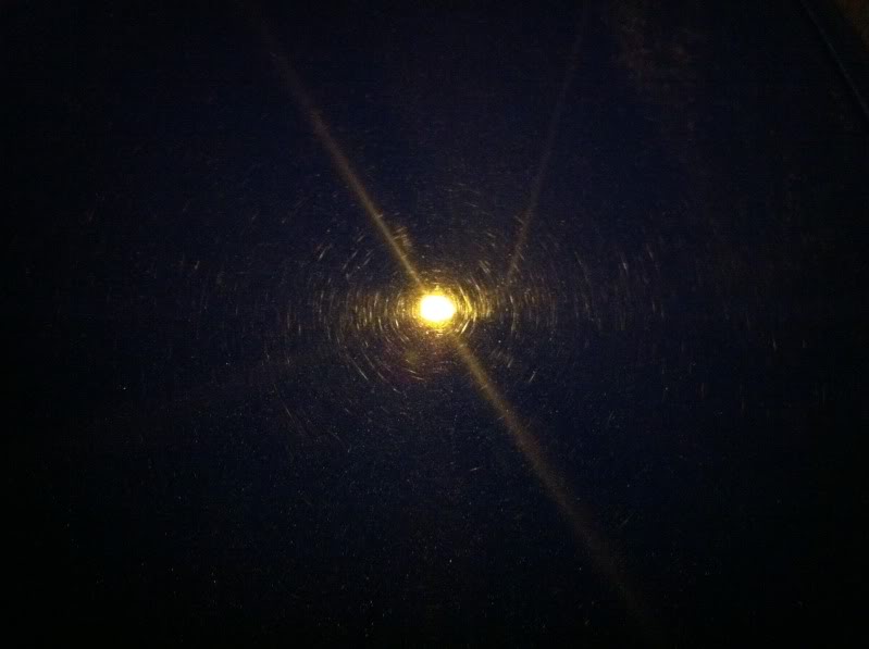

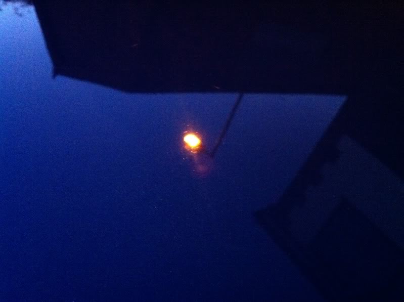

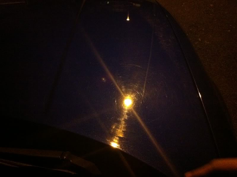

I took these photos a few nights earlier under a street light to show the extent of the swirls,

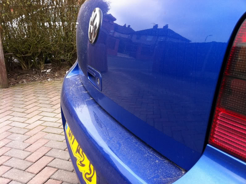

He brought the car around looking like this,

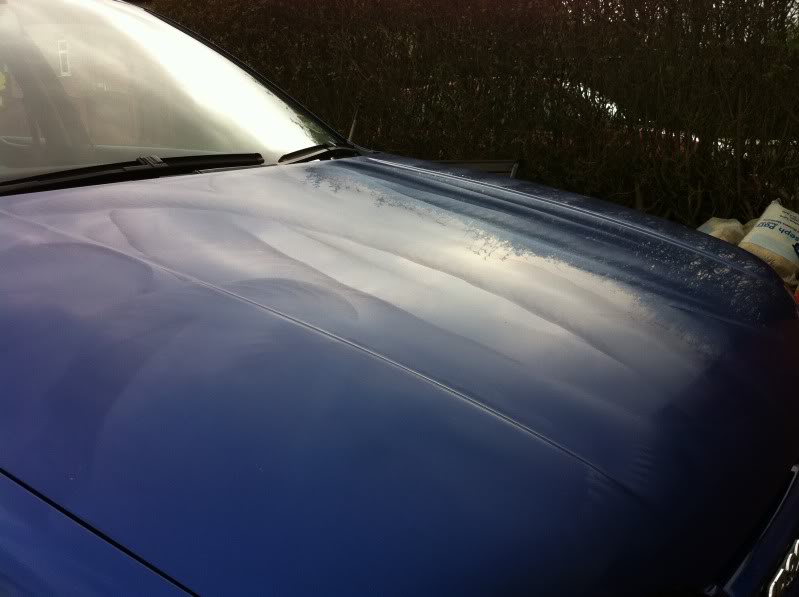

Using my DA G220 with a red meguiars cutting pad and some 3M fast cut plus polish I started on the cutting process,
Bonnet ready to buffed off with several buffing cloths

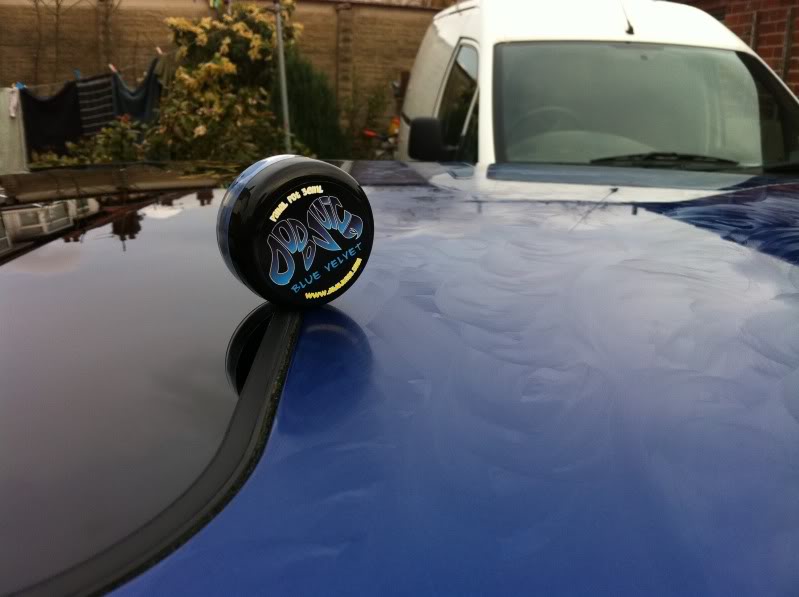

Then moved onto the final waxing stage which was done by hand with some dodo juice blue velvet,
Once the waxwas on we left it for a good 20 minutes whilst we did the final touches.

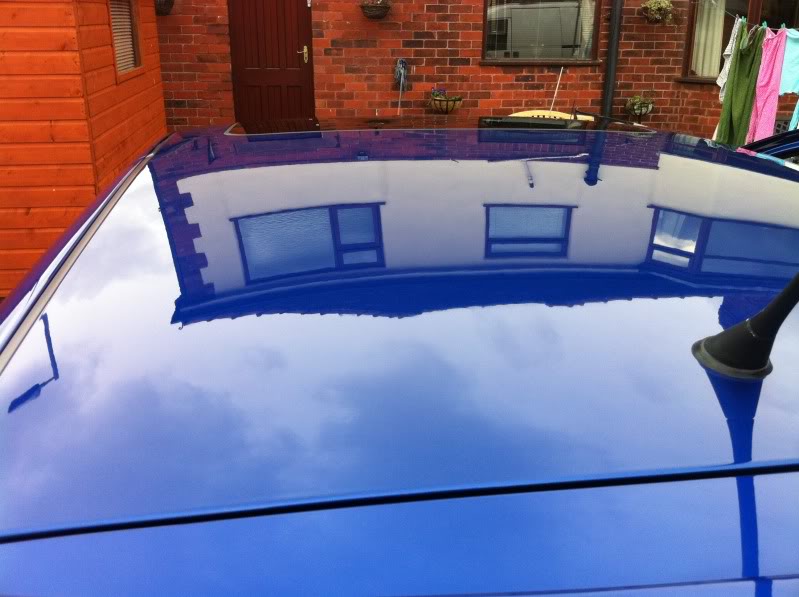

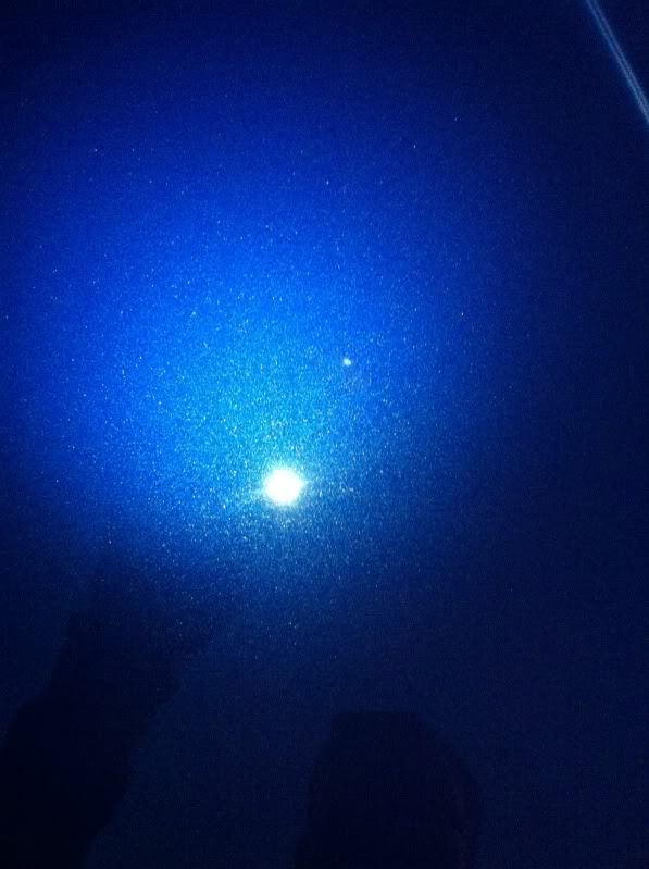

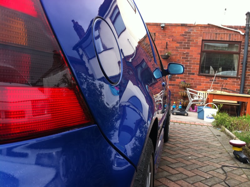

Here was the correction acheived,

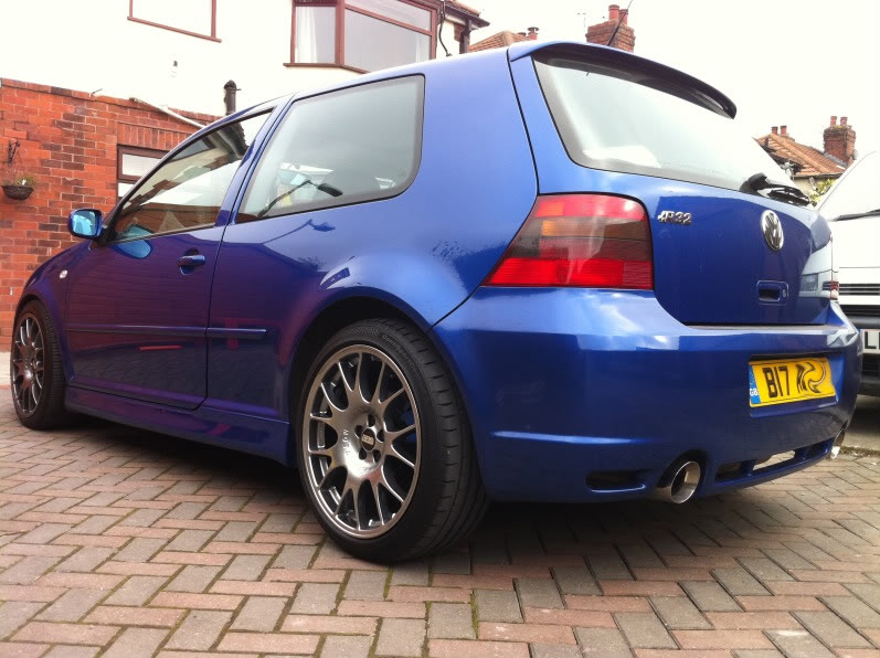

Ahhh the end, now for some shots we took in IKEA
Apparently this is High Definition on the iphone,

Couple of things, that paintbrush that close to the wheels is a massive no no! If the metal bit catches the wheel it'll take a decent chunk off. And they don't look like cheap wheels.
Other thing, with FC+ even with a DA you'll leave holograms so it's a good idea to refine the paintwork after using something so coarse on it. Somthing like 3M bluetop or Menz 85.
Also maybe start off with something a little less coarse next time and see how you go, general rule of thumb start with the lighest cut combo and work up until you're happy with the level of cut, that way you minimise clearcoat removal.

I have all of the 3M polishes green, yellow and blue, would you recommend using the blue top after green then....isnt SRP good enough??
I did start with a softer pad and the yellow polish but it wasnt giving the desired cut, I then changed to the green polish but kept the pad but agin the cut wasn't acheived so thats when i moved onto the cutting pad with the green polish.

Ah no problem mate good to see you started with low cut. Yeah Ultrafina is for refining, in some cases you can go green/yellow/blue but in most cases green/blue is fine.
SRP is definitely not a substitute for the UF mate, there's no real reason to use SRP after correction work. Maybe look into some pre-wax cleansers for use after correction, they give a good cleanse and a good base for waxes, also helps with durability of the LSP.
