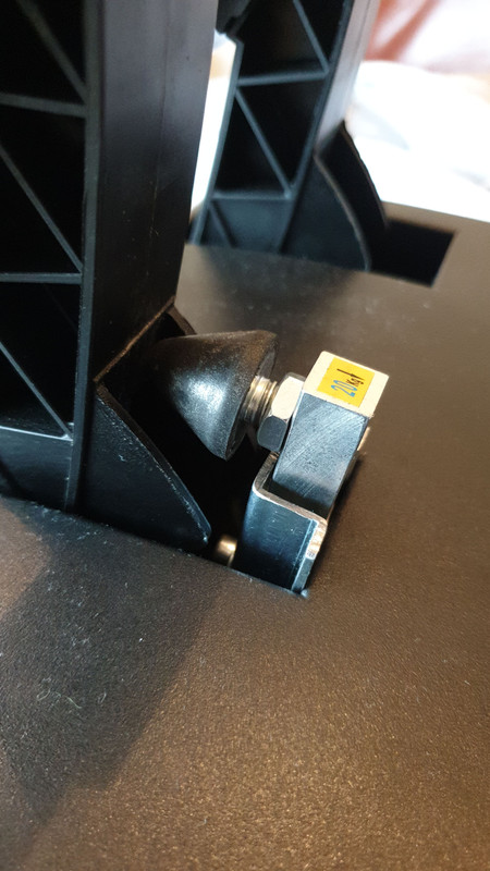

Well loadcell is in!
Feel is awesome!
Guide is here:
It really was dirt cheap!
Used the rubber cone included with the wheel, might need something a touch softer, the BBJ ones might help.

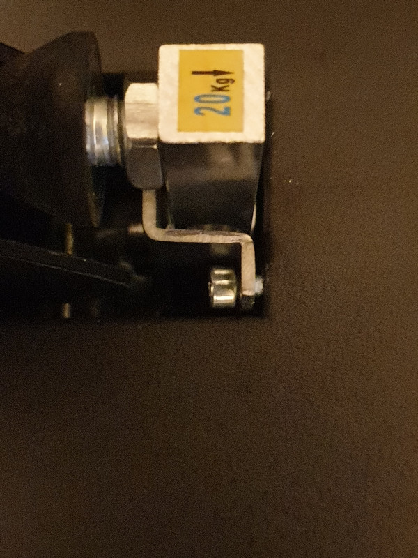

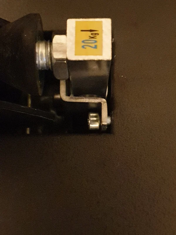

Things I did different:
- cut the top of the bracket so I could mount the load cell behind it.
Enlarged the top hole on the loadcell to M10
- tapped two M4 holes in the sides of the bracket so the rear of the load cell has some room
Do not mount the load cell solidly to the bracket, one of the sensors won't work and make braking next to impossible!
And if you're bored, the cones are called conical bumpstops and come in all shapes and sizes....
