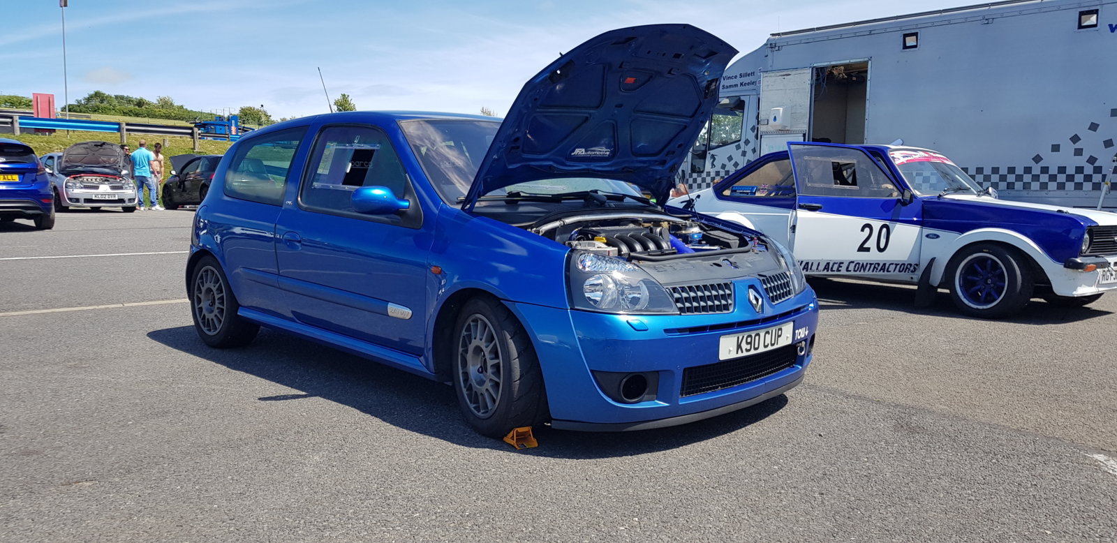

Awsome day at Lydden with my brother-in-law. Car was fantastic. Definately the quickest I have been round the track. Dry weather, Toyo R888r's and the BC coilovers set to hard all round. Grip was immense. I would highly recommend the BC coilovers.

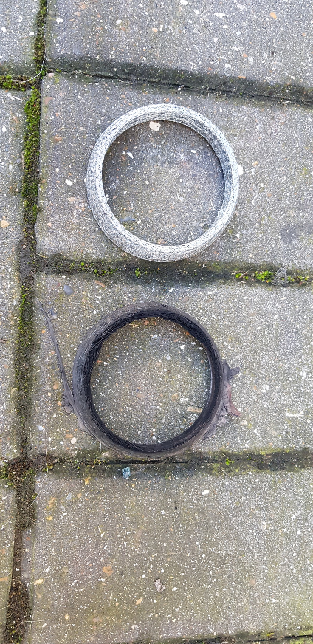

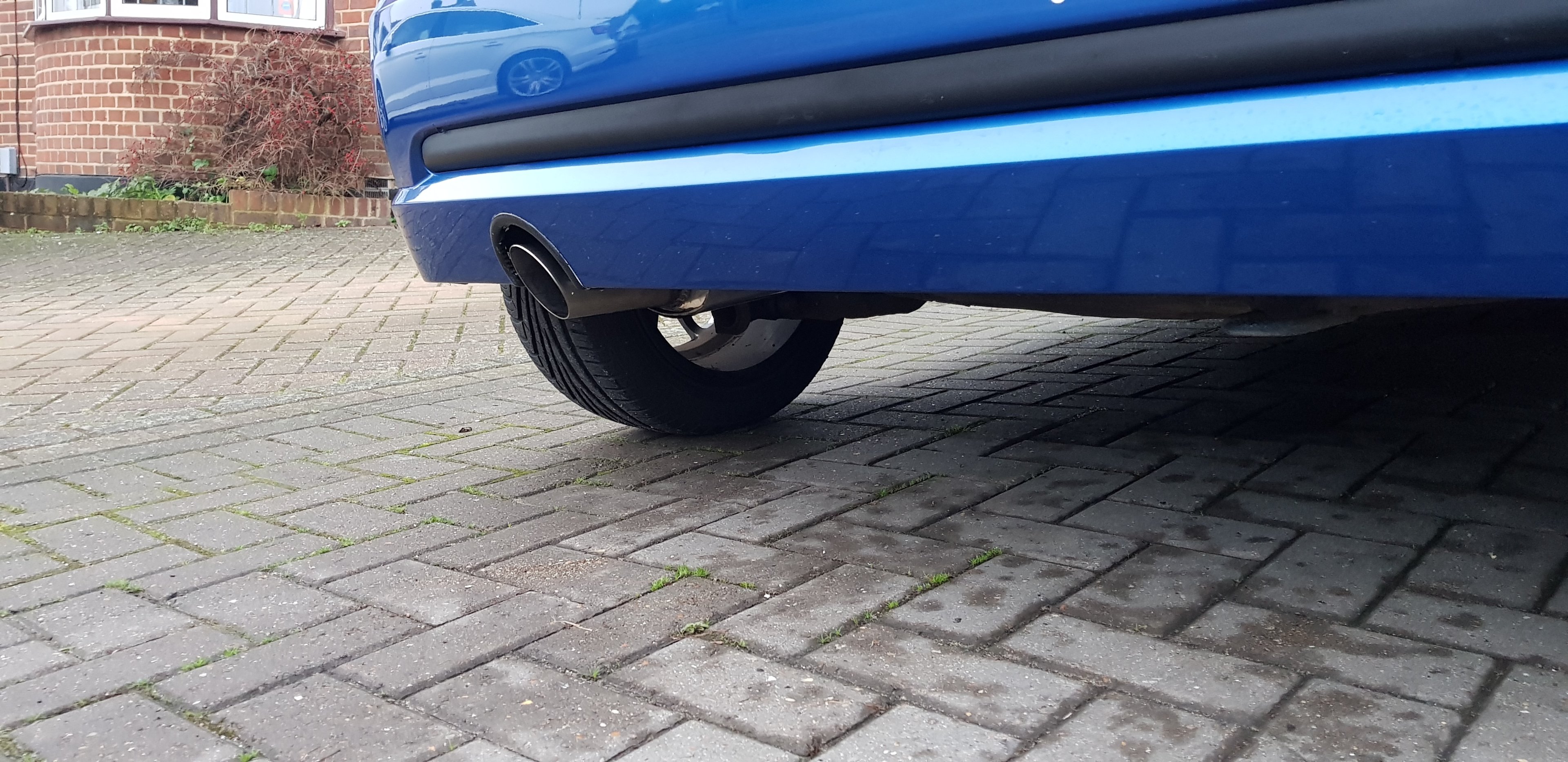

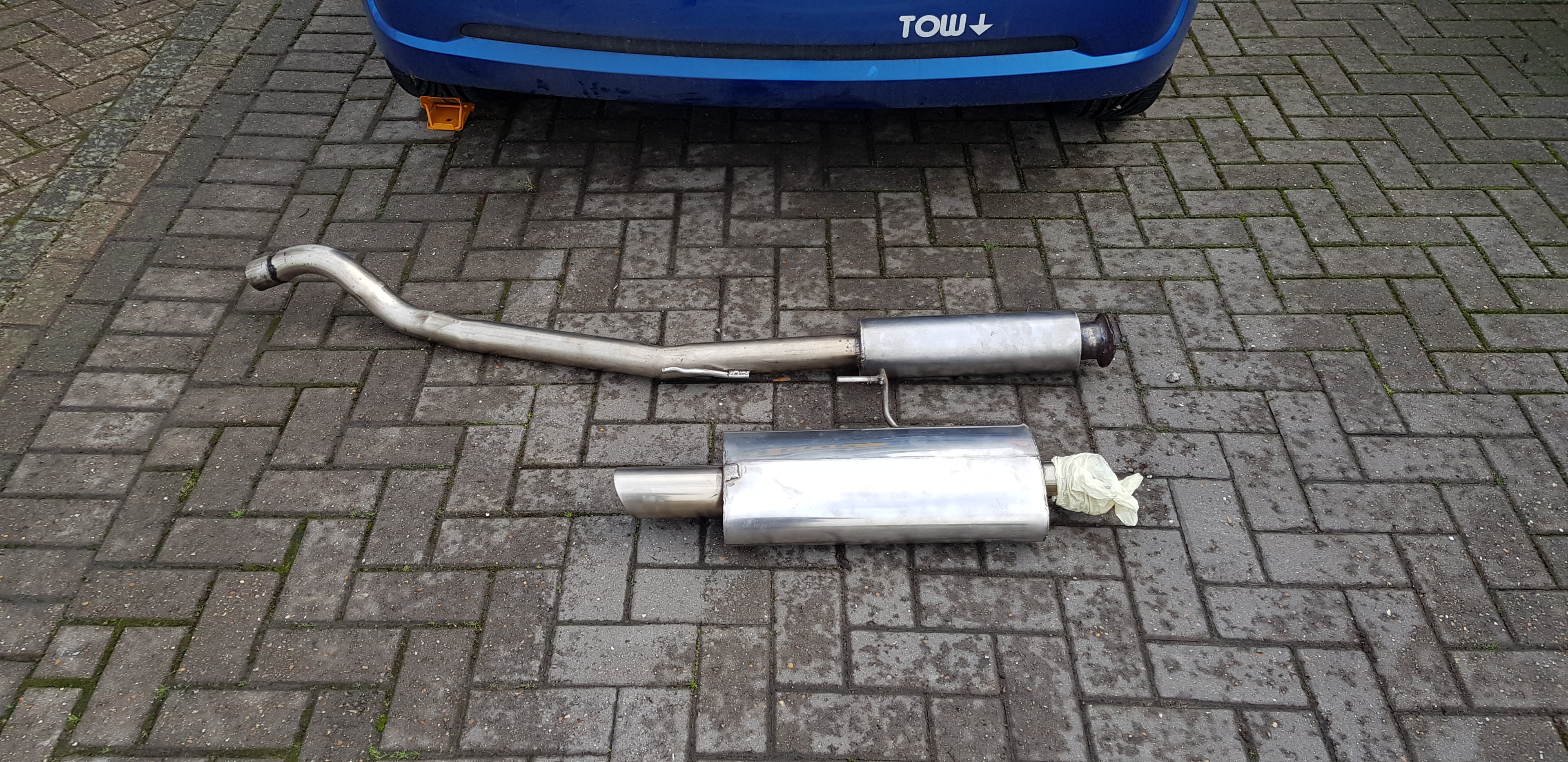

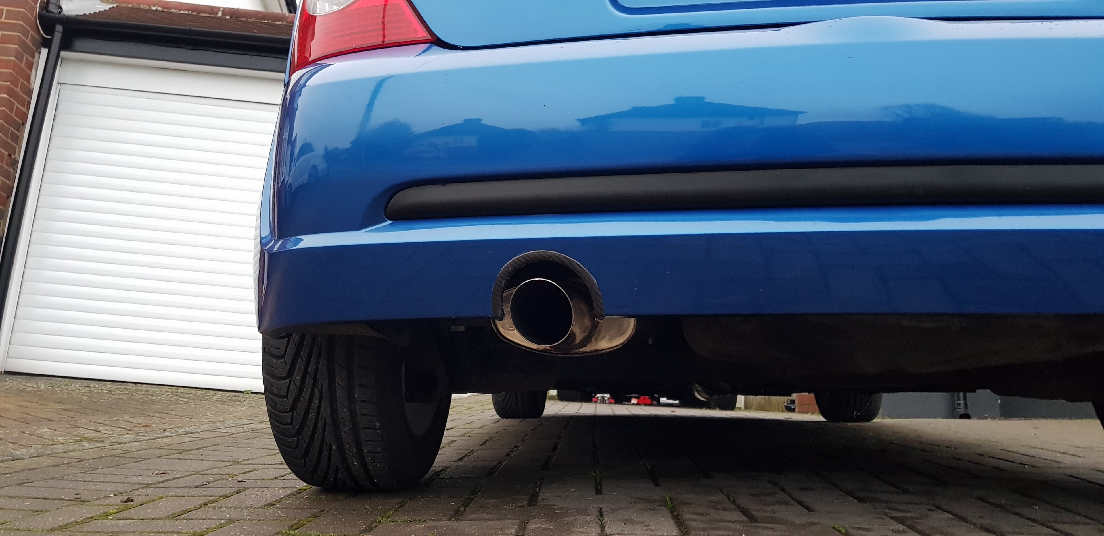

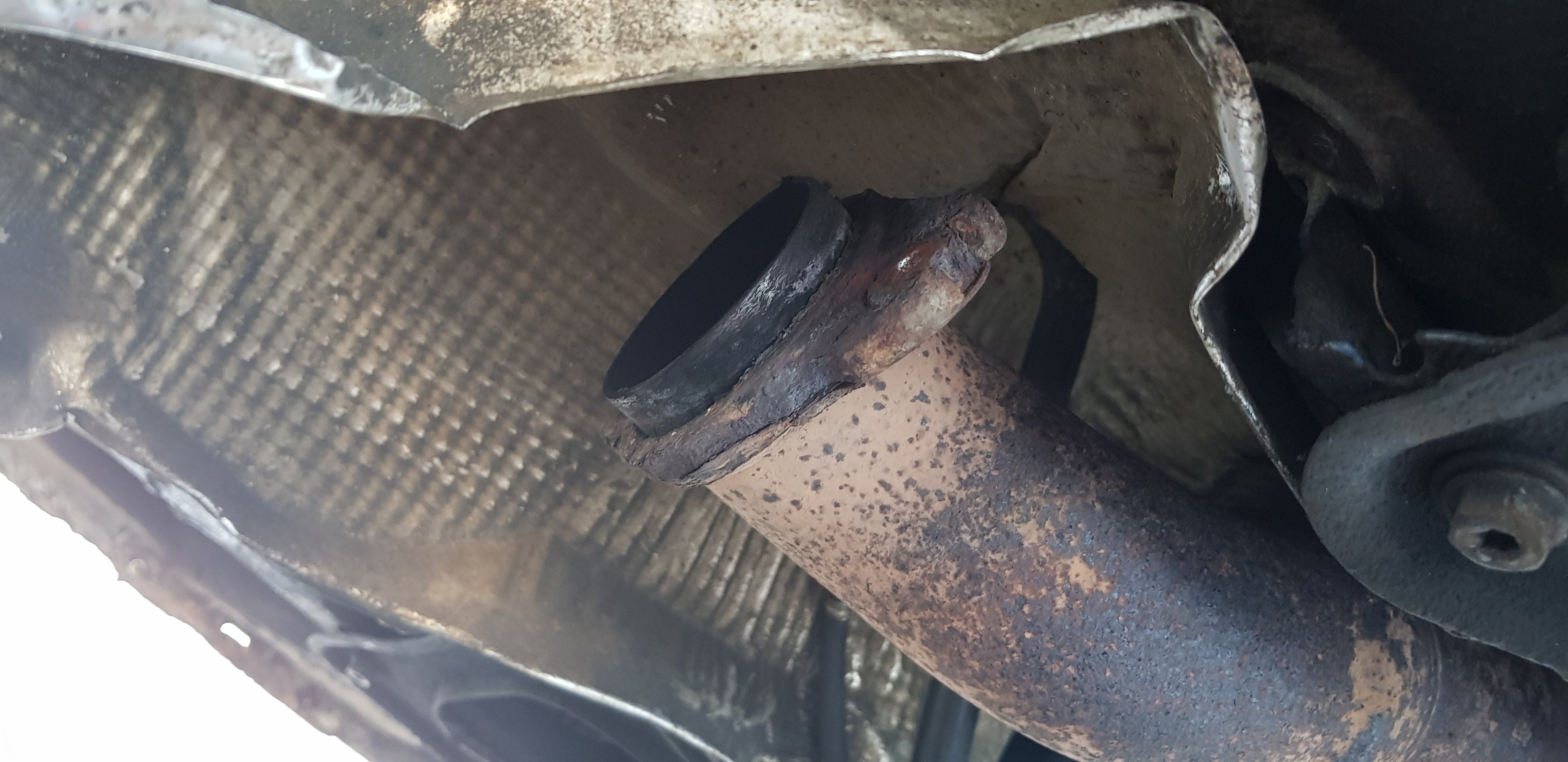

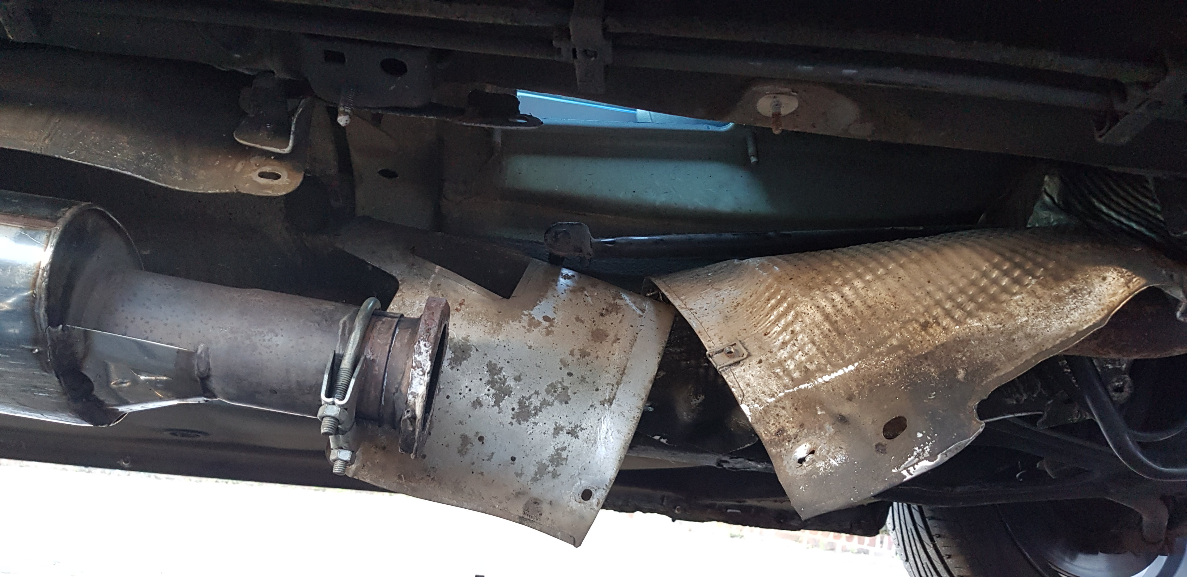

Only had a couple of minor issues. After the first session the exhaust managed to come out of the rear hanger. I currently have a janspeed stainless twin silencer system with sports cat fitted as sick of worrying about noise levels on track days. Sounds lovely. The old school twin exit tip is not to everyone's taste, but the system was a bargain. Anyway that was an easy fix.

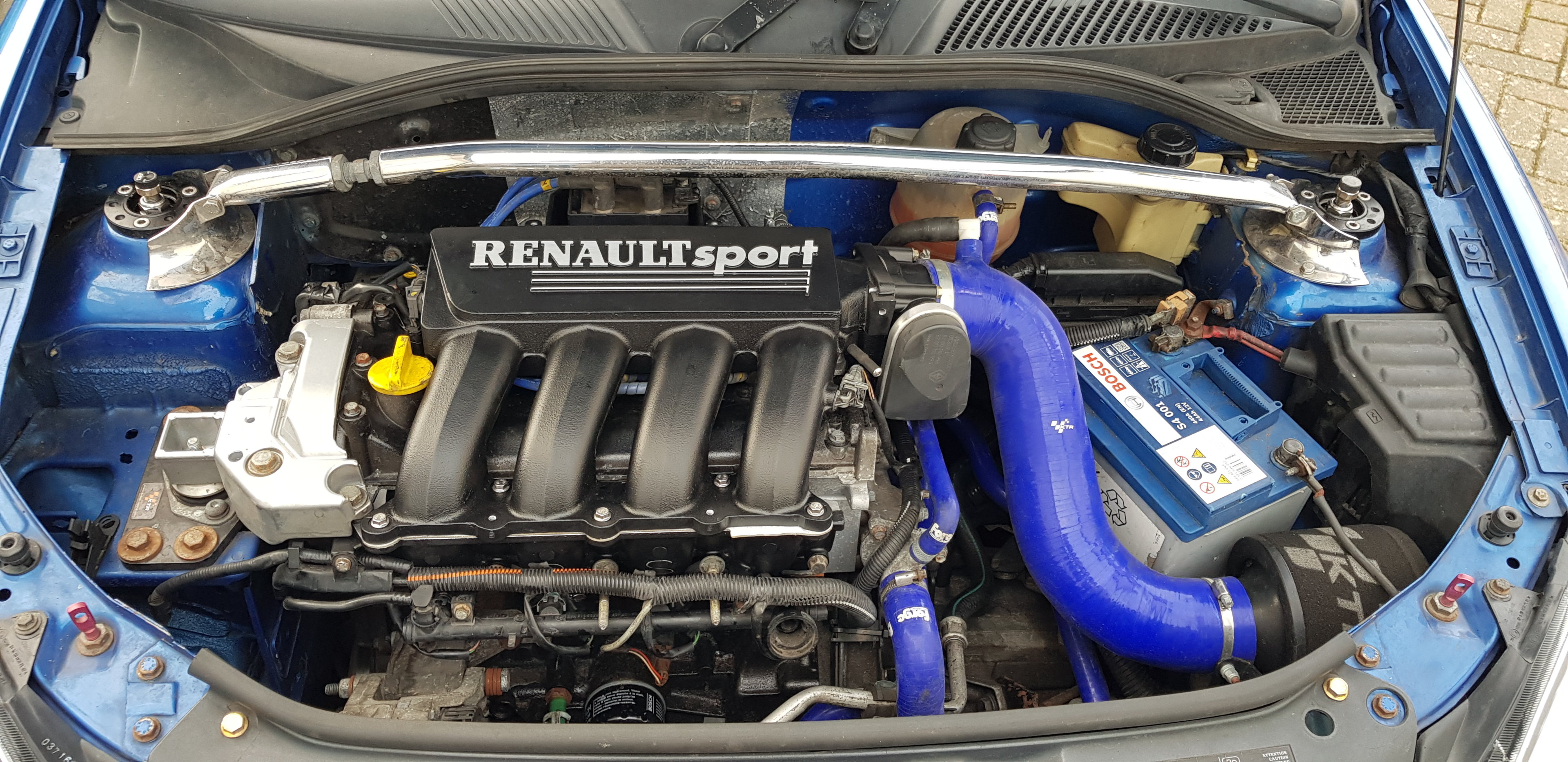

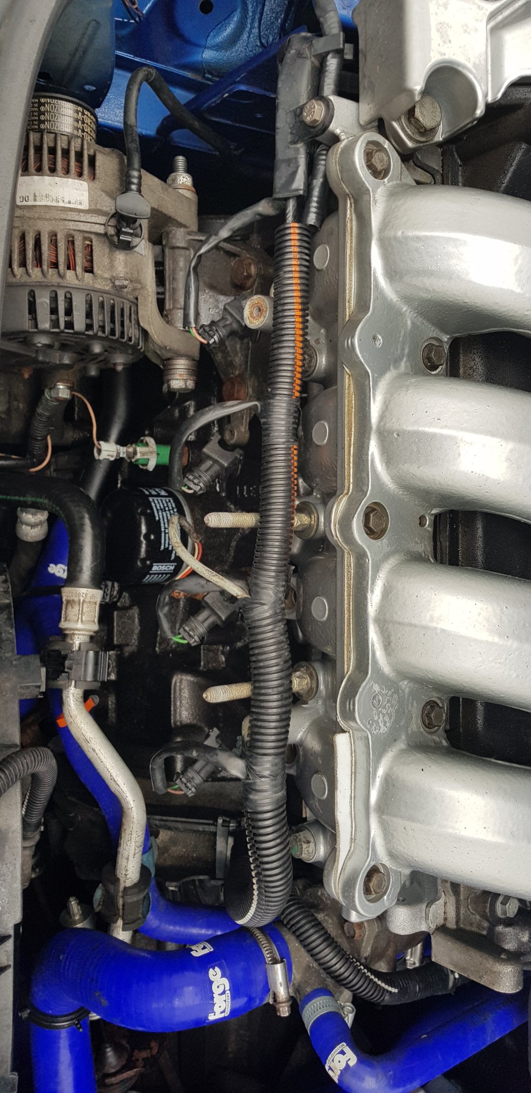

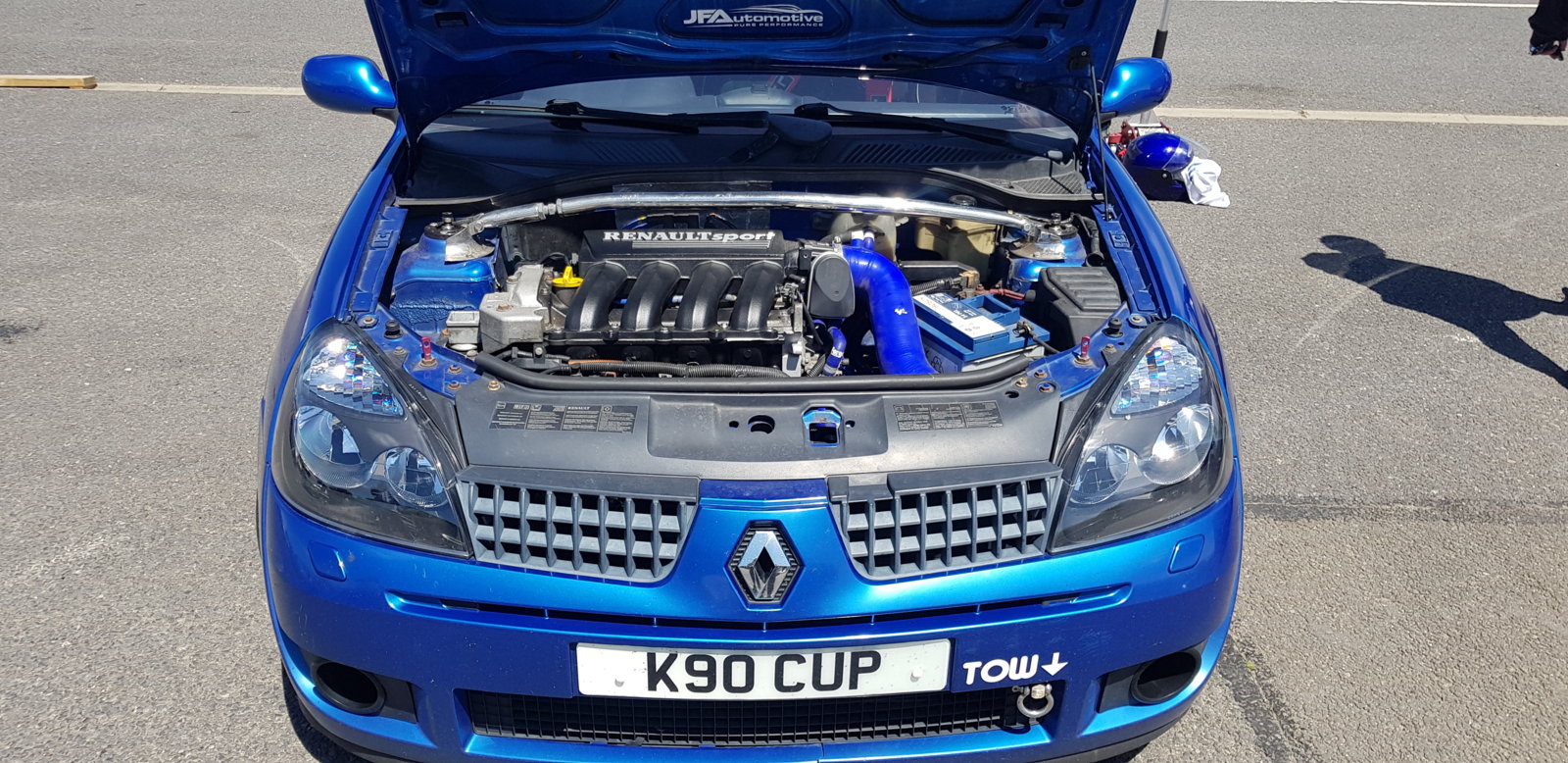

In the second session my brother-in-law had a running issue and the line symbol came on in center of dash. As luck would have it I had taken my code reader with me. This pointed towards a TPS fault. Quick look in the engine bay and the main plug to the throttle body had come loose. Cable tie round it and all good again ready to go back out.

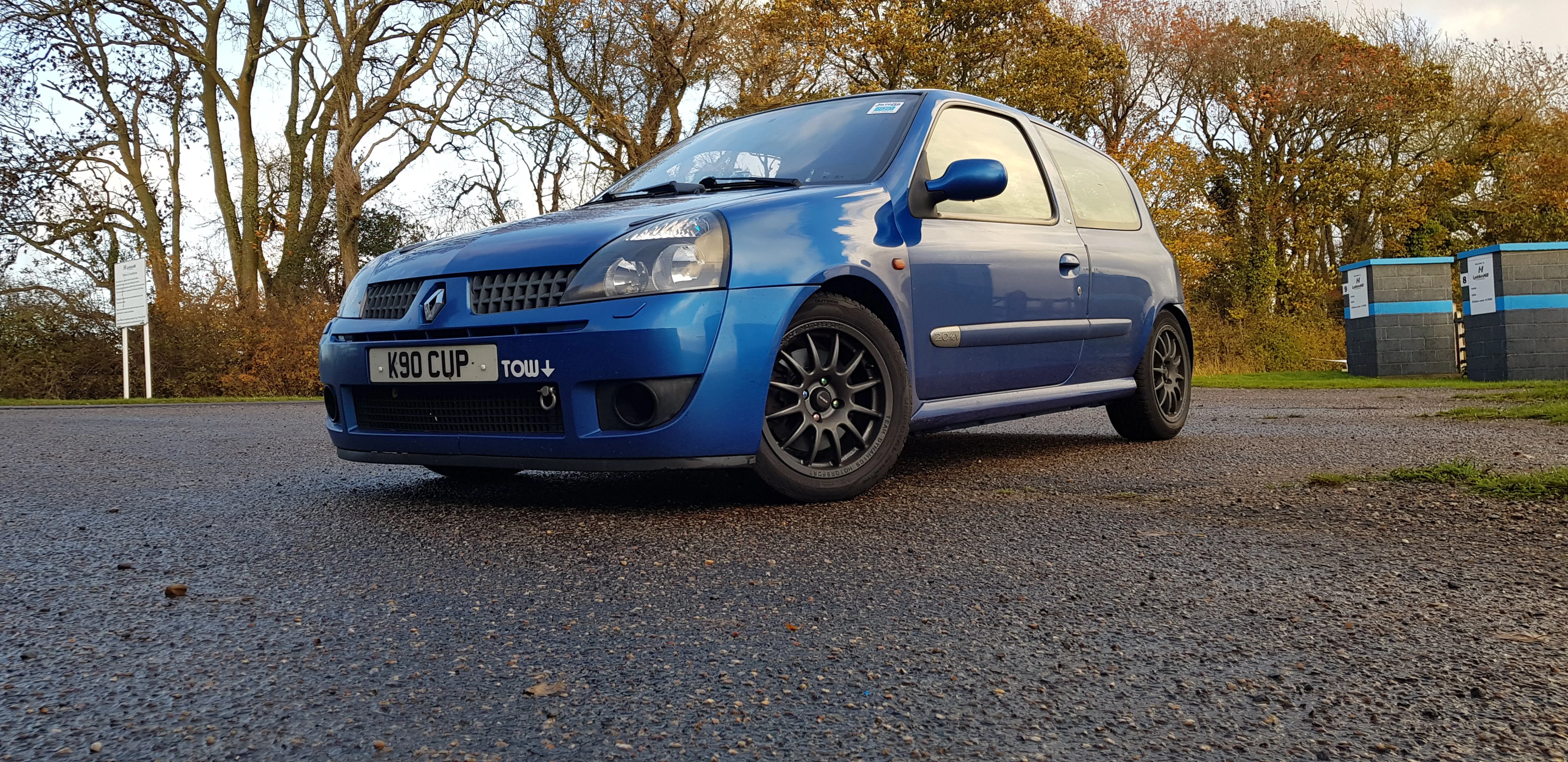

Anyway couple of short videos and some photos of the car.
