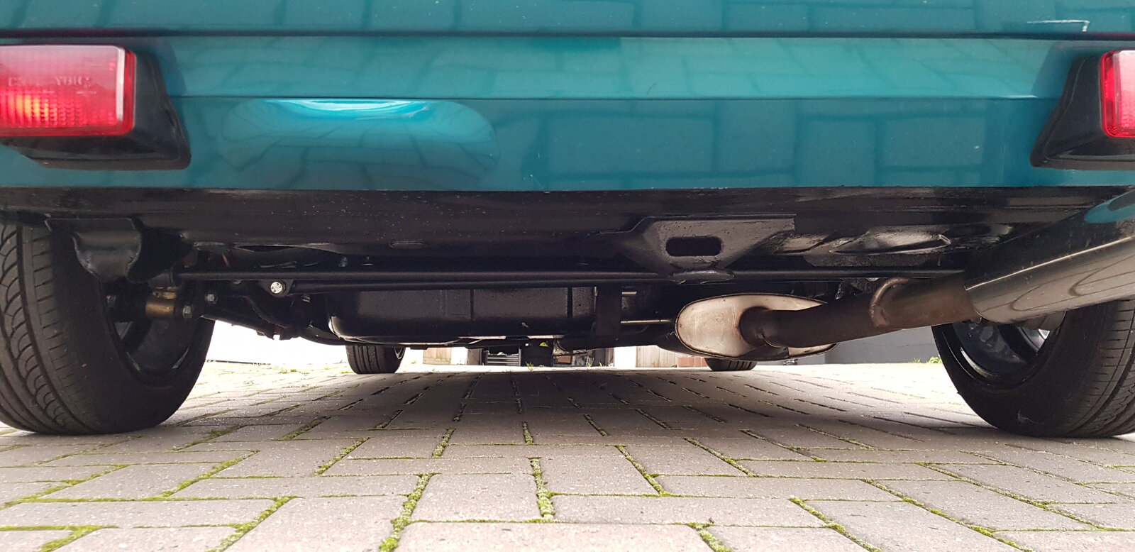

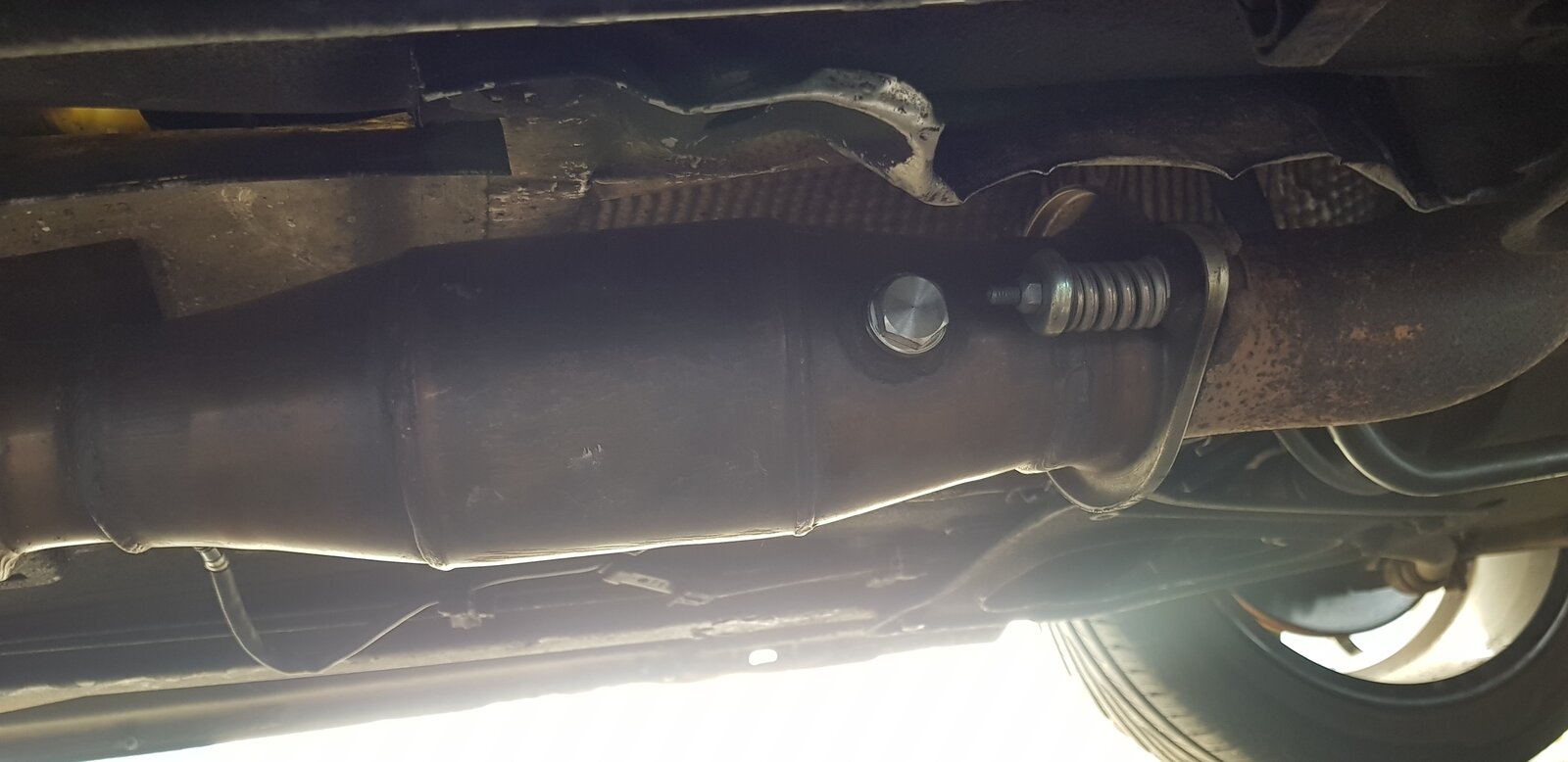

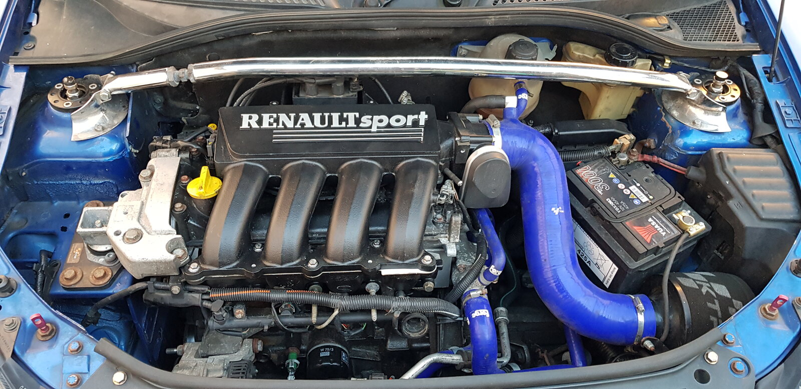

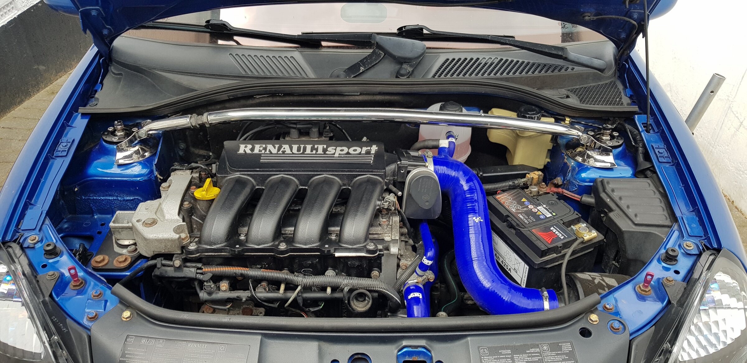

Blanking plug fitted on the sports cat. I have a 182 Manifold, 172 Ktr sports Cat and janspeed twin box system. There is two lambda sensor holes, one at front and one at rear of the sports cat and then one at the end of the 182 manifold. I have a lambda sensor in the 182 manifold and one in the rear of the cat. I have then blanked the front one.

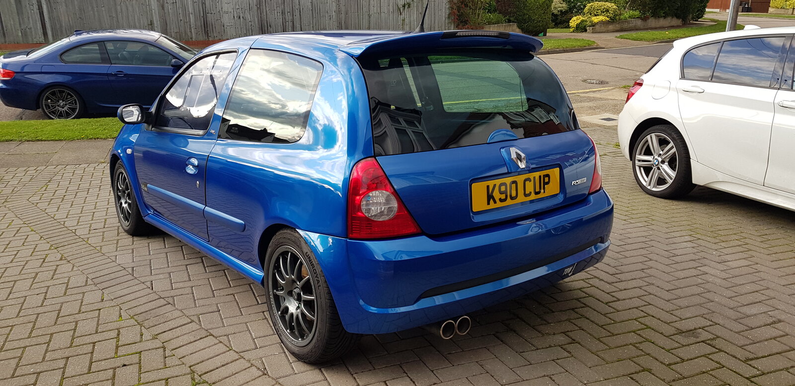

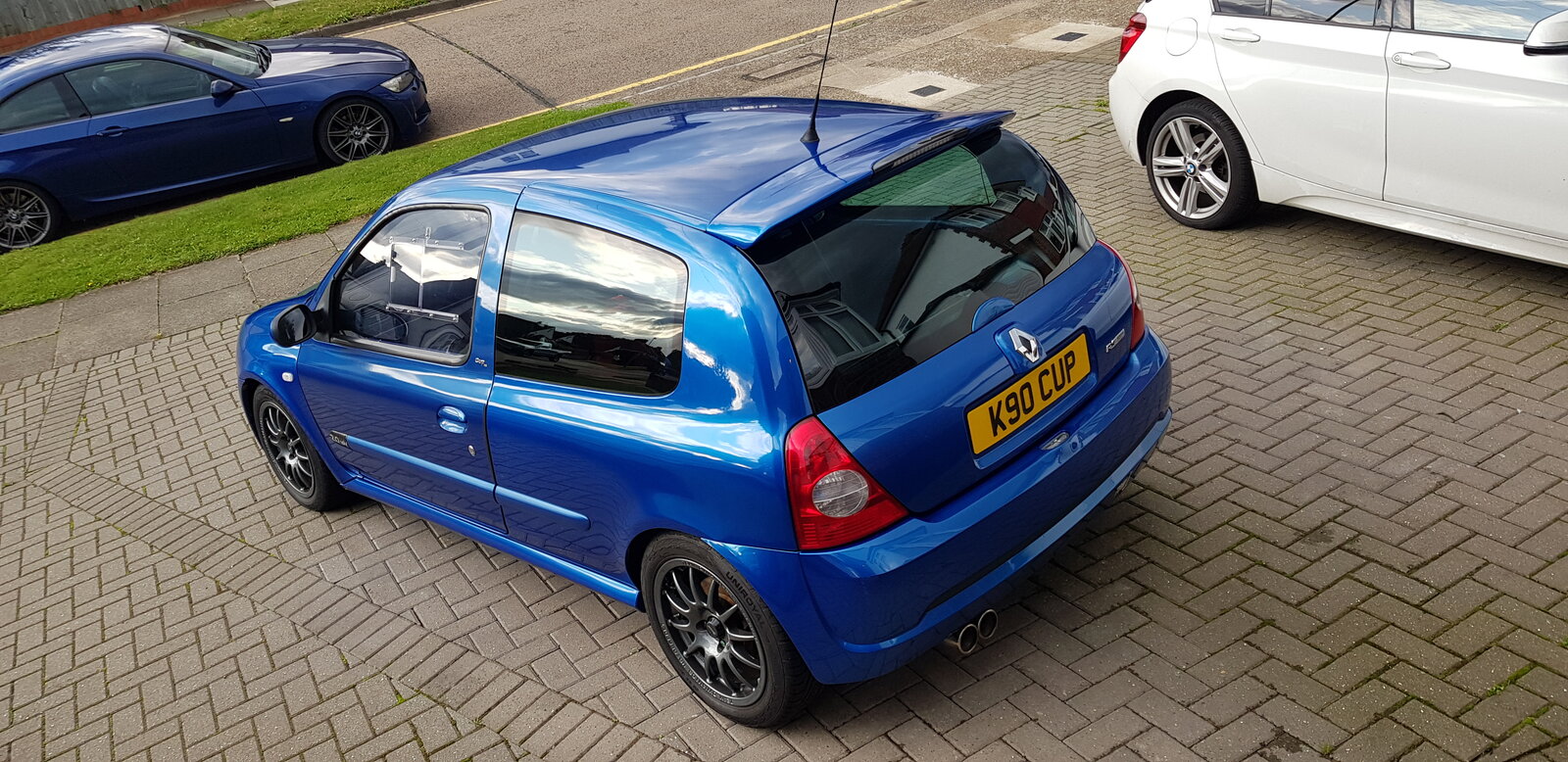

Some time ago I purchased a trophy replica spoiler from @GrahamS in the correct colour. It can be used with the standard boot struts and has the LED brake light from the lower spec spoilers, which I much prefer over the Cup one. Looks really smart.

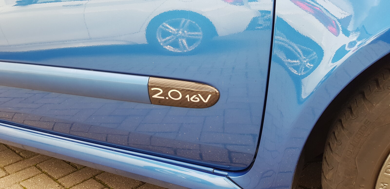

I have changed the side bullets for carbon effect dipped ones, which look really smart. These were from @Aydon182

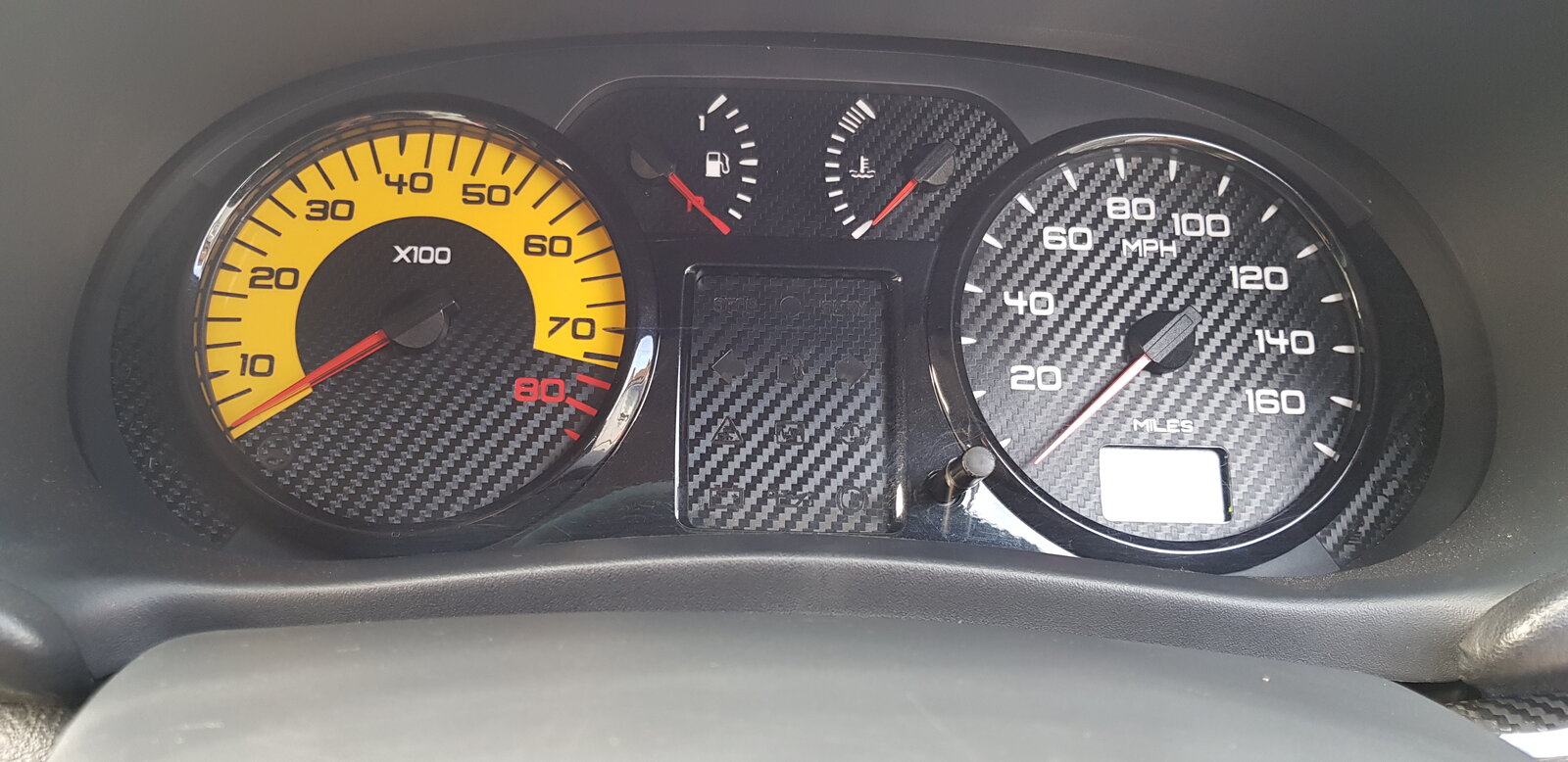

At the weekend I finally got round to fitting some clocks I purchased a while ago with carbon background and RS200 style rev counter. Took a bit of messing around with the needles, but well chuffed with the final outcome and look of them. While the top dash was out I removed the sound deadening behind the dash and the airbag ECU and OBD2 connector are now in the glovebox off the floor. Stereo blanking plate fitted.

These are the new clocks.

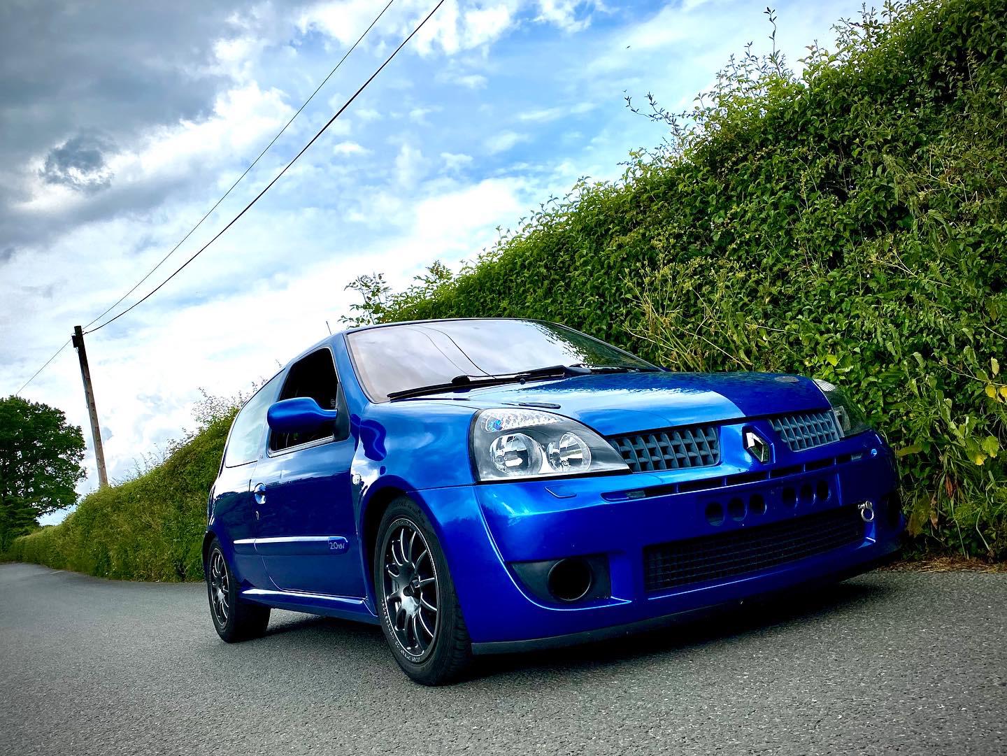

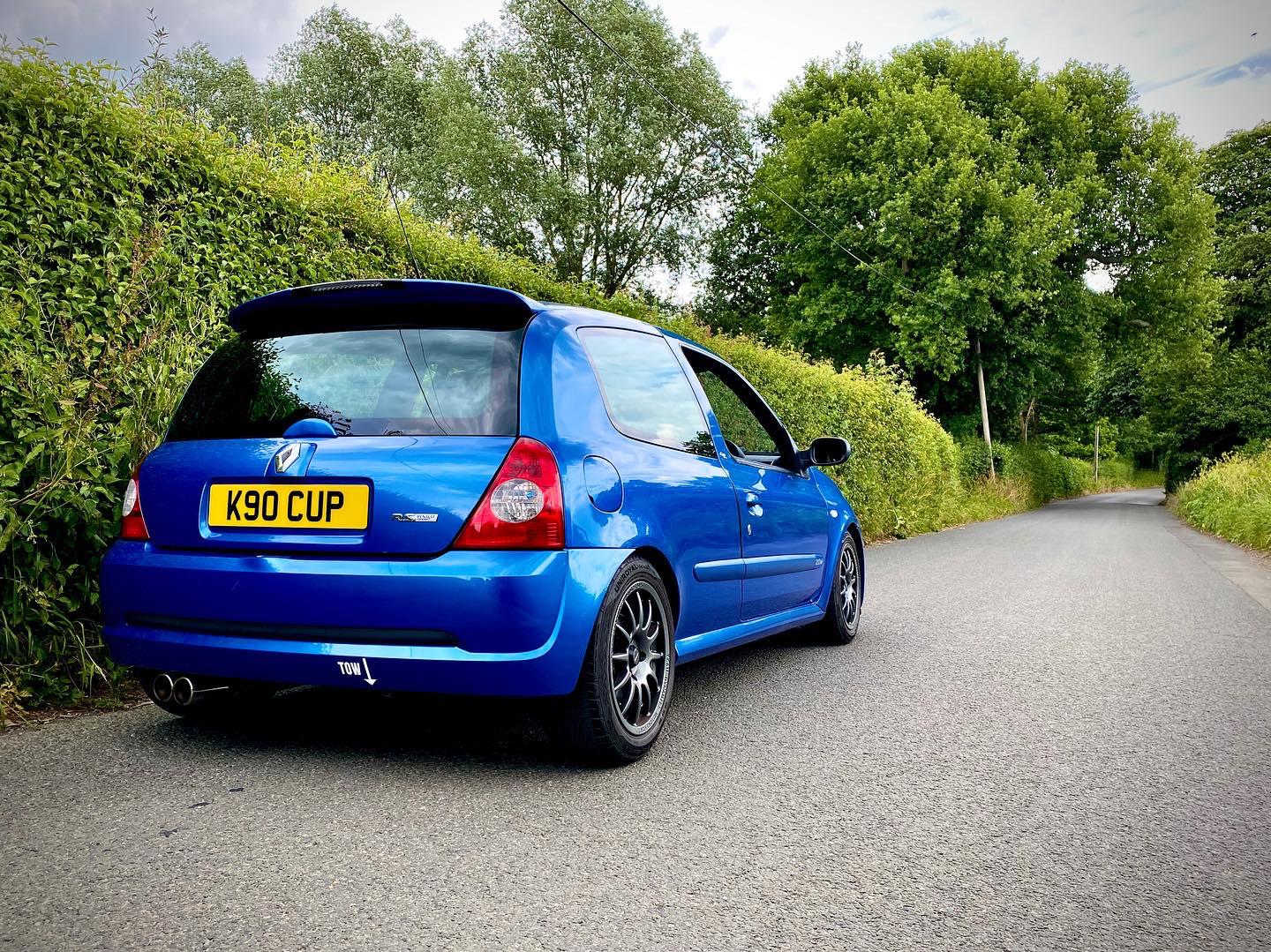

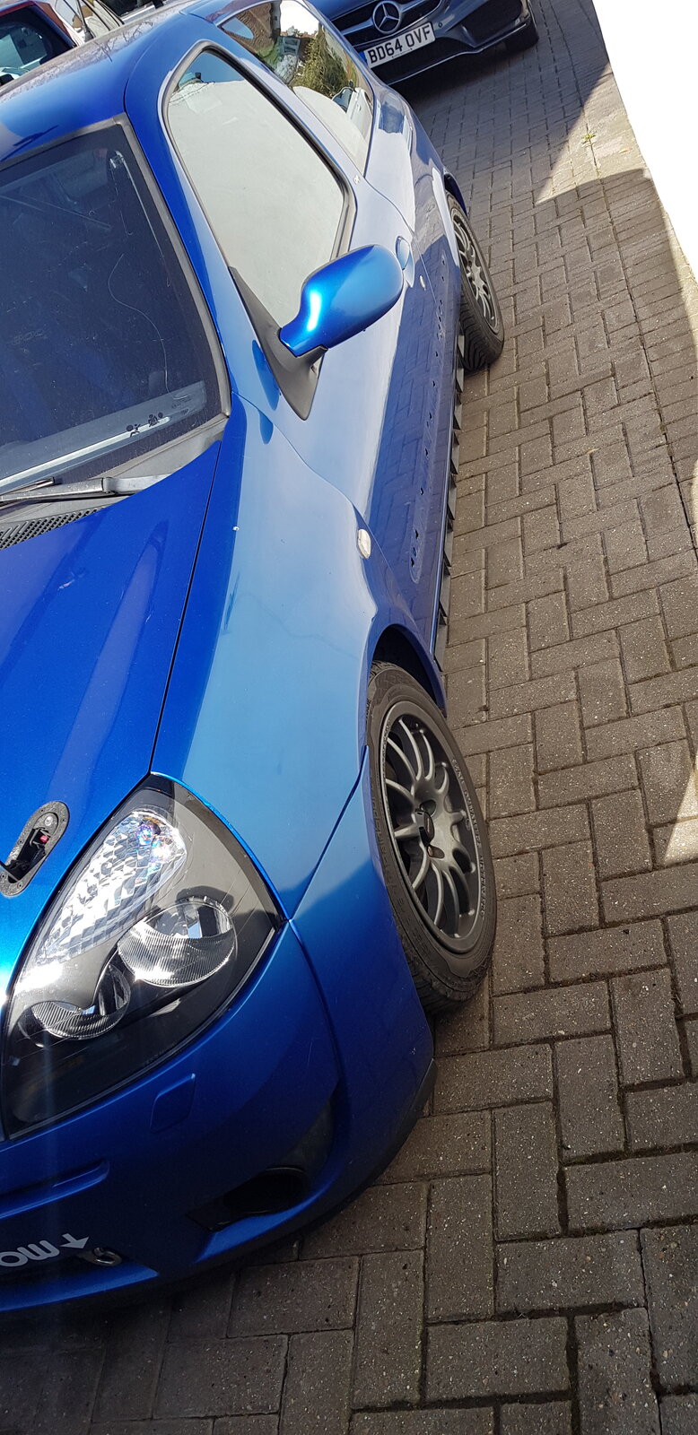

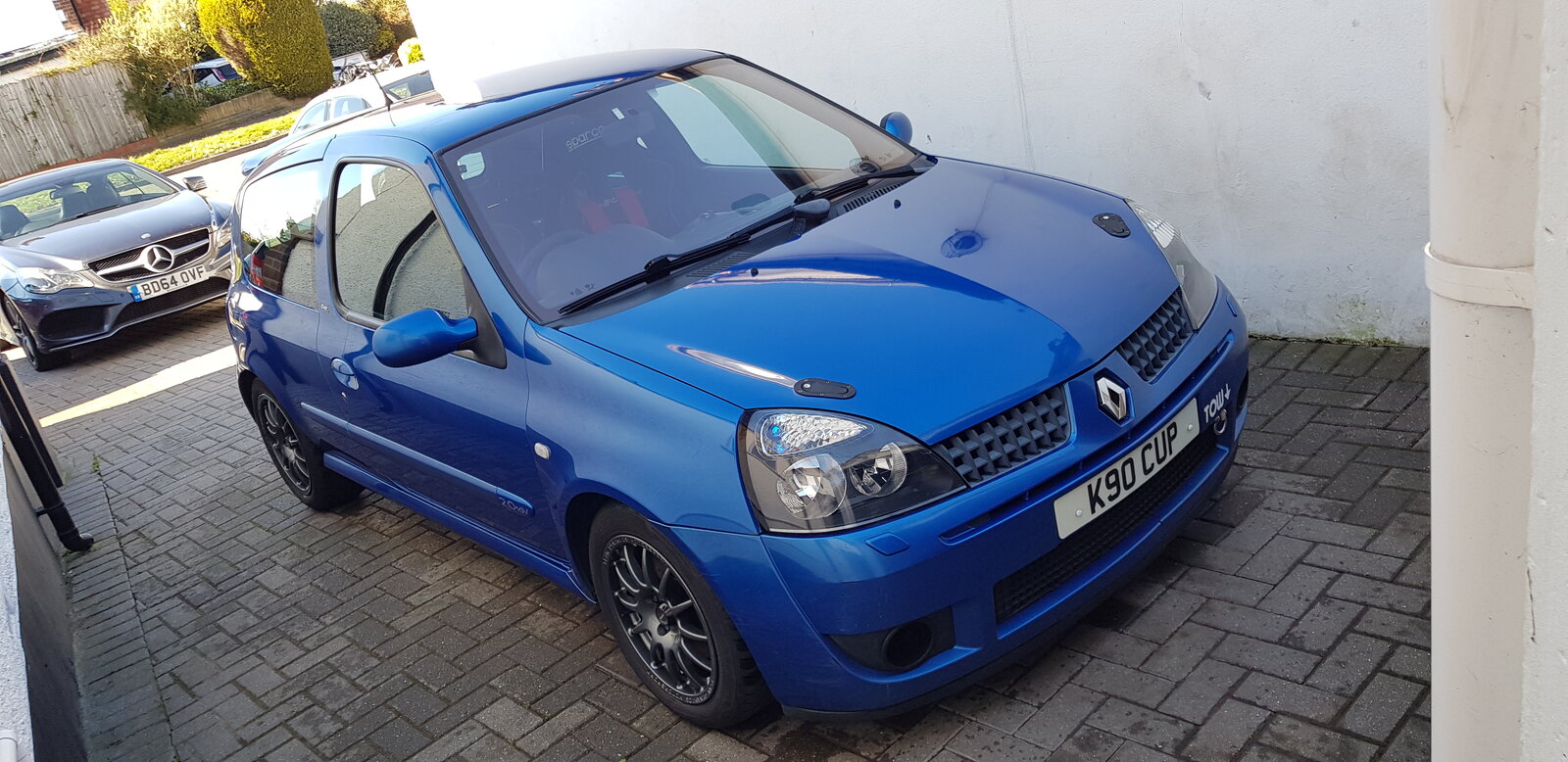

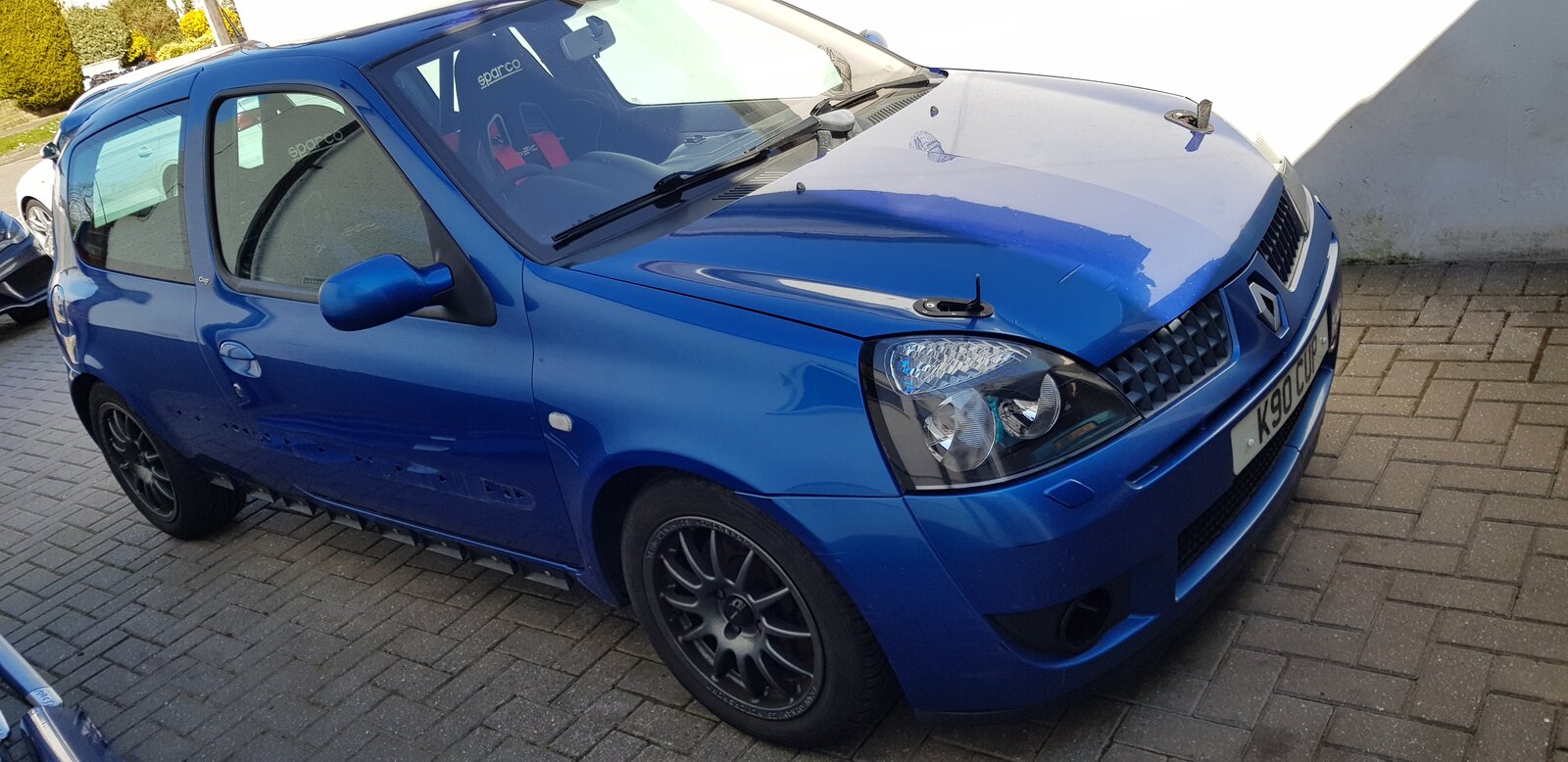

Everyone loves pictures, so finally got some updated ones! Trophy spoiler, new bullets, clear side repeaters to replace the orange ones, new rear discs and pads, more stripped out of the interior to name a few bits! Drove it to pick my son up from rugby Saturday and feels good. Managed to get a nice colour coded wiper delete from @mart.z.s too which looks smart I think. Couple of bits to be powder coated in the engine bay and new coolant bottle. Tempted to get the PMS mounts and move the battery into the car. I will eventually get a PMS shifter too. I would like to do the EPAS conversion at some point and remove as much as I can from the engine bay. Anyway some pics!

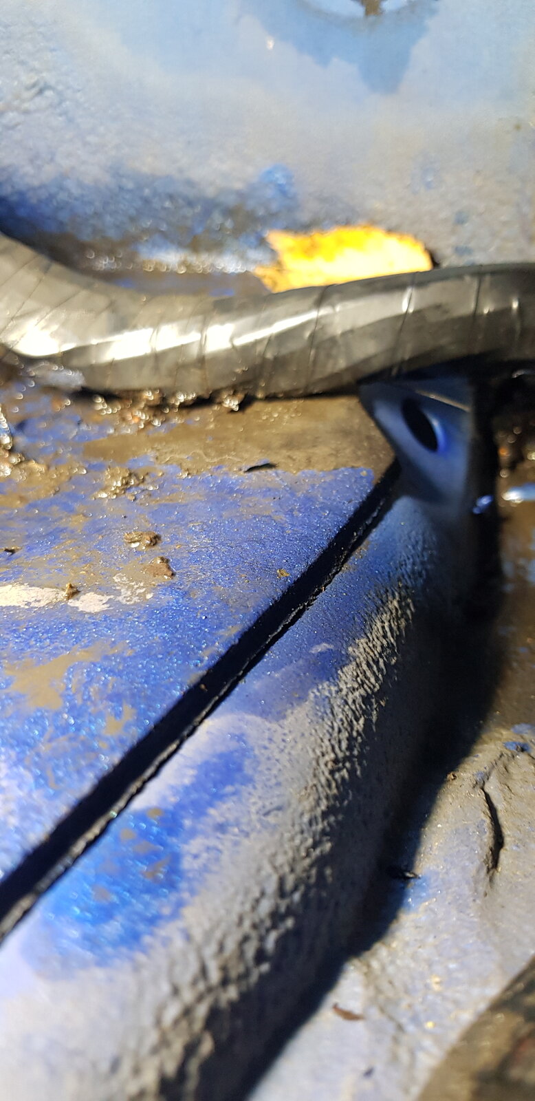

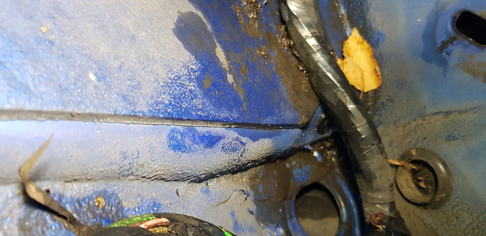

I have also sealed a hole in the scuttle panel that has been letting water into the interior for some time! The interior is also stripped of any non essential wiring and pretty tidy now.
Hole
Hole sealed

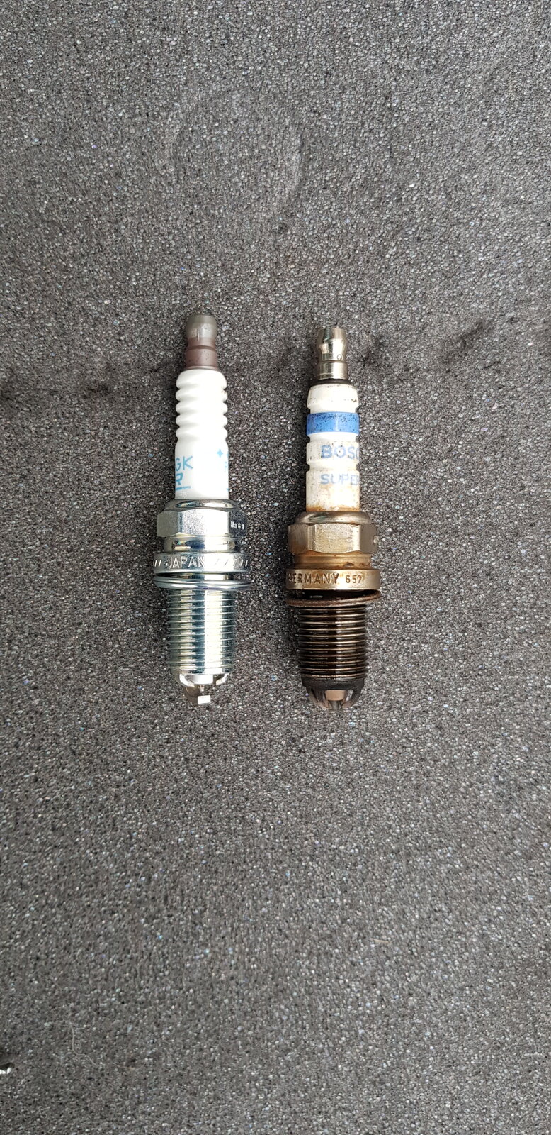

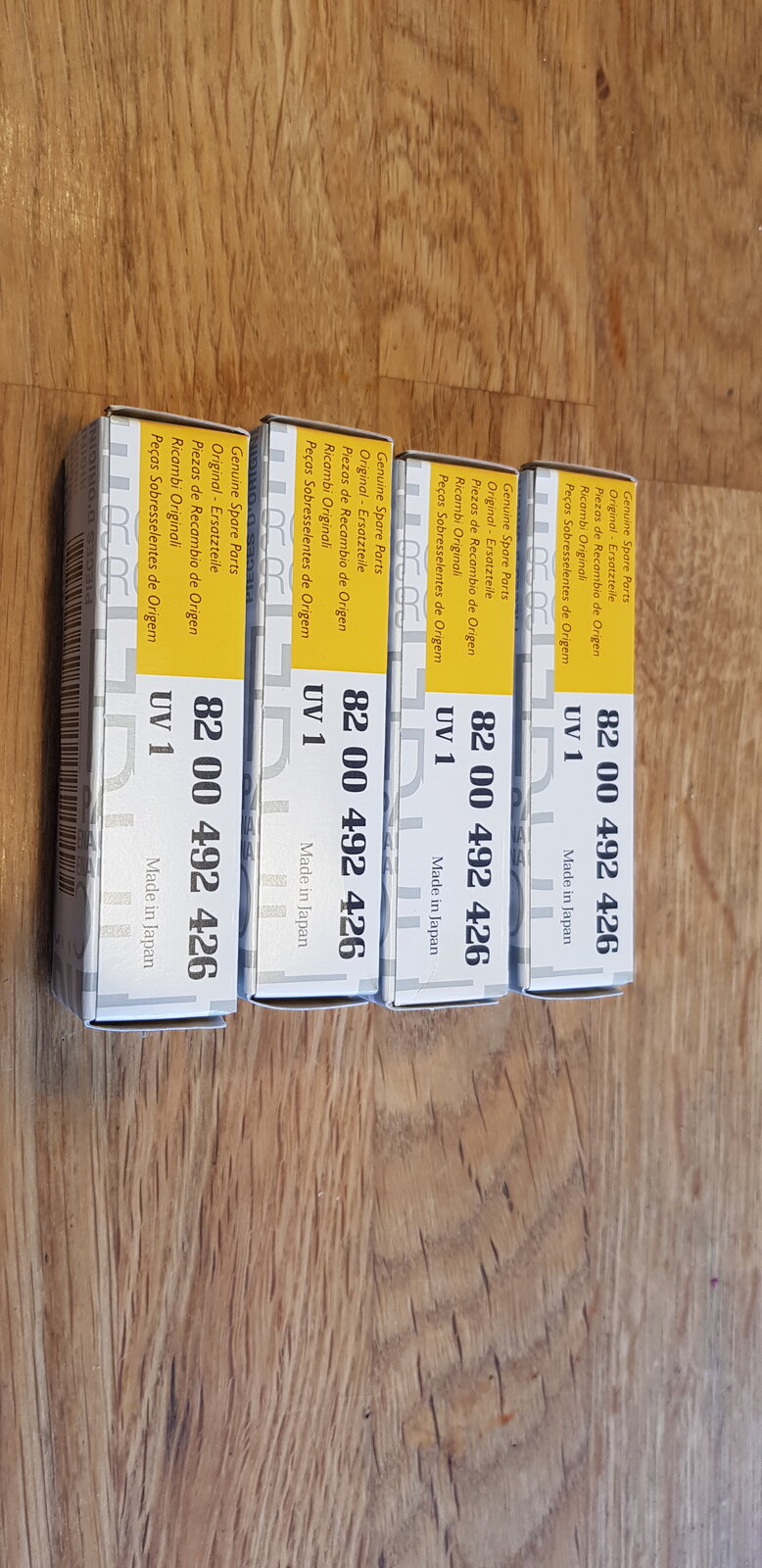

Timing check all done and it was very slightly out. I was not aware what plugs were in the car since the rebuild, but turns out it was some Bosch four prong things. I have now replaced these with some genuine Renault R26 plugs following advice.
Car is running the best it ever has and pulls so well through the entire rev range. The only other thing noticed was a post cat lambda sensor fault. Both sensors are fairly new and genuine. On looking at live data the pre cat is working as it should, but the rear is reading the same so I think the ktec sports cat is not working as it should. I have a lambda spacer coming, but will probably just put the decat back on!

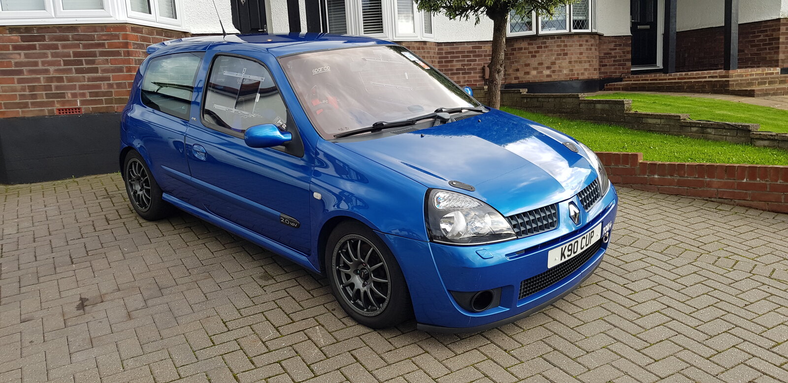

Have started using the Clio as my daily so it does not end up just sat on the drive. For some time its had a really annoying rattle from the rear and its definitely been annoying me on the way to work the last week!

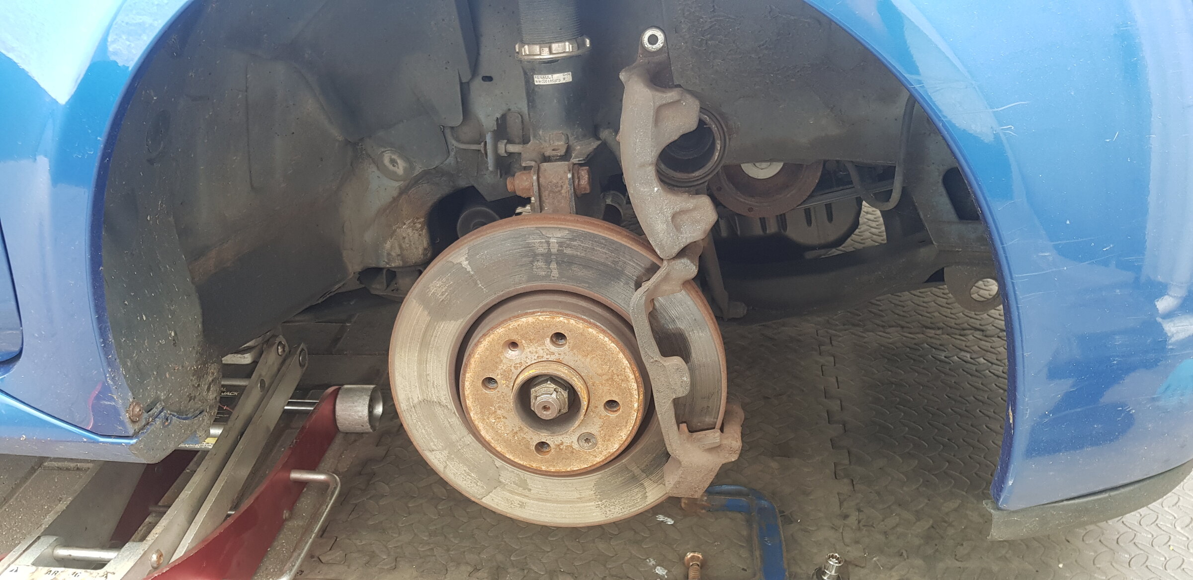

Had another look this morning. There seemed to be a lot of movement in the slider pins on the RNS caliper and the piston seemed very slightly seized. I was able to rock the caliper much more than I should.
In my spares I had a used caliper to try. Cleaned it up a bit, fitted and bled it. It's not is the best of condition, but all the sliders were moving freely and I got the piston winding in and out. I just wanted to eliminate that as the problem before getting a refurbished caliper.
Took for a drive and no rattle, yay! Where the car is all stripped I think the knocking of the caliper was being exaggerated and has slowly got worse. I am surprised how poor fitting the slider pins were and the amount of noise they were making. I think the new caliper is binding ever so slightly so will see how I get on over the next few days. If no good I shall get a refurbished one to match the OSR. I may send them to MS Custom engineering for a lick of paint and refurb.

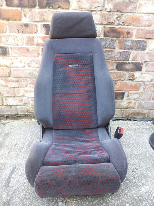

This one 😁 My first car, had it since I was 16, when it was rebuilt with a friend of mine and painted. It's a XR2, but after having the panel work done I decided not to put the body kit back on. Has the original 1600 CVH, which was also rebuilt. Been through various wheels, suspension, interior over the years. Just completed an overhaul of the underneath. I should probably start it's own thread! @Cookson

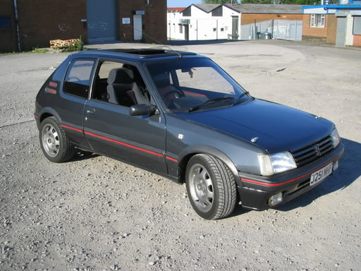

88 spec were THE ONE. f**k 90 spec with that light coloured headliner etc. I was always a huge fan of the darker grey (was the material called shark grey?)
I even had a pair on my 205 GTi

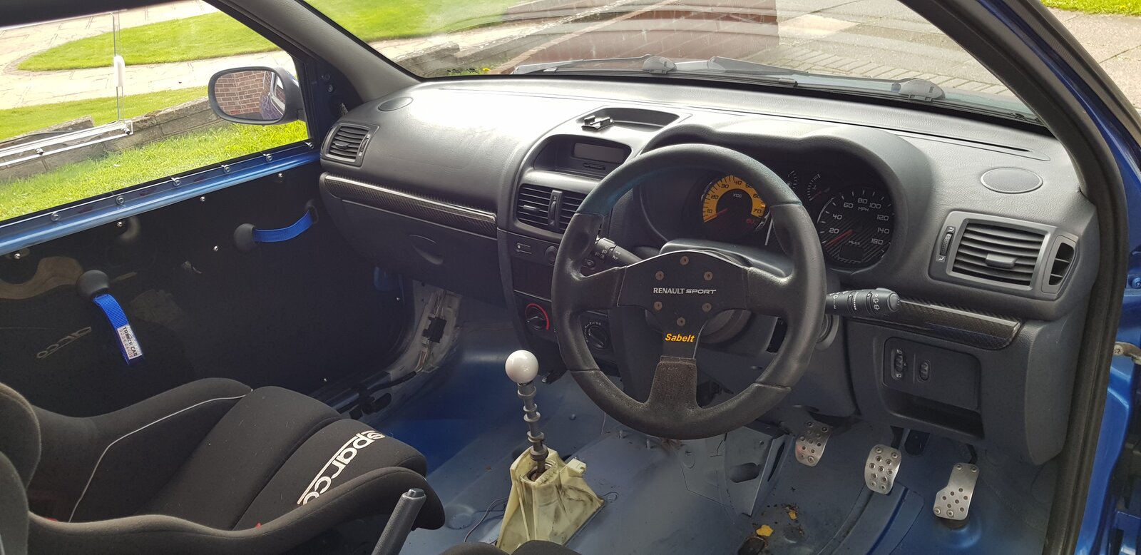

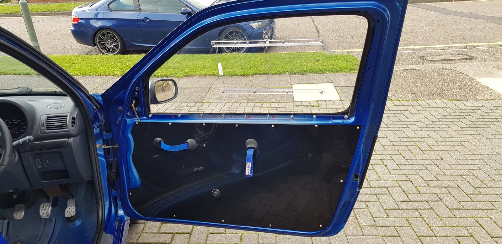

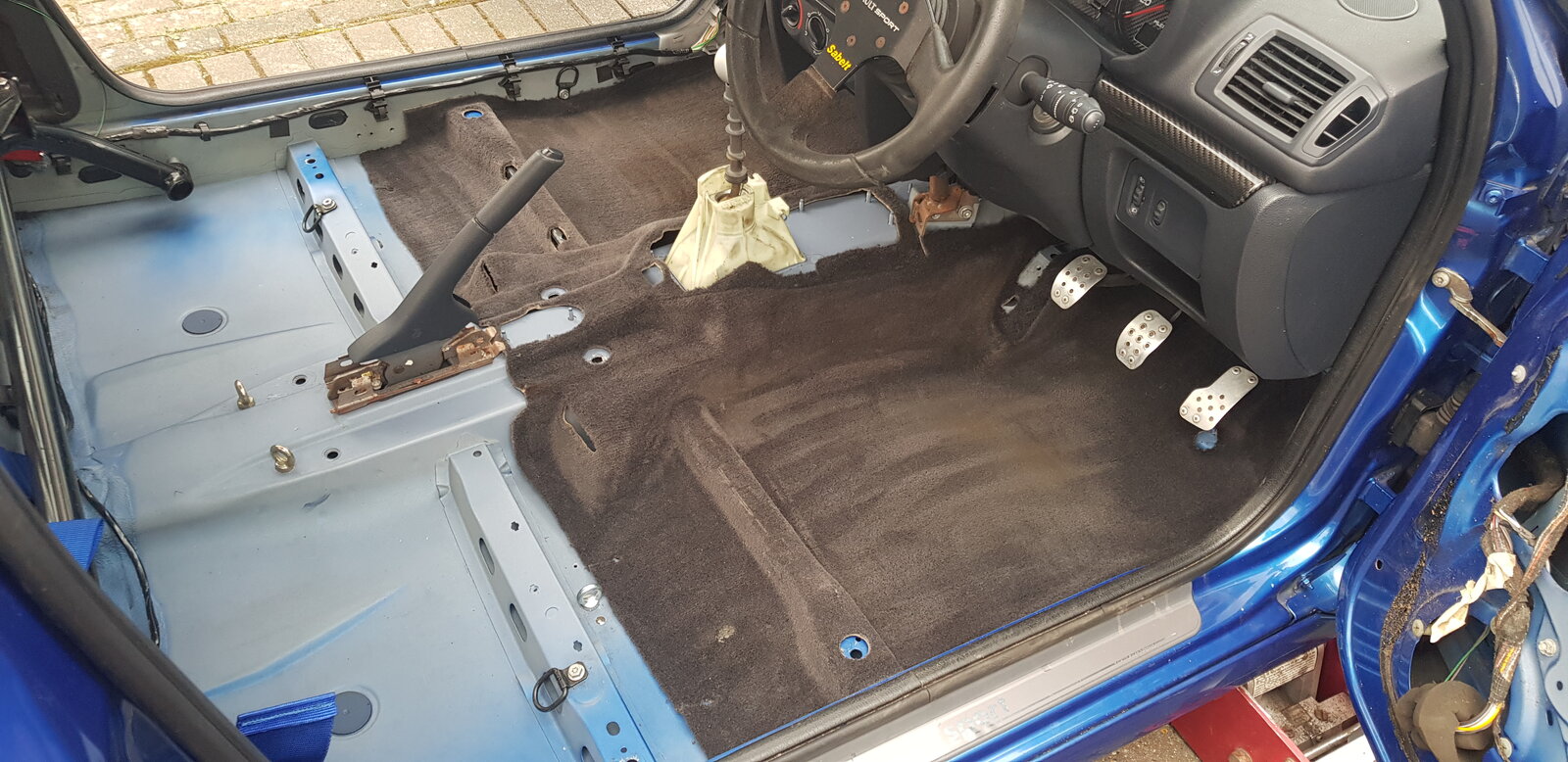

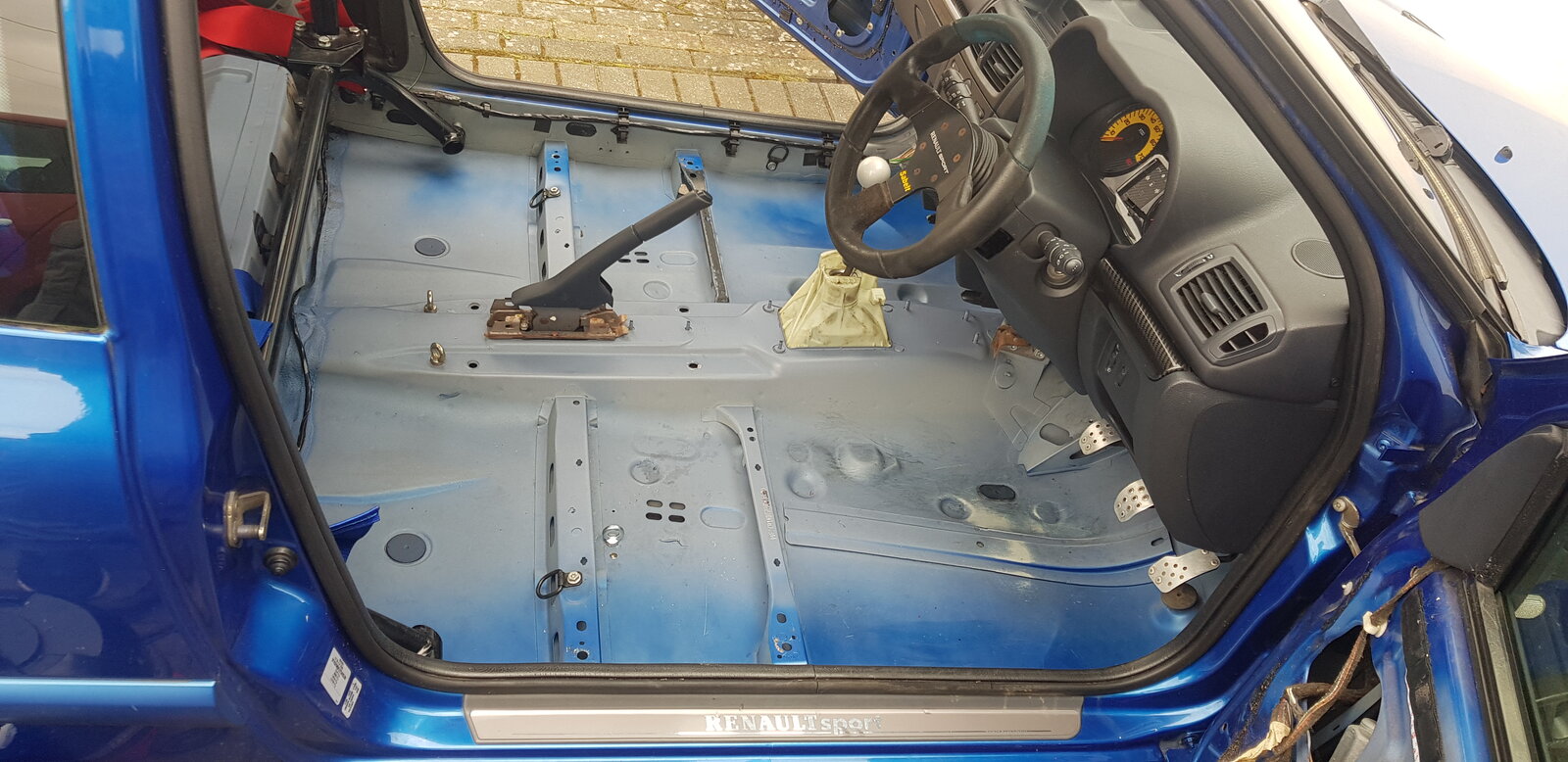

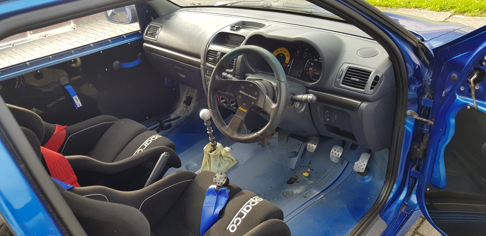

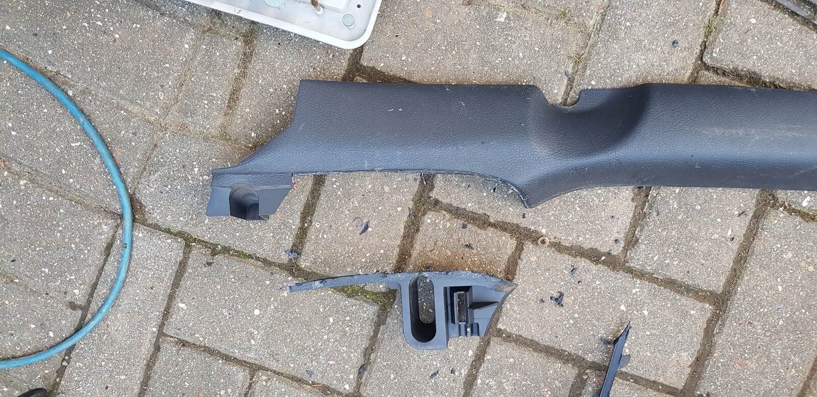

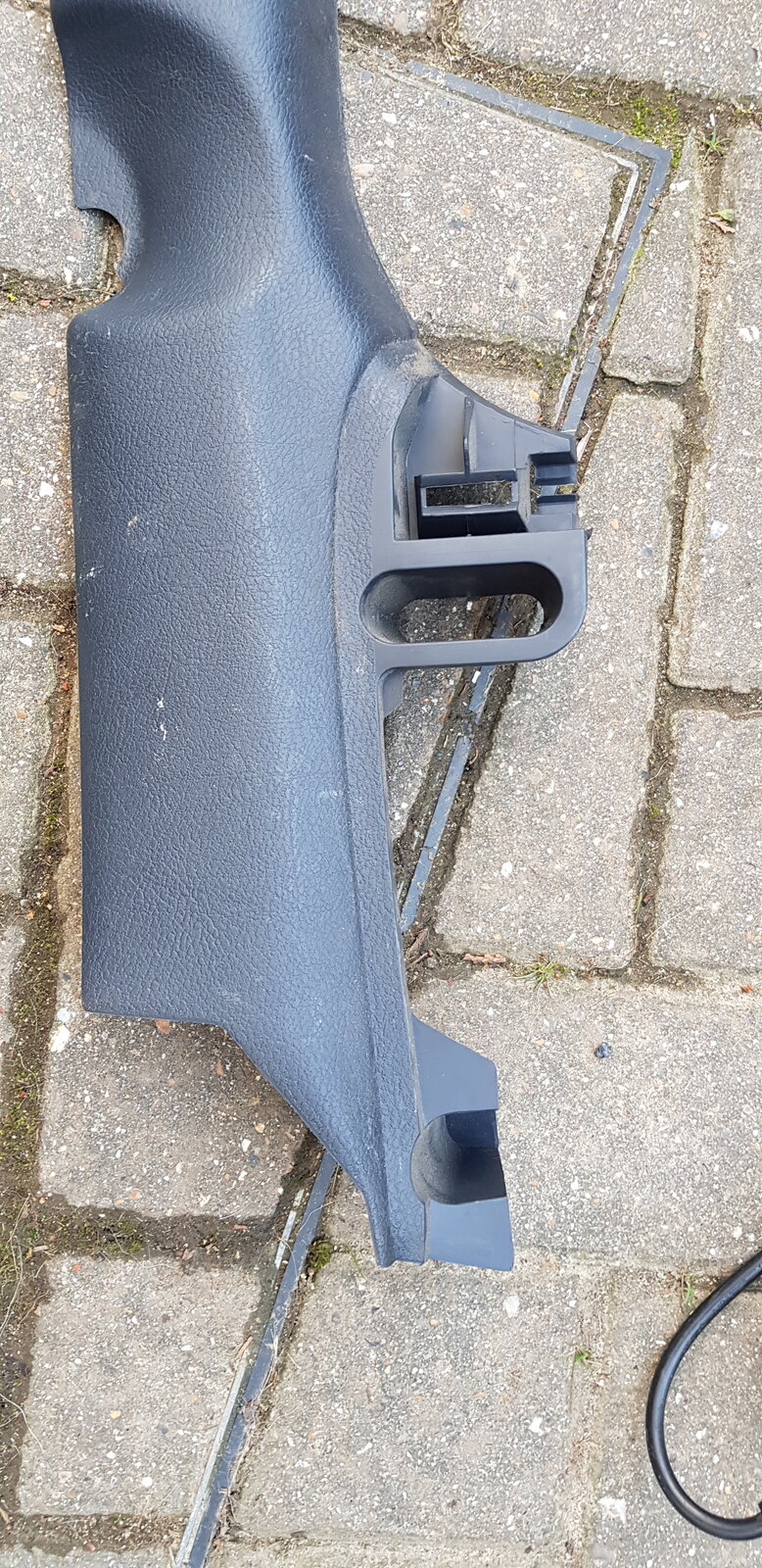

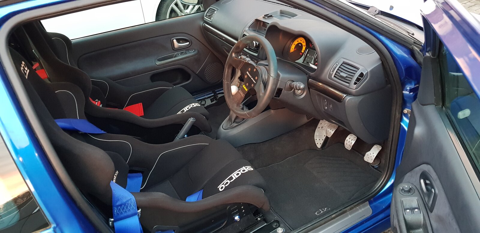

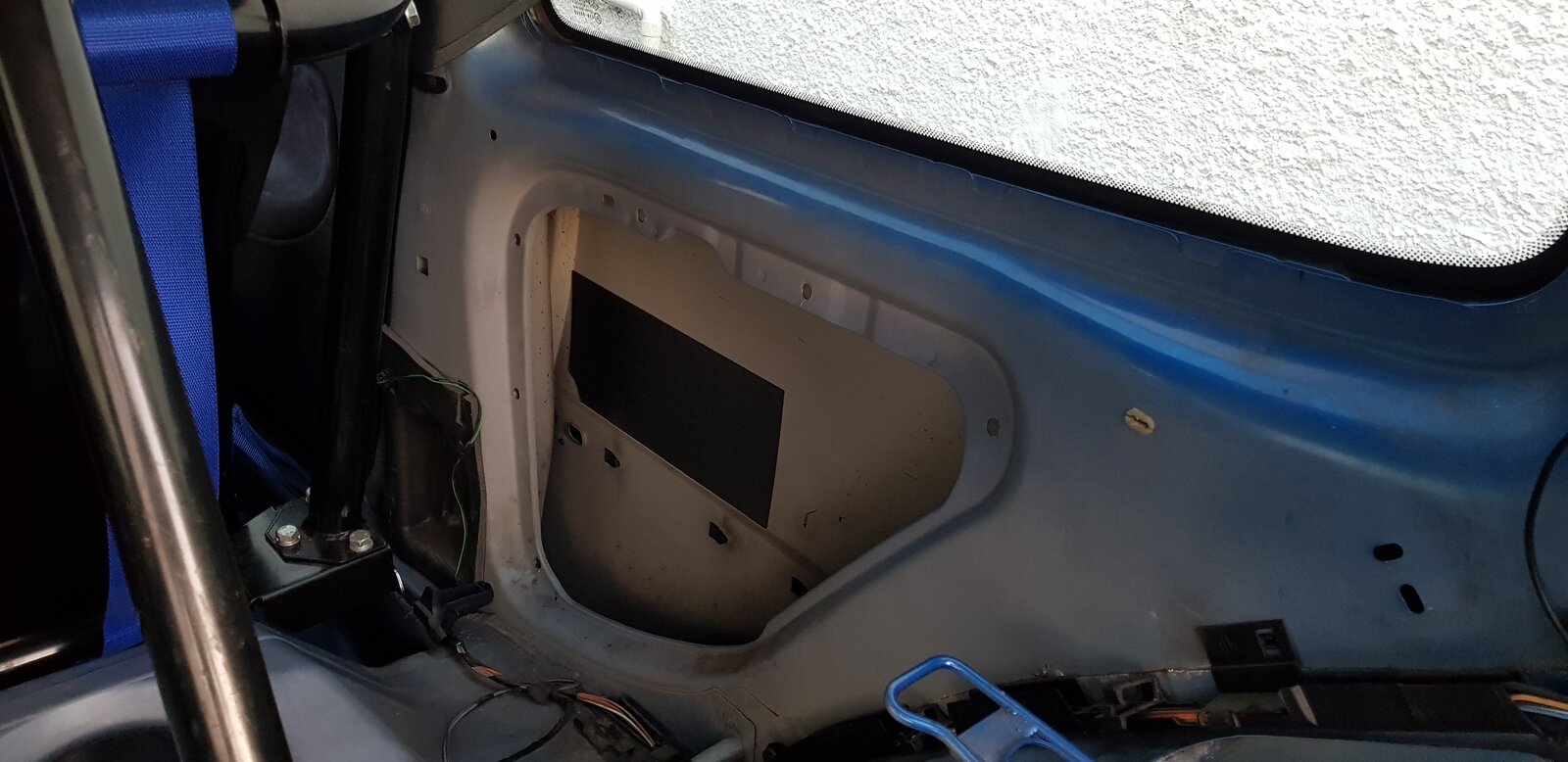

Spent the afternoon on the track car. The only thing missing from the front interior was the sill covers. I did not think they would fit, but the gap between the sills and the carpet was annoying me. I tried them today and after a bit of trimming with my mini dremel to allow room for the harnesses they now fit 😁

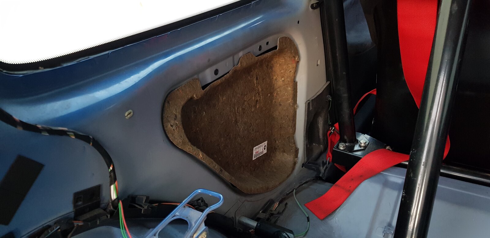

I also have some @Track-car-doorcards rear quarter panel cards to fit. In keeping with noise reduction in the interior as I am using on the road regularly I have also fitted the sound proofing behind the door cards. It also tidied up the rear of the car. Will add better pics tomorrow.
I have also fitted the bulkhead sound proofing back on the track car to try and reduce mechanical noise in the interior. The slight gain in weight is definitely worth it for a car used on the road!
Tomorrow I hope to fit some new rear arch liners, give the car a good clean and check over.

Rear door cards fitted, rear arch liners fitted and some new screws in the skoda splitter. Engine bay cleaned. Removed side skirts(they are screwed on, easy to take off!) and door strips to clean. Gave first clean for a while. Will look to run the DA over it later this week and give a polish. Fitted some blue bullets I bought a while ago.

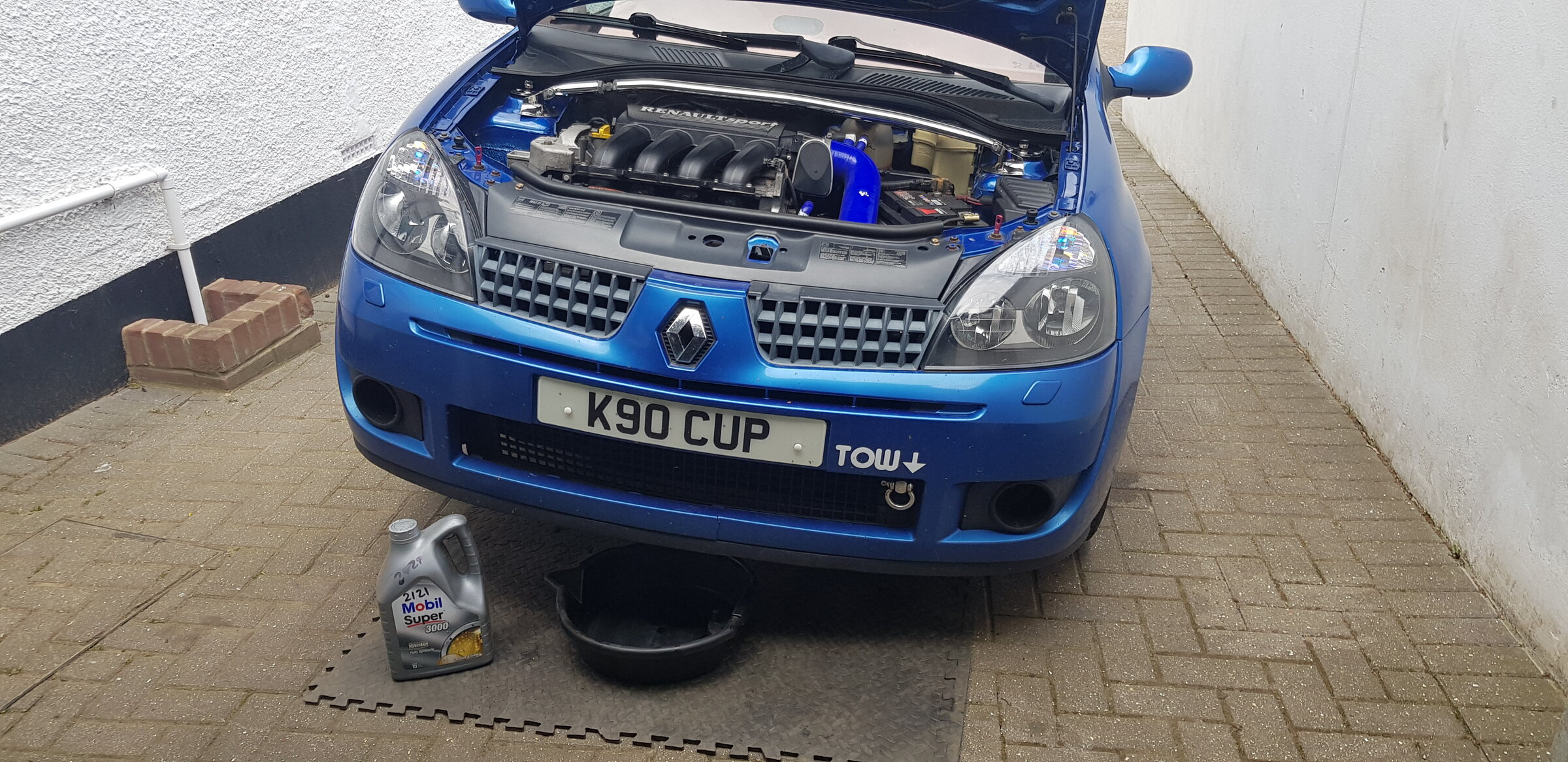

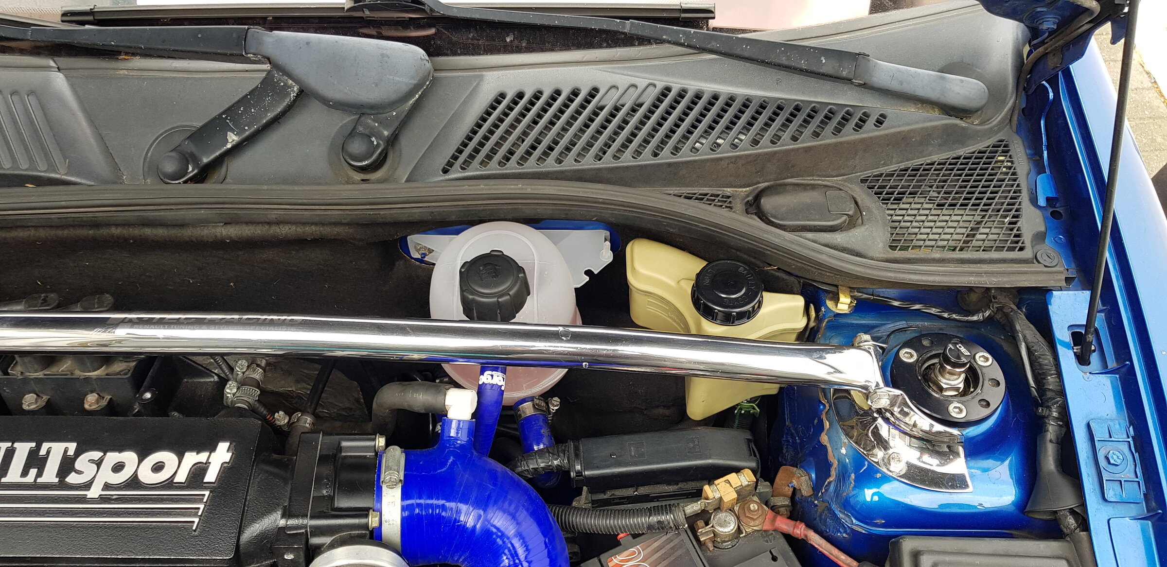

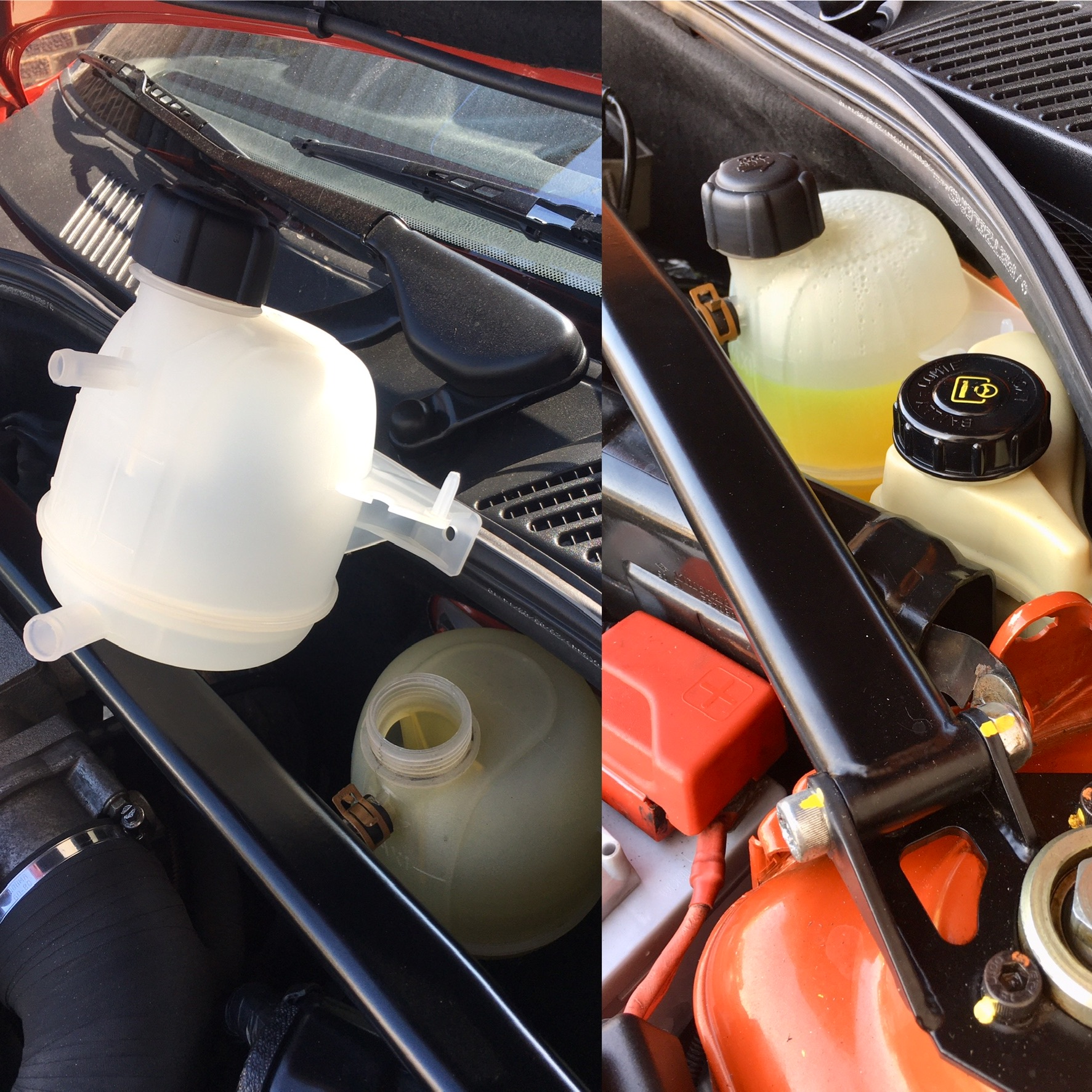

Gave the track car an oil and filter service today. Got some Mobil oil on one of the Eurocarparts offers pretty cheap so thought I would try that.

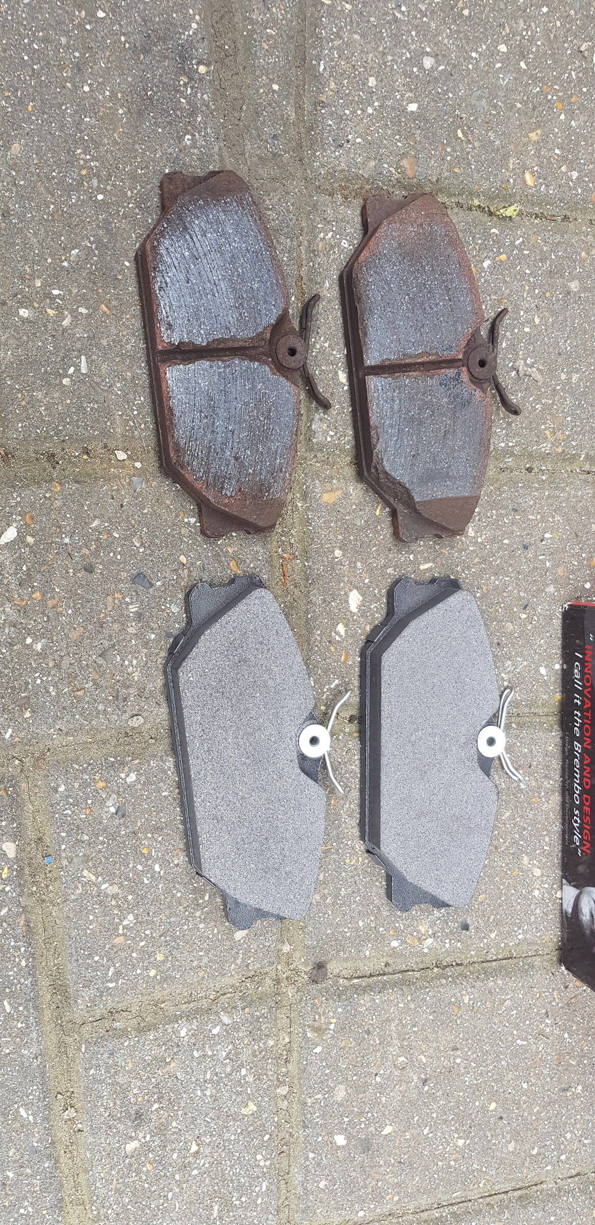

Been getting a bit of a grinding noise from the front brake pads so swapped them for some new Brembo pads I had. When we next do a track day I will swap them for something different as they wear a bit quick on track 😬

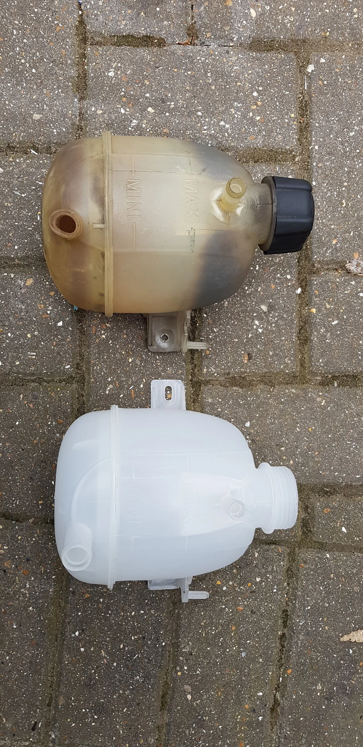

I have also changed the coolant bottle for a new Topran one from Eurocarparts, which I have been meaning to do for ages.
  Clio 182 cup
@Mbeau with the coolant bottle did you use the original cap ? I’ve heard story’s of them not sealing but don’t want to pay £50 for a Renault one 😂
Mbeau
  Clio 172
The cap was not such a good fit to the new tank as the original Renault one, which I have kept just in case. I have fitted one to a previous Clio with no issues though so think it will be ok. Not taken for a long drive yet, but will by the weekend. I will update this thread if there are any issues with it.
£50 for a plastic bottle! I will put the original one in the dishwasher when the wife is not looking 😂
Amos91
Honorary Member
Topran ones don't tighten up nicely.
This one works a treat and is cheap
Few of us have used it fine @frayz
frayz
Yep. Used this one on mine thanks to @Amos91 recommendation with the OEM cap. Zero issues and as good as OEM quality.
Mbeau
  Clio 172
Easy enough to swap over if the Topran one is no good. Think it only cost me about £8 on offer. Might order one of those anyway because it can go on the other mondial!
Amos91
Honorary Member
Sounds like a plan. I've found with the Toprans, as you keep tightening it pops and goes loose again. If you tighten it to just before that point they hold up fine but for a similar price it's nice to have it feel like OEM.

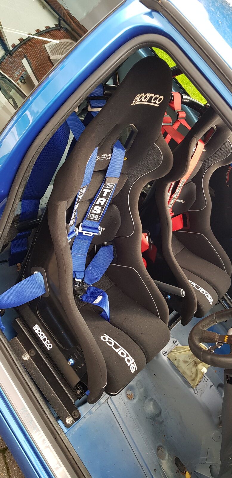

  Clio 172 Cup
Love the ‘club sport’ theme for the track car.
Stripped out racers are pretty wearing to drive on the road (as I have found out) so some carpet and sound deadening make a big difference.
Really like those clocks.
Honestly it has transformed using the car on the road. The little extra weight is so worth it and some music drowns out any rattles! It is quiet enough in the car now to use bluetooth hands free.
I really liked the look of the perspex windows, especially with proper sliders, but they are not practical for everyday use imo. I will probably be selling the doors complete with perspex windows soon.
Clocks are one of my favourite upgrades. I got them from another member on hear.

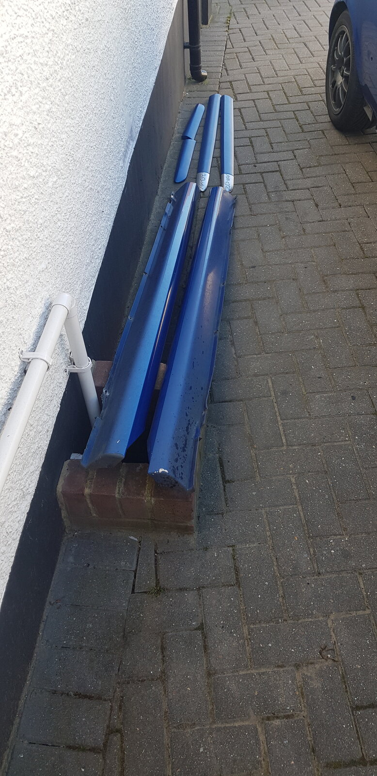

When I dropped the road car off for paint I thought I might as well get a few other bits done as its same colour. The current bumper has a split below the lower grill. I had a spare bumper with some holes cut out behind the number plate in good condition that just needed paint. This has been done and collected. I also dropped off some side strips, mirror caps and side skirts, which I should have back this weekend.
The standard side strips are a matt blue so had the spare ones painted in gloss like the body.

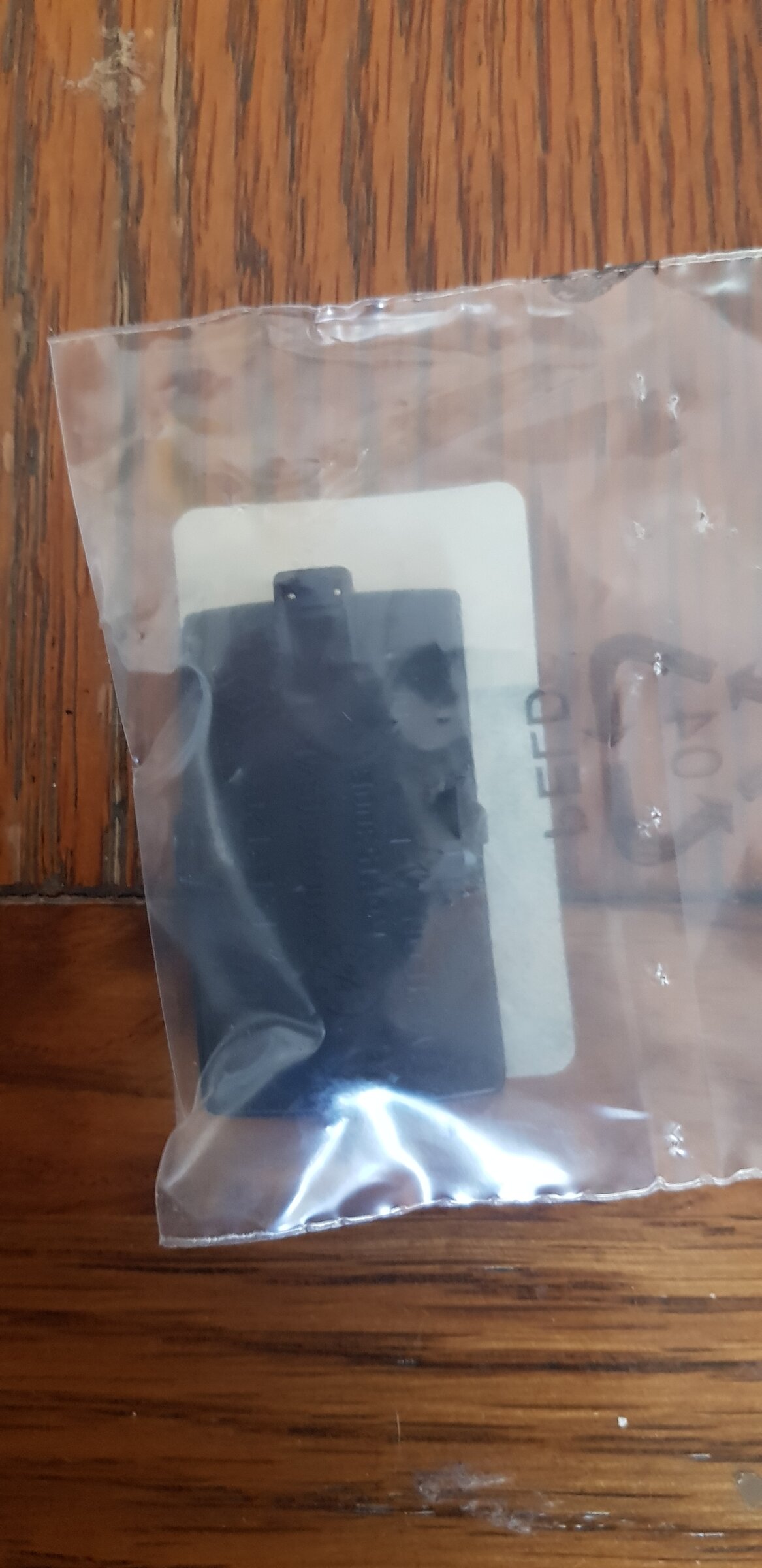

Little update. Ordered some bits for a friends 182 and while browsing I saw a blanking plate for the stereo control on the steering wheel cowling. Will just tidy the hole up nicely.

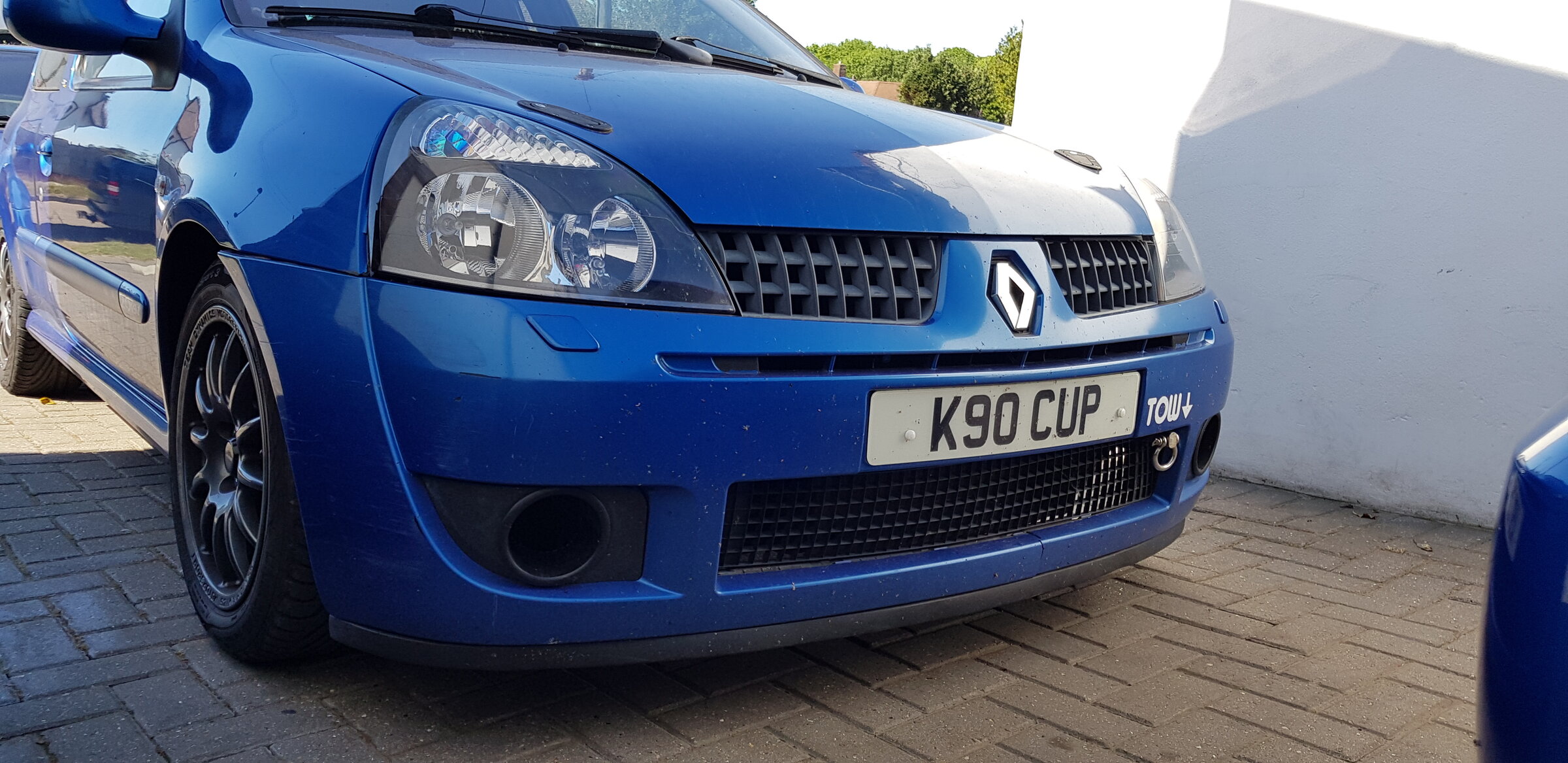

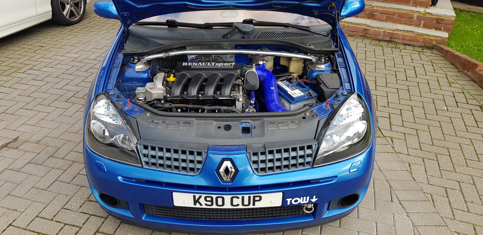

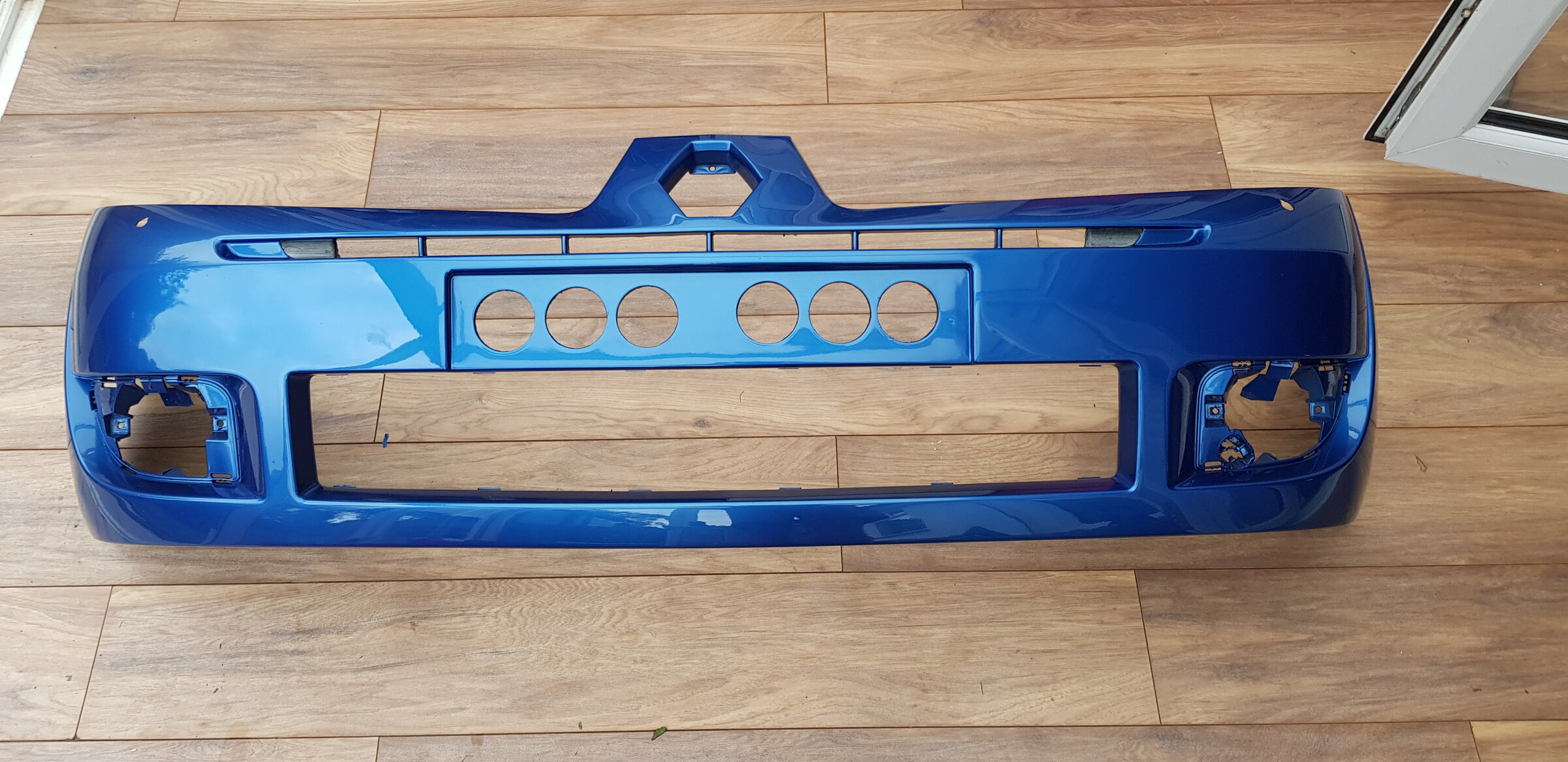

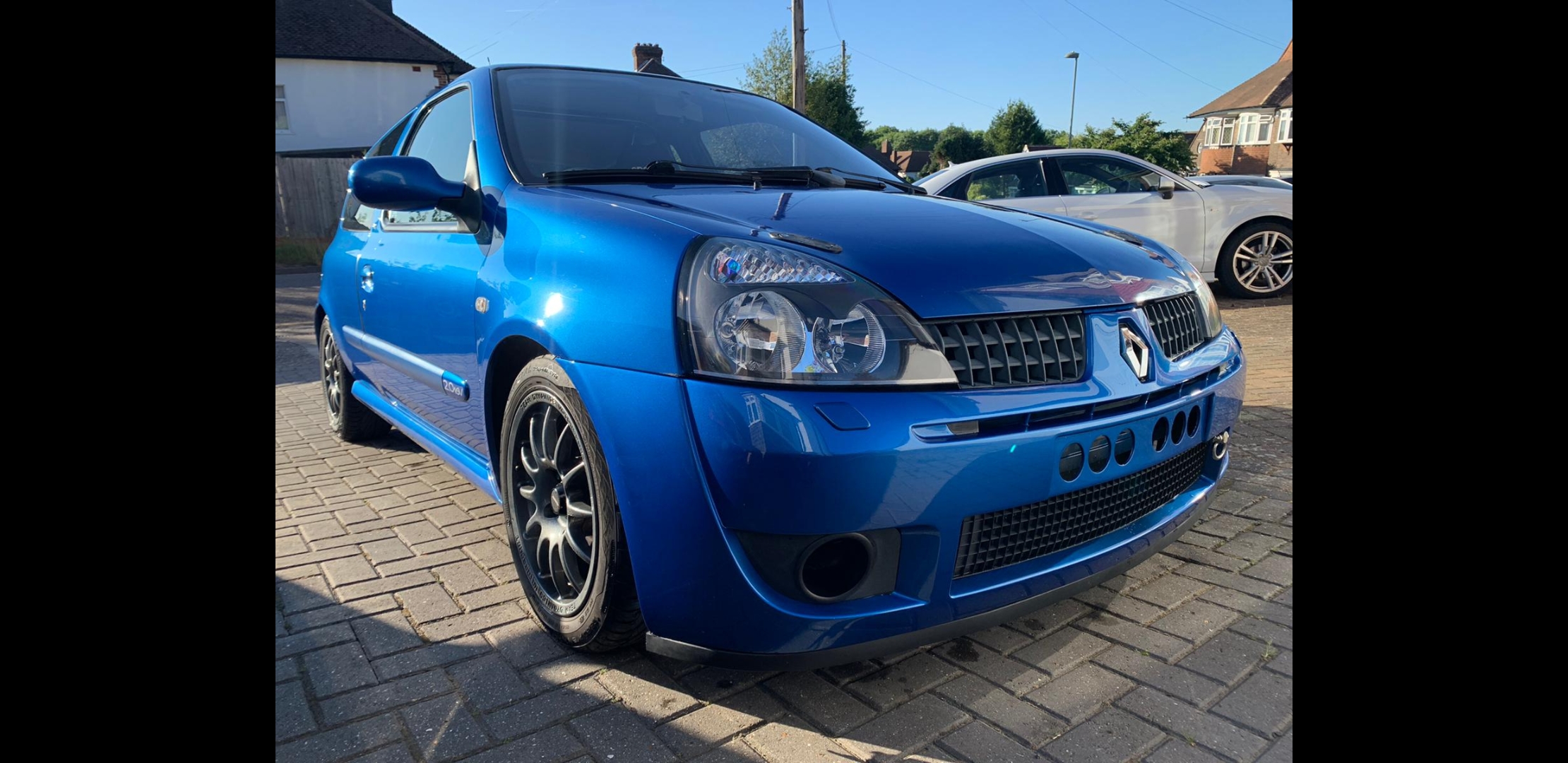

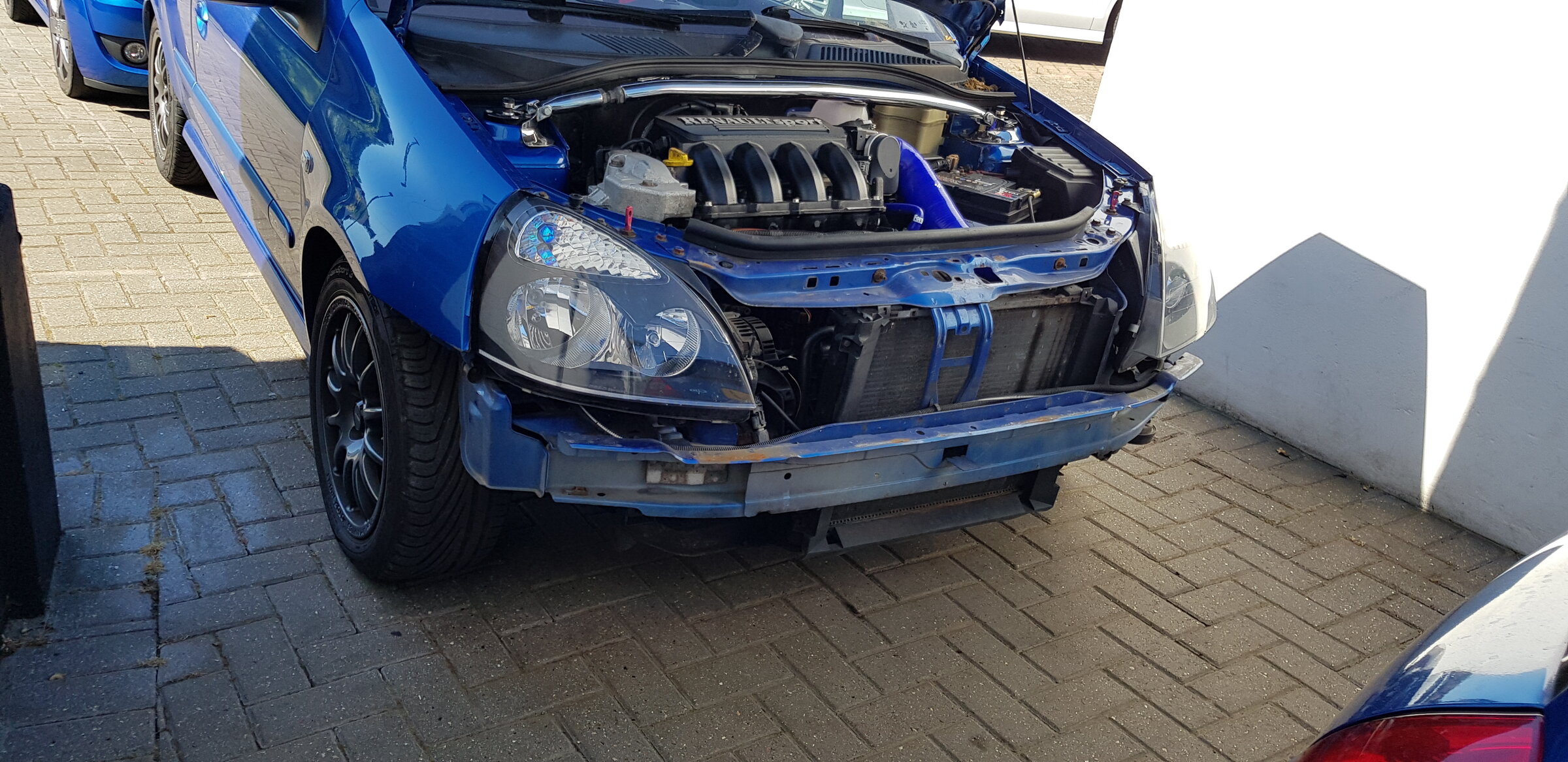

Got round to fitting the newly painted front bumper today. Swapped all the bits over from the old bumper and a skoda splitter I had spare. Gave it a quick clean too. EPAS is now on the cards too.
Old bumper
New bumper fitted.

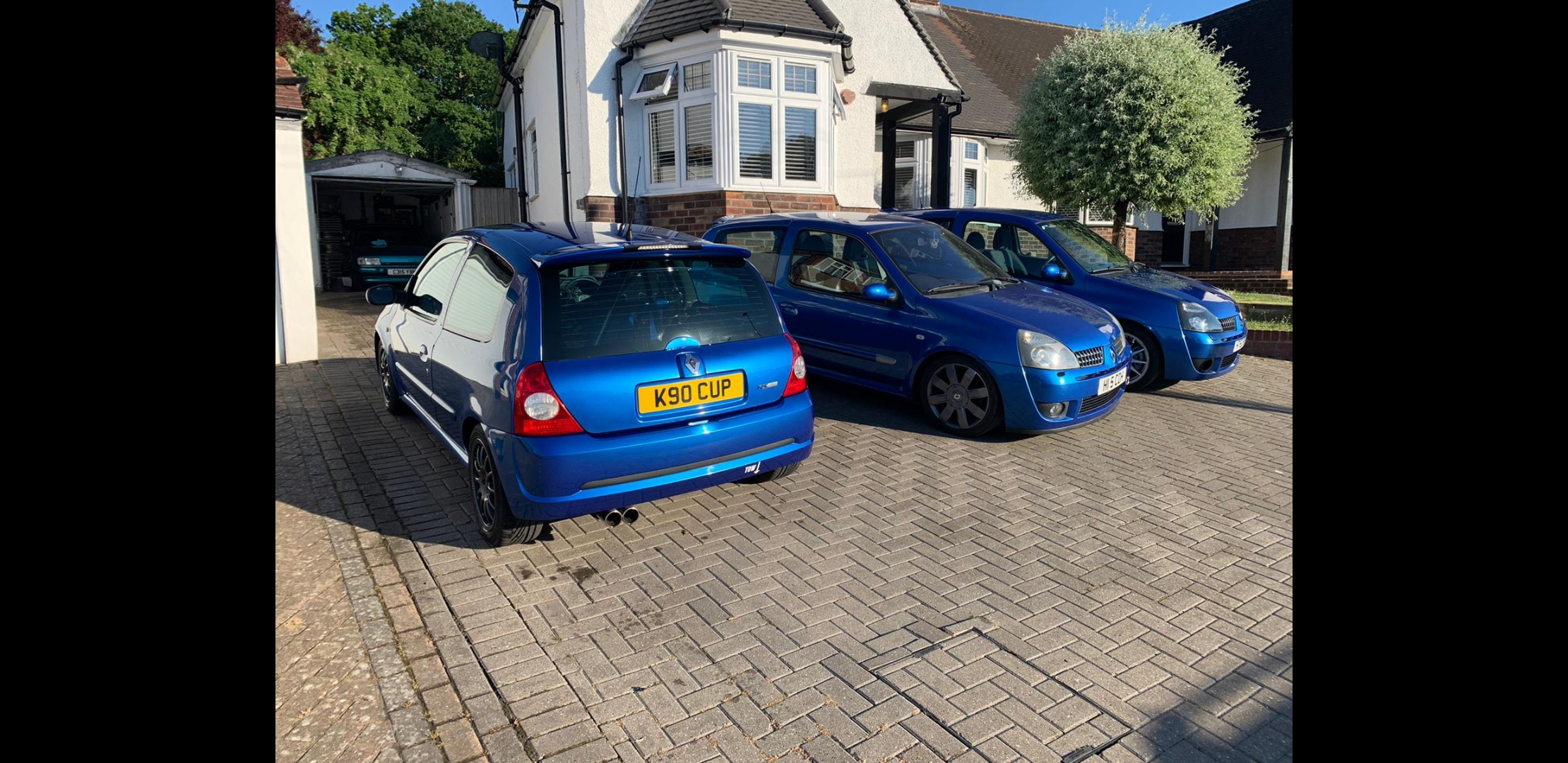

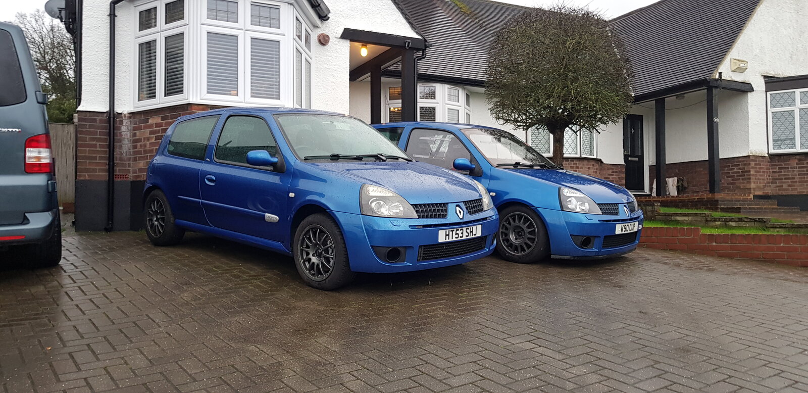

My driveway as been working on a friends 182 this weekend too

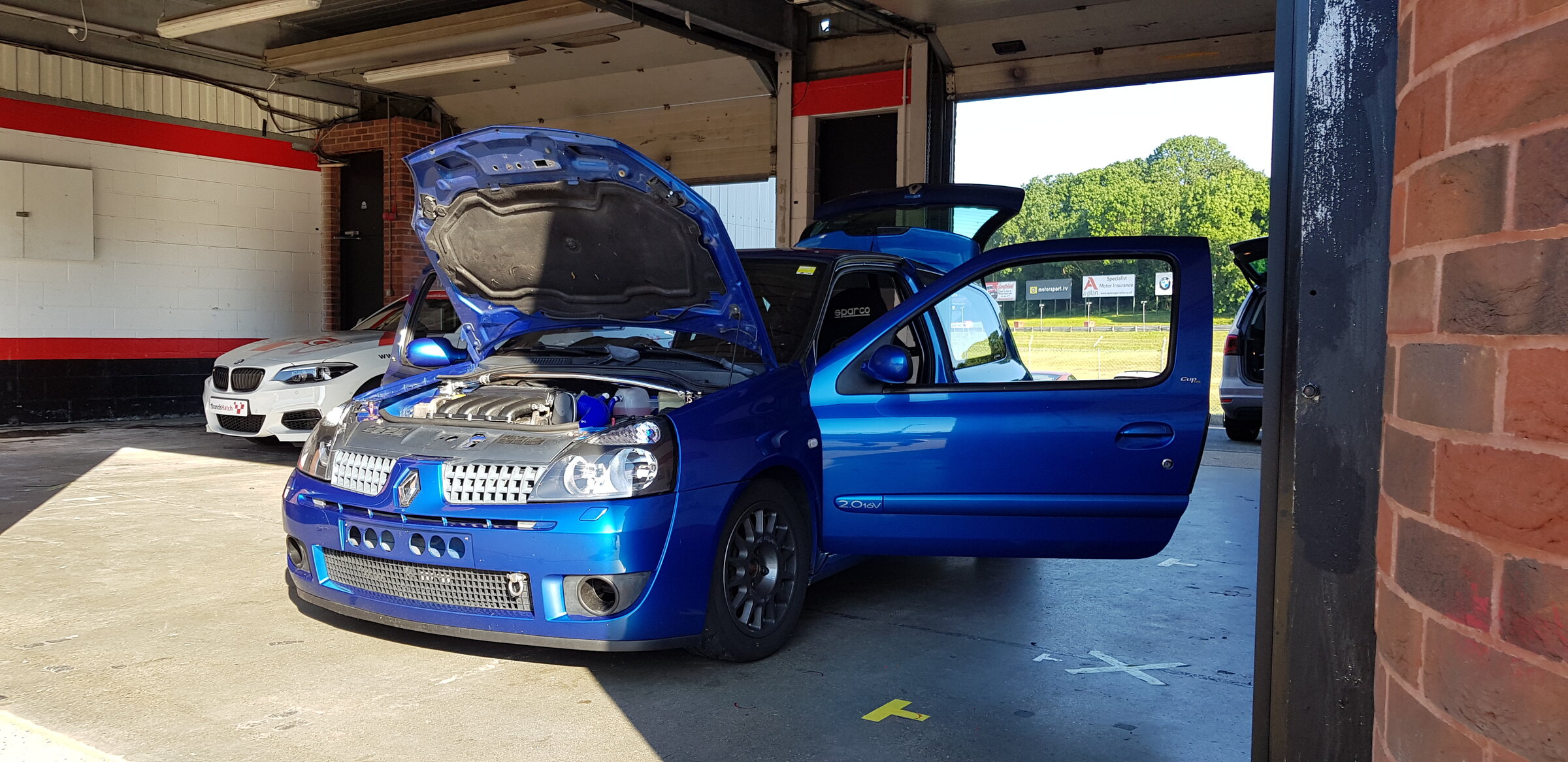

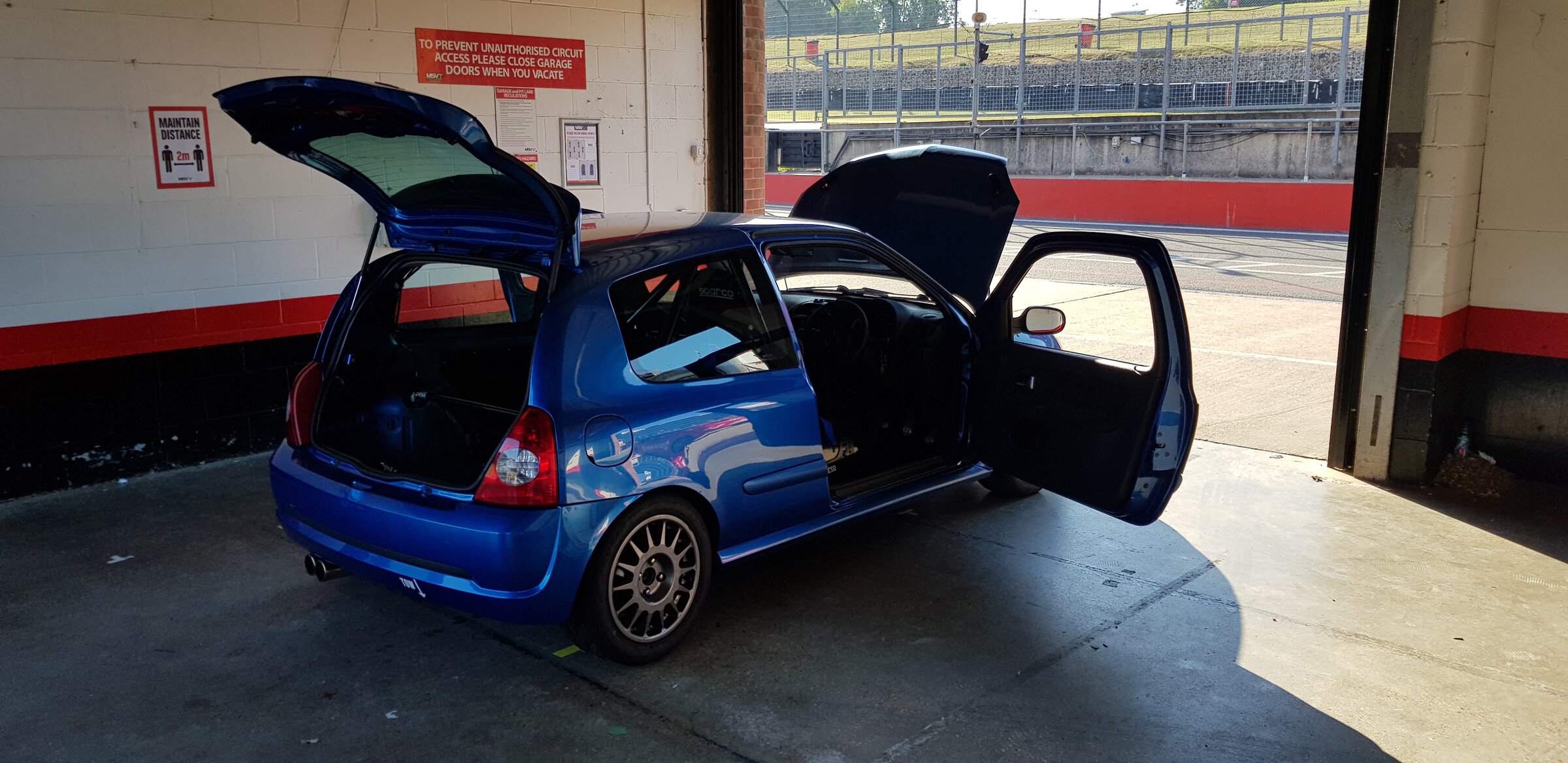

Forgot to update his thread! The track evening I mentioned on the 24th June went really well. Went along to Brands Hatch with my two brother in laws who also part own this car. Car was faultless all evening and the standard Brembo pads held up fine, but do loose a bit of bite towards the end of a session. Fitted the Speedlines with R888's on and grip was amazing. Had a play around with the suspension settings too.
Got another track evening tomorrow at Brands Hatch. I am going in the car with @Somnambulist
Fitted a set of freshly bedded in DS2500 pads today. Have also fitted a mapped ECU/UCH. Clean in the morning as not used the car since last track day. Have put my TD 1.2 wheels on with rainsports to drive there and good chance of rain. Will swap to the R888'S if weather behaves once there. Hopefully get some good pics. Really looking forward to it, rain or shine!
