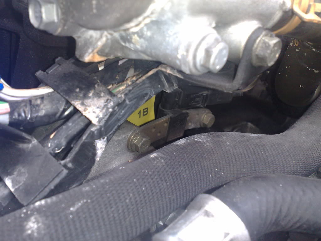

The not starting is likely to be the crank sensor/tdc as above, this is located under the throttle body look for this:
Its under the 1B sticker in the pic. Undo both those 10mm bolts and pull the sensor out. clean out the sensor part - wirewool is handy if you have some.

You also have a new revised "blue" version of the crank sensor.
Thats the one you want! I got mine from a scrapper, but you need to cut the loom as well as the connector is different.

It wont cost you anything, you only need a 10mm socket and ratchet mate, those two bolts, remove them and the sensor will pull out, clean it with some wet and dry paper and stick it back in. Save yourself £50+
