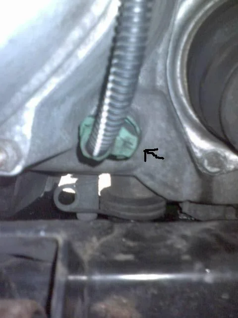

This is what it looks like,
green clip that u press and release, then it is a black plug that is held in by a large nut.

  Volvo S60 T5
Thats the reverse light switch, speedo sensor is at the back of the diff, you can see it from the engine bay.
