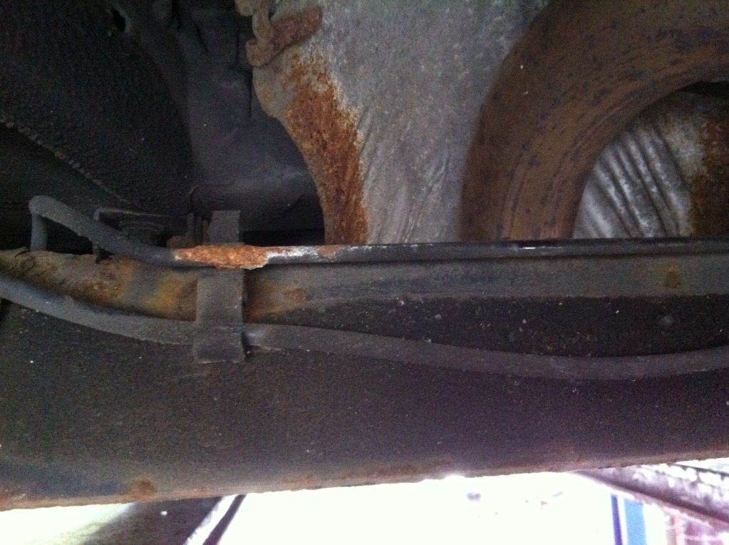

Yes thats it, they are going to replace the part thats corroded. Heres a picture,

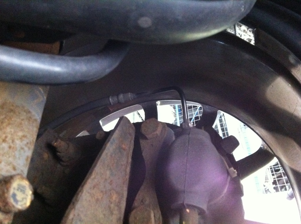

You don't need specialist hydraulic swaging equipment, its just a standard copper brake pipe flaring tool.
The flexy brake pipe should just unscrew from the knackered brake pipe, then the garage should be able to make up a new copper pipe to replace the knackered one and then refit the existing flexy.
The small flexi is swagged onto the pipe therefore specialist equipment is needed. The only screw on flexi is between the beam and the chassis.
A repair will be okay although I would just replace the pipe dude.. How much are they charging you for the repair?
