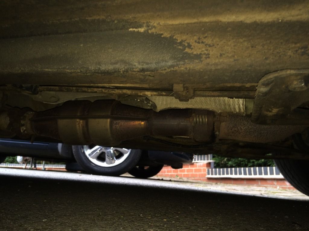

I got the post cat lambda changed and then took it for MOT as its due. My 2004 Clio 182 failed its MOT - On emissions - it should be 0.2% Co2 mine coming in at 0.790%. It has a custom exhaust on it that's a year old, it is not a decat. The garage are telling me i need to replace the manifold to one with a cat converter in it?! Read about and can't seem to find anything about this, they also trying to tell me my car should have the double barrel cat (is this not a 172 part?).

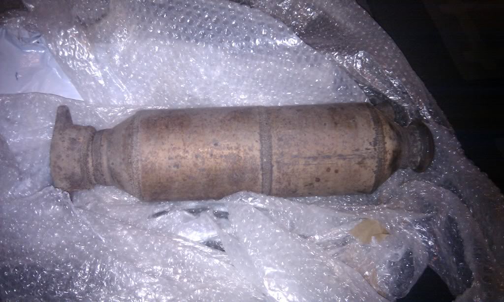

2) Have a look under the car and see if it has a catalytic converter. For the 182 this is a single cat, looks like this and will be attached to the manifold:

2) Yes the car does have a cat

Also there's a possibility that the cat is just s**t - it's not OE.

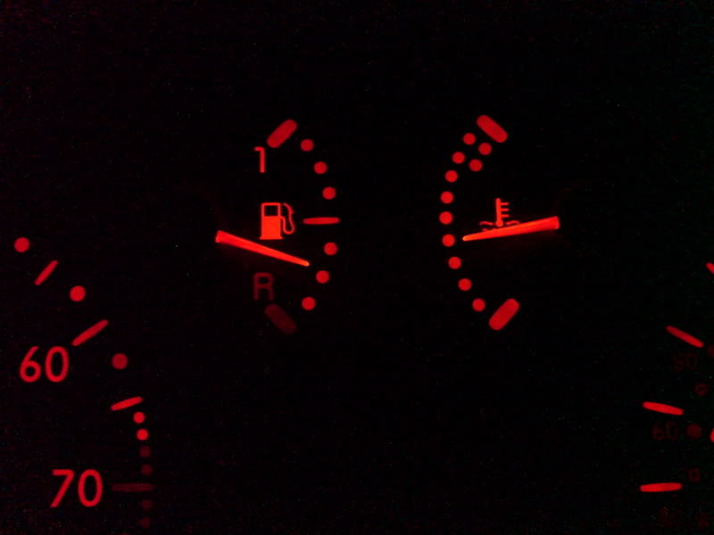

Temp gauge only goes as high as one notch below optimum and stays around that mark. Like this

It's the cat or thermostat. One of the smaller breakers should be able to send a used cat for around £50-60. Obviously the thermostat needs changing regardless so that would be the first port of call.

That's not an original cat. Tbh a double cat (which is a 172 part) would be better than what you've got.

If you ask a question you will get many different replies. My gut feeling however is that the cat is to blame (being a cheap pattern item by the looks of things) and possibly your thermostat being knackered. If it were me I'd get a genuine cat, with a secondhand item being fine and either a genuine thermostat or one made by Thomson; I have not had much luck with pattern thermostats in other cars lately.

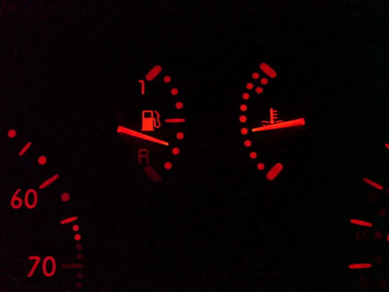

Almost certainly the cat in this case if your MPG is fine. The thermostat however would not help matters. Mine with a knackered thermosat used to slightly higher than that but not by much. The temperature sensor I ruled out; the last owner changed it with no success. The car now runs better when warm.
