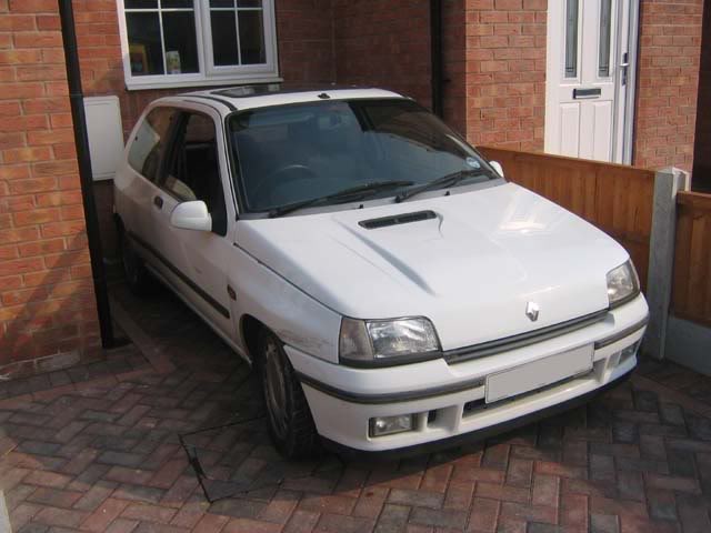

Late last year my brother gave me his Clio as he needed something bigger for the family but didn't really want to part with the car. On saturday I had an MOT done on it to see what kind of condition it was in.
Most of the stuff is minor and really easy to fix, however I haven't a clue when it comes to the steering rack and would like an idea of how difficult it is / time consuming for the garage to repair.
I have not driven it much but I can see why my brother didn't want to let it go entirely (he has borrowed it from time to time!), its a cracking little car and I would really like to get it on the road.
Apart from a little play in the steering wheel it seems a sound car. The body work needs a little work as there is some minor rusting here and there but the interior is just like new!

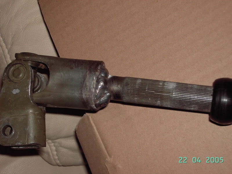

Play in the steering, you sure its the rack mate? On both my old wiliams and valver, it just needed the column welded..
as this pic shows..
I was going by the advice from the MOT station tbh. I will strip it down and have a look myself now. Thanks for the heads up!
Is this a common problem on these cars?
Yeah common problem mate. I didn't weld mine, just bought a new rack and column when it came to the cruch. :)
with mine I just used a self tapping screw... basicly enough to wedge it in place really... might get my mate to weld it up though I guess, lol.
