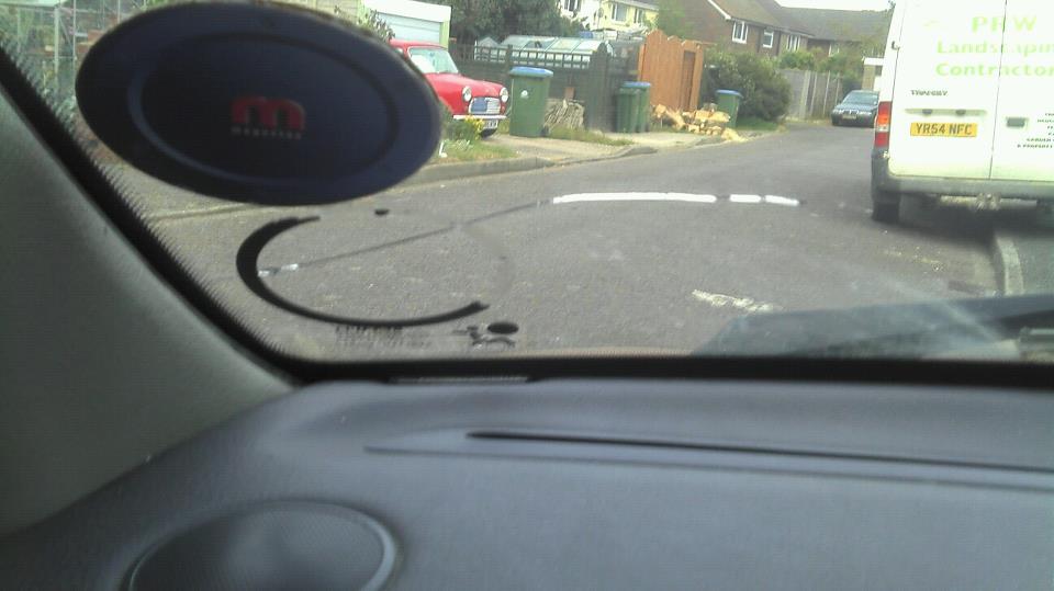

any mot testers out there or anyone know if this will pass the next MOT. thanks in advance :)
I was expecting a chip, not a 7 inch crack.
Got windscreen cover?
no its a crack but only just in the swept area, i am aware of the rules but was checking with hope for the best

Just put a shorter wiper blade that side to miss the crack and it will be a pass and advise as it will be out the swept area !!!
Then get it sorted before it gets worse !!!

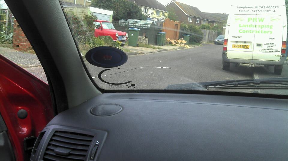

I would avoid big bumps with that crack or it's going to spread right across!! Looks pretty much a fail from those pics! :eek:
It's definitely a fail. Get it repaired as soon as possible. Especially now the cold weather is setting in.
Yeah sorry to say mate that would be a fail. As also someone has said above ^^^^^ the cold weather is coming with that still there you may not have a windscreen left.
As said shorter wiper and it wont be a problem. Obviously clean the window so the dirt line moves, people worry too much I would leave it until it gets bigger its not in your direct vision.

That should fail.
Mine cracked, but in a different place, when I was in France. It grew every day for the next week, as soon as I got back to the UK I had it changed.
It's not worth the risk, the clio screens aren't even that expensive, think my trophy was only about £120 not through insurance. Yours might be a bit more if it has auto wipers.
A chip under the size of a 5 pence piece can be fixed with silicone. The crack you have pictured will fail...especially if the MOT tester is doing it as he should. The only way something of that size wouldnt be 'so' bad is if it was by the scuttle panel on bottom of screen...but I wouldnt want to risk it.
With the wiper blade he has now yes... But get a smaller one it will be a pass and advise :)

It should fail.
I'm not saying its going to fail because we don't know the MOT tester, but according to the law, it SHOULD fail.
No it will not. Any crack of that size, anywhere, is a fail.
Your right McGherkin my last job for 6 years was to prepare cars for MOTs its a fail
Its touch and go tbh i had a 4 inch crack in the middle of the passenger side on mine but it got passed on a mot :/ something about the rac having laptops or something on the passenger side and as the drivers side was clear it passed no advisary :/ but may depend on mot station

If a crack touches the edge in two places it is a failure. At the end of the day as it stands at the moment it is a failure.
Yes you probably could fit a shorter wiper blade but you aren't solving the problem. Fit a new windscreen and everything is ok.

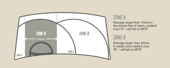

No you can't. No damage more than 10mm in zone A, 40mm in zone B, zone C (non swept area) is a slightly grey area but I do know you can't have a crack that touches the edge in 2 places.

If we're going to get picky then, remembering that a clio's wipers wipe in the opposite way to most cars, according to this, that car will fail. (bottom left, the whole screen is covered by the 'wiped zone'.)
