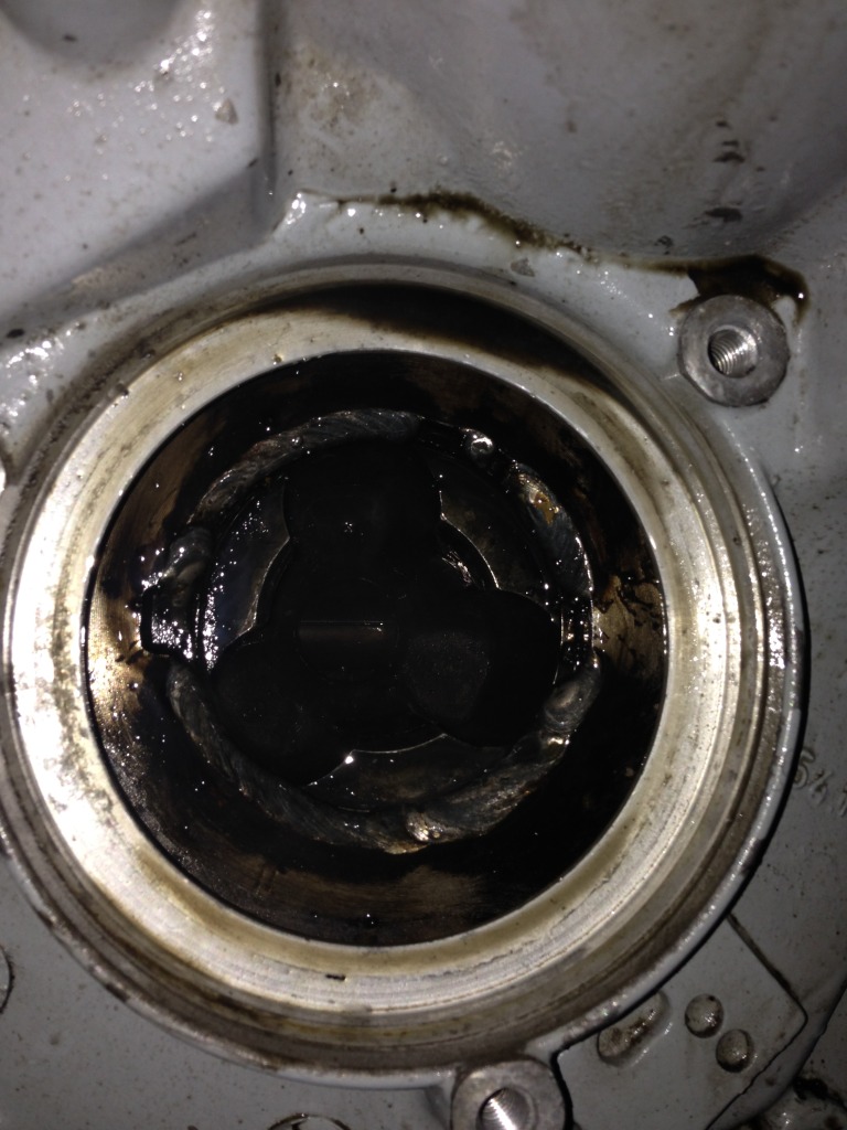

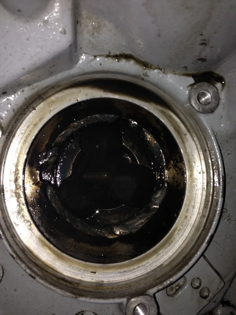

Here's the one it broke. In fairness it probably wasn't the best weld, it was done in situ, at about 2am after I'd been recovered back to the garage. So it was very much a rush job.
Game over for it as it lost bits of circlip and thrust washer in the casing. And I despise breaking a JC5 apart. f**king things.

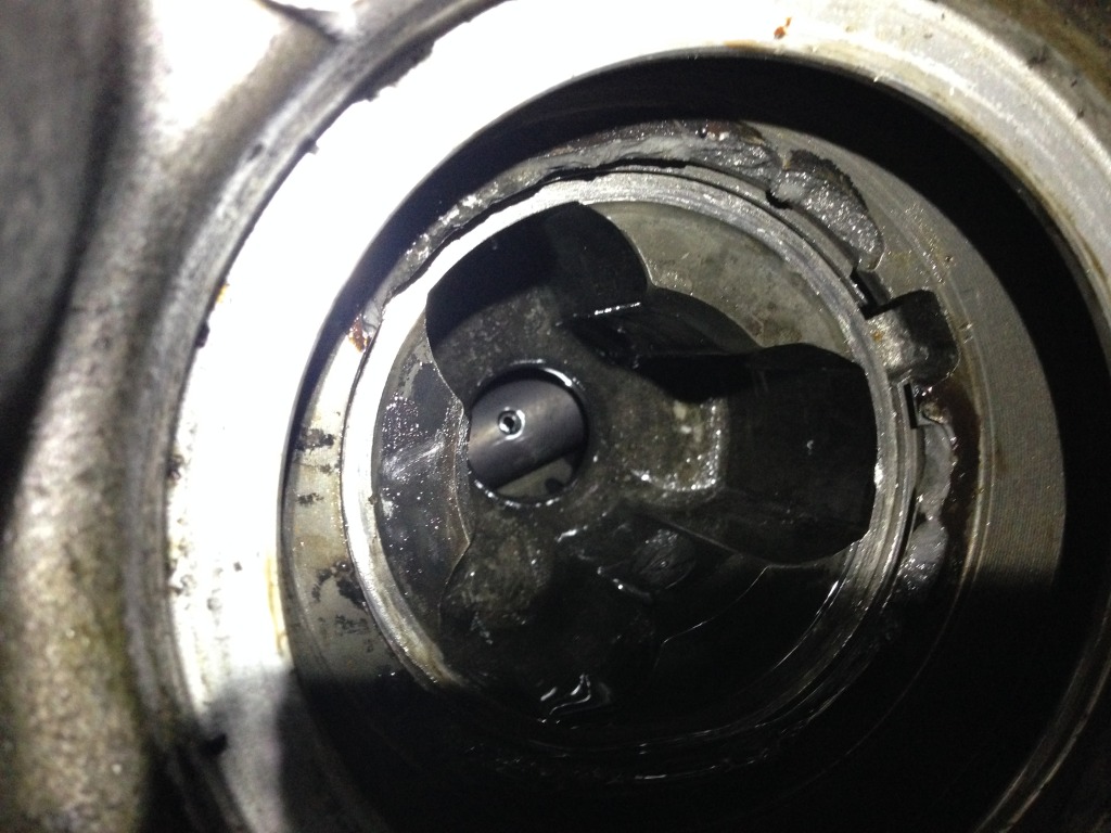

Here's its replacement.
