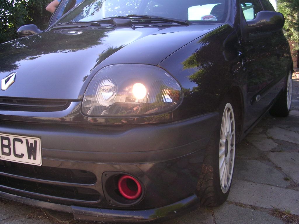

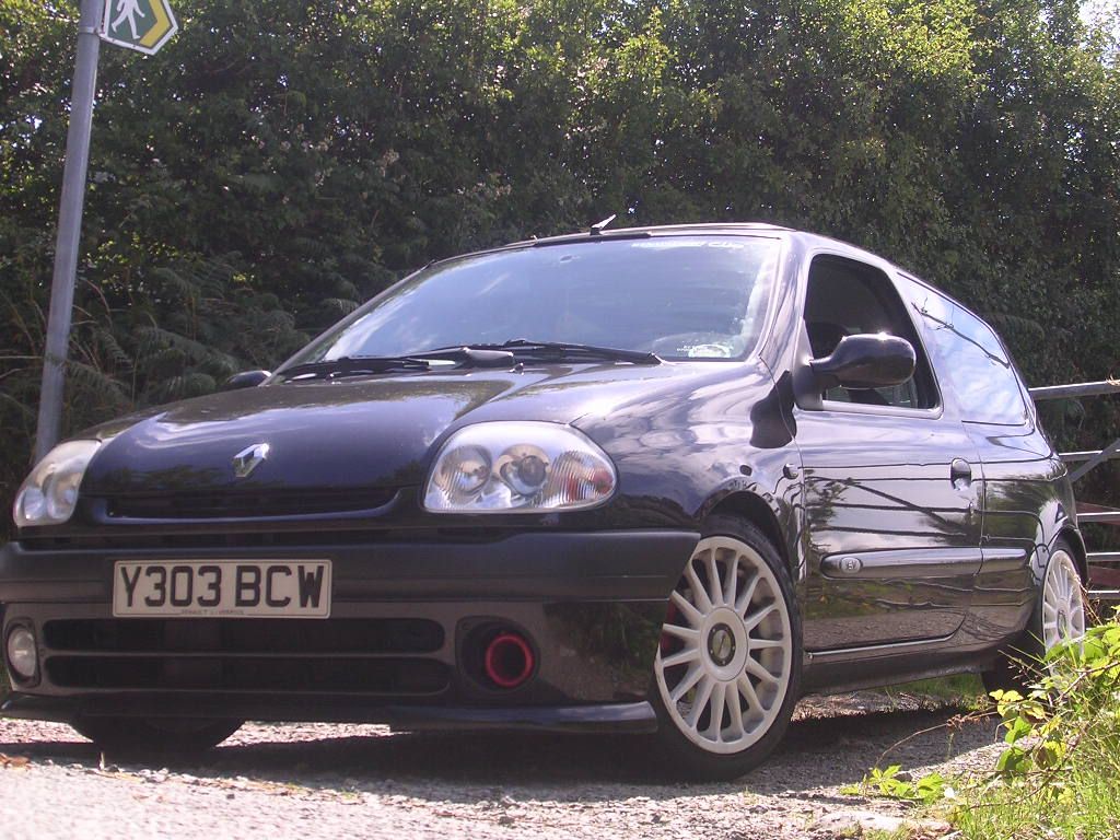

yer i mean, i masked for the main beam n the indicator, the dipped is projector so doesnt need the reflect, checked last nite
  C63 AMG, F430 & 172
amen to that lol, that car and evry thing u see on it has been done by me, i have never been trianned to do stuff like that either lol, spent a cira 3k on it, imigine the cost with labour on that

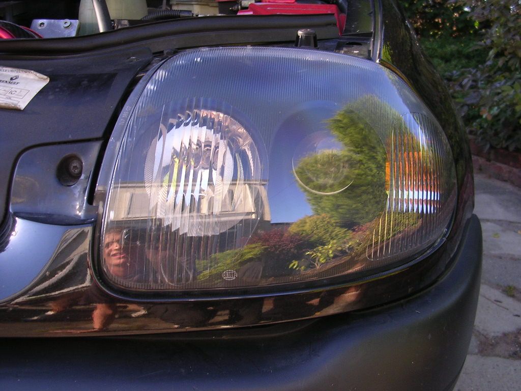

They look wicked, Ive been thinking about doing the same with my lights. Did you strip the chrome plating off or just paint over the top of it?
  A well built VW
Needs silvervisions !!!!
Looks cool dude have thought about that myself but those lights are like gold-dust
What kinda paint did you use ???
Has
  RS 182 - Black Gold
Look very cool !!
Hows did u get the glass off the front?
I thaught they are vacumme sealed with HOT glue and permanantly bonded on?

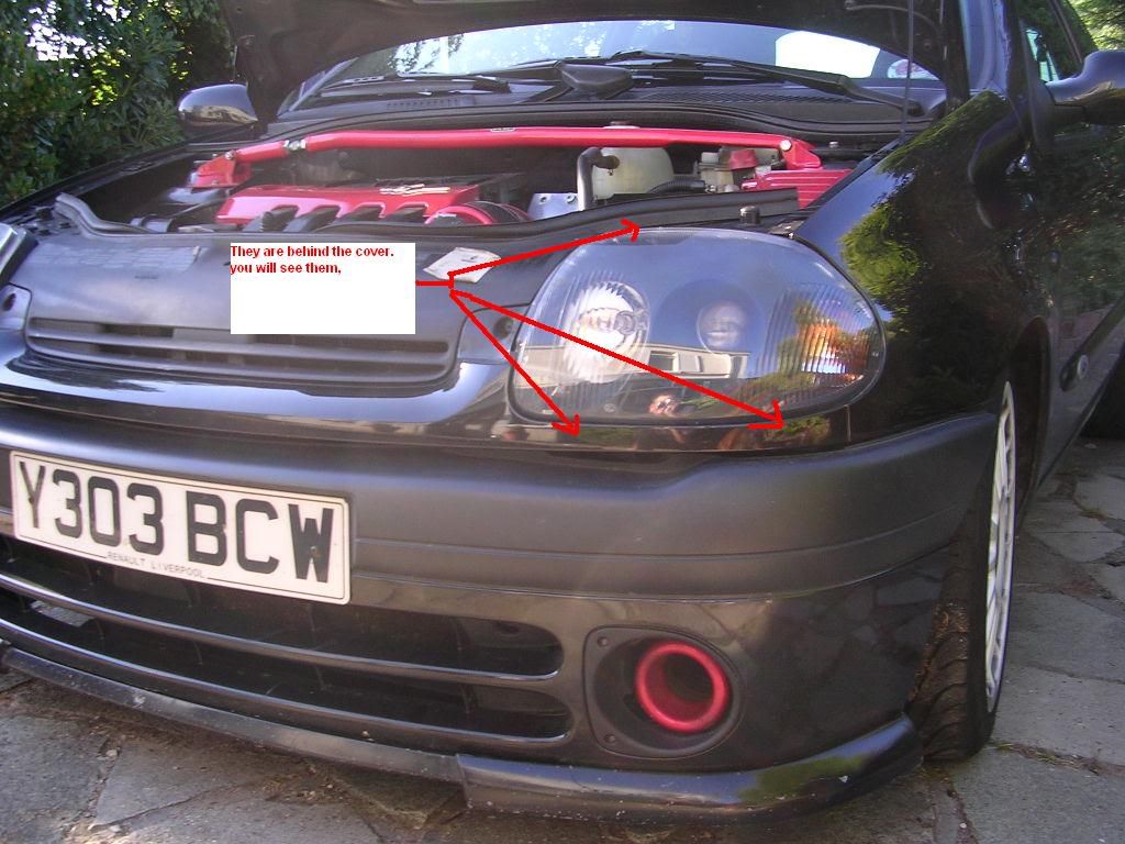

Hi, all i thought i would make a giude. if any one wants to do it themselves
1 firstly remove the 4 torx screws on the lock and bumper cover
http://i2.photobucket.com/albums/y43/ben_p/edit1.jpg
2 The cover is clipped in at each end, these clip will pull out with some persuasion

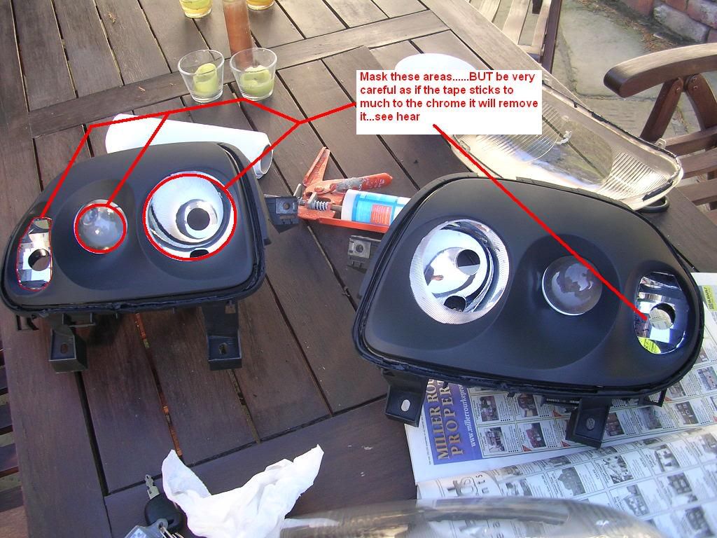

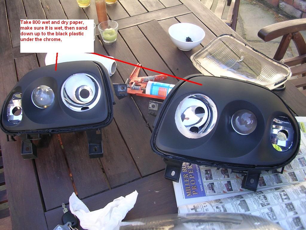

4 Once the lights have been removed take a stanly blade, and a wide flat head screwdriver, start to prise and cut the gum when SLOWLY seperating the perspecs screen.
5 Then mask the main beam and the indicator sections, i only did the back of the indicator and also masked up t the corrigated part on the full beam (u will understand when you open them up) NOTE DO NOT SURPRESS THE MASKING TAPE DOWN AS WHEN U REMOVE IT, IT MAY PEAL THE CHROME PLATE! then cover the projector bulb with tape,
http://i2.photobucket.com/albums/y43/ben_p/edit4.jpg

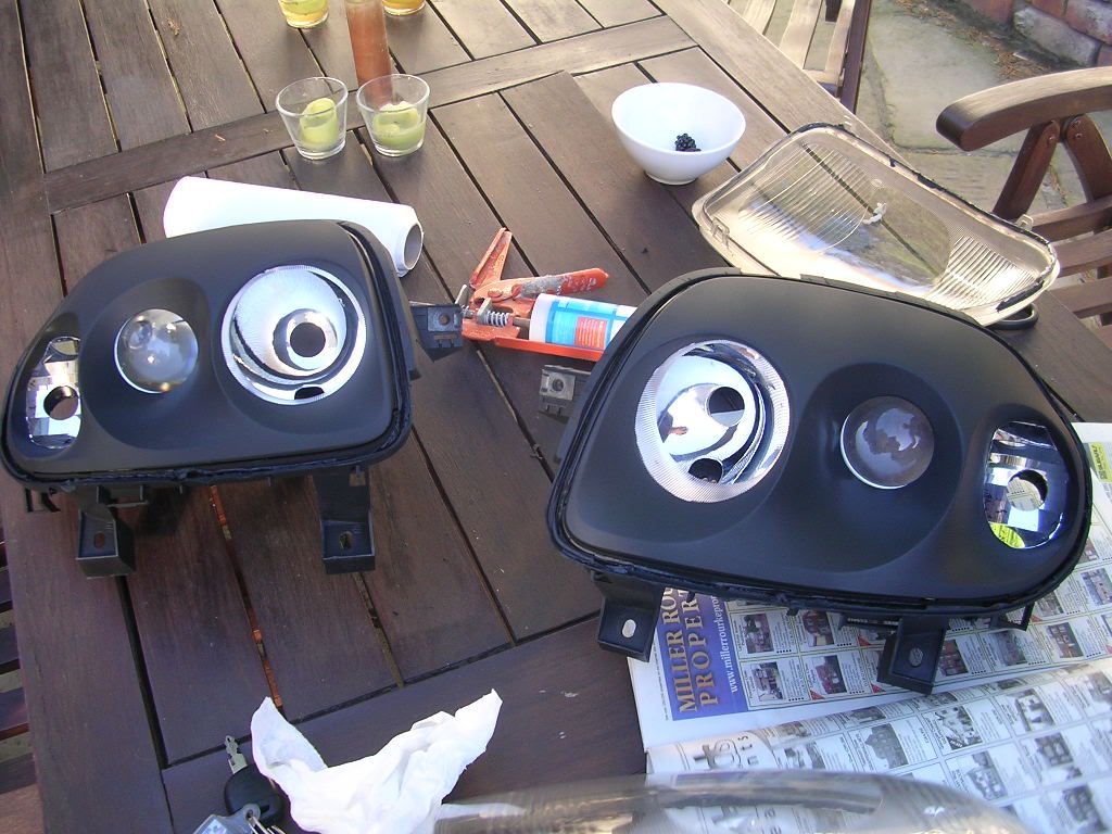

6 Then take the sand paper and remove the chrome plating around the tape, then clean the paint off with a moist wet cloth,
http://i2.photobucket.com/albums/y43/ben_p/edit5.jpg
7 Now apply plasticoat matt black, 2 or 3 times over the lights and alow to dry for 30 mins
8 remove the tape revealing this.............
http://i2.photobucket.com/albums/y43/ben_p/pic2.jpg

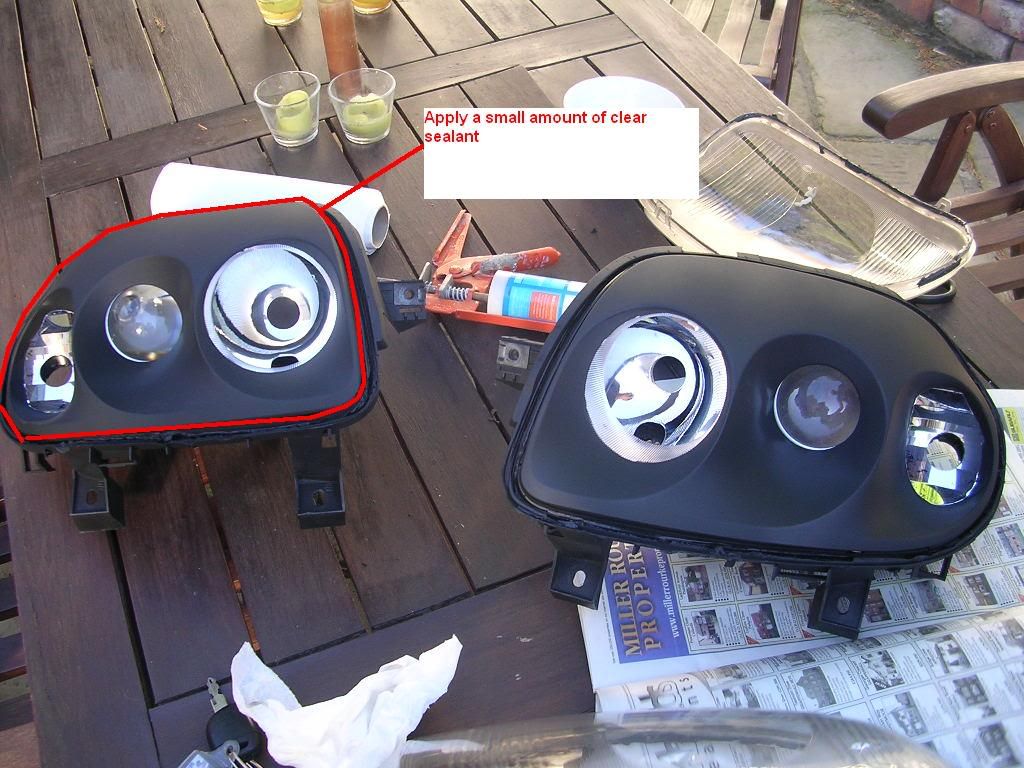

9 Then clean the inside of perspects cover with window cleaner, apply the sealant and slowly join the two together, the old gum will still be sticky once lined up, apply a lot of pressure on the cover to get a good seal.
http://i2.photobucket.com/albums/y43/ben_p/edit6.jpg
10 then re fit the lights to the car, clean the covers and .................
http://i2.photobucket.com/albums/y43/ben_p/DSCN2695.jpg

oh i got the pressure washer out n tested for water, no leaks lol, n this morning there was no condesation

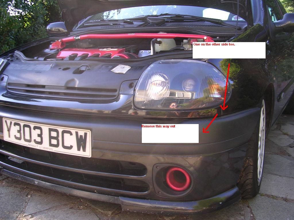

nice work ben.
ill call you when i get back from the u.s, could you give me a hand with some polystyrene to do what you have done in the back?
  Black Clio 182
looks really good mate. where did u get your front splitter from and how much was it. want one for my clio.
