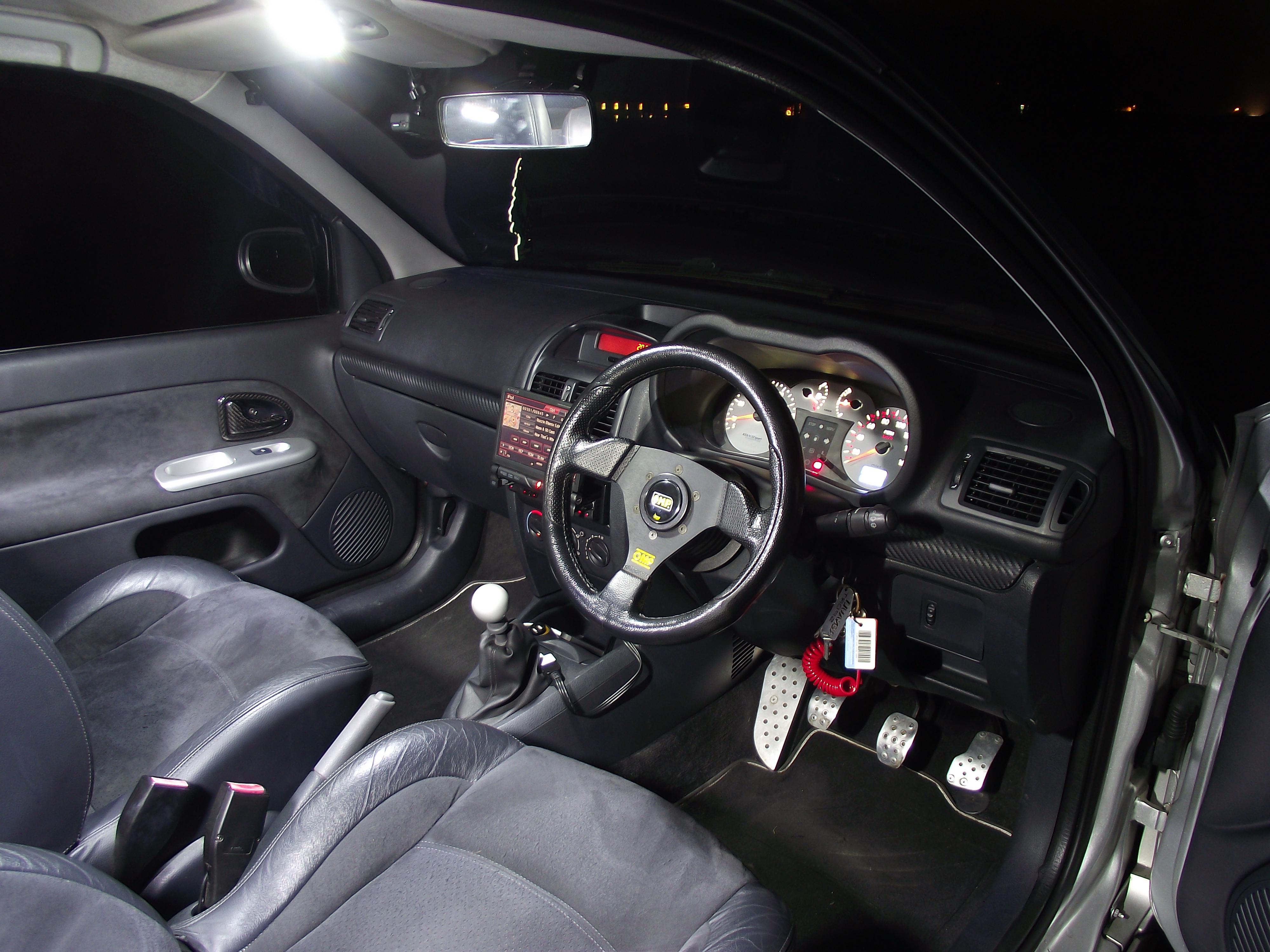

Phase 1 dash on a Phase 2
  Clio mk2 RS phase 2
I know I sound a bit unorthodox, but in my eyes the first version looks more classic.
Can it be done?
I already have phase 1 door cards.
