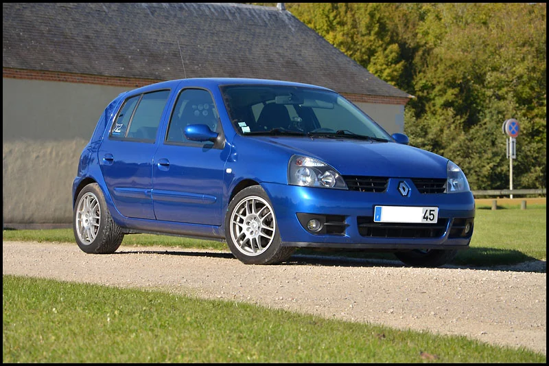

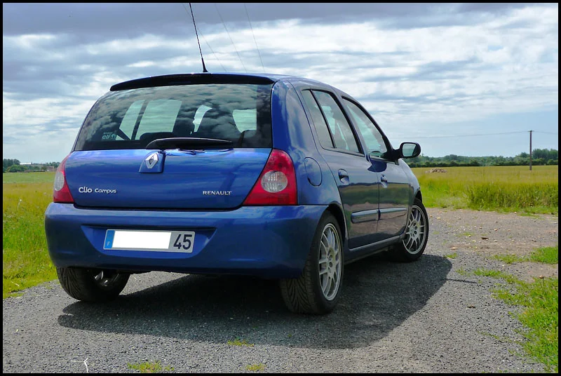

And now some recent pictures of my Clio :

really nice pics! like your car too! as for your plans, don't bother with sunroof, roof bars, window tints or mudflaps ;)
Thanks mate ! :) My plans are not 100% serious, but I really want to install a sunroof. Mostly because I want one, but also because of the challenge. if you know what I mean ;) When I have an idea stuck in my mind, I always end doing it. :p It was the same case for the rear discs, i did not really need it but really wanted to perform the install.
That's really cool, can tell you've put a lot of effort into that.
Thanks a lot ! :) It's the case. Now I'm really happy with the way it looks, handles and sounds.
