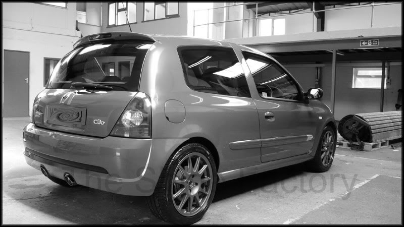

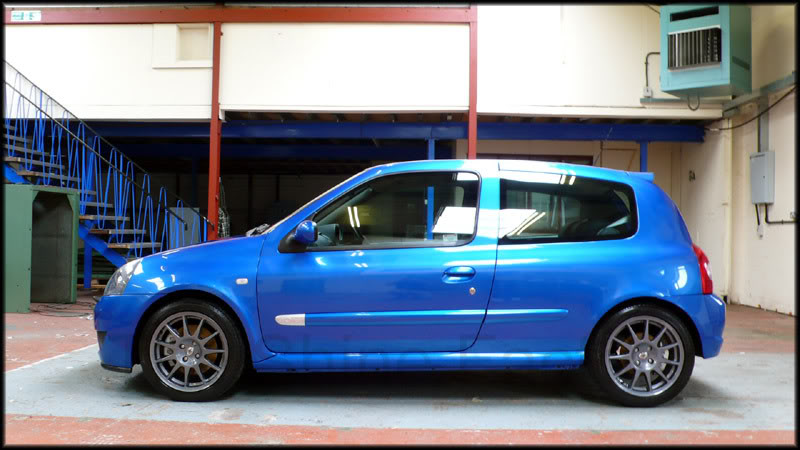

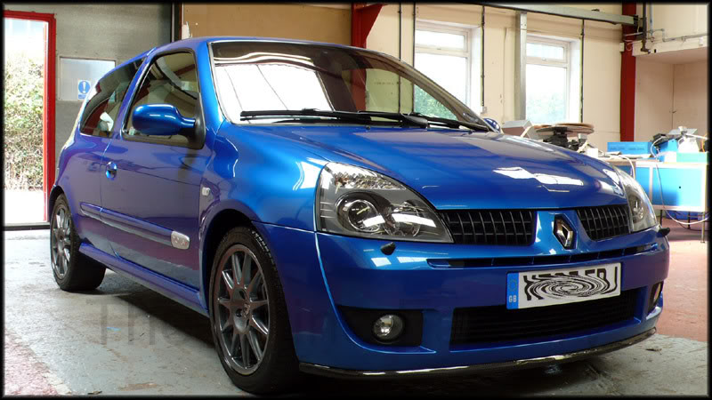

My 10hour 182 detail with brazo (56k ha ha)
Woke up at 6.30am this morning drove to my new garage, and started washing my car ready for mark (brazo) to come and work his magic. and he did lol see below !!!

yes very happy lol. just wish we had some sunshine now lol

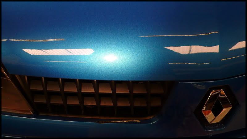

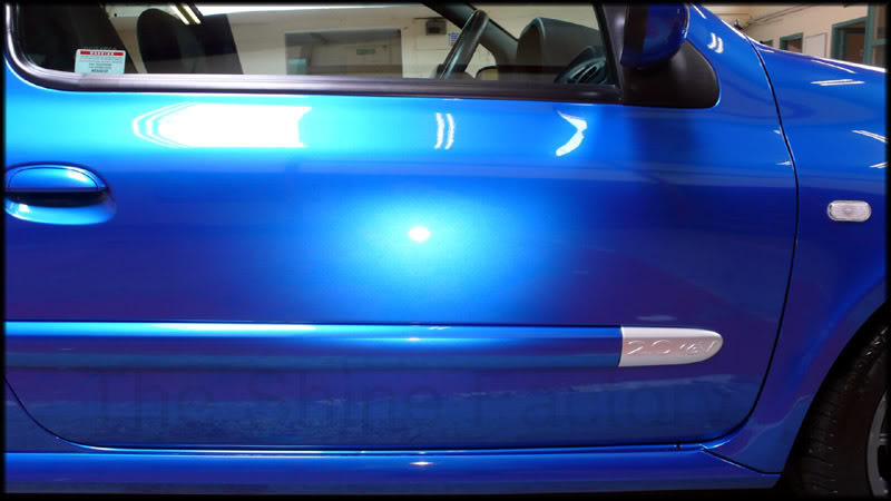

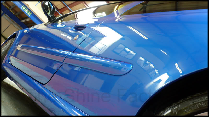

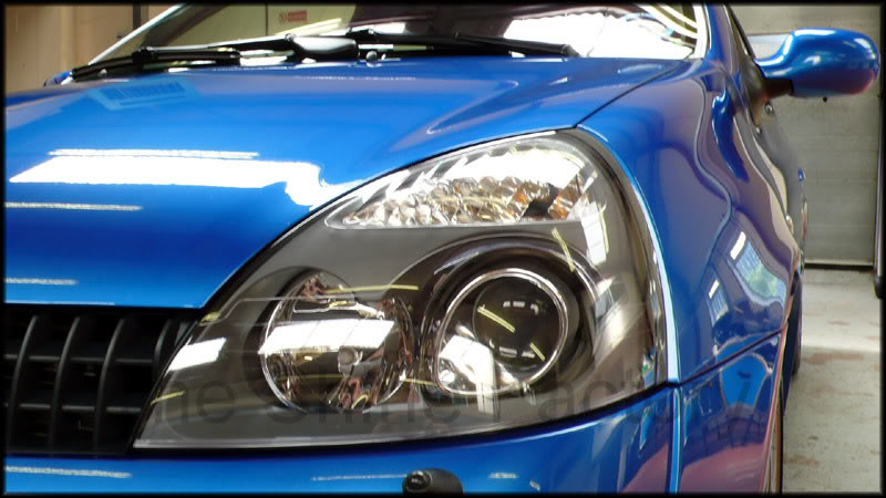

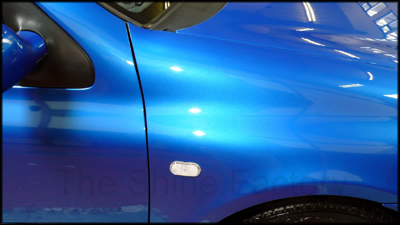

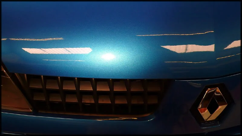

Full Process
washed with two bucket method, lambswool wash mit, chemical guys body wash and wax, dryed with megs water magnet.
  • Clay with sonus green and megs final touch
  • Polish with makita rotary and intensive polish via a megs polishing pad.
  • IPA wipedown
  • ZFX enabled Zaino Z5pro x2

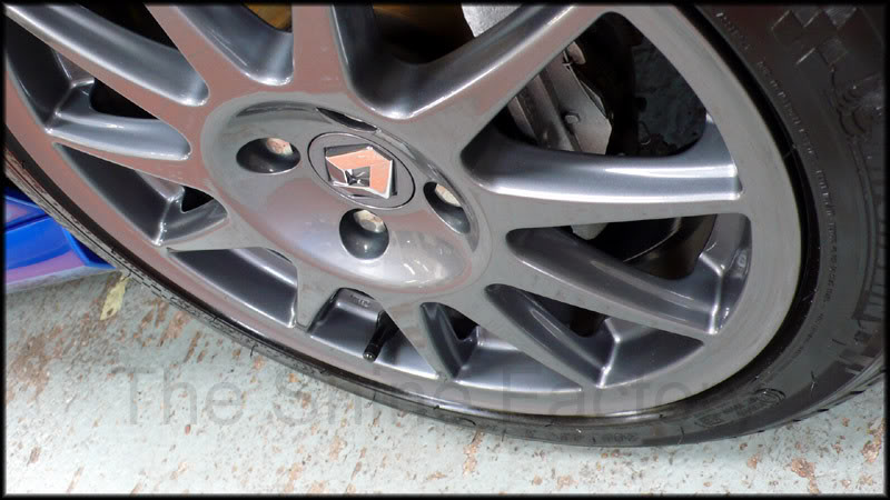

  • Wheels- IPA wipedown and Zaino Z5
  • Tyres and trim chemical guys new look trim gel
  • Glass megs pro glass cleaner
