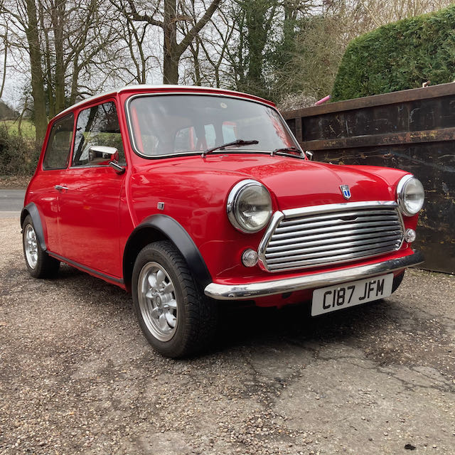

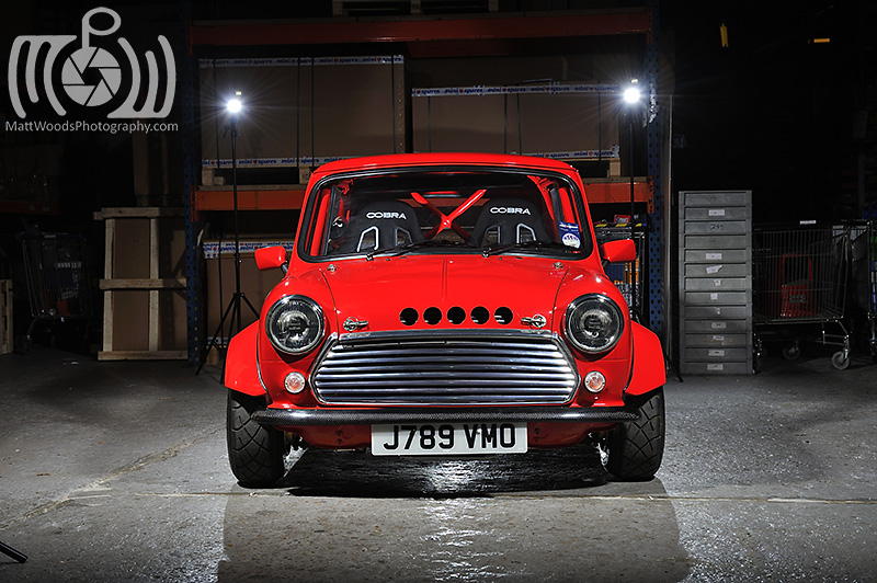

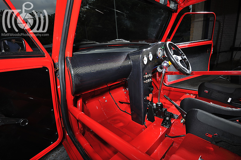

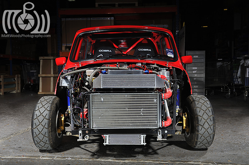

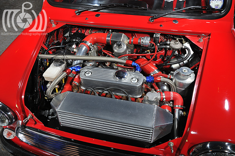

Glad you still own it, here's mine, owned it over 20 years now.
Oh they’ll be plenty mate, I’d guess the majority of the regulars on here are around 40 and likely started off with minis or had mates who did.
I’ll have to find some pictures of mine, albeit they were taken pre digital cameras!
That looks proper that mate!! 👌
I had a Mini Cooper S many years ago, I've been told, it's in the Heritage centre now. Many happy memories with the wife, and three boys in the back.
That looks like a fairly serious build @T3gav - great to see it!
