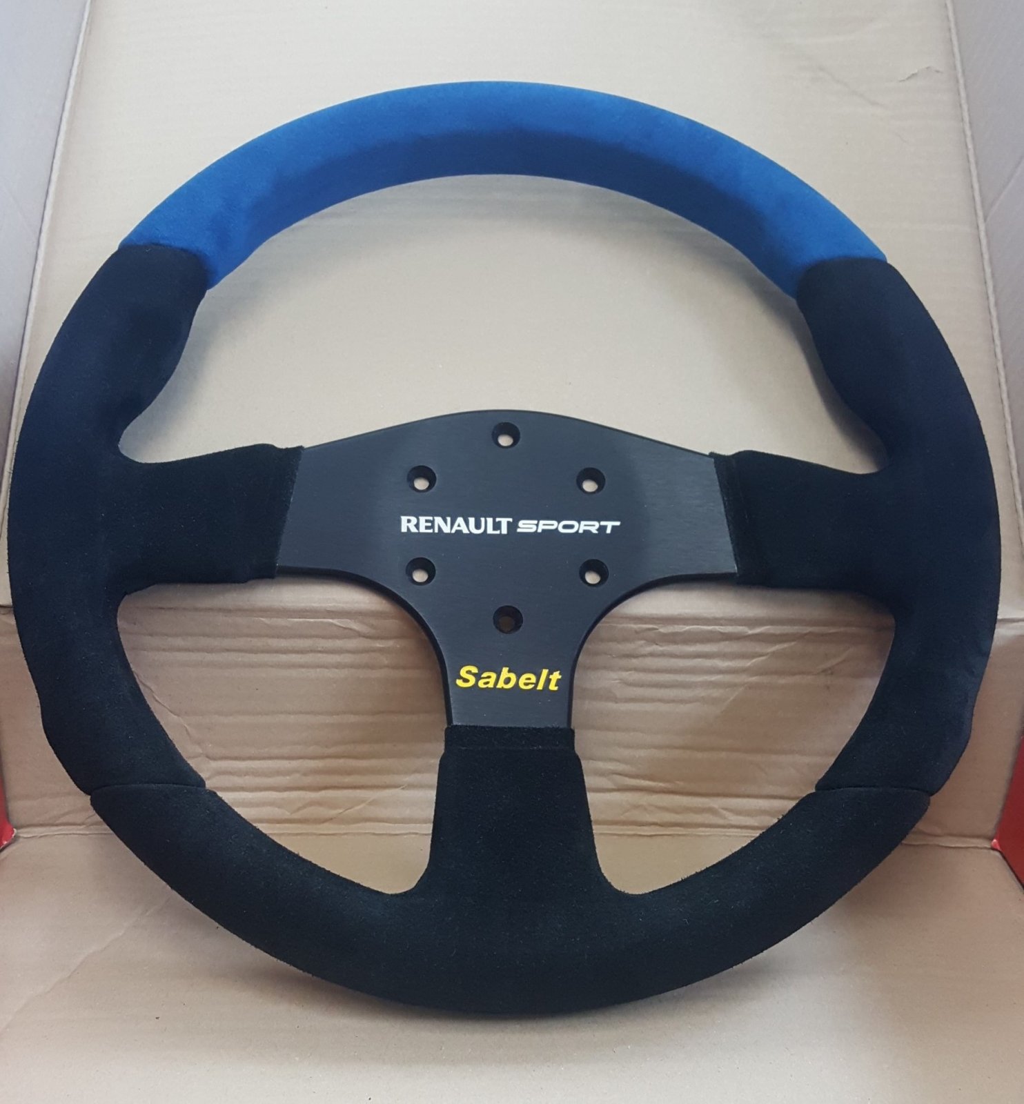

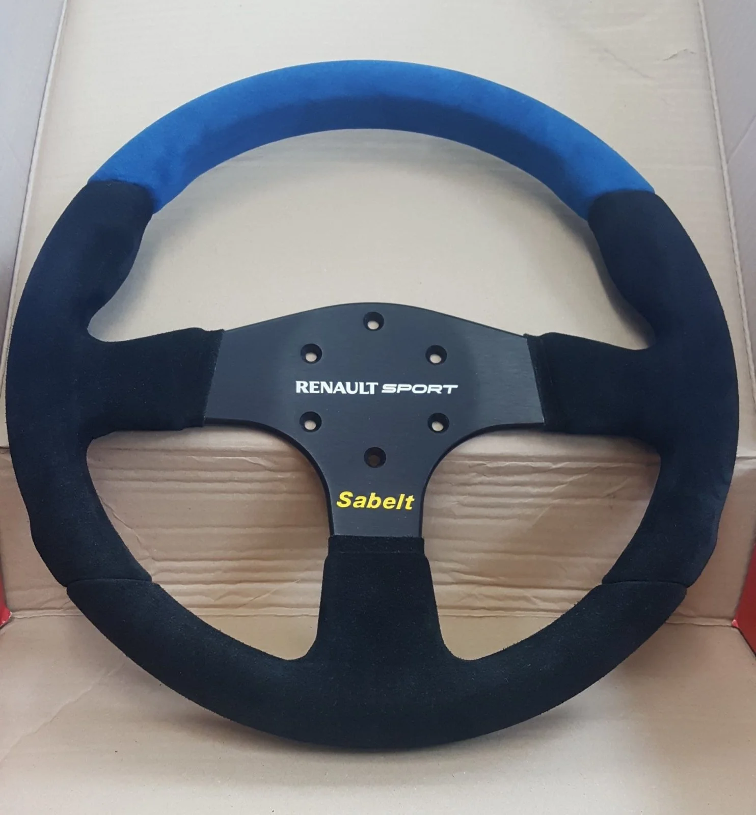

Just arrived, most impressed with this i absolutely love it and cannot wait to fit this weekend.

So i fitted the Steering wheel and the Stealth Exhaust, the car sounds 100 times better and the steering wheel is so good in truth they should have had this from the factory, transforms the driving experience completely, just need some driving gloves as i don't really want it getting dirty.
