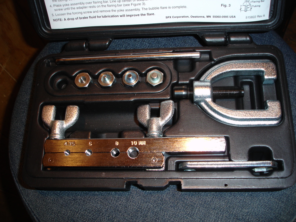

I got this "bubble flare" tool kit to replace my rear brake rubber hoses, I'm going to "cut" the rubber hoses from the steel tube, then add a fitting and flare the tubing, once I do this I can attach "regular" Stainless Steel Hoses!
Will post some pics from the process
