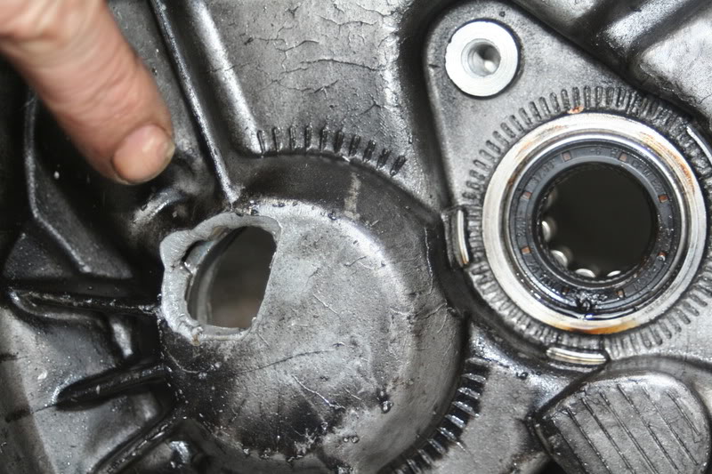

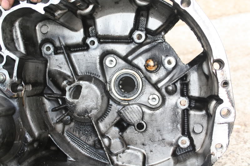

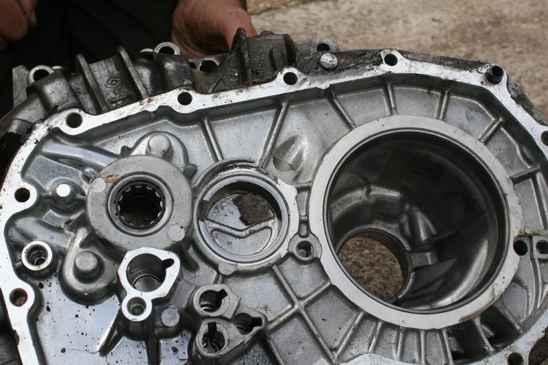

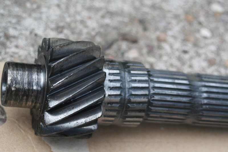

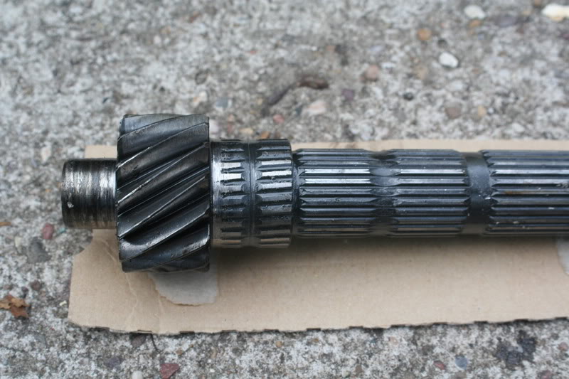

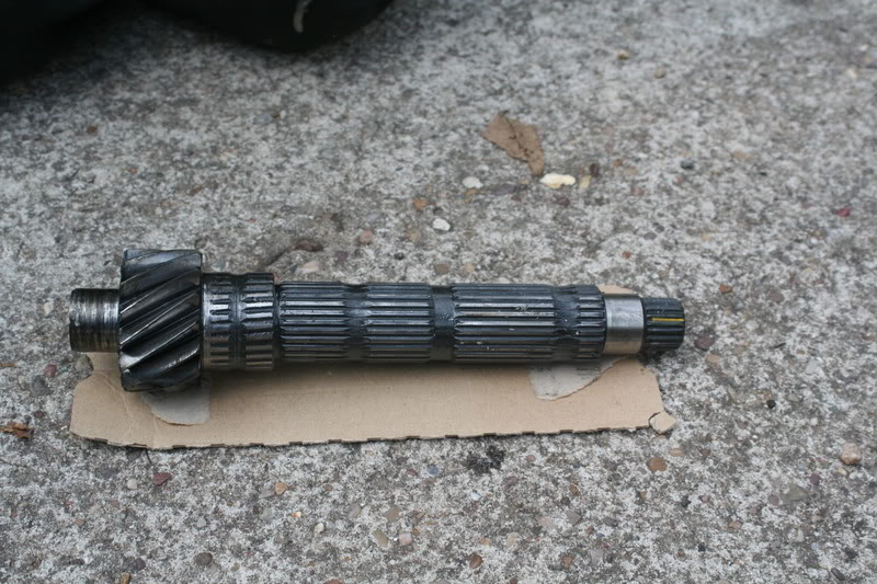

well basically the bearing went at the top of the gearing spindle and would not allow any fluid to get by ... as you can see the where on the spindle and the hole throu the gearbox caseing
some pics of the damaged parts
does anyone know the proper names for these parts
now i need to try and take all this stuff to reno and pray
